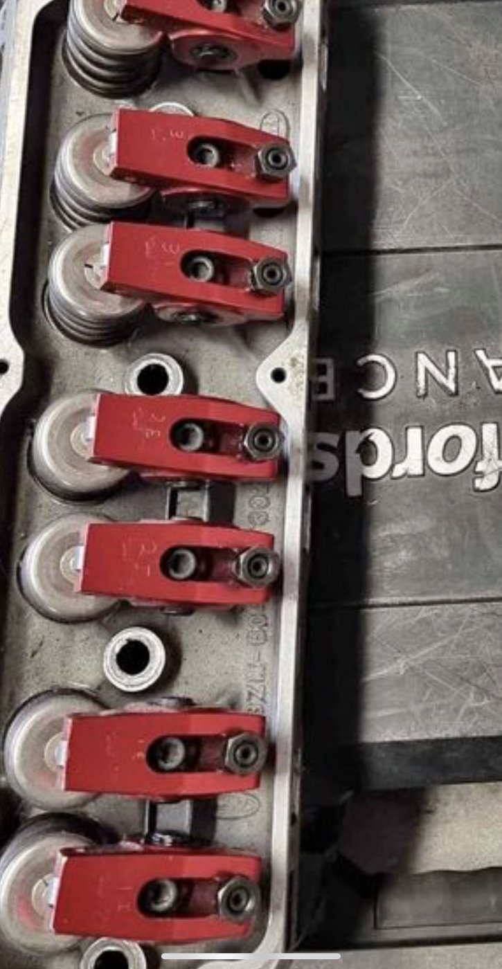

I’ve never seen rockers with adjustable tips before. Can anyone identify them please?
S Simon Mar 24, 2023 #1 I’ve never seen rockers with adjustable tips before. Can anyone identify them please?
Adam C. Mar 24, 2023 #2 Many pedestal and shaft mount rockers used with mechanical cams are that way. Otherwise you adjust hydraulic lifter preload with custom length pushrods. Rocker to valve tip contact is set by shimming. Those pictured are pedestal. Last edited: Mar 25, 2023
