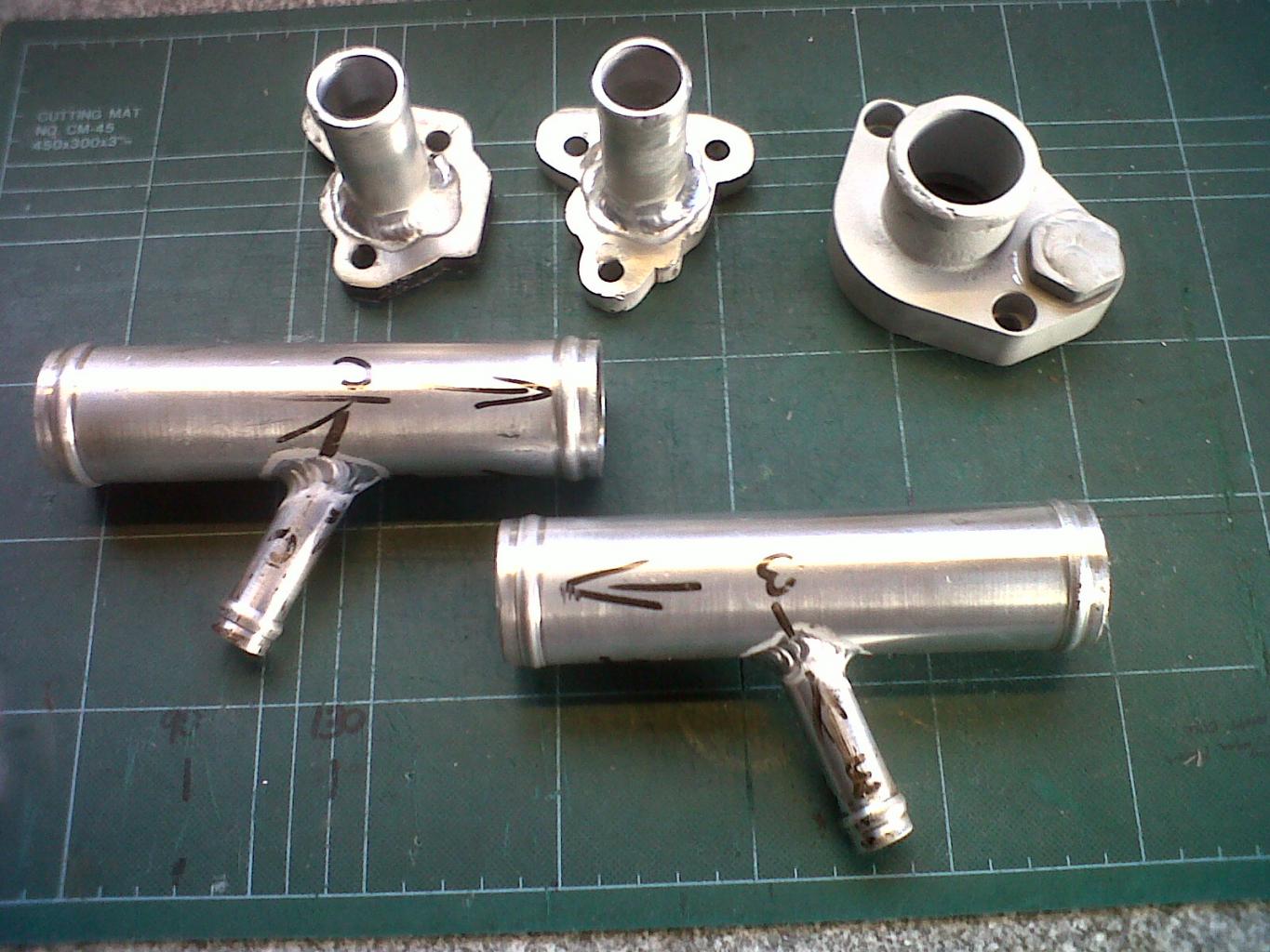

Hi Brett,
I was looking to your pictures and the routing of your heating hoses to the heater matrix.
They are directly tapped into the main hoses which sounds to me the cleanest and lightest way but I doubt if it works properly.
There is a large air bell sticking in your heater matrix.
How did you removed the air ? And is it circulating enough water ?

I originally want the take-offs at 45 degrees i.e. in the direction of flow, but the person who did them for me didn't do what I asked. Worse case I will add a small booster pump

Hi Brett, Skorpion is right, you will not get any flow in the tee-offs to the heater. Unless the branch pipe goes into the middle of the flow on the larger pipe. What I did with mine was a 45 degree tee for the branch offs. The smaller branch pipe is not flush with the inside wall of the larger pipe, rather it goes into the middle of the liquid flow and has an angle cut so the liquid will be forced into the smaller pipe. K
