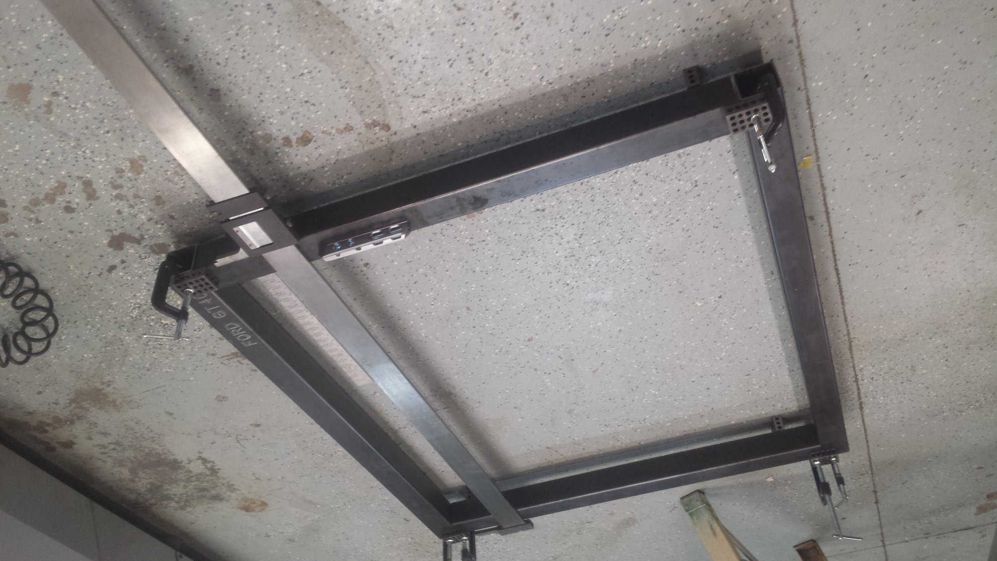

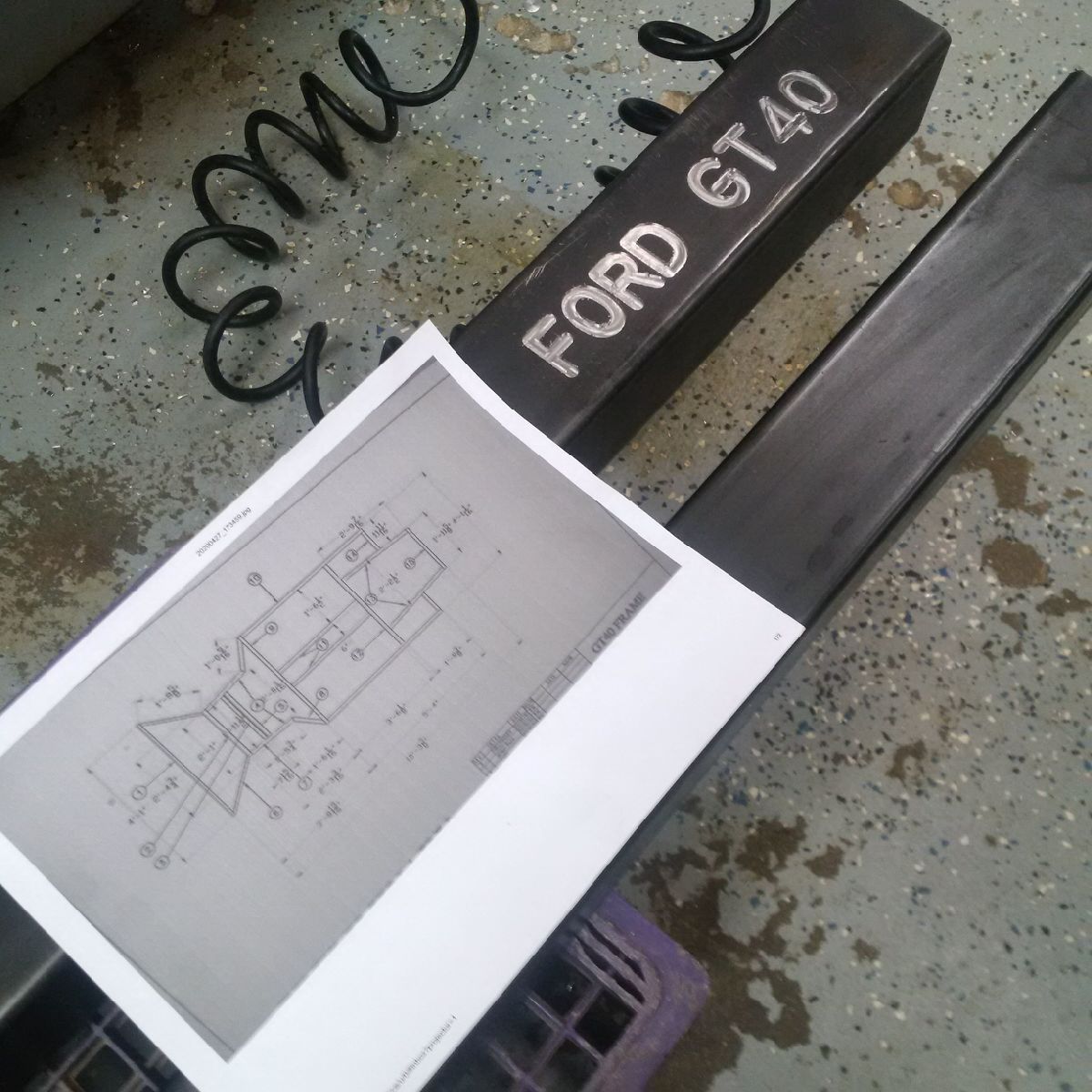

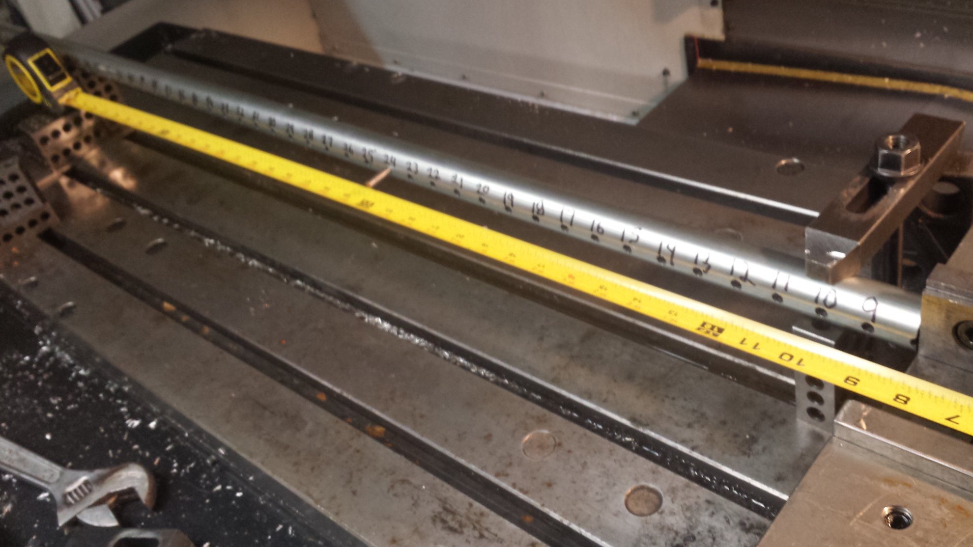

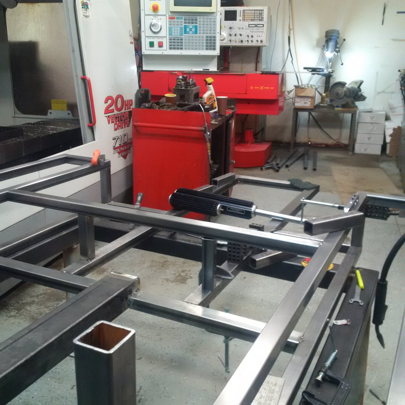

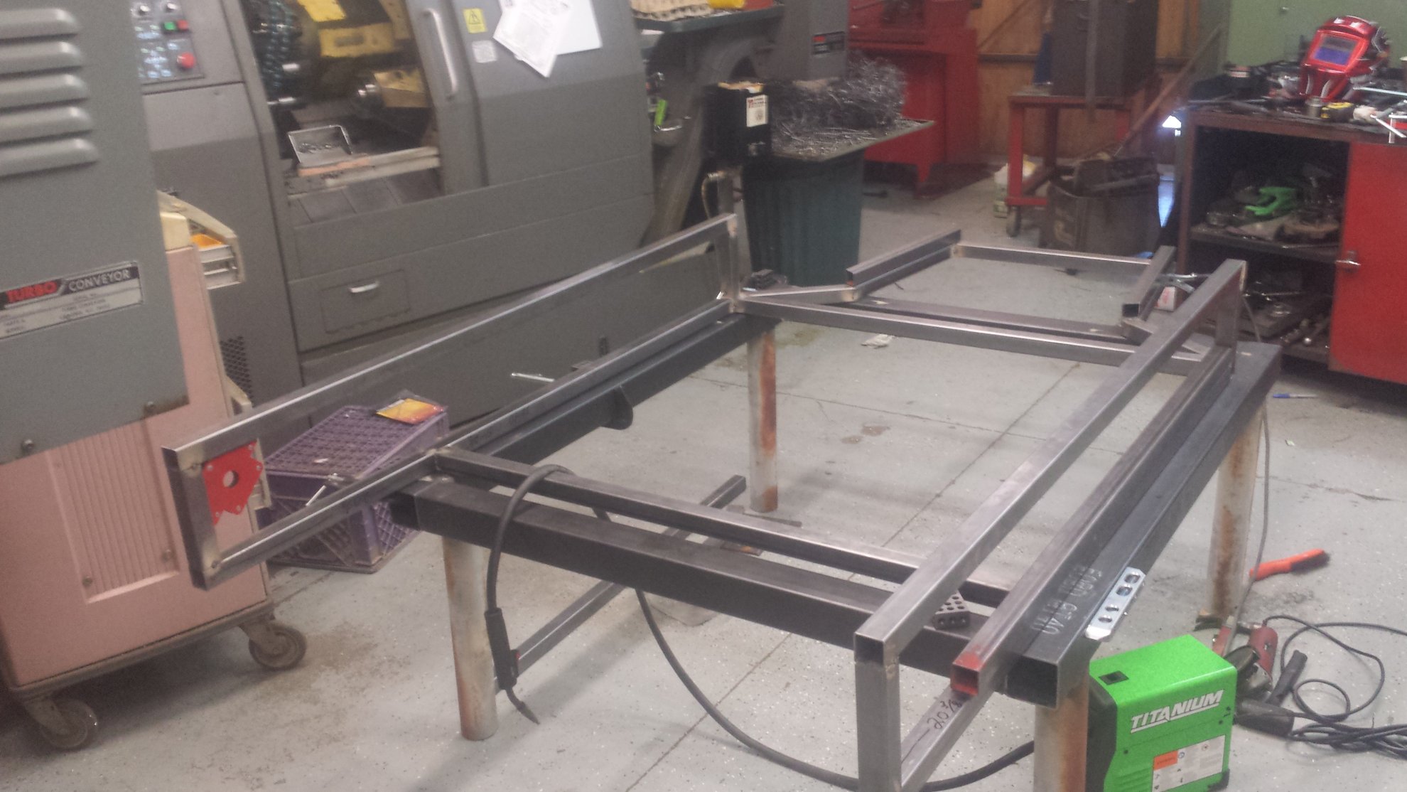

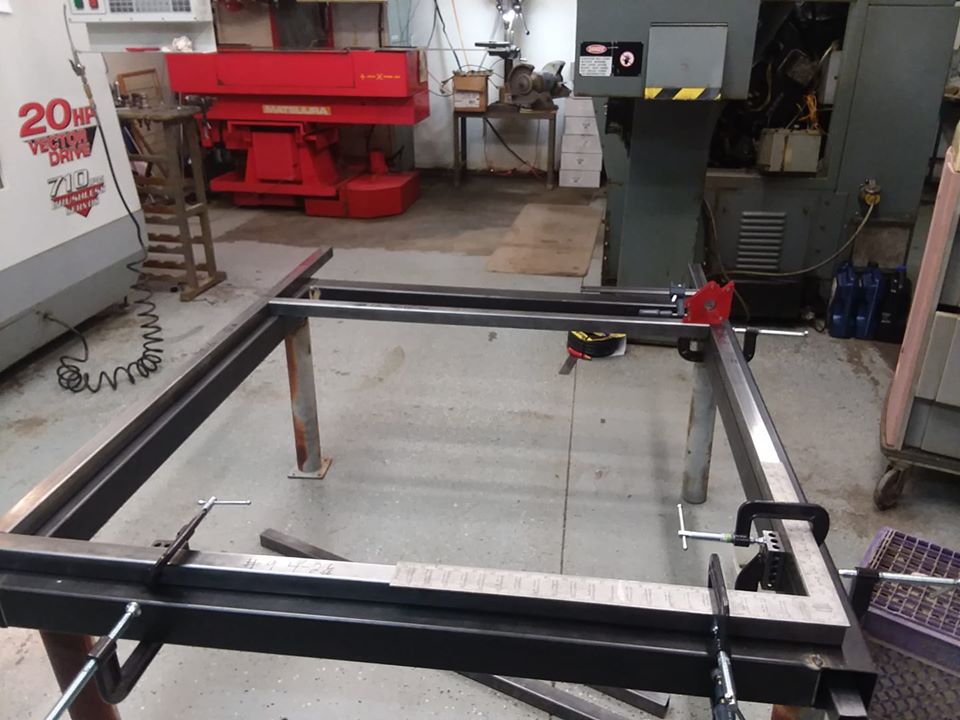

Starting the welding jig squared up ends on the Hass using XYZ to make measurement.
Setting up CNC to cut frame parts each hole is 1.00 apart and a pin is set at size up to 72 inches then program number in X is changed say .375 parts will be within .010 should be tack welding sunday.
Make the diagonal measurements equal from corner to corner and you are guaranteed square.

I don’t see a CNC in my future, but may get into 3D printing when I move to the interior work. It may come A CNC can make very accurate parts basically all the parts. and a cad program ( I use Master Cam) has helped me decipher the drawing that has blurry missing dimension, figured out the frame. For now only tack welding it to see if the body fits. It's fun to build for sure.

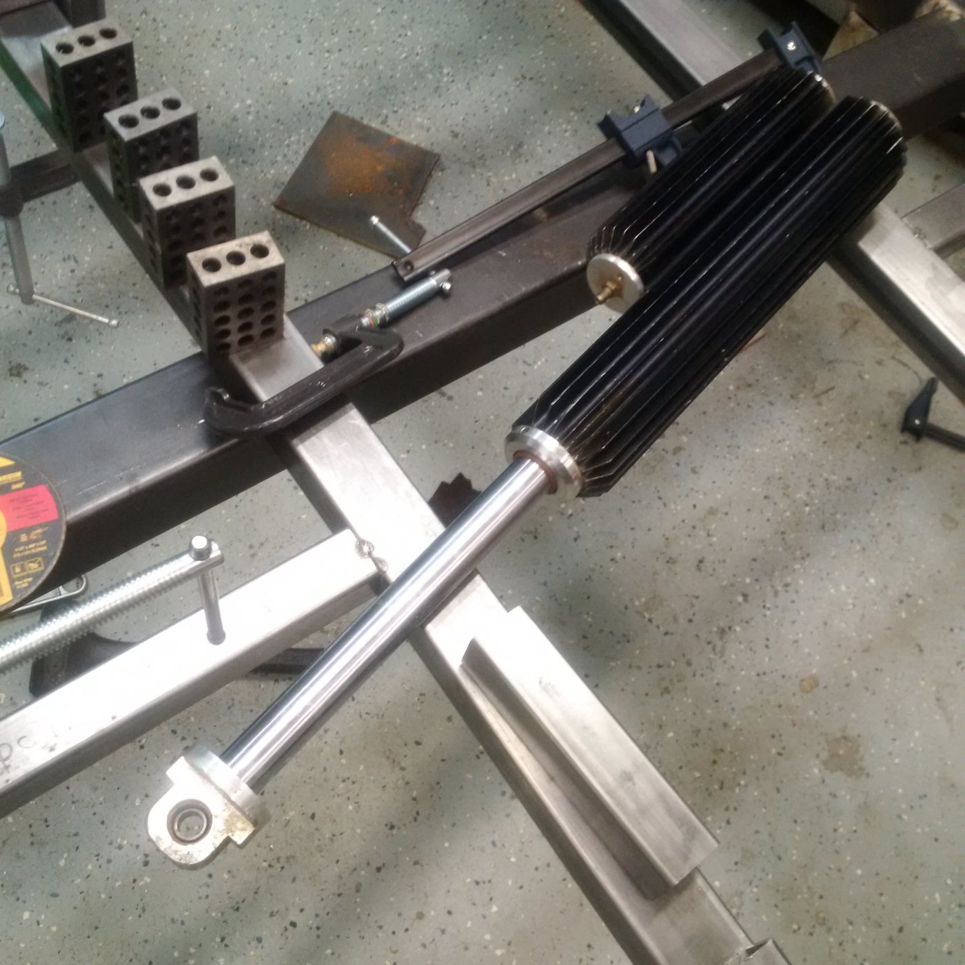

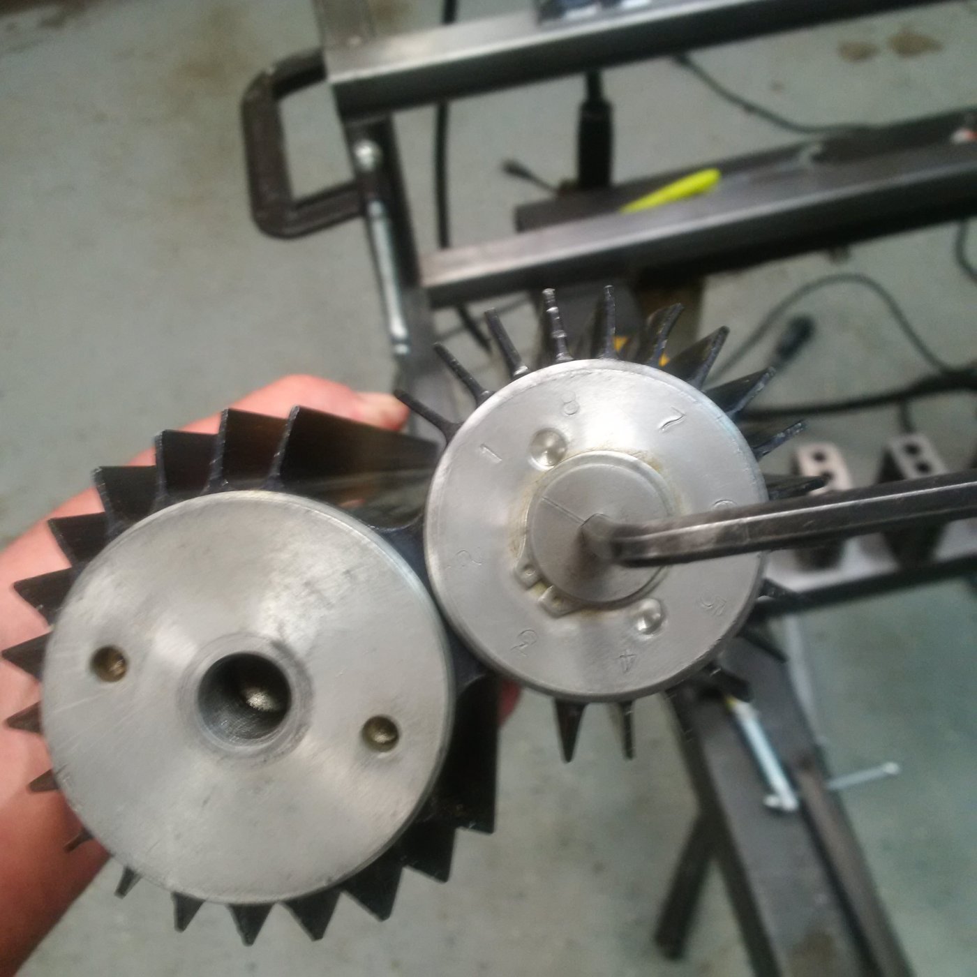

Working on chassis considering suspension with adjustable compression rebound damping shocks, modifying them to get a light coil maybe 350 lbs then using nitrogen for final ride. I got 20 bodies ready to be machined into shorter lengths.
