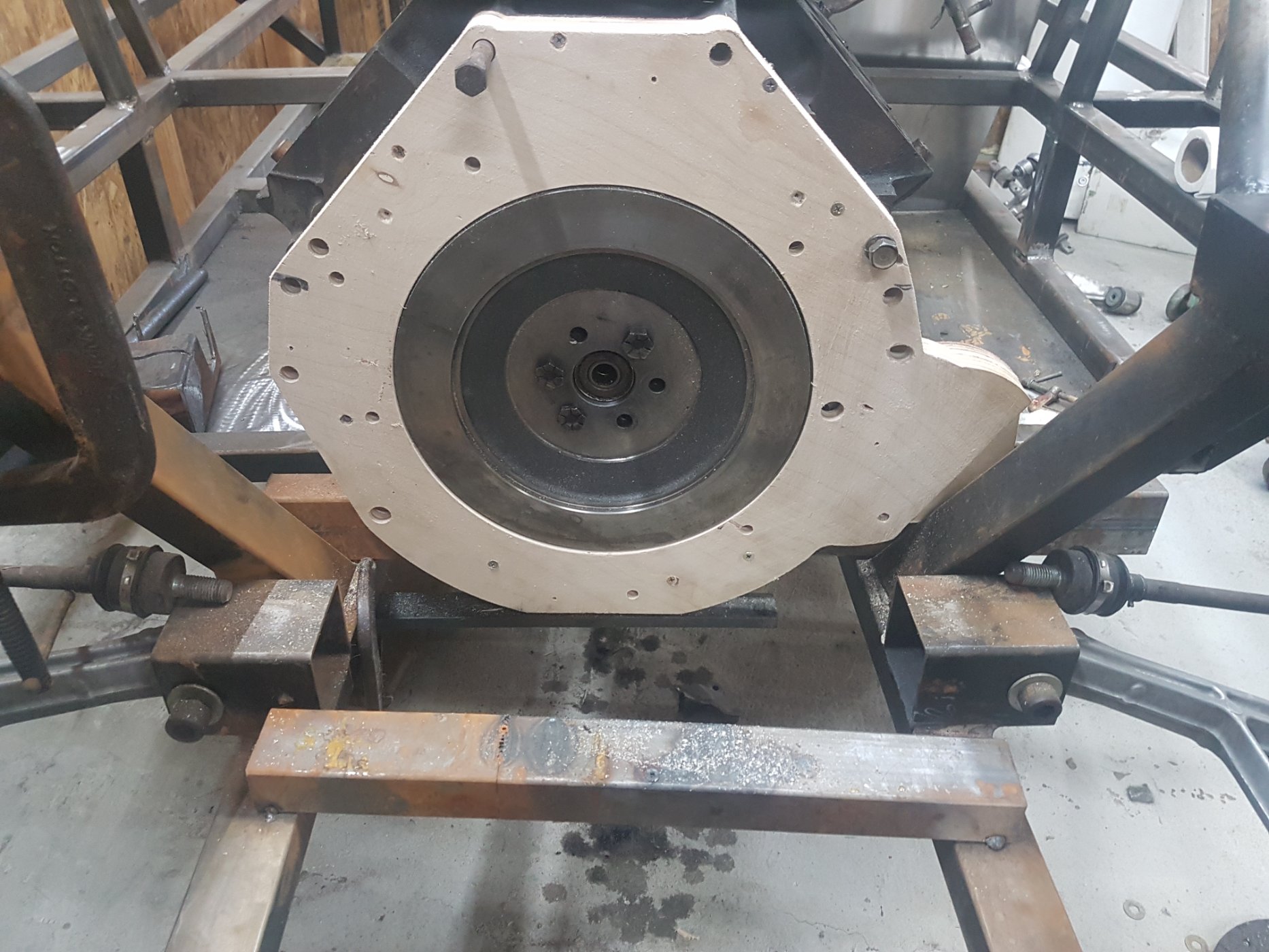

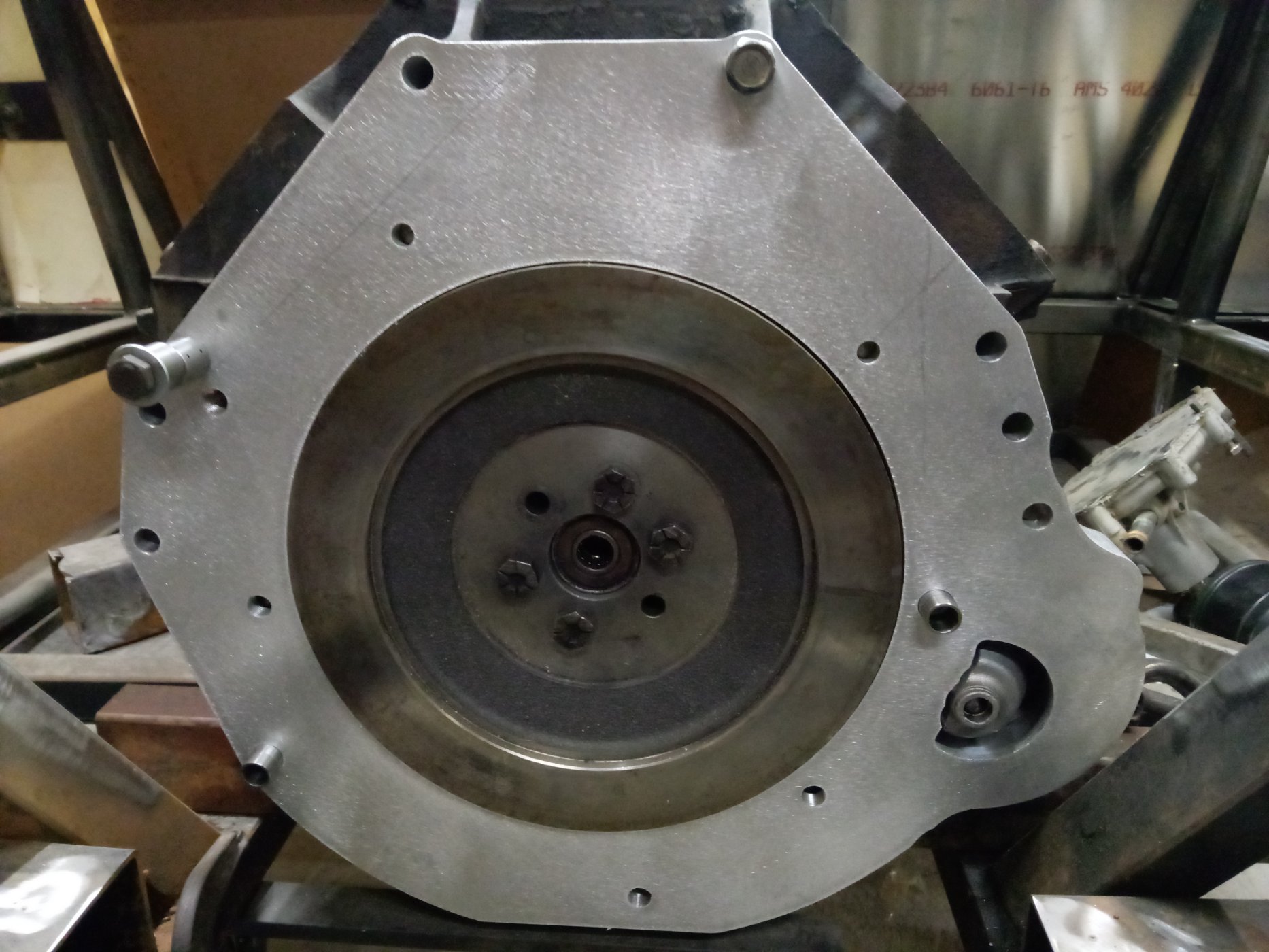

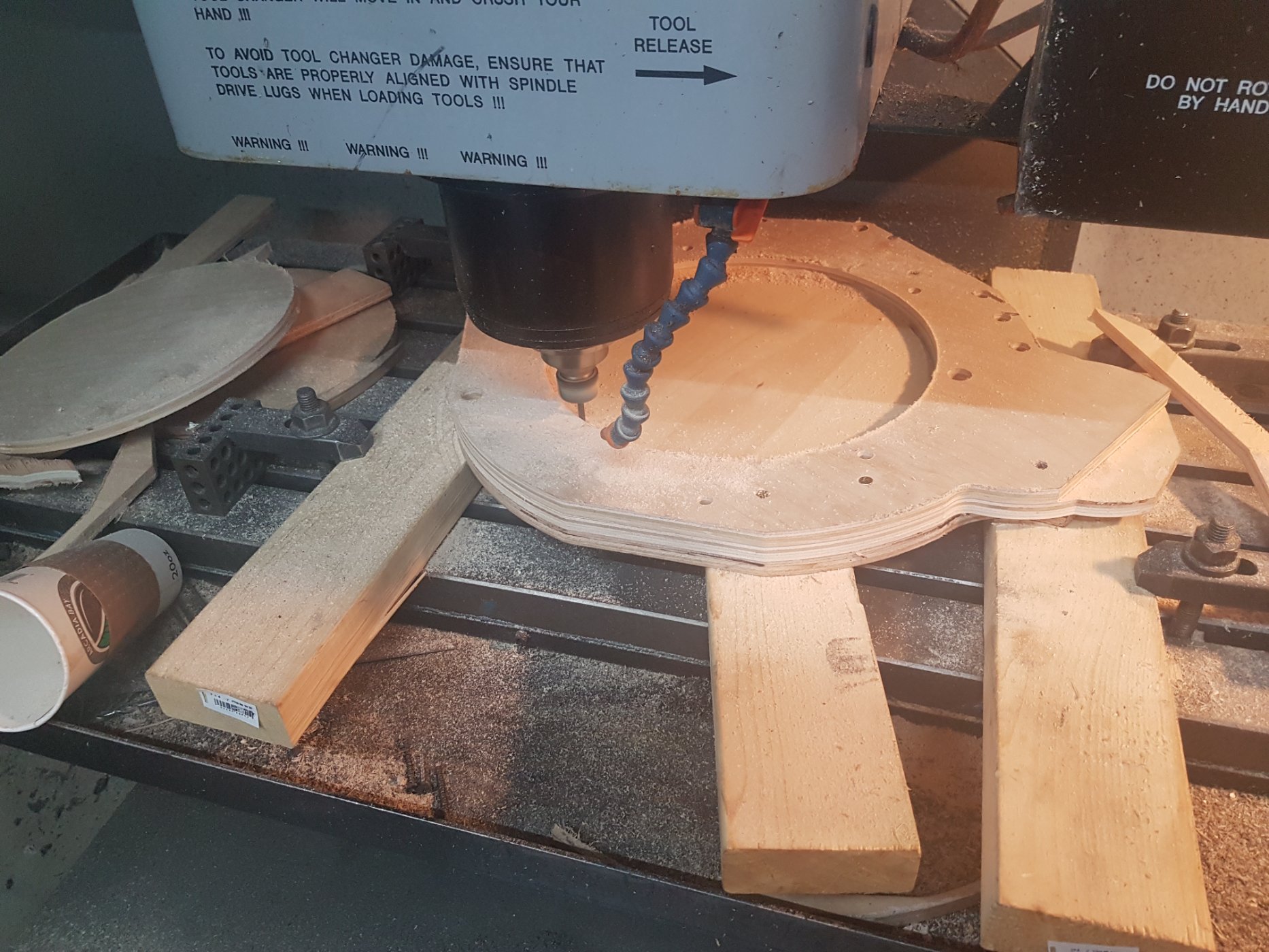

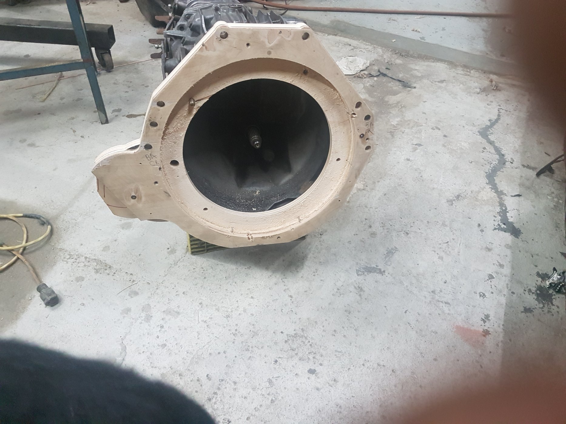

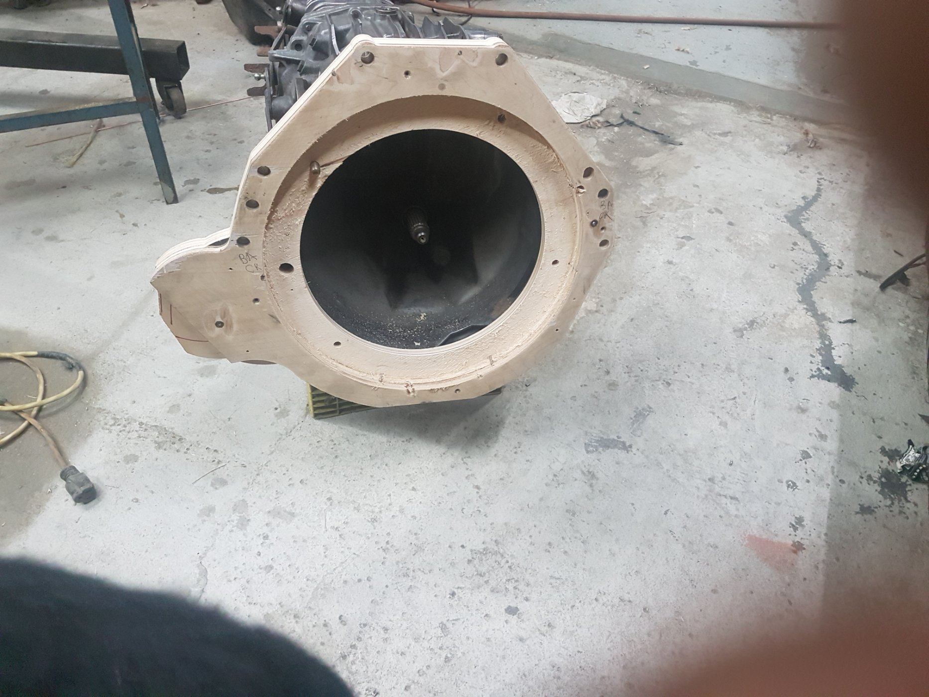

Making the adapter for the 351W to 996 trans. There was a good drawing for the 351W bolt pattern and Locating Bushings so not a problem. However the 996 Trans bolt pattern was none were to be found. Had to make a centering part to locate the tranny shaft XY ZERO and then a special bushing to hand drill .200 Dia holes in perfect alignment. And then on Mastercam create points by lowering the edge finder down in the hole and moving XY till perfect fit. I made the model out of wood as if i tried Aluminum I would have scrapped a lot of metal. I am using the 351W Ring gear. I have seen some the use the small 996 ring gear and a small gear then the starter. 3 gears ? Any way this will be stock starter and gear set up.

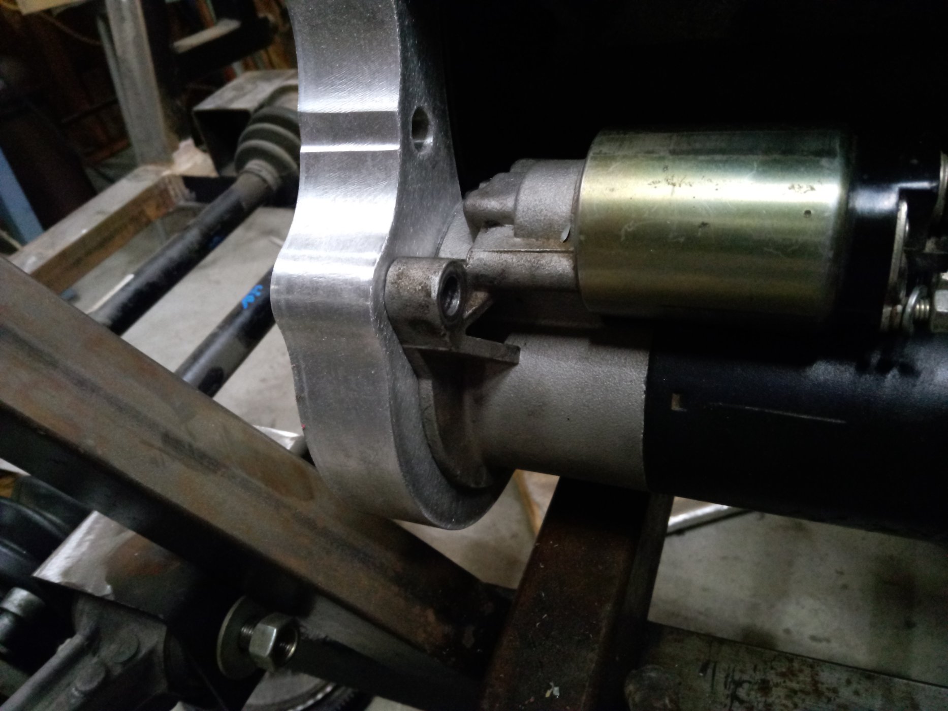

I could send you the CNC program. The adapter is 1.5 thick and uses the stock starter no cutting the 996 tranny. I have not completed the adapter in Aluminum. I have to go buy the the metal so updates soon;

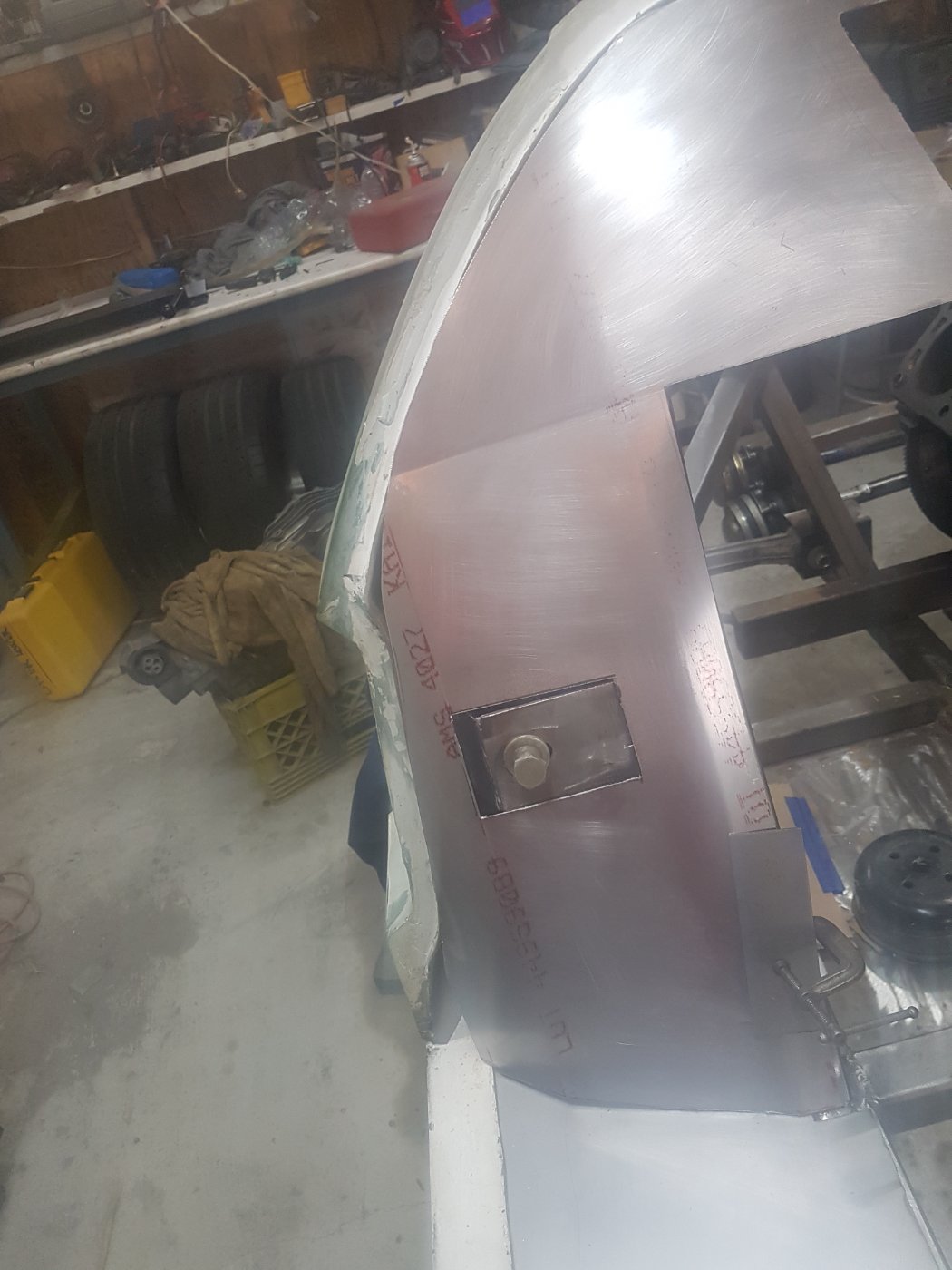

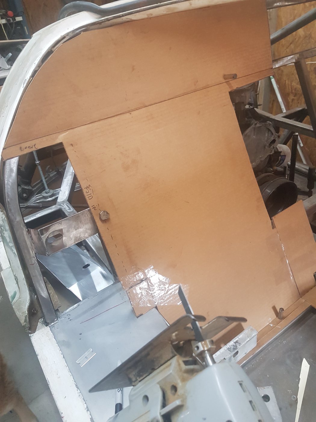

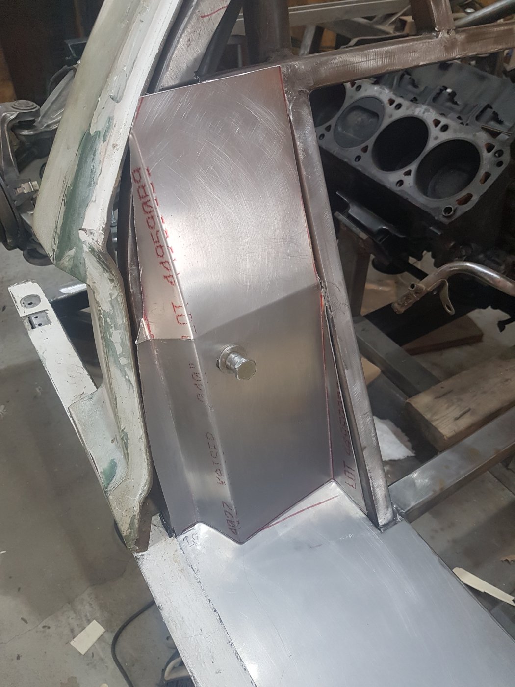

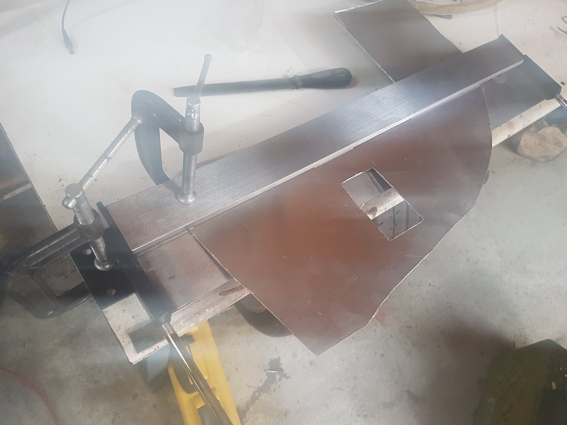

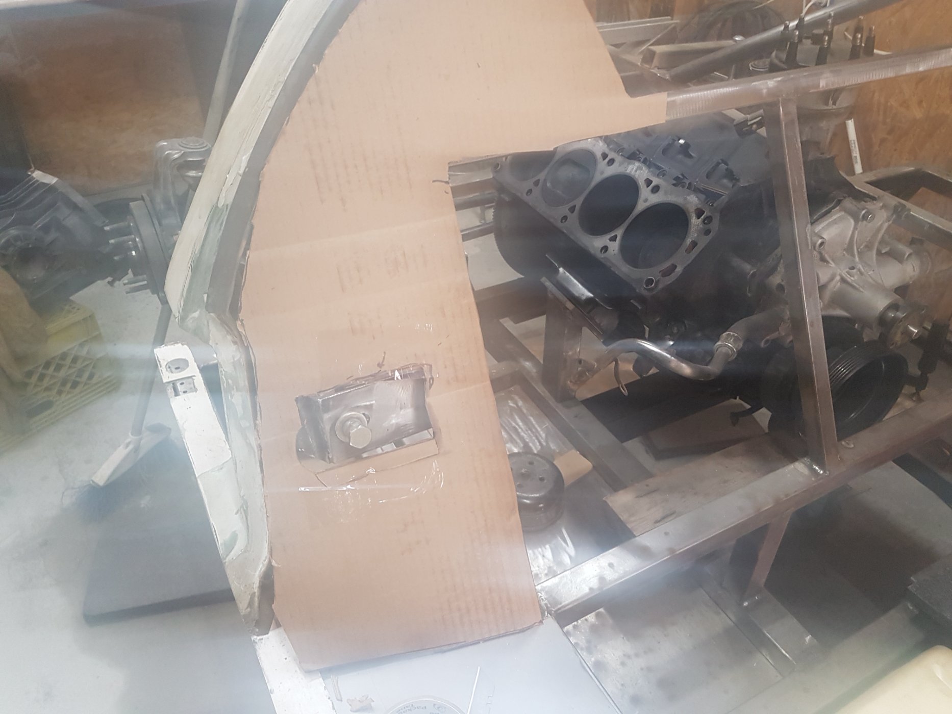

Working on sheet metal, making cardboard templates thenView attachment 143685View attachment 143686View attachment 143687View attachment 143685View attachment 143686View attachment 143687 marking the Sheet metal for cutting. I bought a harbor freight sheet metal brake to make the bends to fit the frame. Part shown has 4 bends to fit. Also I recommend for cutting cardboard. Use a Jig saw with a razor blade cutter. It saws the card board very precise, clean.

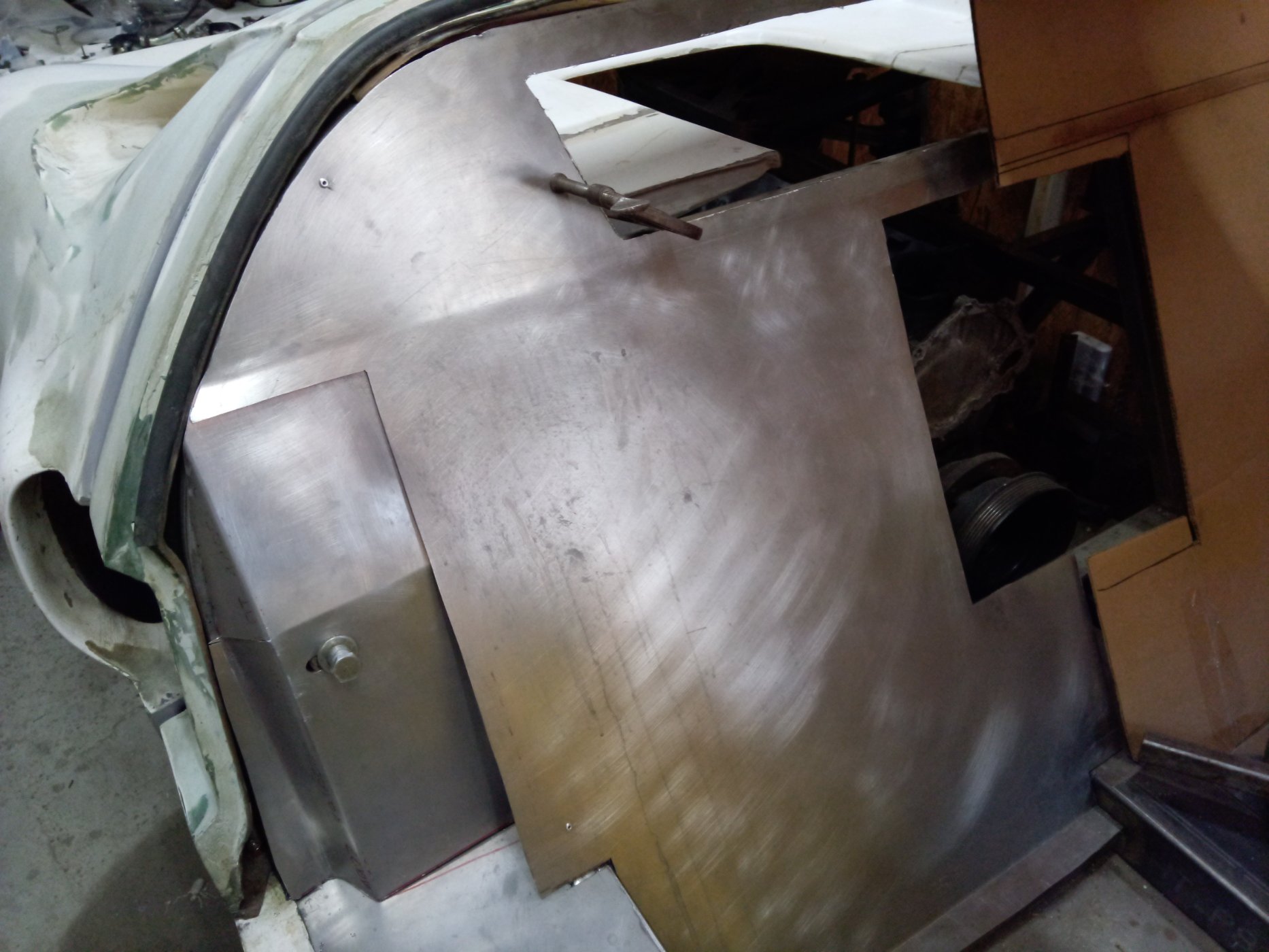

The door did not close, here is the modified version. There will be some Heli arc to get this finished.

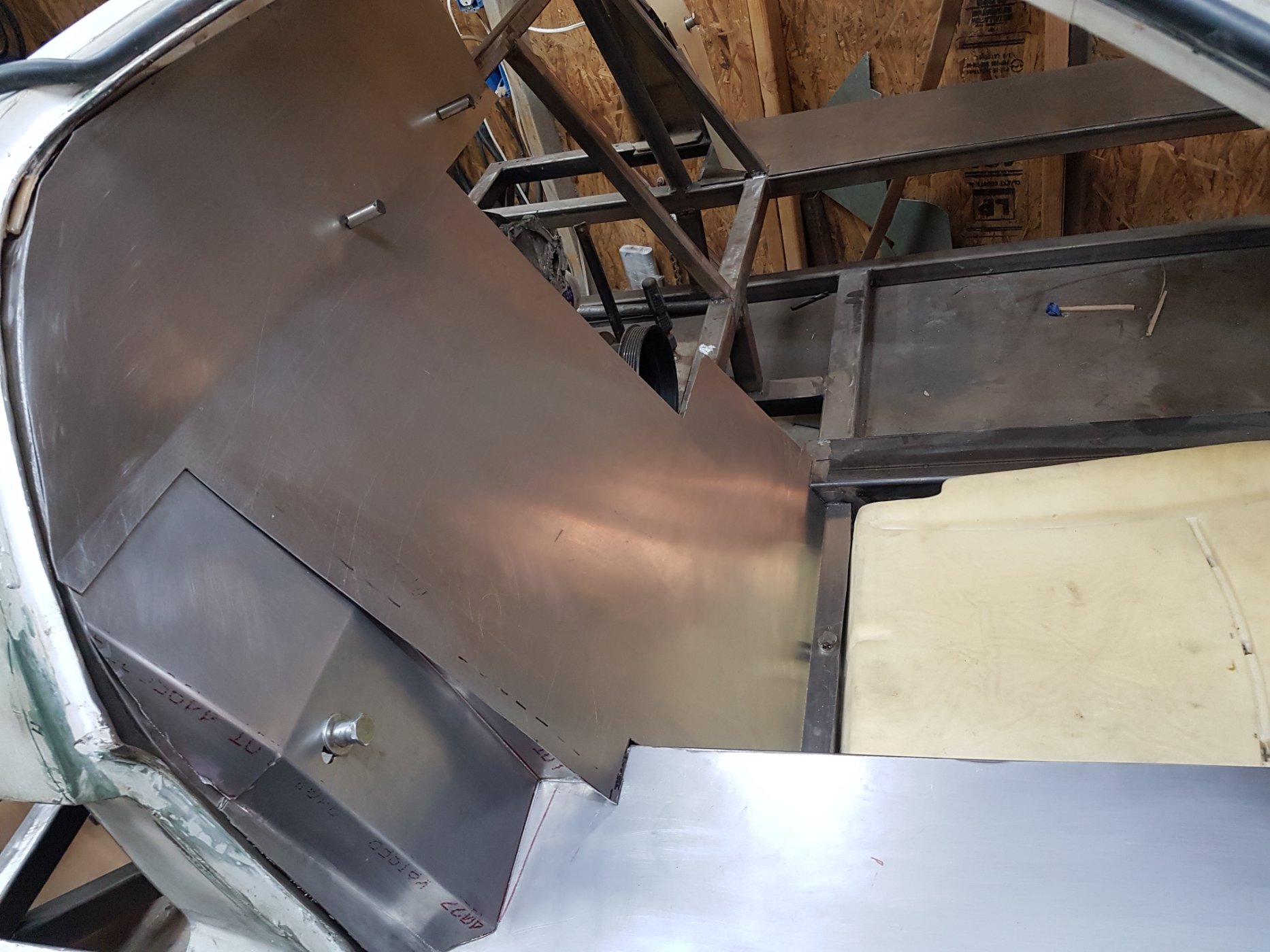

The door did not close, here is the modified version. There will be some Heli arc to get this finished. Next is the panel in cardboard that was cut to shape. And bent with the harbor freight brake. Using a dab of grease on the steel to mark difficult areas that sharpie could not get. After I used strong magnets to hold pattern in place. the rest of the pattern could be completed followed by marking the sheet metal. See razor blade jig saw blade, really made nice straight cuts in the cardboard pattern. Next is to cut sheet metal to fit then make NC points around the rear window for the CNC mill. The magnets really keep the pattern in place.

The cardboard pattern worked out good, The Harbor freight brake barley made the bends .062 aluminum. Maybe a pre heat will help here. I am going to have a cover to work on motor if needed. Tomorrow on to the other side. And then a drive down to Industrial to get the 1.5 thick plate to finish the transmission adapter.
Here is the final adapter plate for the 351W block to the 996 transmission, making a wood model is the only way to go as it is easy to correct mistakes. Anyway it fits perfect with a tolerance of + - .005

Hi there, I used the stock 351W ring gear and cut it down to fit the 996 clutch assembly my plate is 1.250 thick. No cutting of the 996 tranny or cutting of the 351 block. I think people use the 996 ring gear or a second gear. Do you have master cam i could e-mail it if you like

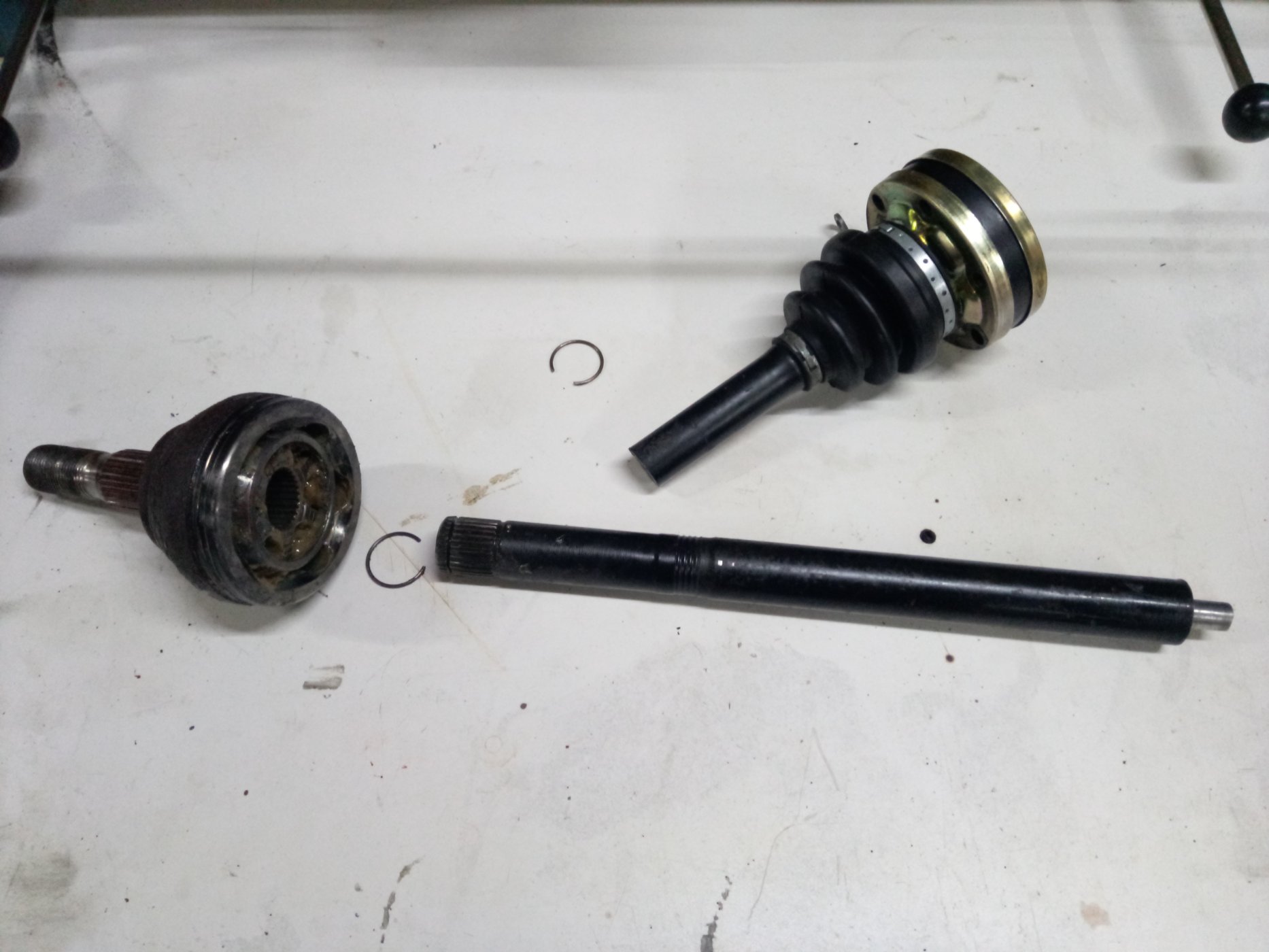

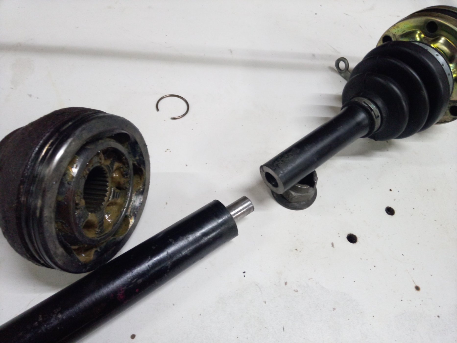

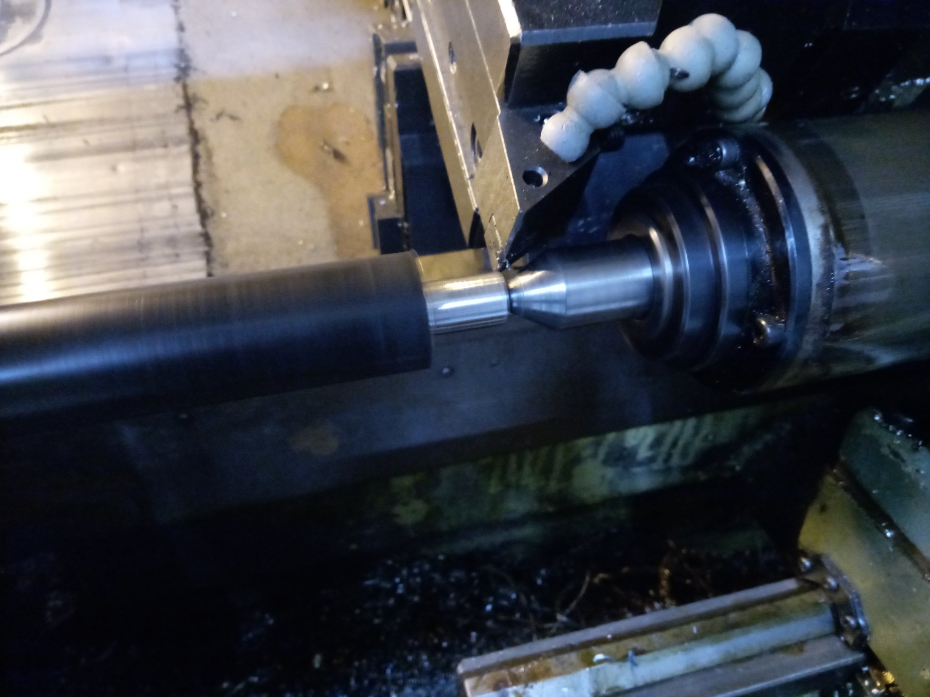

Today i did the 996 axle to C5 axle. I cut off the 996 four inches from the end and found out it was hollow. That made it easy.
Then I drove out the C5 hub with a brass hammer (notice clip that holds it together) Then on my CNC lathe I turned a smaller shaft
on the C5 end .575 X 1.00 Later I will tig weld it together with a slip sleeve and pin weld it.

A simple butt weld might work OK but if you cur the ends at , say a 45 degree angle and weld the two parts together you will have a stronger, more fatigue- resistant axle. Keeping the two parts aligned is critical, no matter how you do it. What is the dog's name?
45 degree for sure. Holding off on welding for now. Thor is my dog my buddy. A German Shepard 120 pounds and a lap dog.

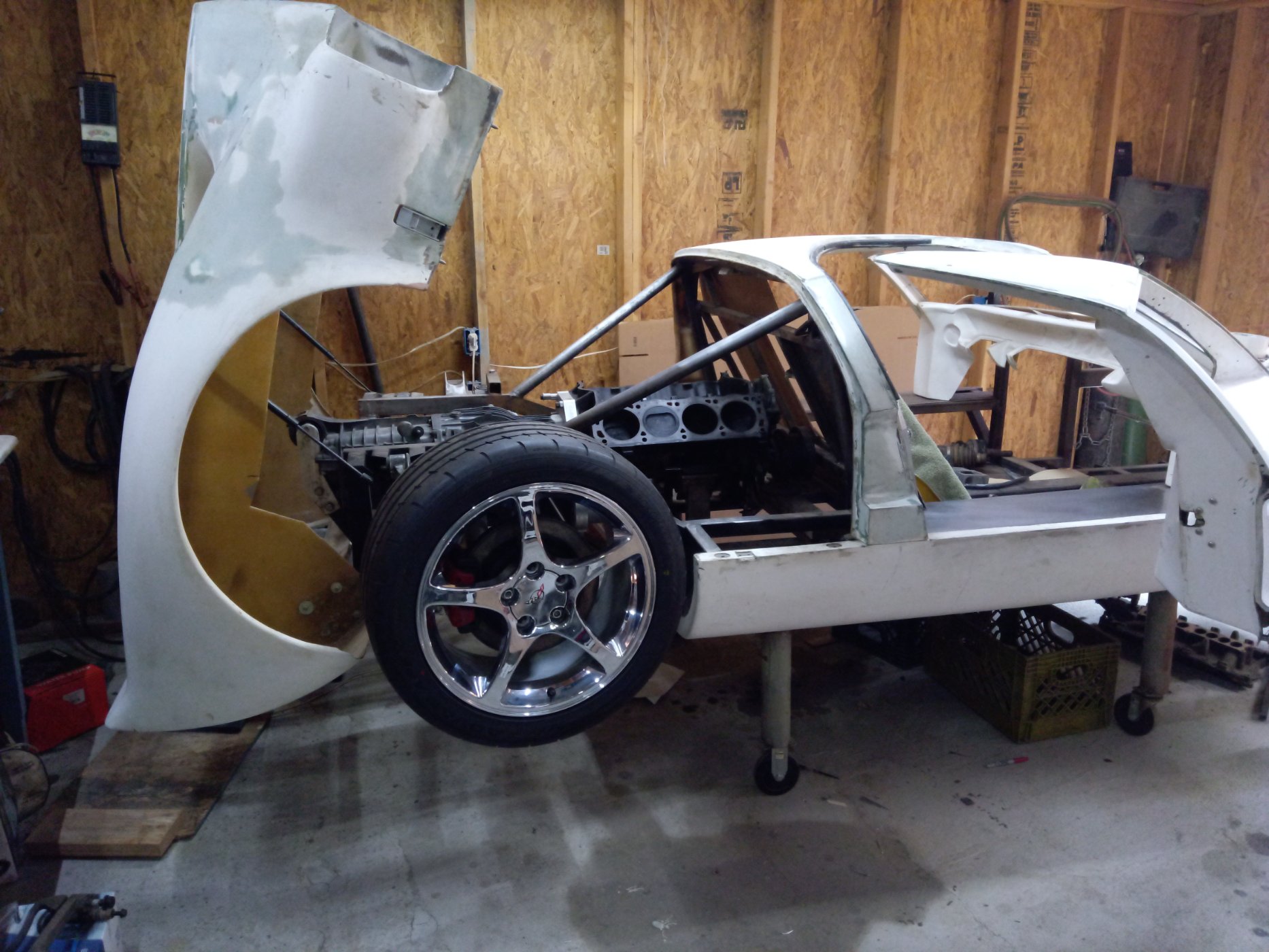

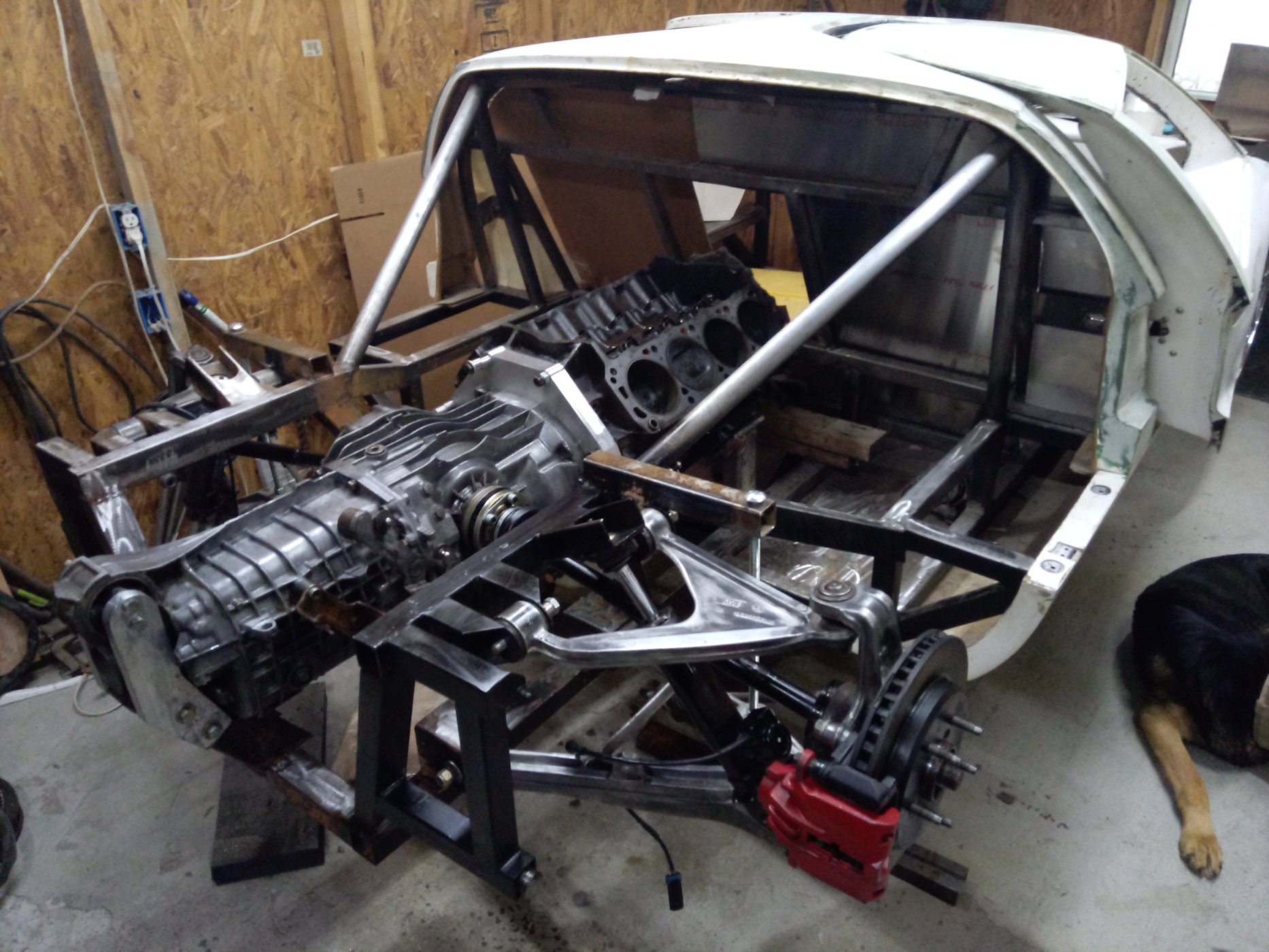

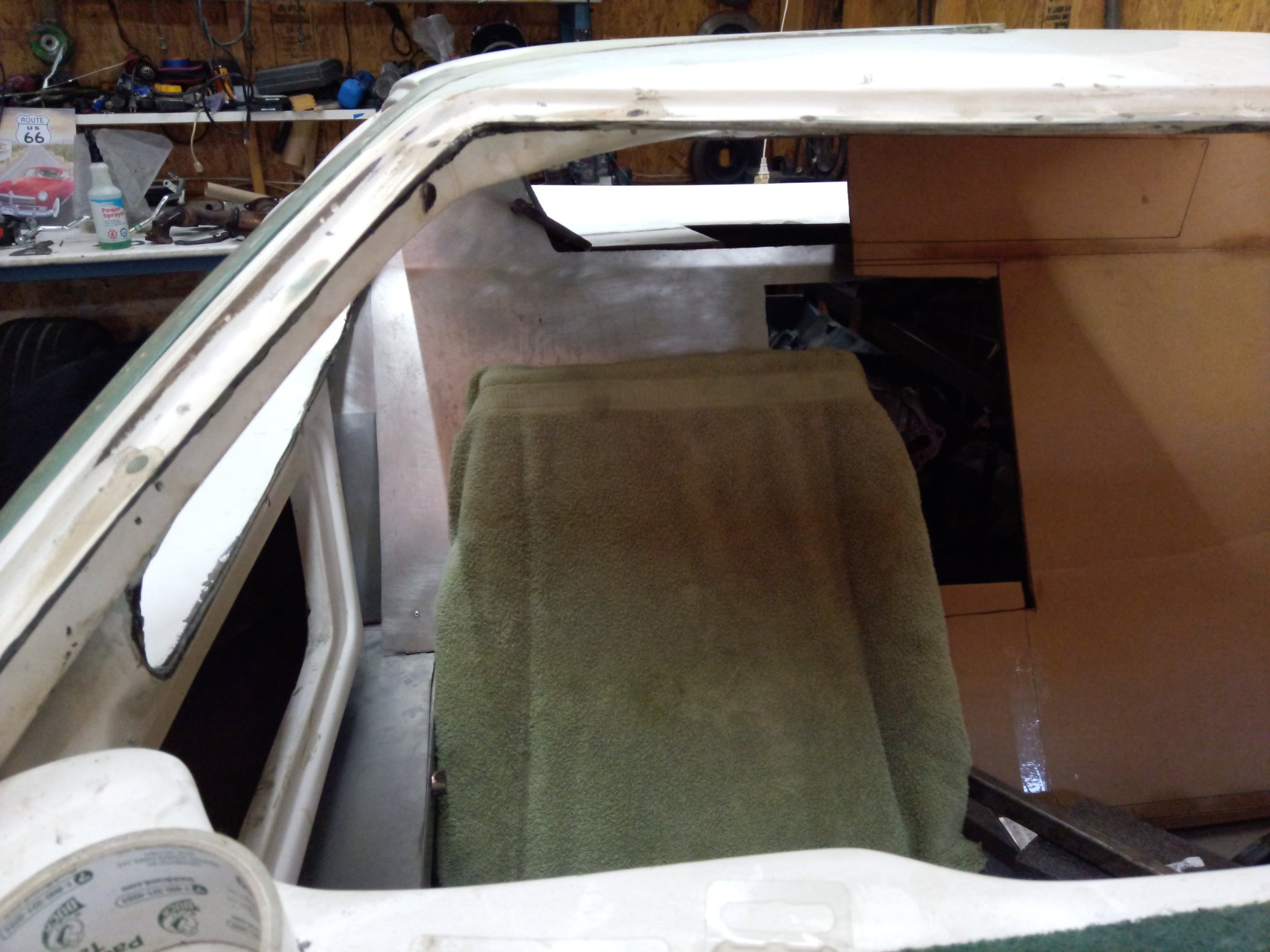

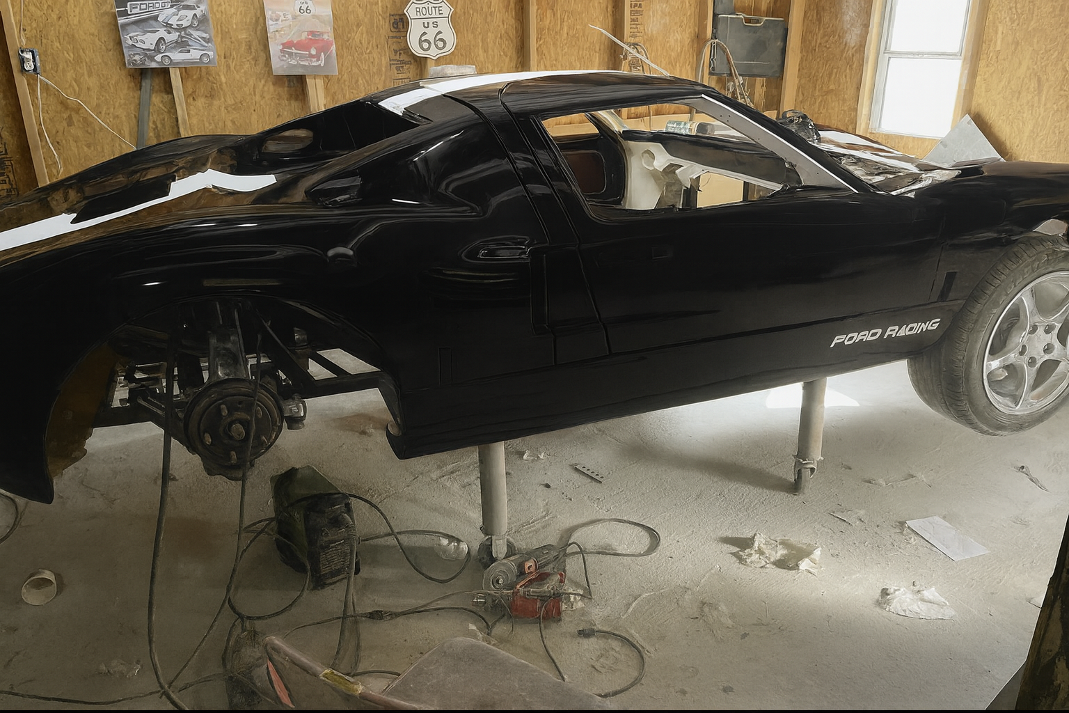

Made some progress today did some sheet metal work cut out the rear window. Making template for driver side sheet metal. Also trying out some seat foams

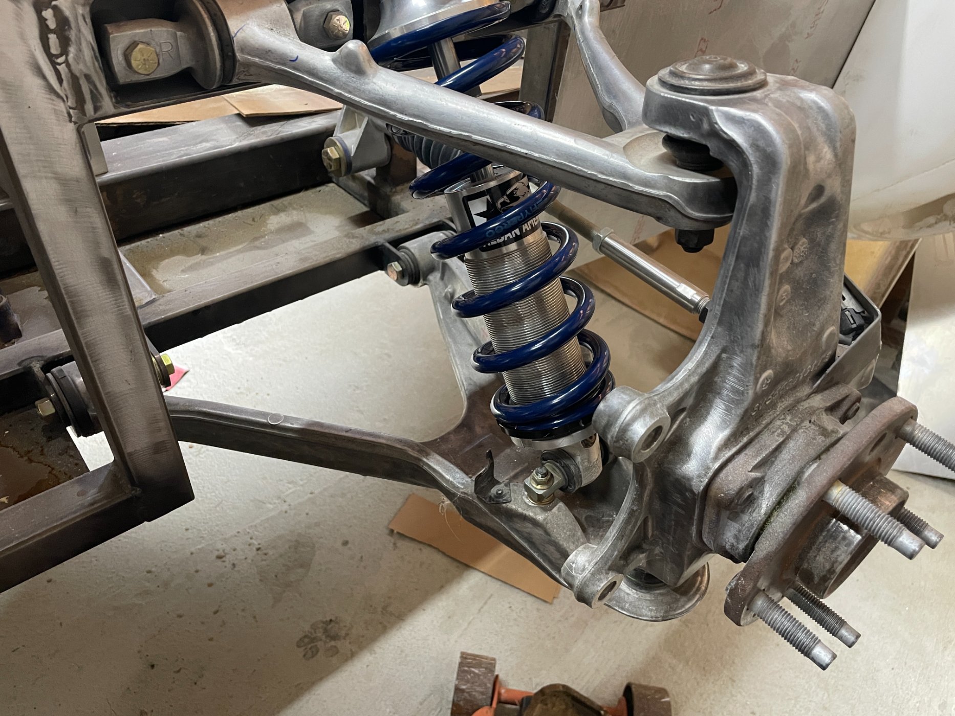

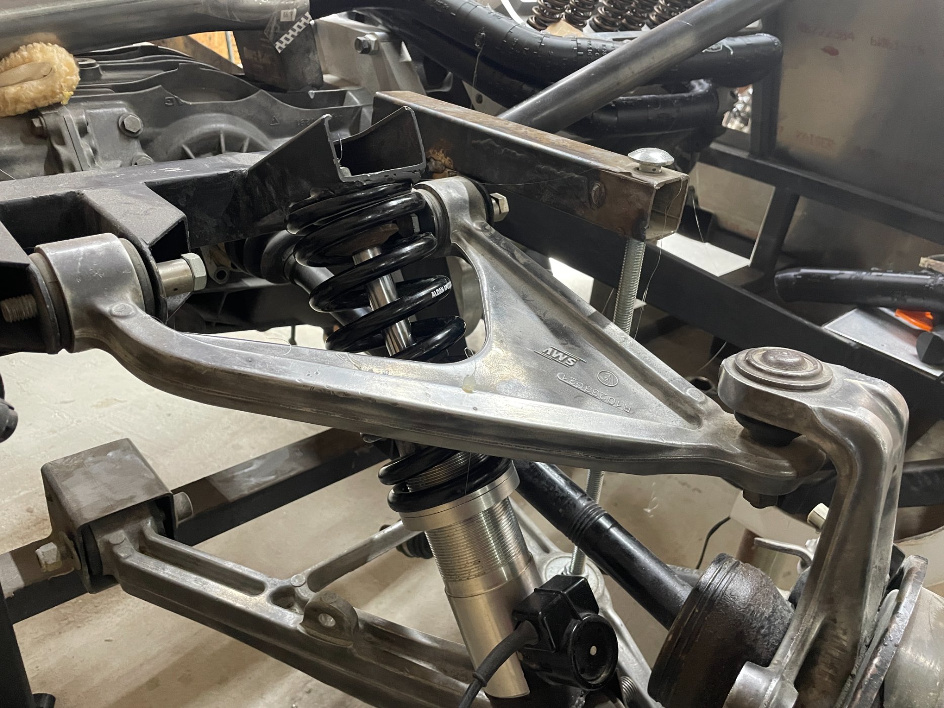

Getting closer. Got rear shocks close 9.5 inch 500 pound springs???? Maybe longer 10.5 inch

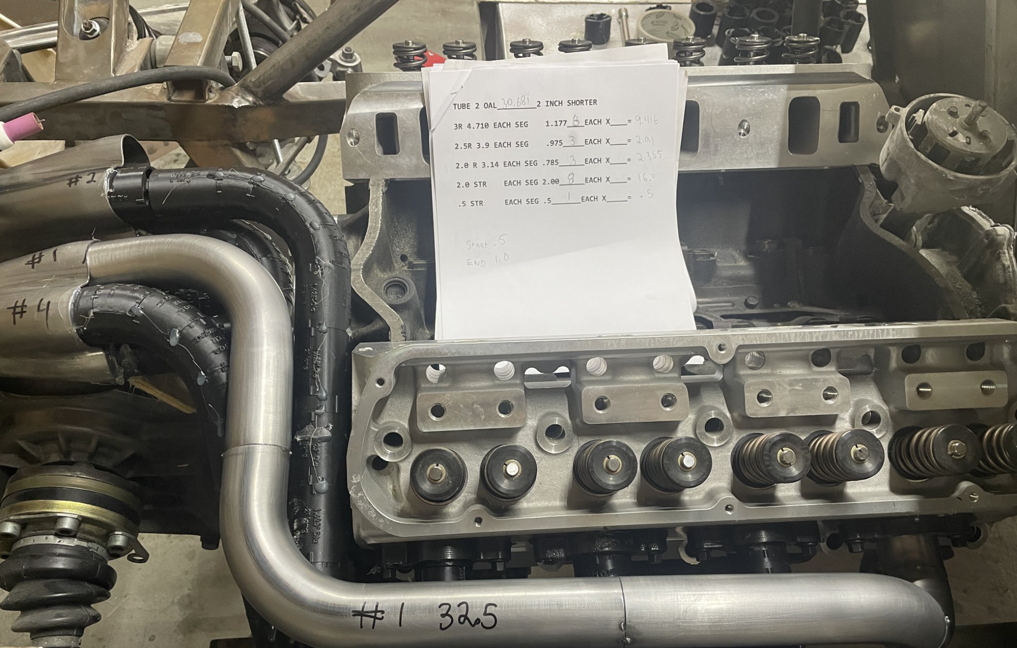

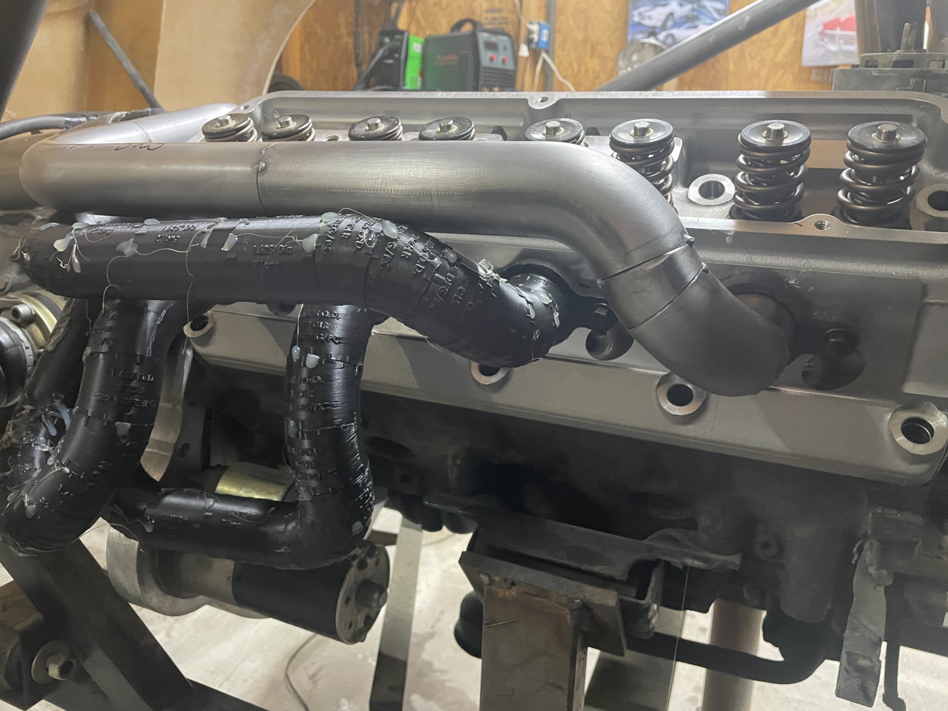

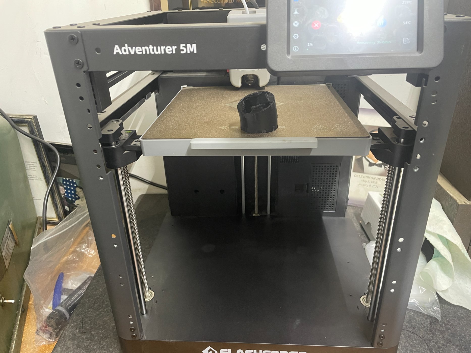

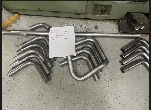

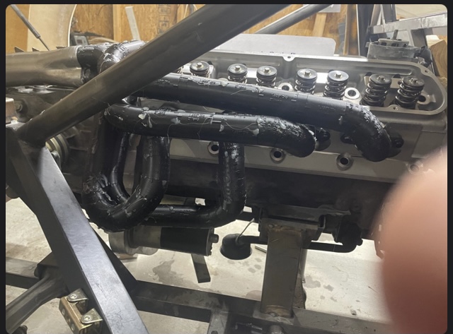

Front shocks 350 pound ???? and the bundle of snakes. I got a Flash forge 3D printer $250 to make tube segments. Using AFR 190 cc heads on the 351 W tubes are 1 5/8 .065 wall steel.

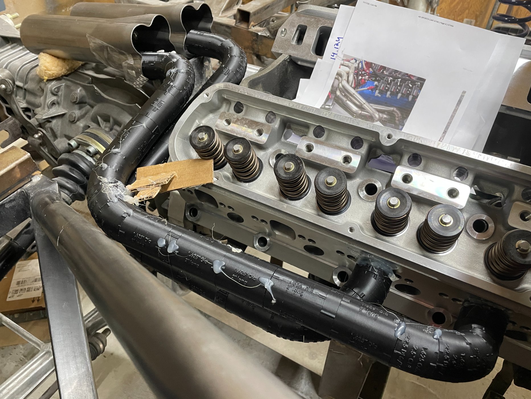

3.00 R and 2.5 R. Setting each segment first try small O rings not good then I put dabs of hot glue and good to go. Maybe stainless tubes later.
The most frustrating part of this build is my iPhone making photos upside down. Next time i will use my Blackberry Q5. (it still works)

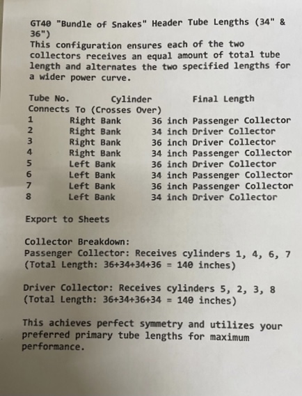

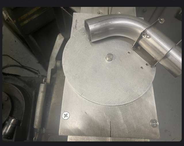

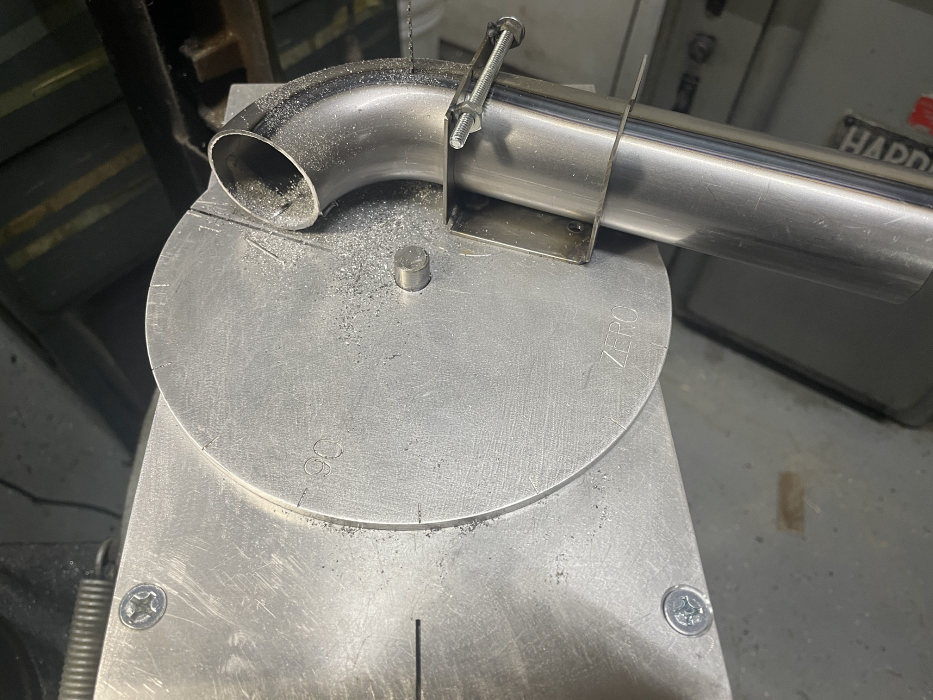

Making the snakes. I used a 3d printer to make segments and then put them together so there were 4 30 inch oal and 4 32 inch oal
Then cross firing in the collector. supposed to help torque and higher rpm 180 degrees firing.
I also made a saw jig the cut each segment at 22.5 degrees. One thing that helps a lot is to put a drop of hot glue at each joint.
Only the joints. To release twist the segment to release it.
Making these out of steel for now.
