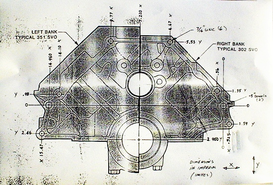

flatchat(Chris)
If your adapter plate has been machined with the correct coordinates from the crank axis for the bolt and dowel holes of the motor and trans., it should align and fit-- give or take a thou or two (which is like a nanometer to a bricklayer /ubbthreads/images/graemlins/grin.gif)
PM me if you need thes dims.--- for a bottle of your finest bourbon /ubbthreads/images/graemlins/beerchug.gif
flatchat(Chris)
Ahem !
flatchat(Chris)
Or, engage NC for bolt and dowel coordinates --crank axis @ XY'O'
L1 X - 7.745" Y - 1.31" drill 15/32"
L2 X - 7.22" Y - 2.9" ream .500"
L3 X - 6.66" Y - 4.25" drill 15/32"
L4 X - 2.55" Y - 8.43" drill 15/32"
L5 X + 2.55" Y - 8.43" drill 15/32"
L6 X + 6.88" Y - 3.88" drill 15/32"
L7 X + 7.74" Y - 2.9" ream .500 "
L8 X + 8.25" Y - .44" drill 15/32"
6 bolt Windsor blocks
..........Y-
X+<---O--->X-
..........Y+
(1st neat correct entry wins) ? /ubbthreads/images/graemlins/grin.gif
