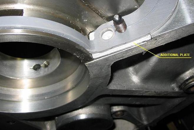

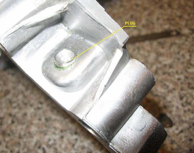

Interesting subject! As I have built a SBF aluminum block I can tell you that it is true, there are several oil leak possibilities. However, as it was previously mentioned, if you have a carefully building operation, you will obtain a good result.
First of them, we have to keep in mind that aluminum SBF are only semi finished block and you have to perform several machining operations to adapt it to your main components. For a good oiltightness, the main point is to machine the oil pan deck plan at the right value. You have to install the distribution cover to do it and to compare with a gauge how much thousandths it will be necessary to mild to have exactely the same level between both parts (you have to refer to the distribution cover level). Then, you have to provide a pair of plates to adjust the rear end bearing (see picture here below). Last point regarding the oil pan installation: I like to use a one piece oil pan gasket. Next critical point is the valley between intake manifold and block. At this place, despite my separated cover plate, I use a complet silicon tube to be sur that oiltightness is performed properly. Regarding the oil dipstick, as I have a dry sump, I have installed a plug to solve the point ;)
But..... none of them have anything to do with the block being aluminum. They have to do with the block being finished properly and machined properly, as well as being assembled correctly. The issues with an aluminum block Ford motor is the same with the iron block motor, careful attention to detail. Same for all motors.
