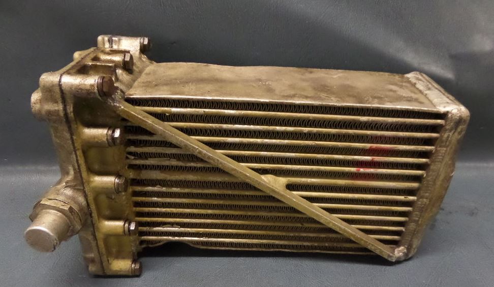

I have a large oil cooler and plate which I believe was used in original GT40s back in the day (Continental IO-470) - see pic. But, I'm thinking I might want to use a cooler with a fan rather than just passive/ambient cooling like this one. I'm concerned about:
1. flow capacity - I don't want to add in a cooler and plumbing which somehow diminishes flow rate and capacity, and starves the engine for proper oil flow and pressure,
2. having the oil stay cold for an extended time during warm up - ie. do I need an oil thermostat plumbed in because I've just added a huge heat sink system essentially?

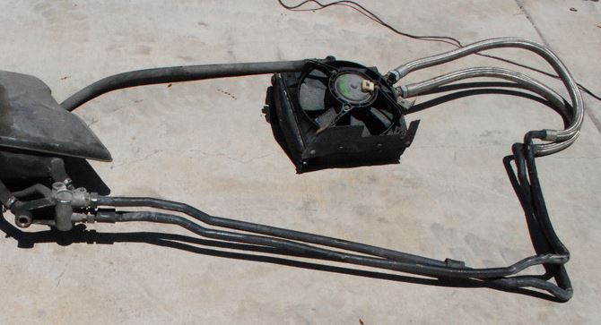

I like the oil cooling systems on air cooled 911's from the 80's with the RF fender mounted coolers with a fan and a thermostat (see pic). Wondering if that may be a good design to replicate (and use parts from).

3. If you go for the old school fender cooler, you may want to look at some of the ones that the original 40s used(street versions). There lines are big enough for your requirements. The heat from the radiator(in this setup) will essentially preheat the oil for you. These are for the 289s, so I would think it should work for a 302.

Bill, I'm not seeing how you can "pre-heat" the oil as shown in that picture, either. On a cool day, it will take a while to get heat out of the water radiator, as it is.

Just curious, will the adapter plate and bypass shown on your Continental IO-470 cooler work as is or are modifications needed? The last adapter plate I ran into did not appear to be plug n play...

If you notice that on the original 40, the cooler is behind the radiator. I don't know about your individual cars , but on mine, the water temp comes up way before the oil temp does(granted mine is measured in the sump). Some of that water temp is transferred to the oil cooler early on. Remember, heat travels from hot to cold. It may not be a lot but it does happen.
I recently purchased an ERA car and notice that they cool the oil with a self contained unit that attaches to the left rear on back deck. About 16 inches square. It has a thermostat controlled fan to cool the oil when needed.
