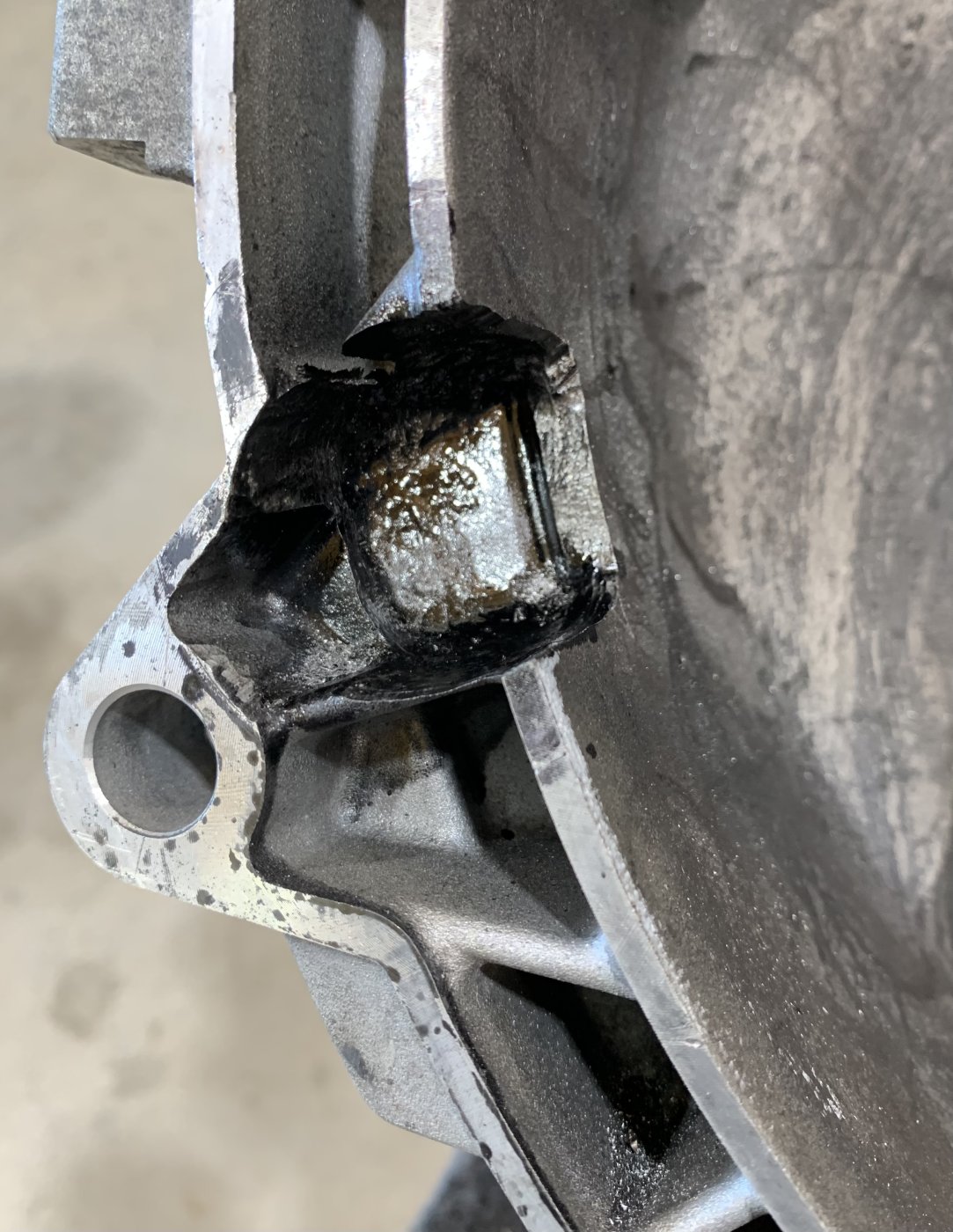

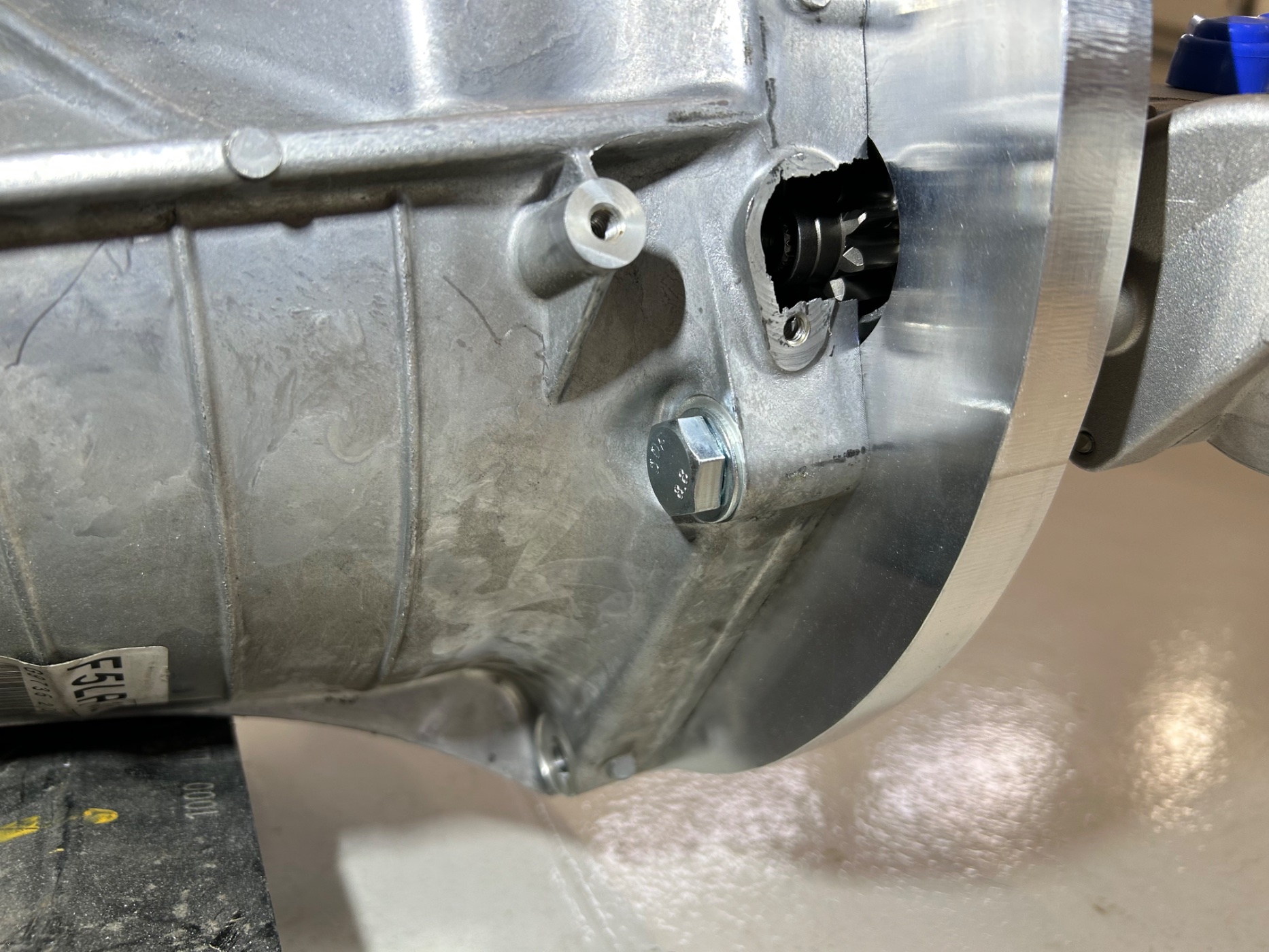

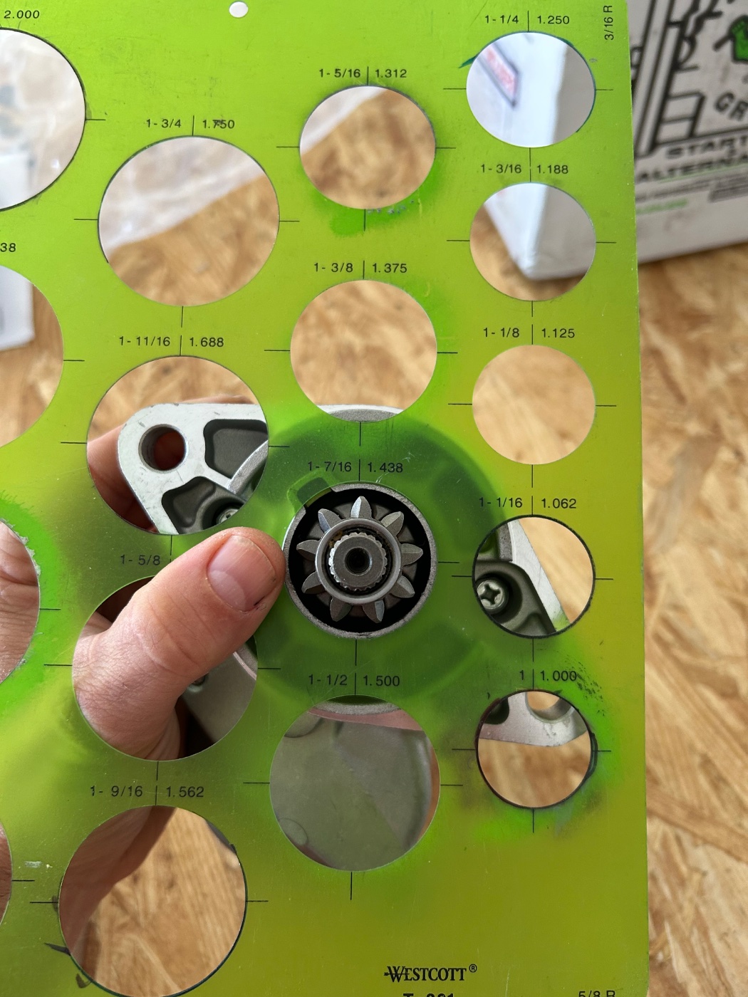

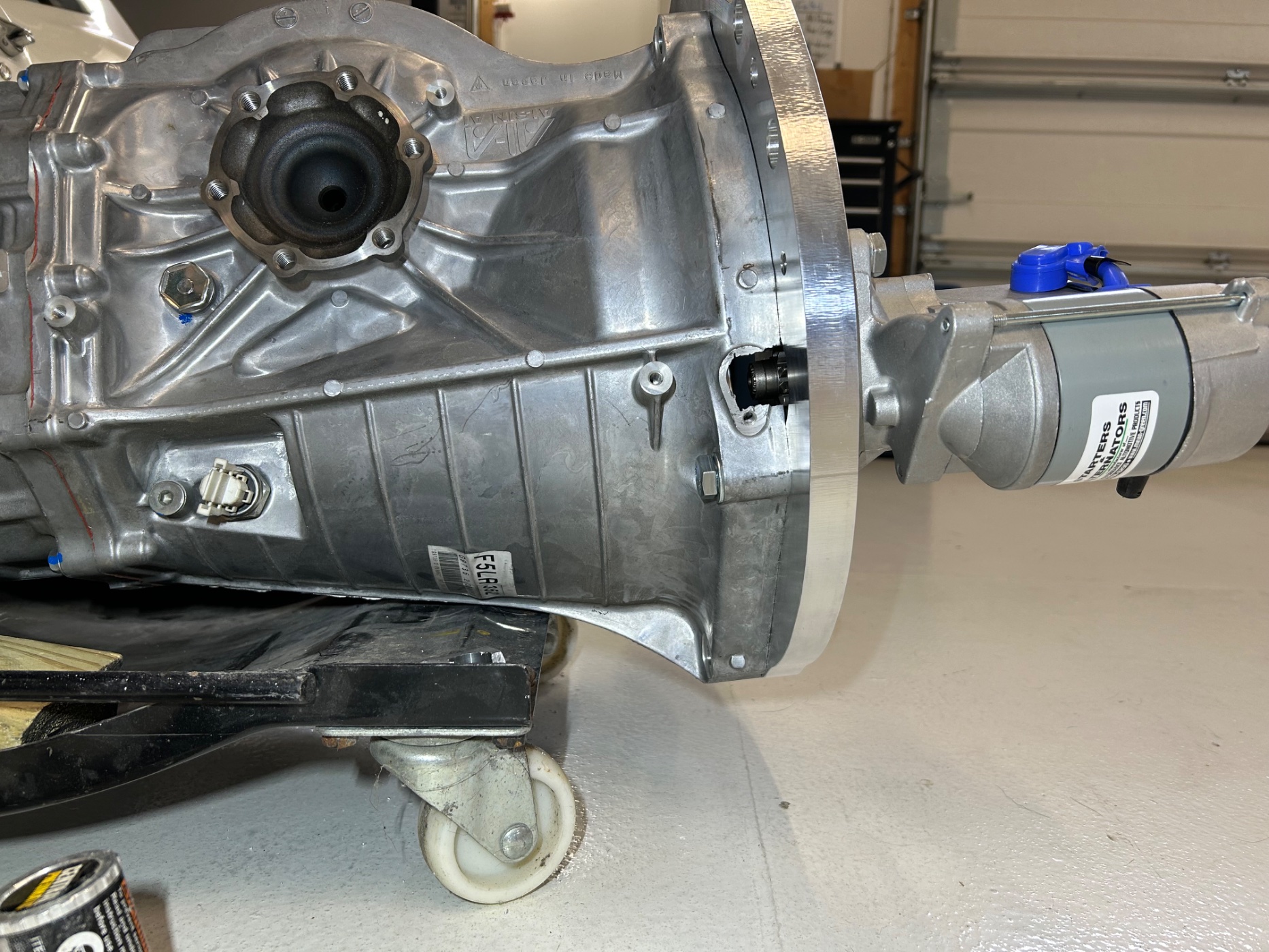

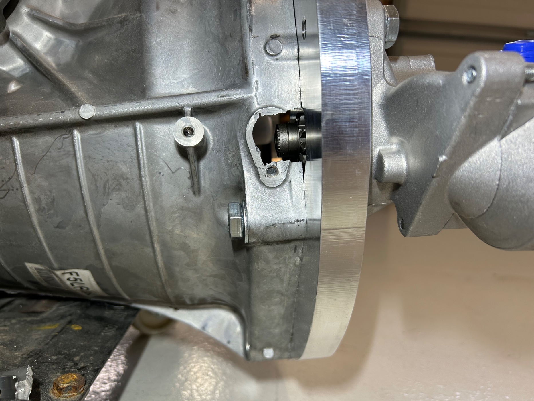

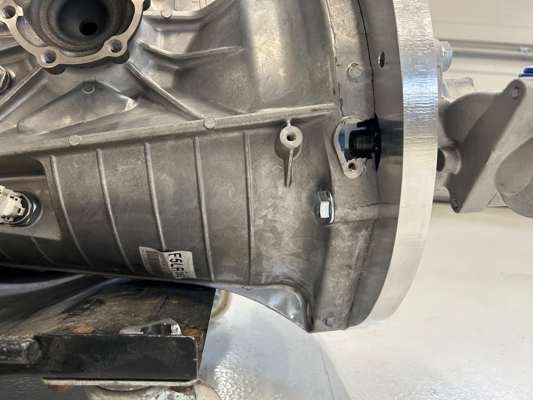

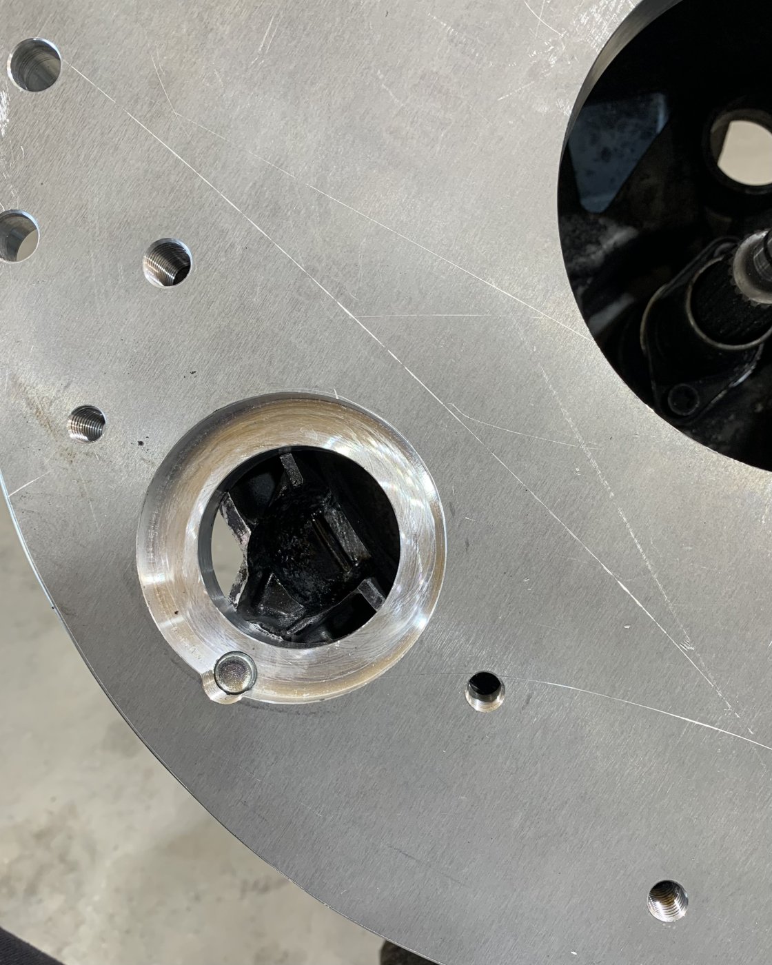

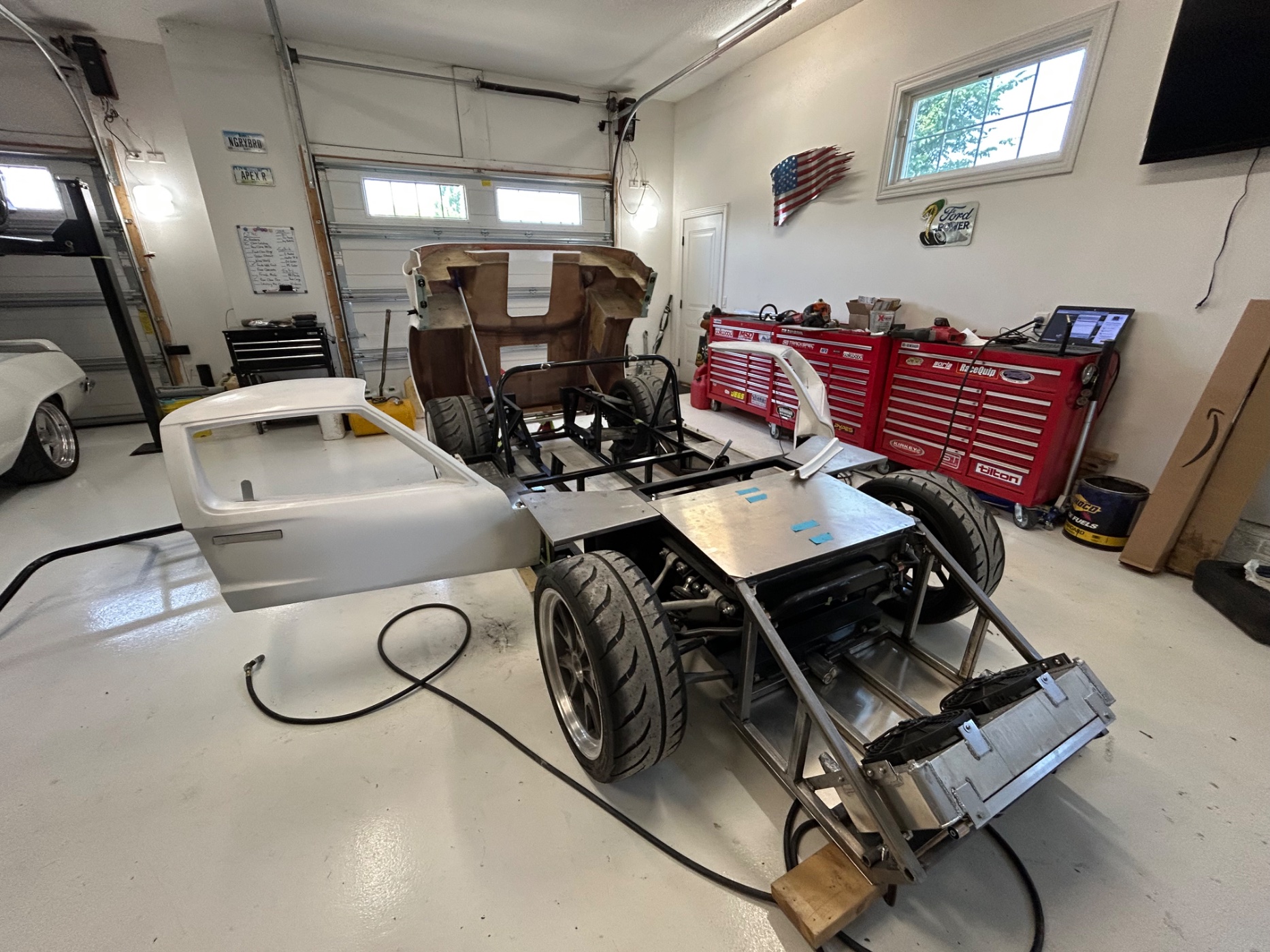

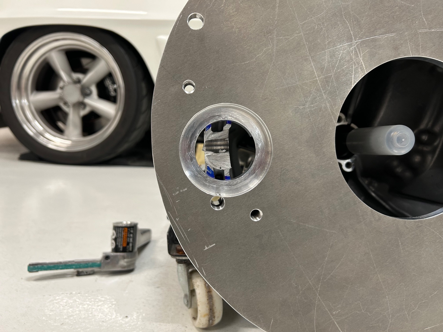

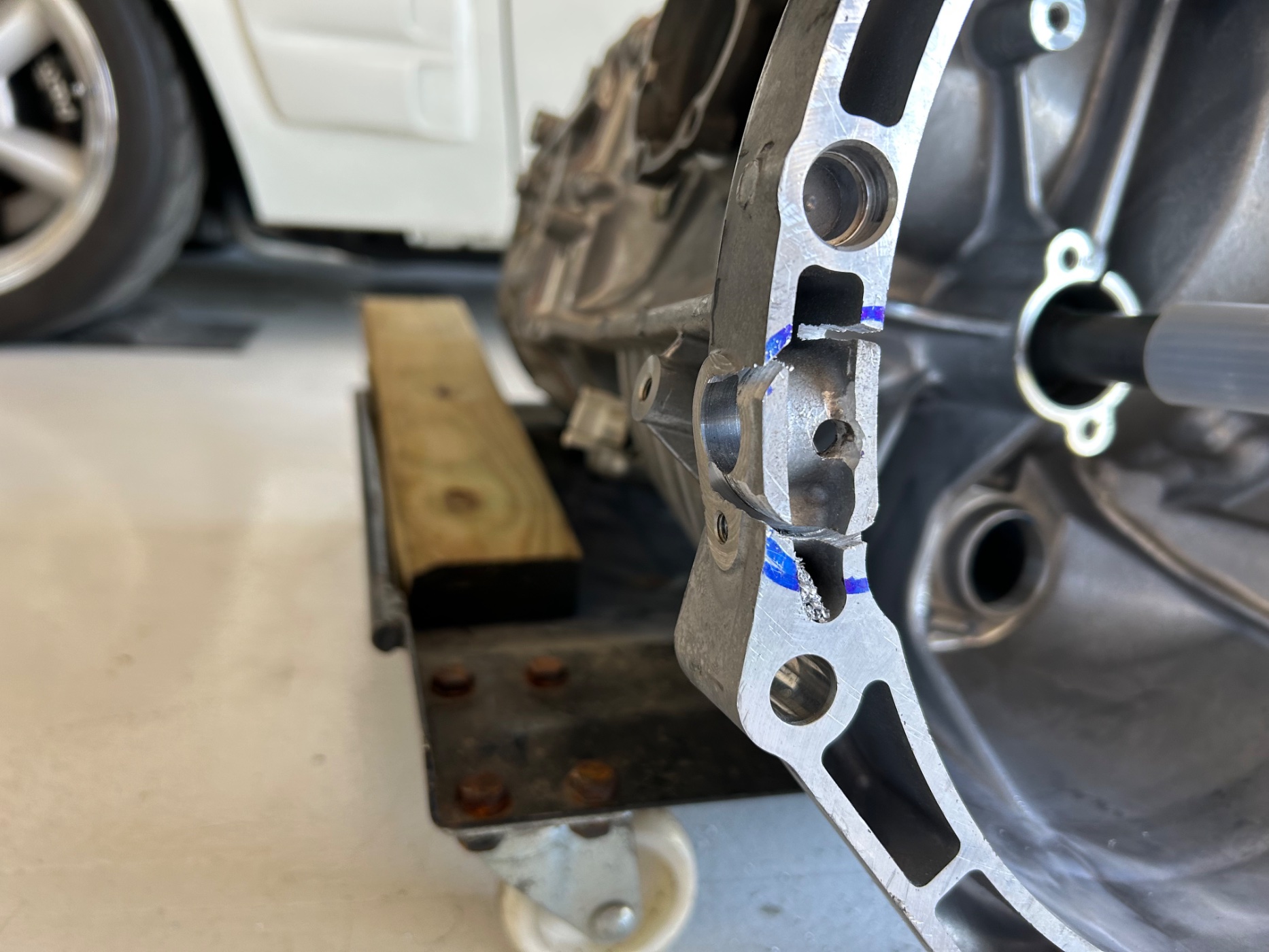

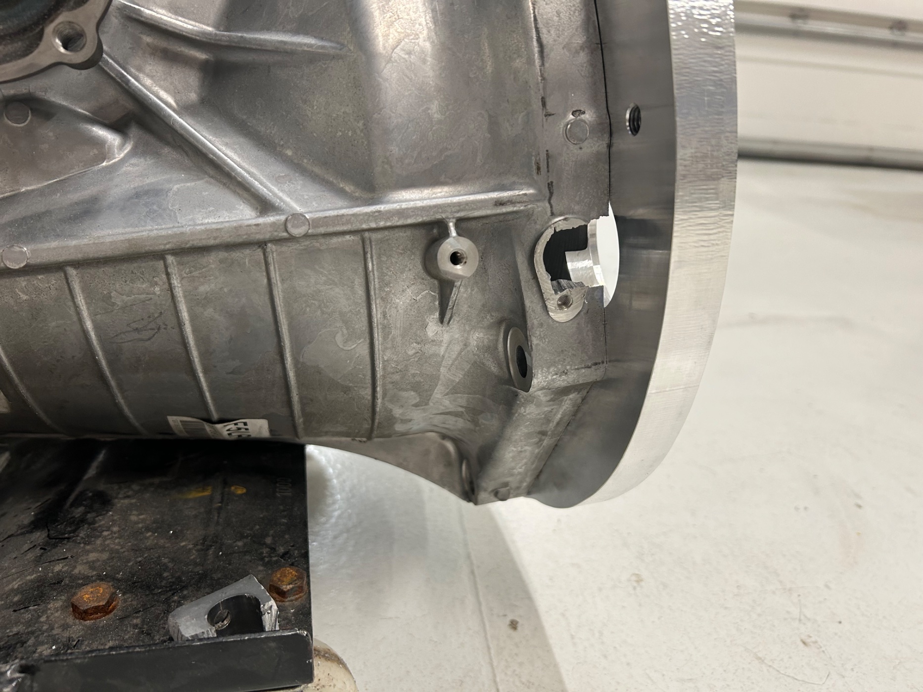

For a change of pace, I decided to start cutting up a brand new Porsche trans. I’m gonna call the starter manufacturer to see how far the starter gear goes out to see how much more grinding is needed.
…And then back to finishing off the inner wheel wells.View attachment 147263View attachment 147264View attachment 147265View attachment 147266View attachment 147267View attachment 147268
Joe, I ended up just bolting the starter to the adapter and jumped it to a spare battery to see if there were any clearance issues. Yours looks deeper than mine but I can measure if you would like.

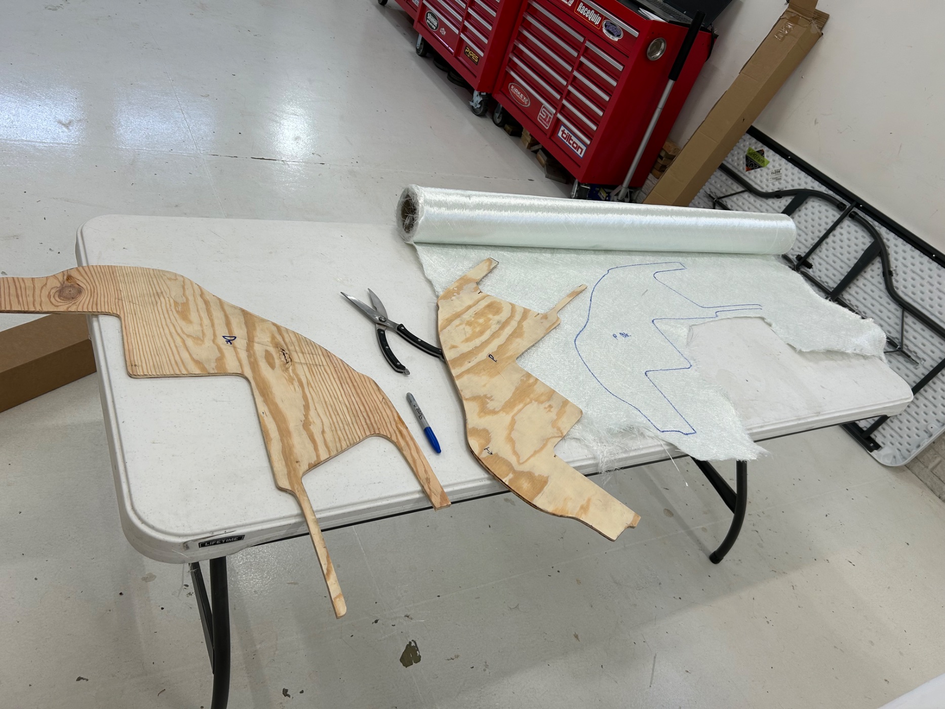

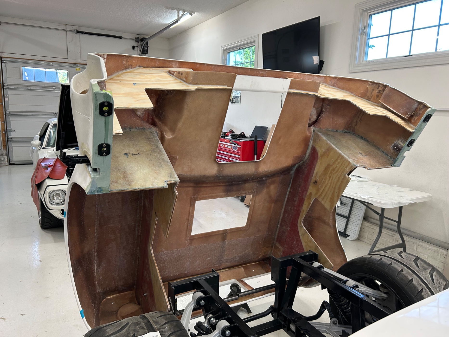

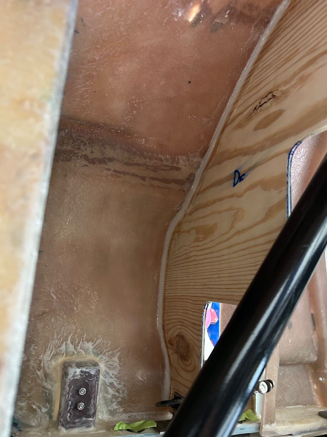

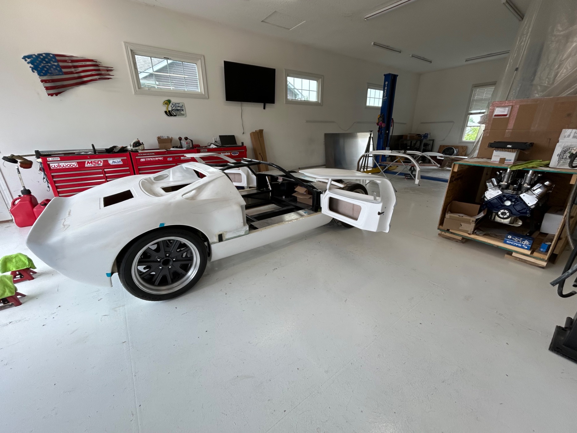

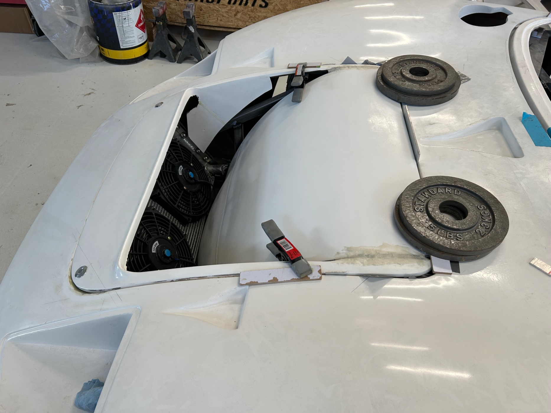

It’s amazing how long some of these individual projects can drag on. I started making mock up panels on Thanksgiving Day. Finally got the front panels tacked in today with epoxy. I’ll finish filling the remaining gaps after the first round sets up with the clam latched into place.

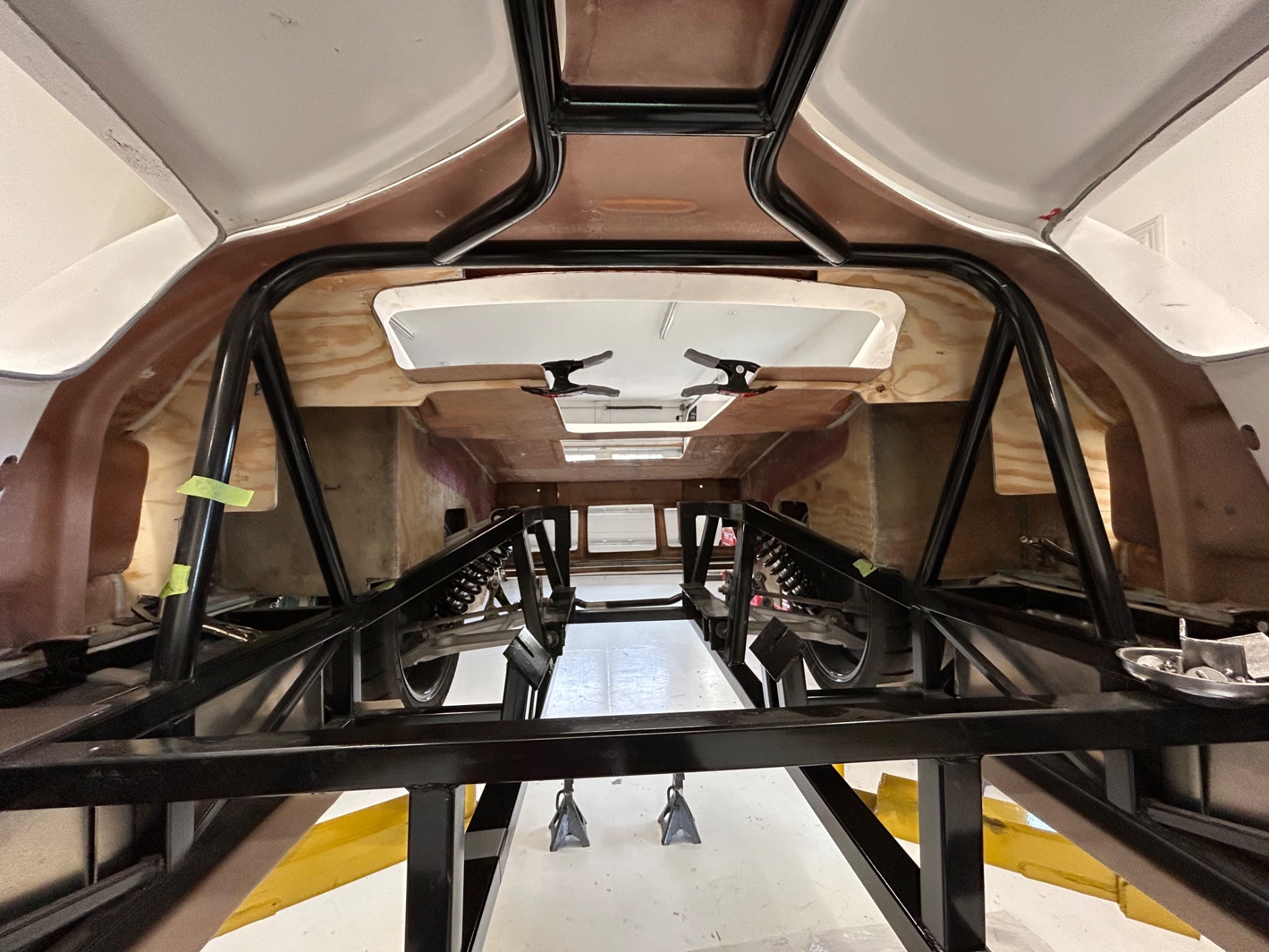

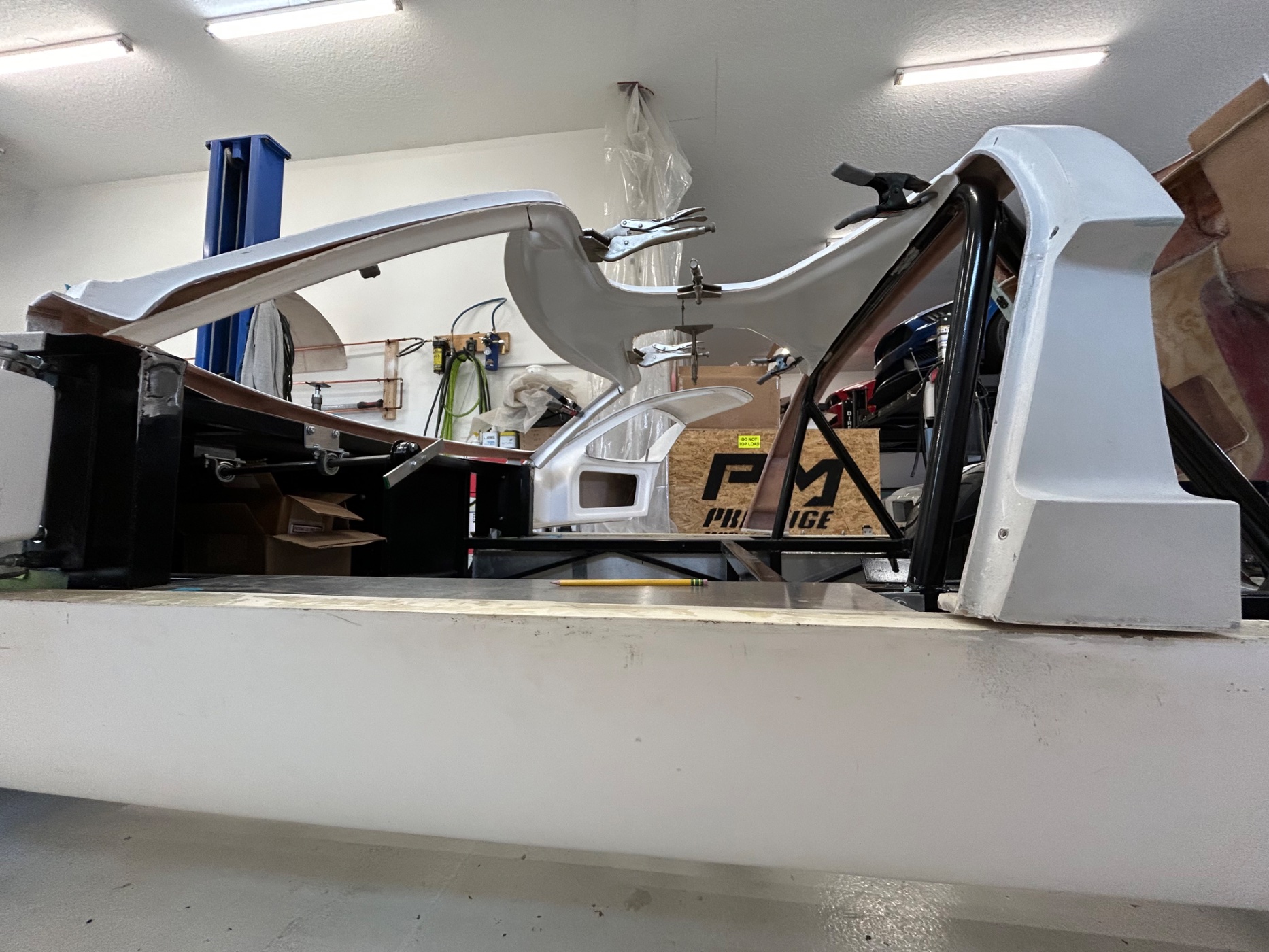

Rear clam is stiff enough now that I can open and close it by myself. All 4 locating pins hit at the same time. I’m going to use a single center hood pin for the top.

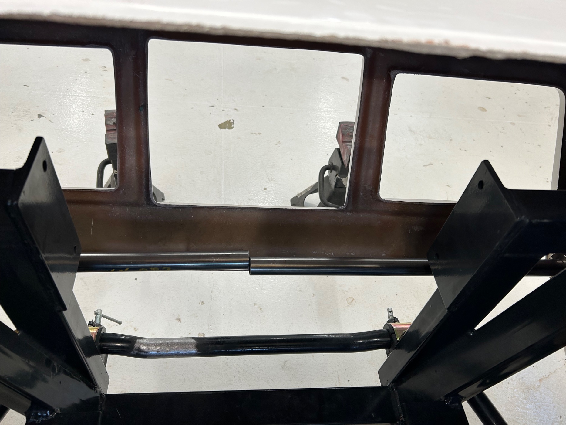

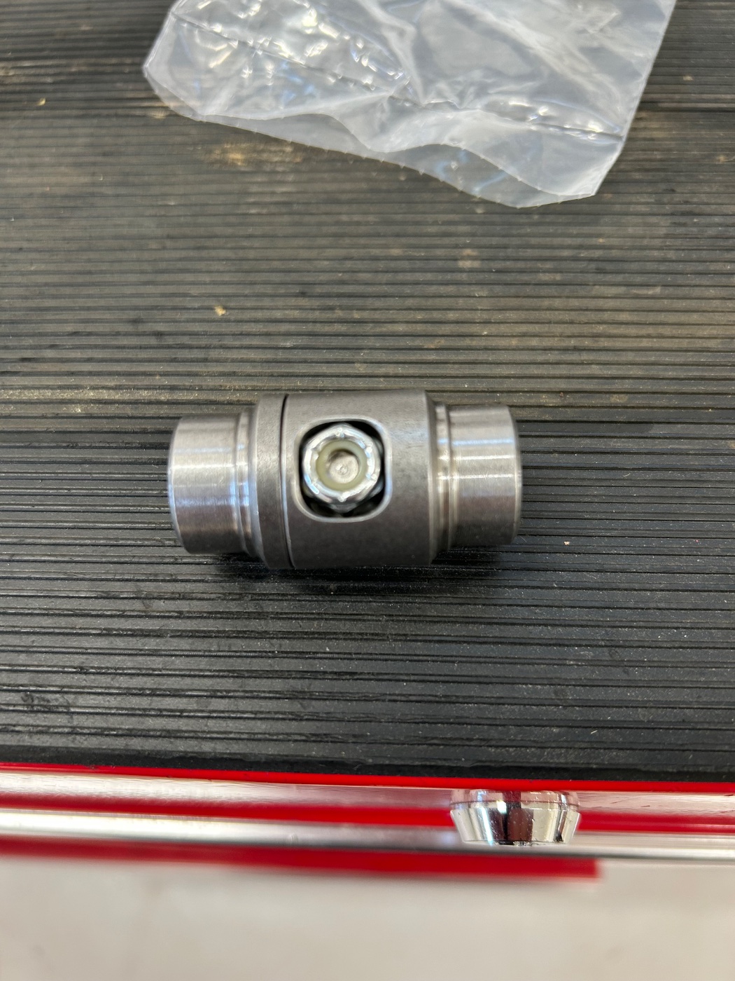

The rear hinge will now be 2 pieces, after I weld in the coupler. It was impossible to get in when it was 1 piece…and it will only get worse after I finish off the wheel wells with Raptor Liner.

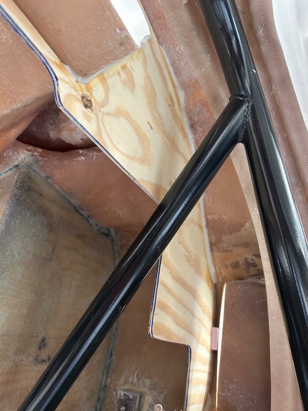

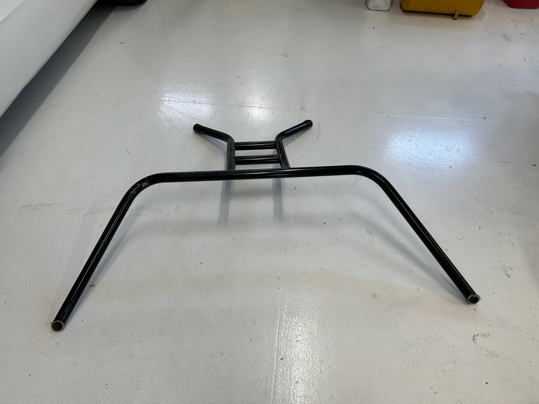

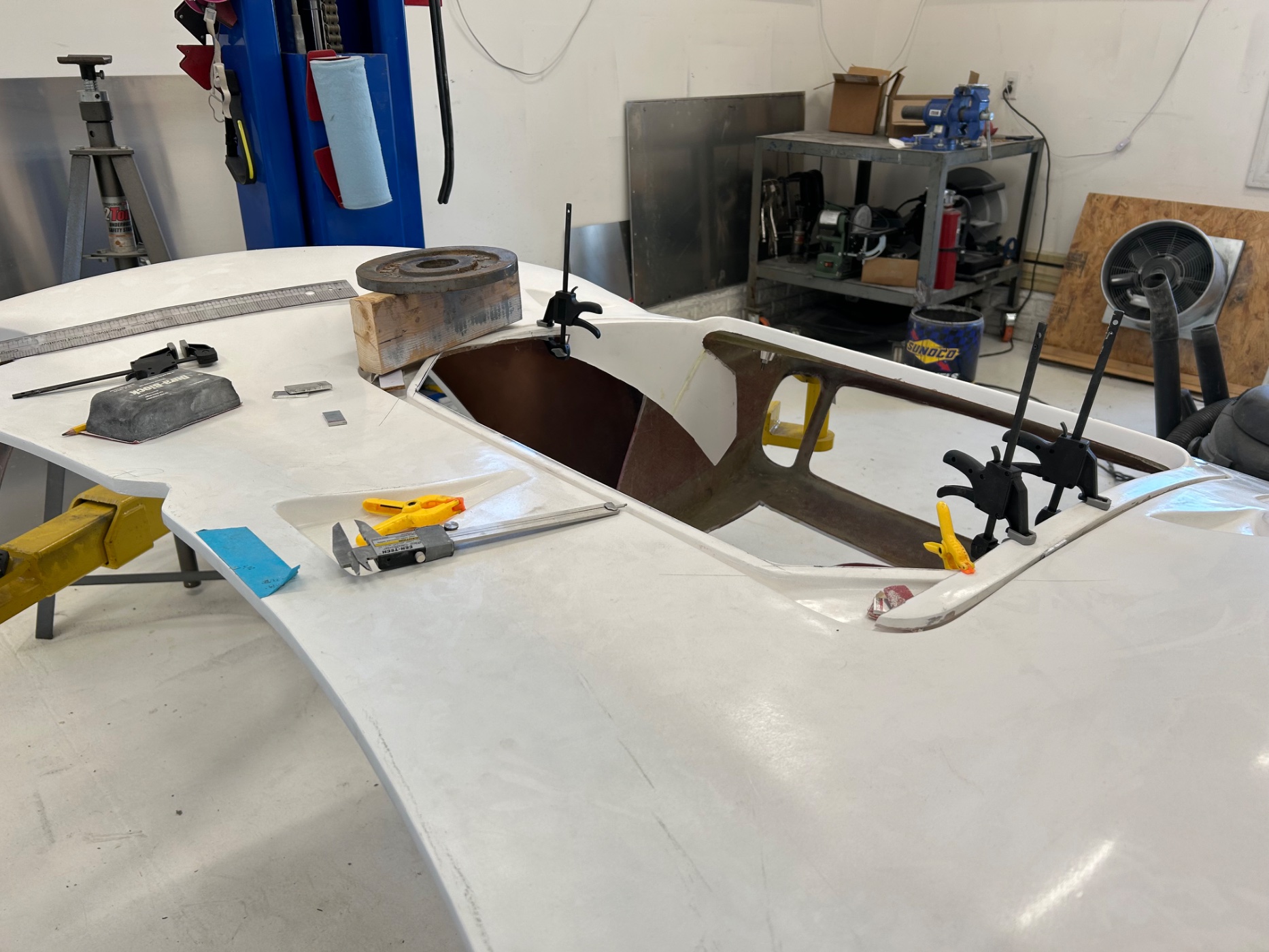

Sure glad I paid for the roll cage option. If you get that, the spider is shipped with no inner structure and is flimsy as hell. Chris’s had an inner panel and inner a-pillars that he cut up and shipped to me. I’m going to fit the inner panels to the spider and get it roughed in before bonding the inners and the spider. Then I’ll make my own bars that will work with the new spider. I may be able to use the original front hoop.

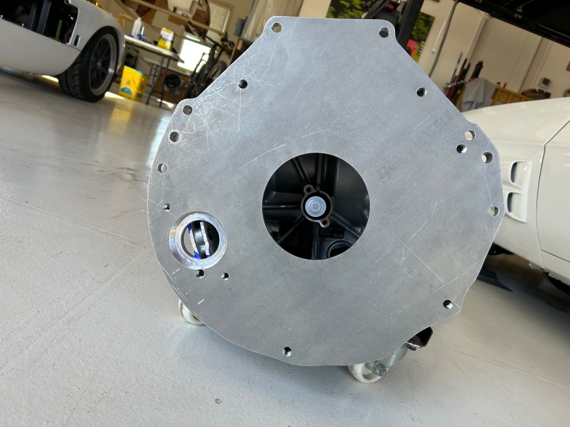

I have only mounted the adapter plate and starter to the trans. So far, so good. I haven't finished grinding out the starter area yet. I'm thinking that I am going to build a firewall similar to a Tornado, as the AP cars ship with aluminum fitted, but no inner structure, besides the roll bar.
I'm having a flash back to when I replaced the roof on my 69 firebird. Clamps won't be in short supply!

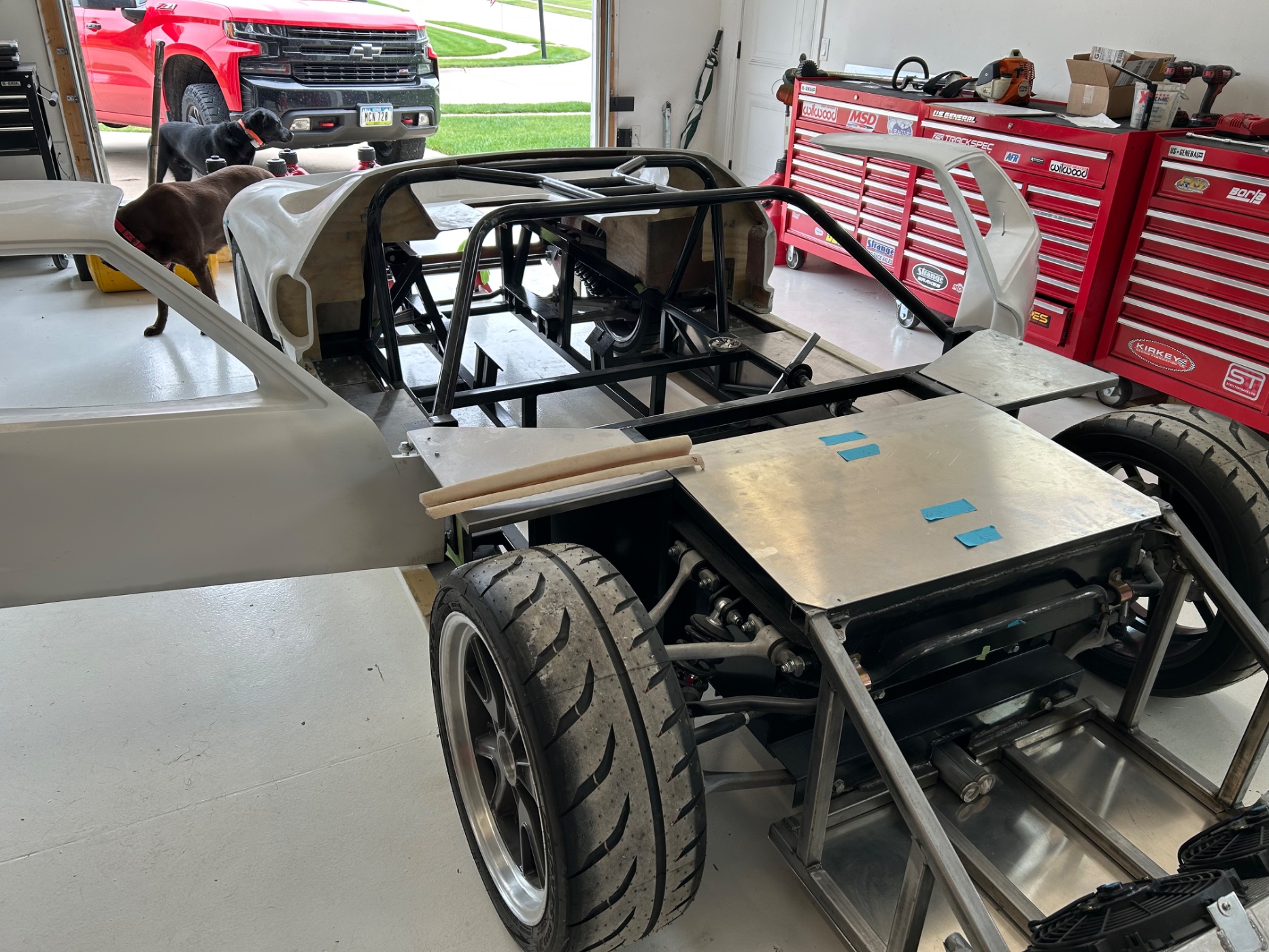

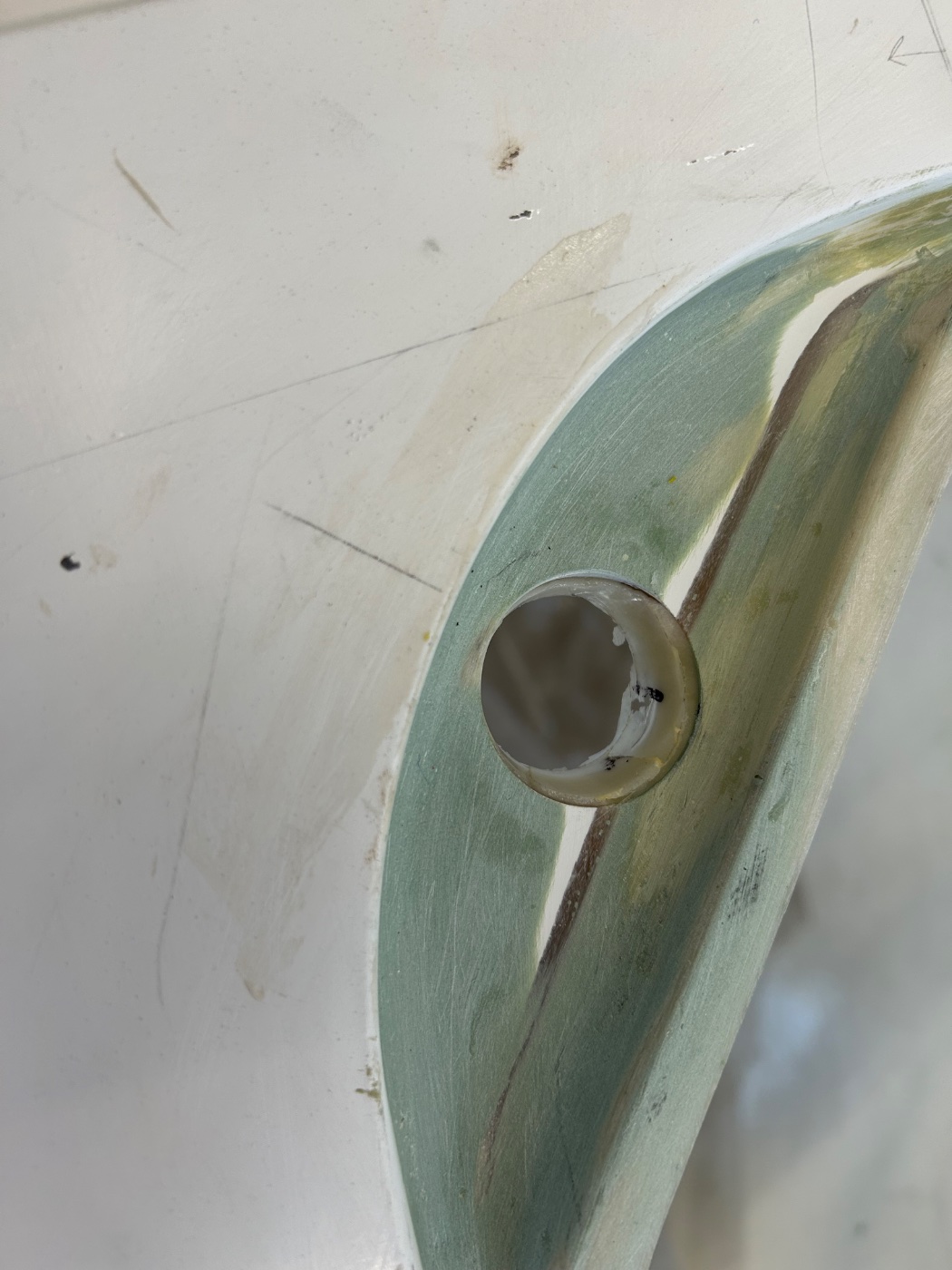

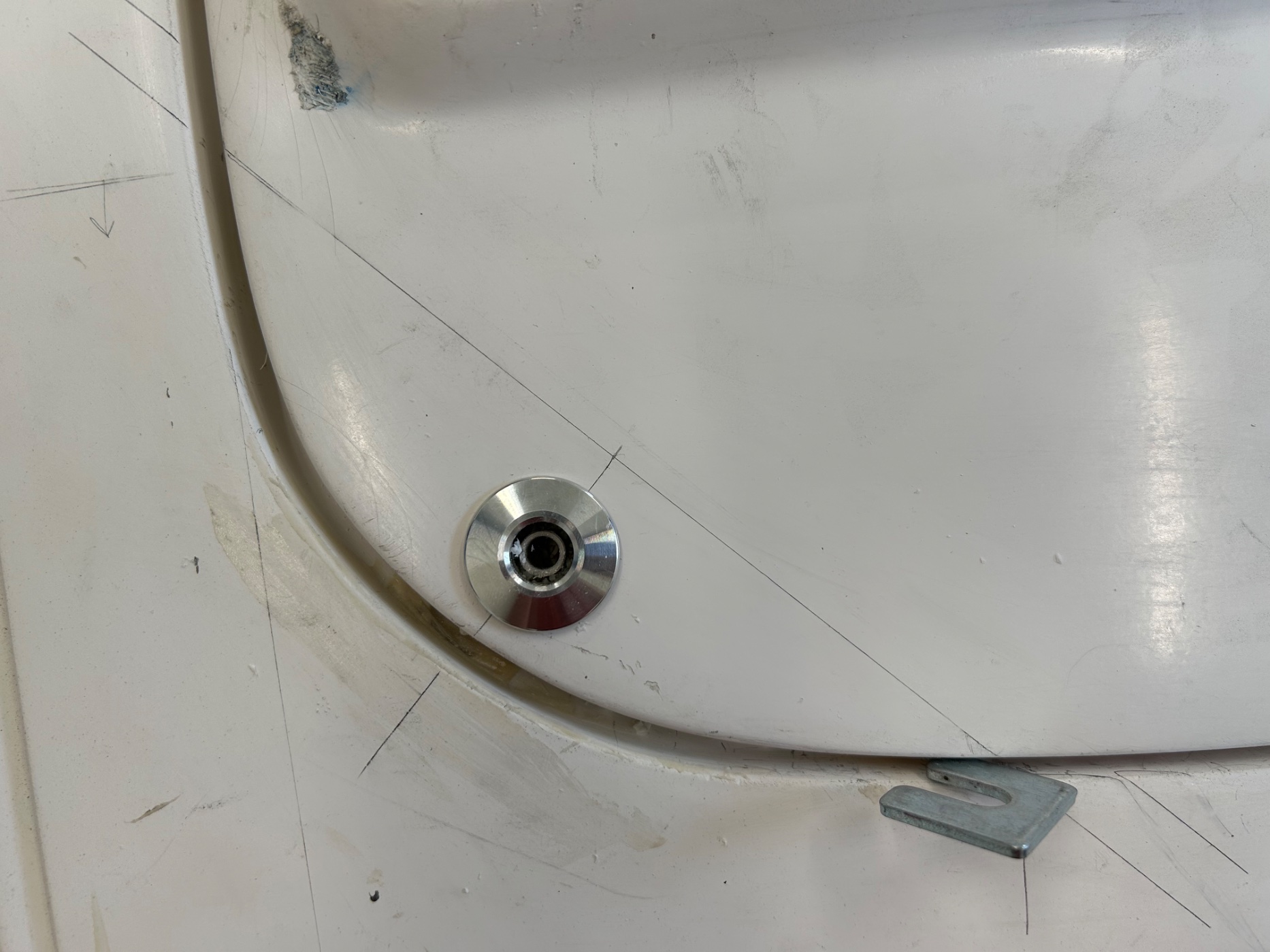

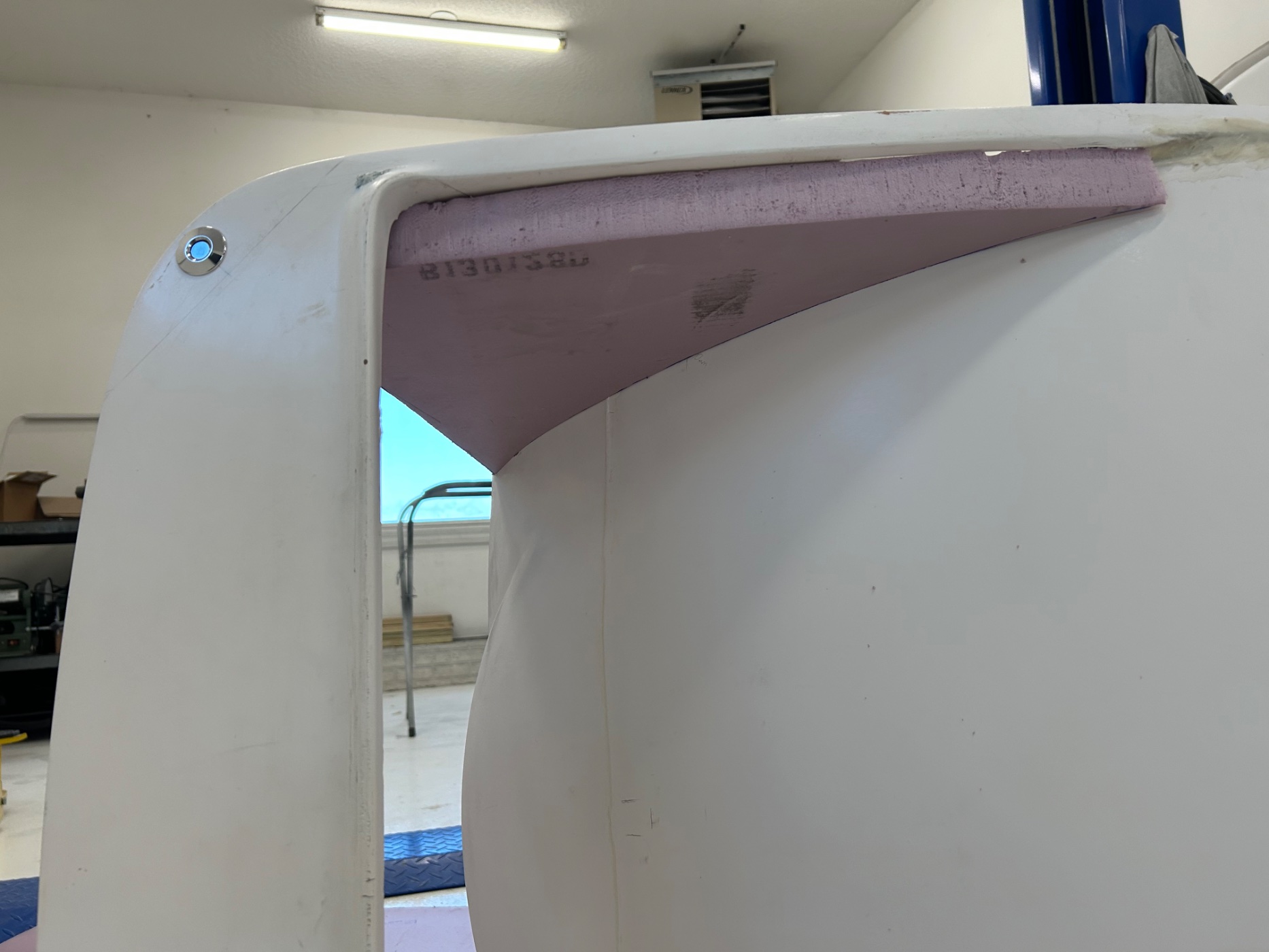

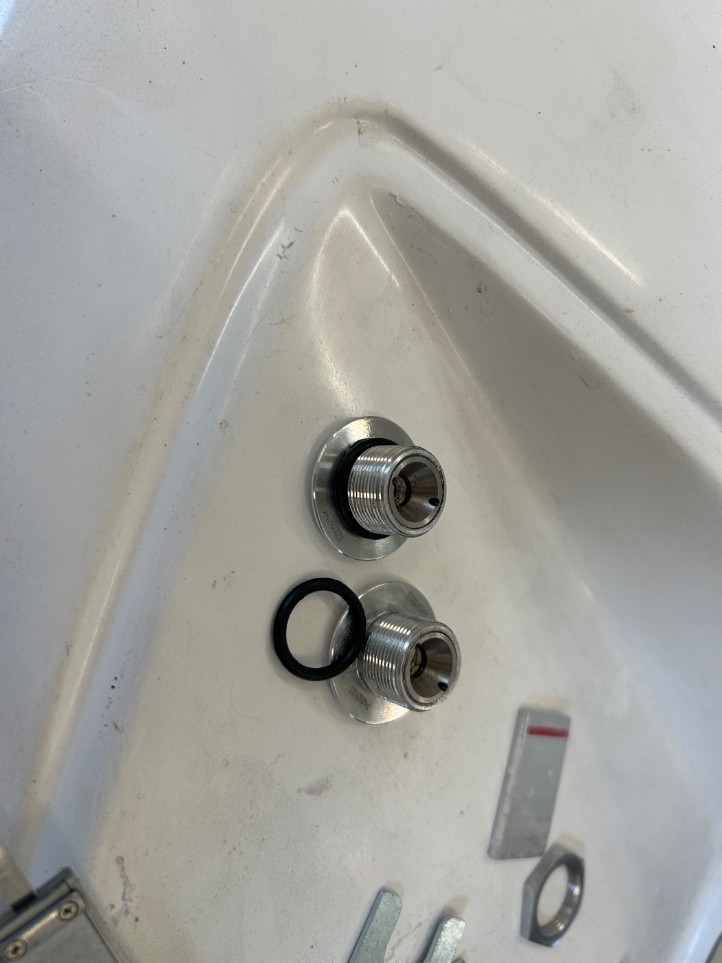

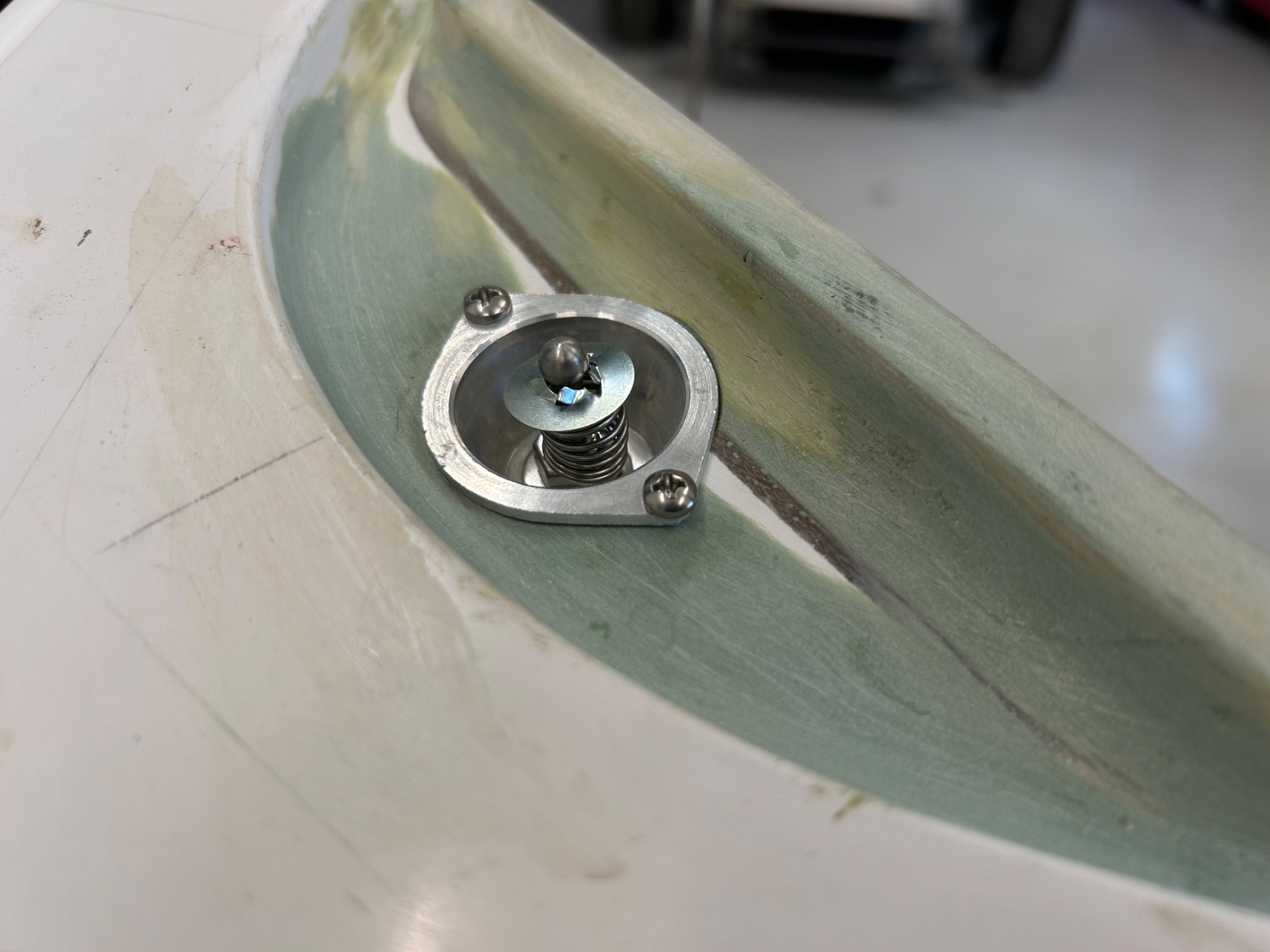

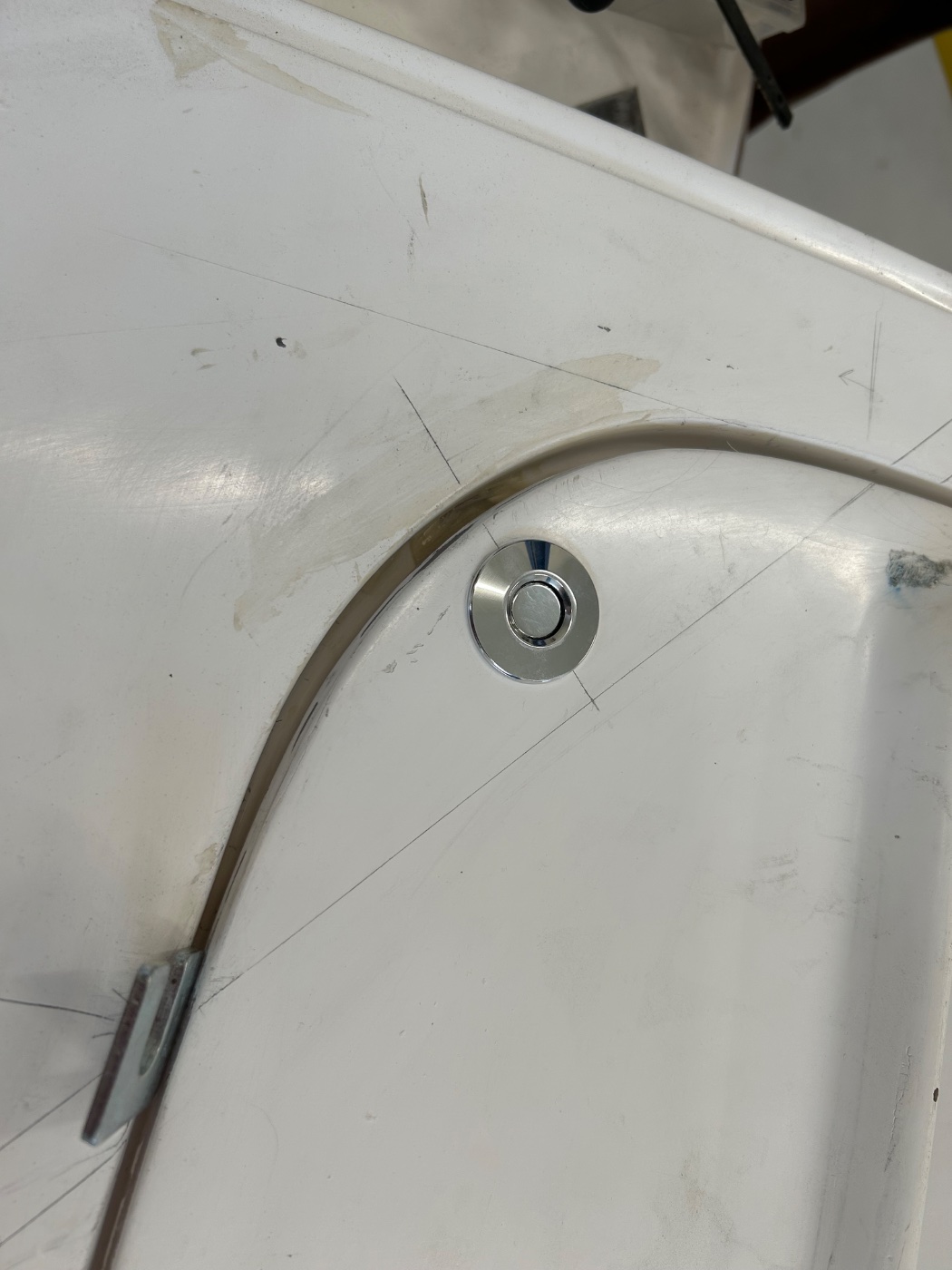

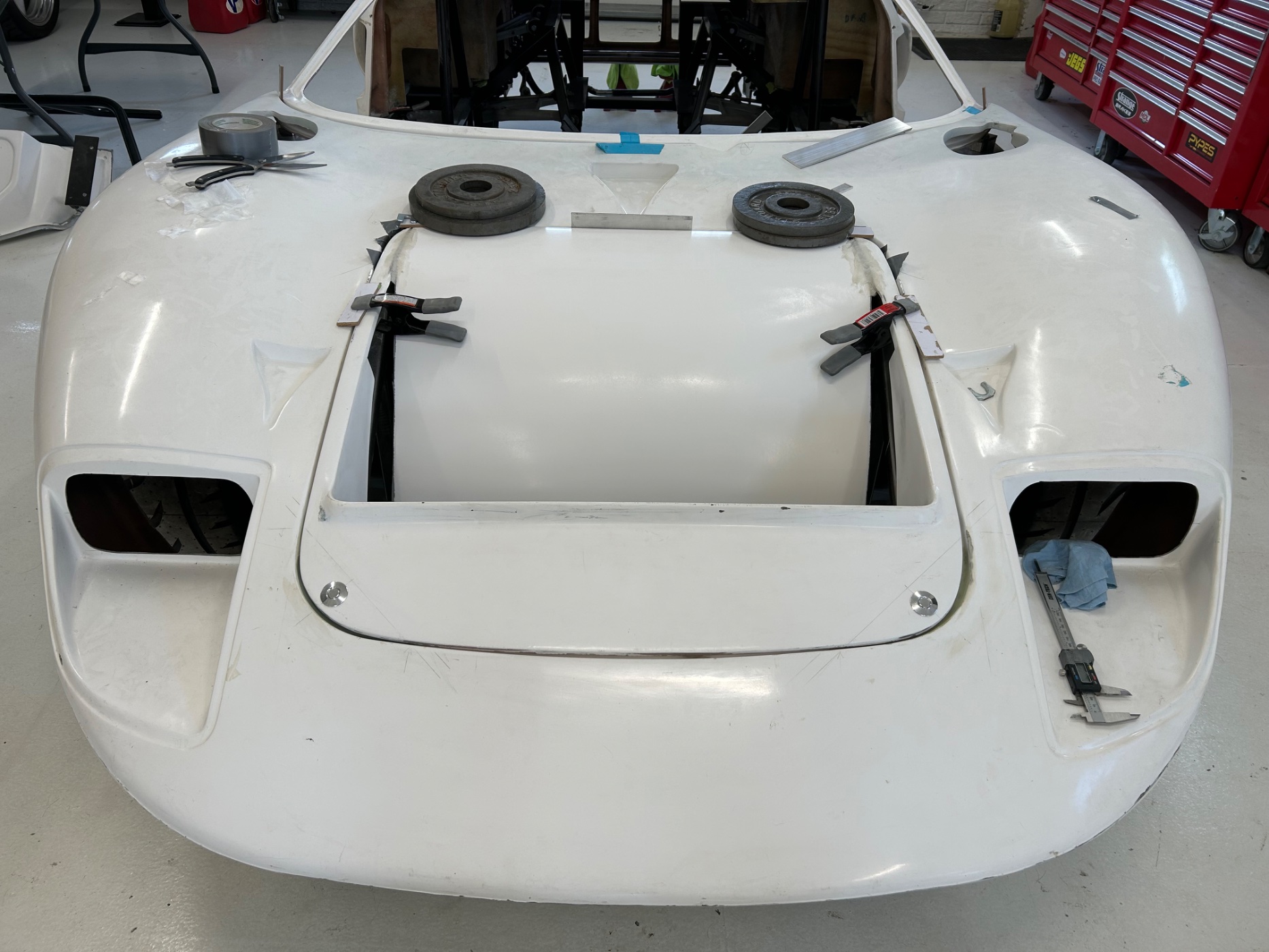

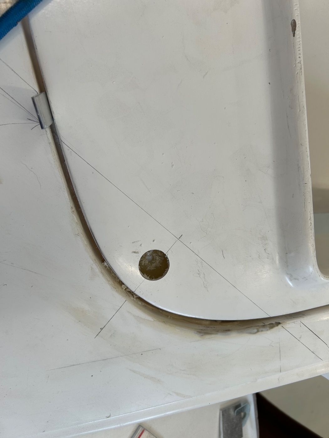

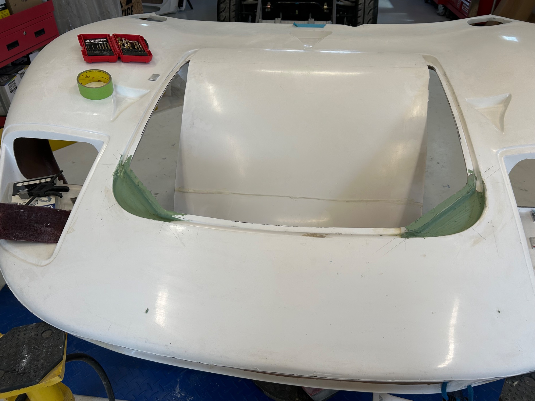

Decided to take a brake from the rear and move to the front of the car. I think I have a plan to get the front cover back to one piece and get the depth of the snorkel set and paneled off. 1st step was getting the corners set. A final gap of 1/8" was taken into consideration when measuring for the buttons. I went with the name brand ones since I've heard nor so good things about the Amazon/Ebay variety. Of course, my Harbor Freight hole saw made the cup hole too big,so I did a press fit with some thickened epoxy.

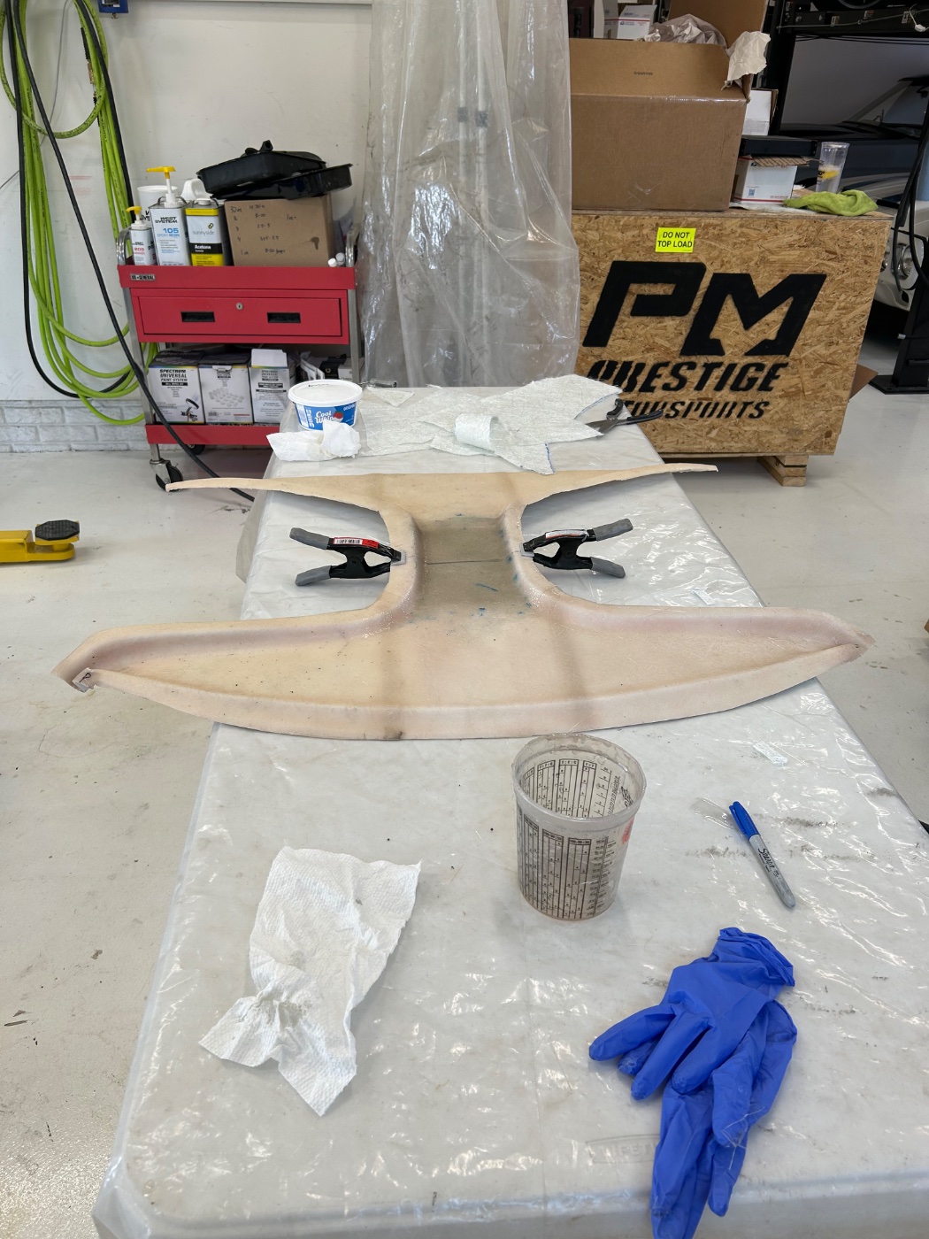

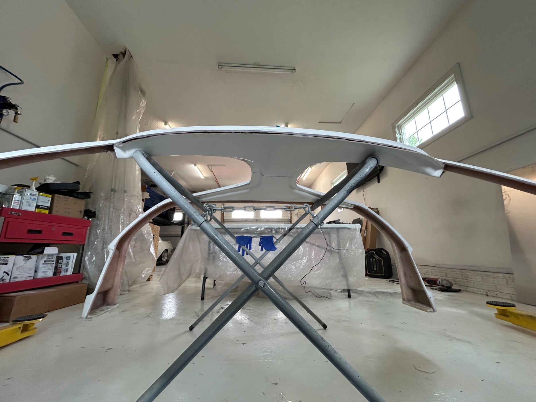

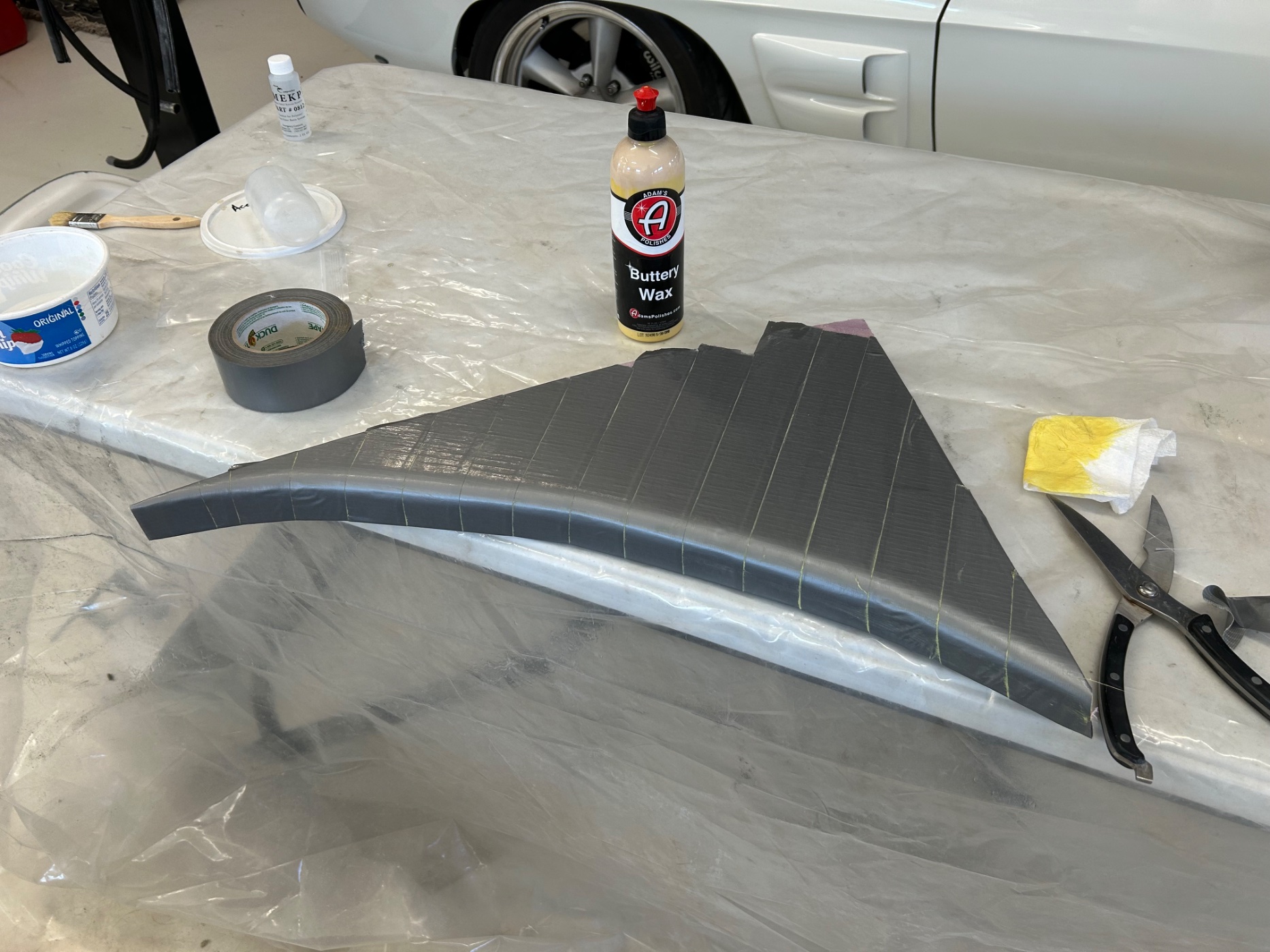

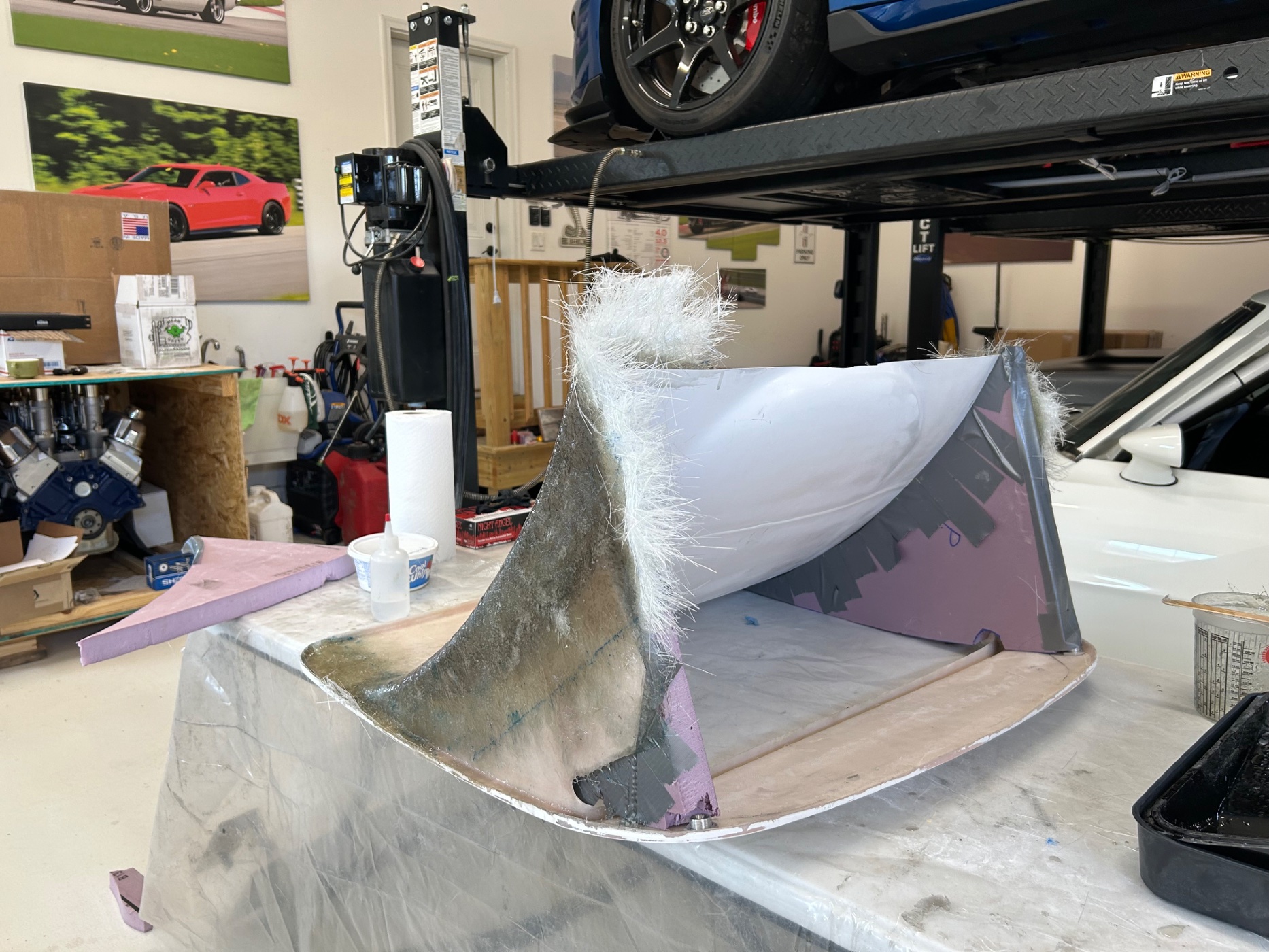

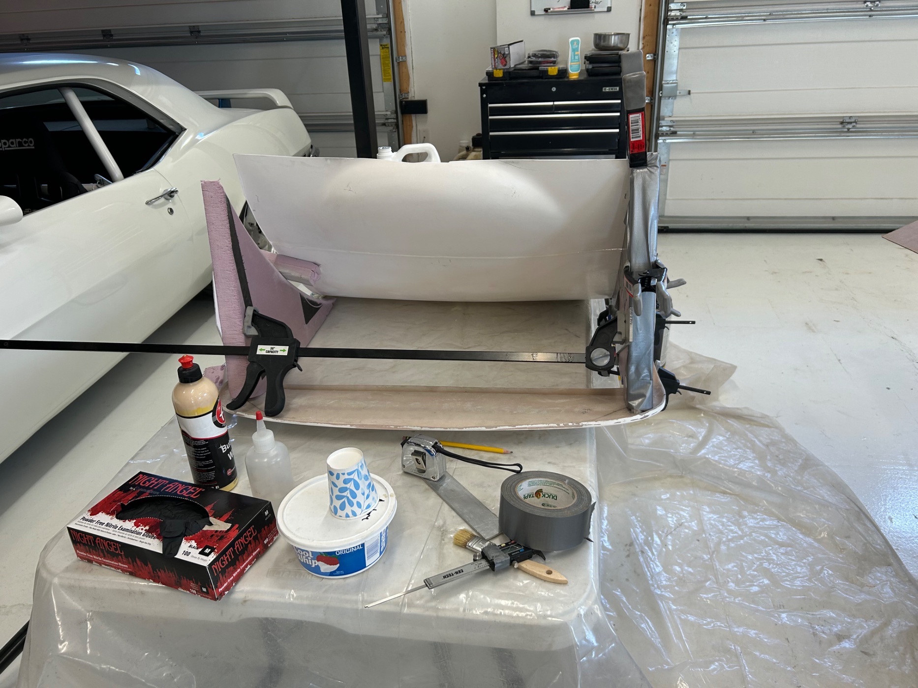

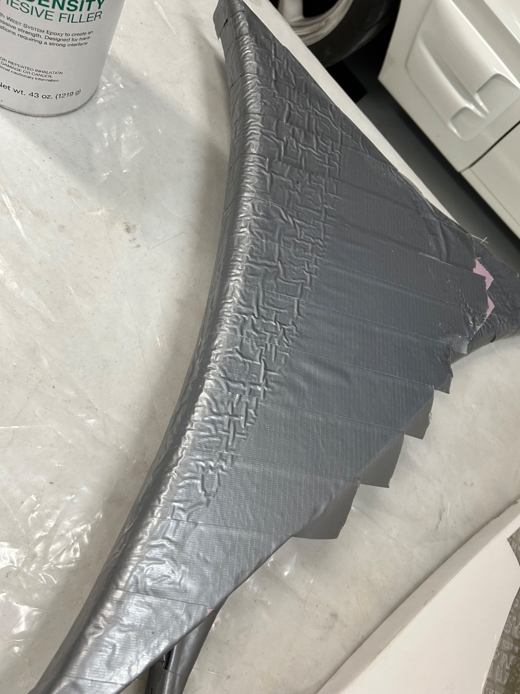

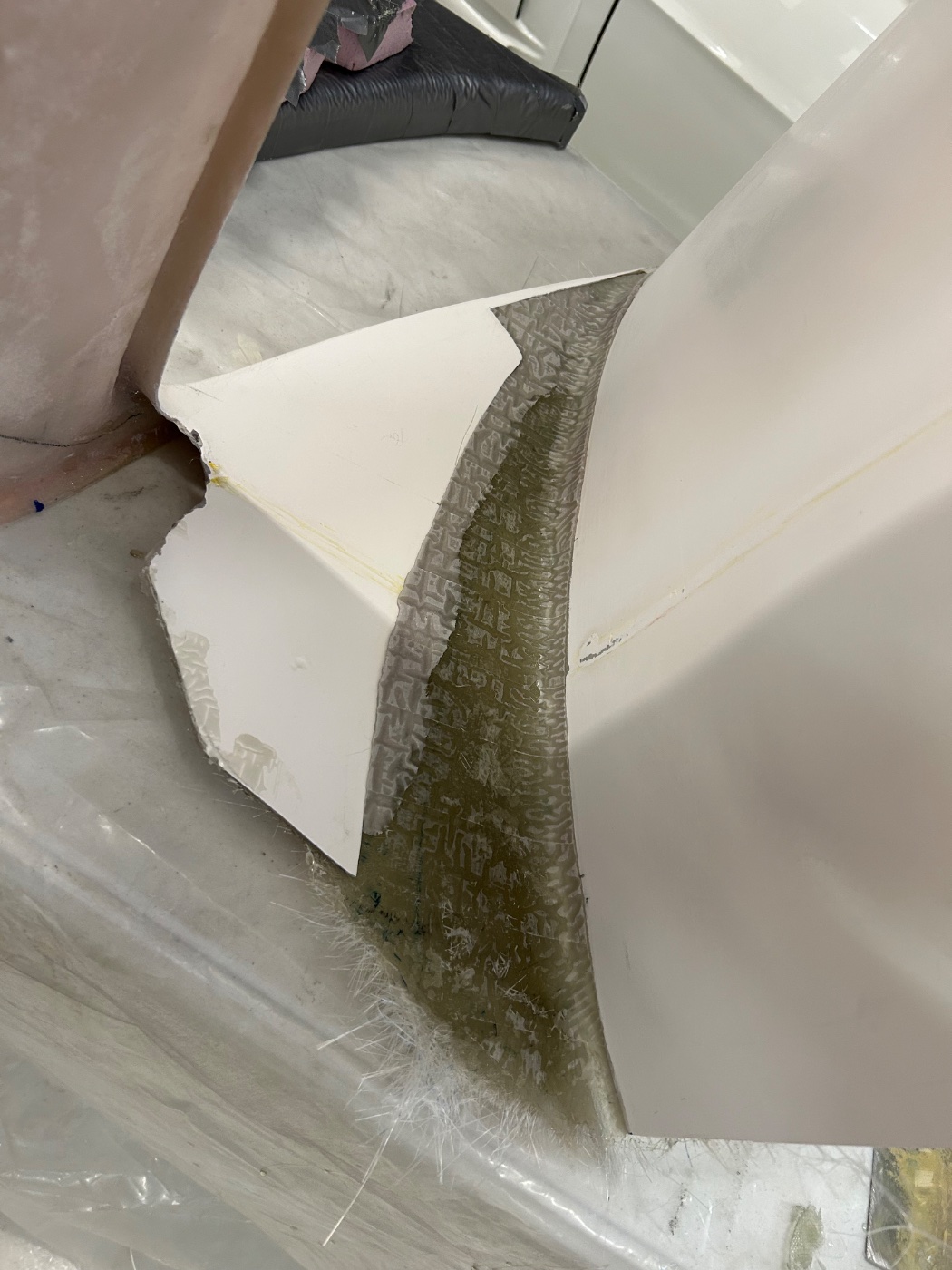

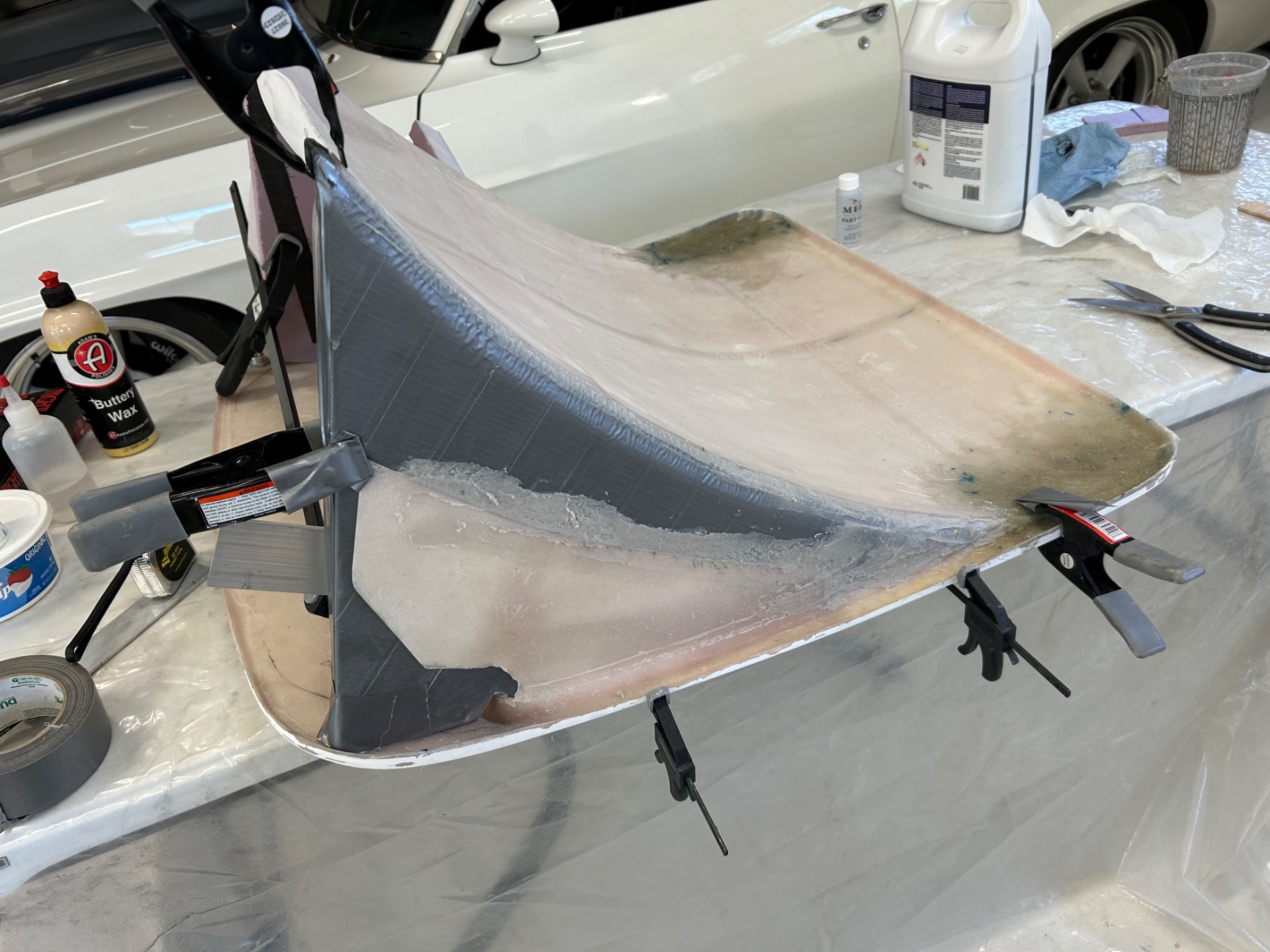

Moving forward. When I started to hack this thing up last winter, I was a little worried about if/how I would be able to get it back together. It’s back in one piece after first bonding the piece together with thickened epoxy. After that hardened, I ground down the excess on the underside and put 3 layers of glass. I will probably make a styrofoam and duct tape buck for each side to get the curve set and filled in.
Chris Kouba
If you're not using epoxy, you'll want some sort of protective coating as a barrier between the resin and foam. Otherwise it will melt it and the effort will be wasted.
I plan on wrapping it with duct tape. I’ve been applying a thin coat of regular auto wax to help with release. I always hit the area with wax and grease remover when I pull the mold.
Aluminium tape works wonders.
It also does make the step of release agent obsolete unless you have negative curves.(Resin will not bind to the aluminium very good, which means that the release is possible without an agent)
Yes, I’ve used that too. I think duct tape is easier to lay without wrinkles.

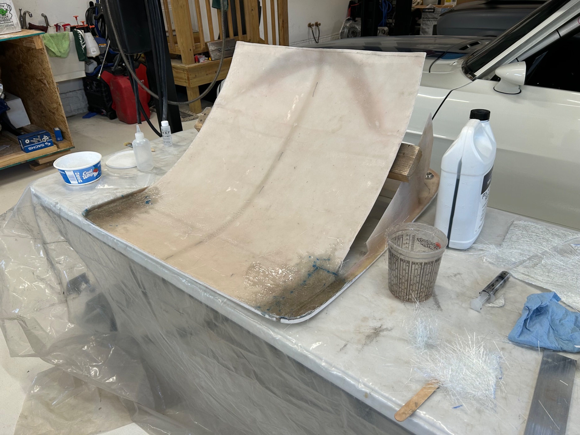

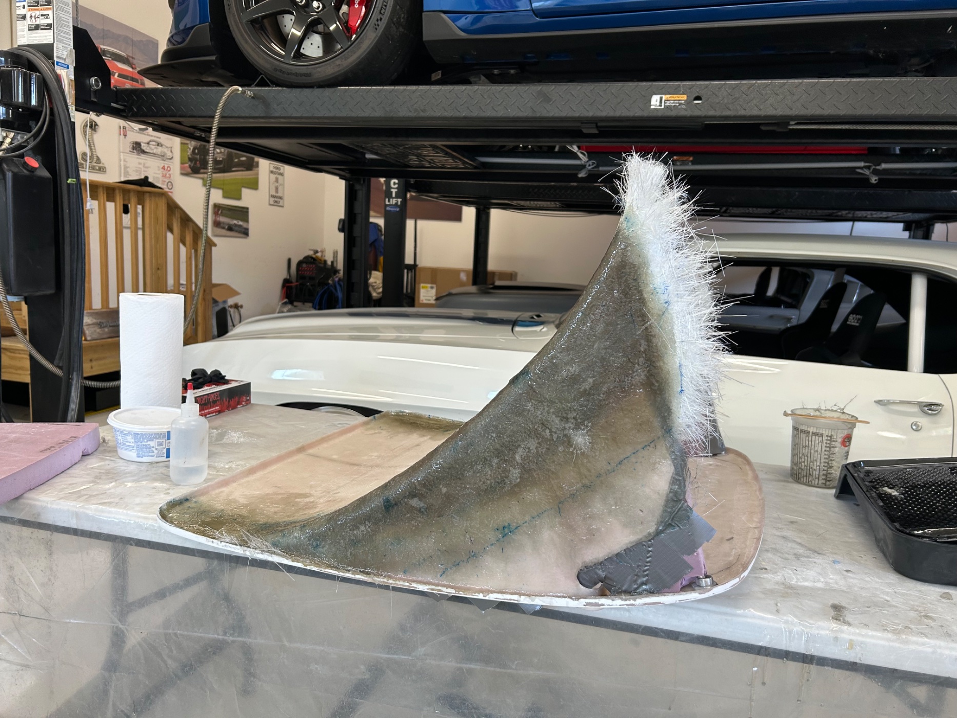

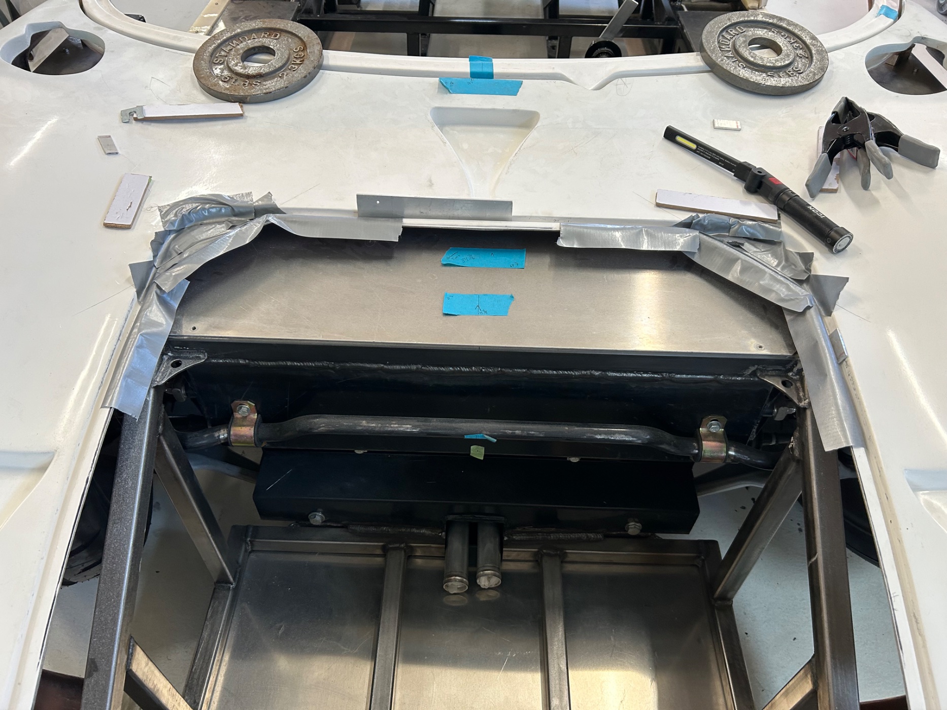

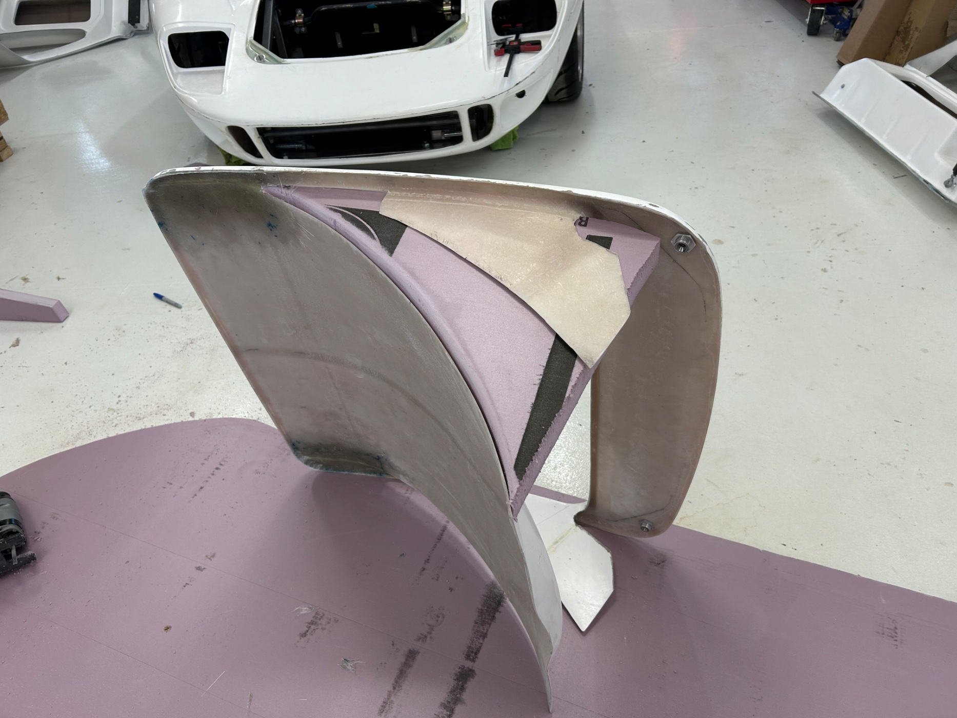

Side 1 done. I started with a transition of thickened resin.

Now that I think about it, I’ve only used duct tape with epoxy. Luckily, the tape held up to the resin, but it wrinkled. I thickened up some finishing resin to smooth things out. Ready for trimming and filler.
Brian
It's impossible to apply on compound curves, but I always use packing tape. Epoxy doesn't stick to it and it's thin enough the overlap doesn't show as bad as duct tape.
If I'm vacuuming it, I'll use trash bags or poly.
