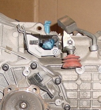

My 01e has a plastic slave cylinder retained by a single bolt. The body of the slave has a rubber sleeve where it enters the bellhousing. Remove the bolt and slide the metal the metal retainer off, twist the slave slightly to clear the retaining step on the transaxle, and it should pull right out. Here's a photo (ignor the blue tape)

All 01E's have a bolted in slave. If yours is held in by a pin it's an 016 transmission.

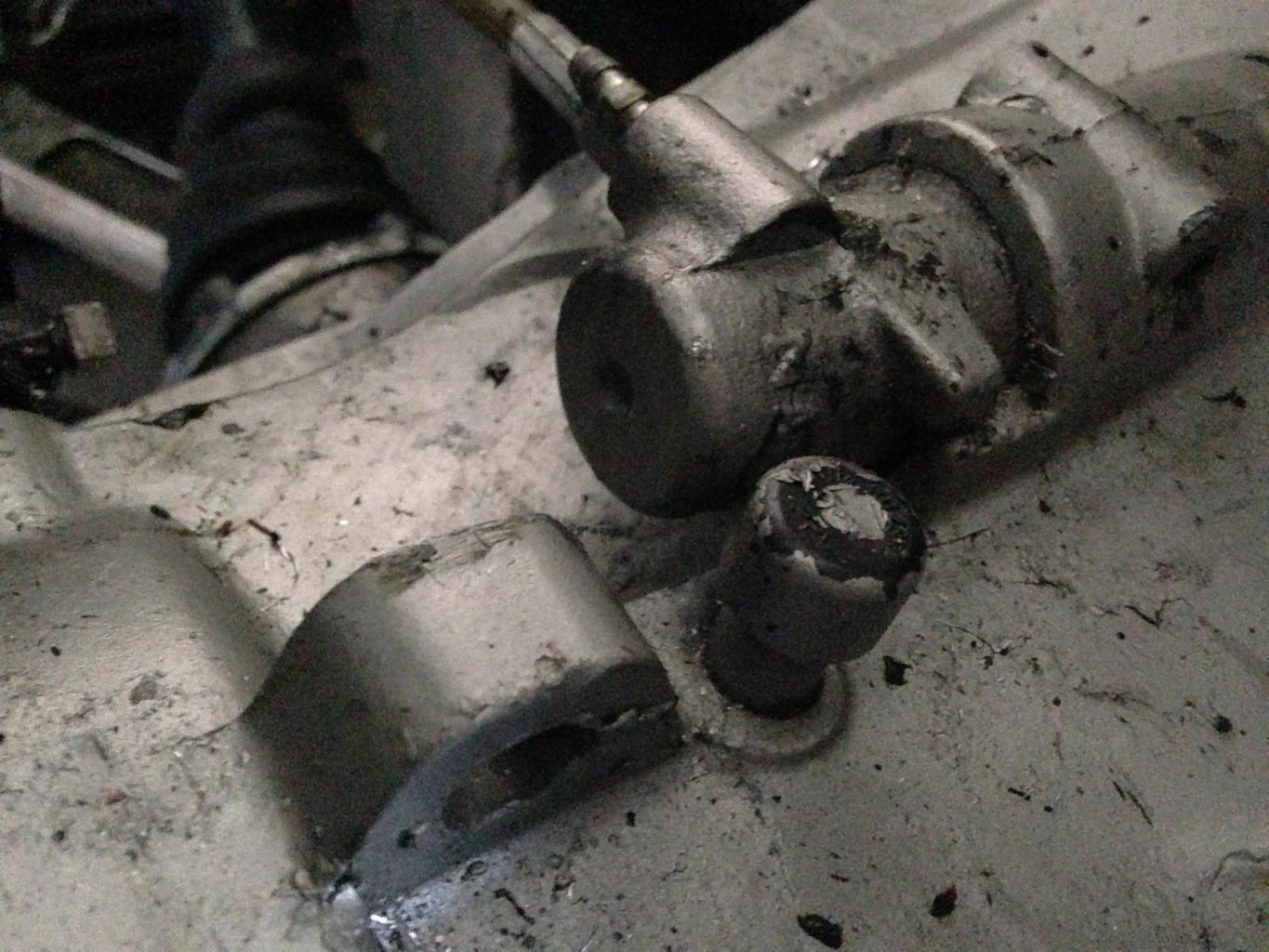

Hi Michael, as mentioned, the cylinder perpendicular to the slave cylinder should have a retaining pin that needs to be driven out, possibly with a bolt that will fit just inside the cylinder walls. My car somehow did not have a pin but luckily the slave was also well stuck in the trans housing. I would spray penetrant around the slave and let that sit awhile. I used a pipe wrench and wiggled the slave back and forth until it came out. I used some sandpaper to clean the hole and the new one slipped right in. For the new retainer, I used a small stainless steel bolt and ny-loc nut.

Often with the 016 the slave corrodes itself into the bell housing. I've broken transmission housings trying to get it out. You have to remove the pin which might mean drilling it out, and then remove the slave which might mean hammering it out, or cutting it into piece to get it removed.
