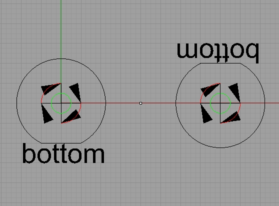

Lurker and first post here....but I have to ask!:o If I understand you correctly, you simply rotate the trans 180 degrees so the top is now on the bottom? In that configuration you still haven't changed the rotation of the input shaft......have you? If not then shouldn't you still have the same amount of forward and reverse as before? Just curious.

I'm still having a real hard time getting my head around the top to bottom flip though. Assume there is a cad file showing the centerline of the input shaft that traverses through the length of the trans, that line is the rotational axis....correct? Assuming the input shaft rotates in a clockwise direction looking at the trans from the input shaft end, the rotation of the input shaft will not change by simply rotating the trans upside down...will it?:dead:
Anyway here is a jpg showing what I mean.
Now don't get me wrong, I know nothing of the transaxles but I am trying to learn and that is why I'm here on this forum. You have excellent technical info period!

Hi Mike,
It's the output shafts that are the issue, looking from the rear of the GT40 with the tranny in the mounting position in the Audi position ( gear selectors on top of gearbox) now rotate the gear box so the left side output becomes the right side output and vice versa. So you are rotating it on the input shaft axis not the output shaft axis. I hope it makes sense.

High Steve good description
Yes I had to think about as well.
I find the best way Mike is use your hands (imaginary g/box).
One hand on the input shaft rotating clockwise.
The other on the L/H drive flanges, it is rotating in the forward drive direction.
Now roll it over without letting go of anything while rotating your hands slowly and now it is going in reverse.

I once made a post on how anyone can do this. It involves putting your arms into a crucifix configuration and rotating your fingers to indicate tire rotation and using a wall to represent the ground. Start out facing the wall, then flip yourself over (facing away from the wall) maintianing the same rotation with your fingers. This has worked for me every time I have done it (every couple of years just to convince myself that the laws of physics haven't changed. BTW, to emulate a Porsche, you'll have to stand on your head, LOL :-)
Mike, you'll get 6 reverse speeds!
Thanks guys,
Jim this is one of those things that even when you see that it works, you still don't believe it. I followed your example and can see what you are talking about. Just to be sure I replicated it on my cad system.....so now it is through the thick part of my head! lol
I appreciate the patience and the help in understanding. Now, how are you going to fix it?
You would fix it by flipping the ring gear inside the trans.
