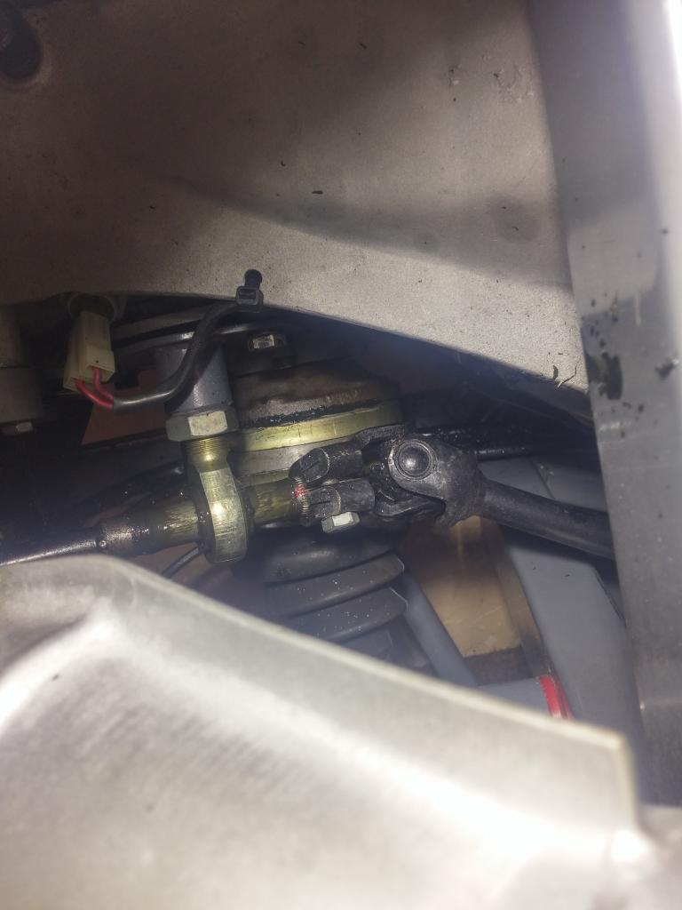

I parked it up for a bit and had a look and notice quite a large amount of oil/grease that has been flung around the engine bay as it looks like it has come from the coupler? (not sure what its called) but that is what the photos show. Then i dropped a mate off at home and couldn't grab reverse (very embarrassing) then pushed her back and managed to grab 2nd and 4th for the trip home. When i got to my driveway (in 2nd gear) i pressed the clutch in (to slow up, as if i go to fast it will scrape out) but the car stalled because it never came out of gear (freespin) so then i pressed clutch in and tried to start again and the car was moving under the starter motor power then fired up and it went a couple of meters before i had to shut it off because the clutch wasn't disengaging.
I hope someone can point me in the right direction as i am new to this but am fairly competent once i understand what i need to do.
My thoughts at this stage is a broken seal somewhere hence the thick oil everywhere and the gear selection progressively getting worse meaning a leak, The gold colour band around the coupler looks a little average and can be moved with a screwdriver but I'm not sure if thats the problem. There does look to be a larger buildup around one side of the coupler and all fling marks of oil are in line with that as well.

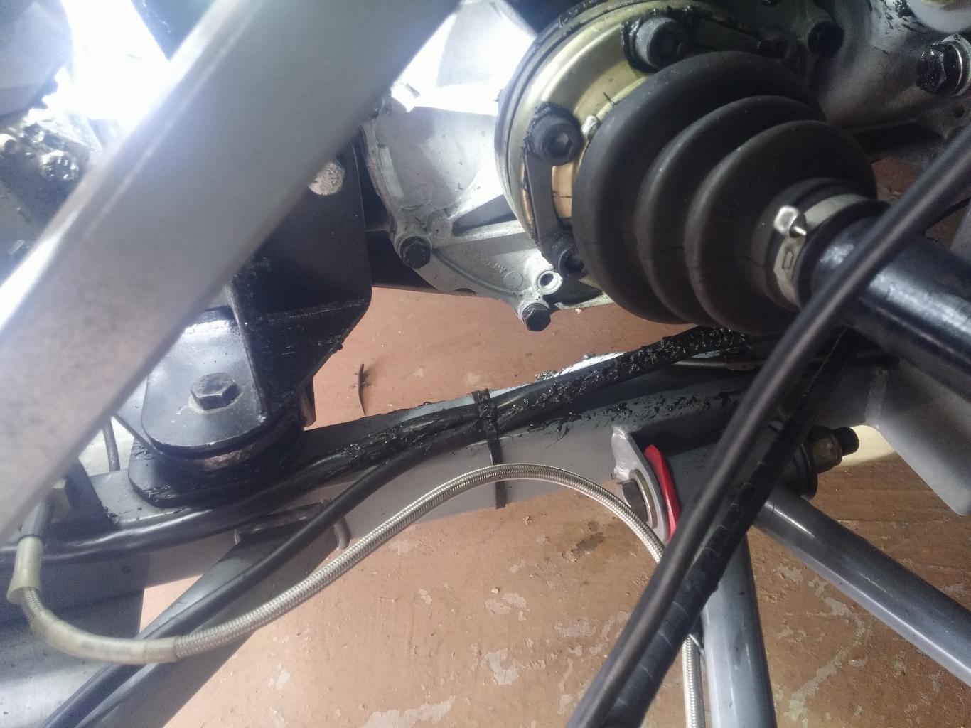

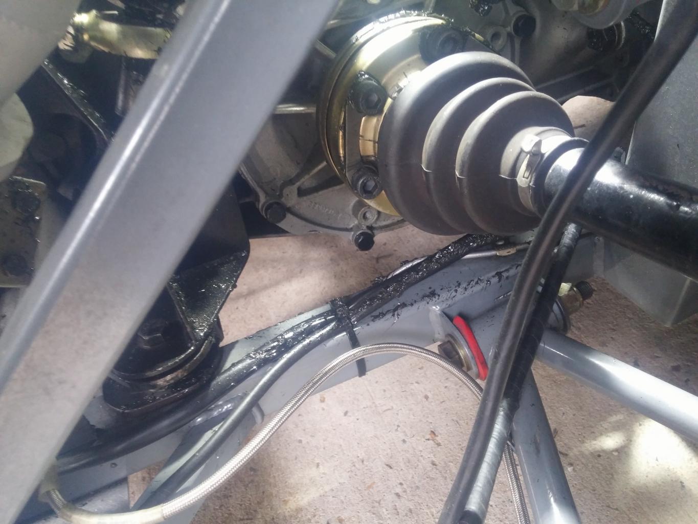

Here are some more photos of the issue.
Mitchell
The grease that has escaped appears from your photos to be from the CV joints. That is an easy fix as it could be as simple as the cap screws being loose. Worst case scenario is that the axels will need to be removed, repacked and resealed. This problem is not related to your gear selection issues which others will comment on.
Regards
Russell

"The gold colour band around the coupler looks a little average and can be moved with a screwdriver but I'm not sure if thats the problem".
The gold colored band...should not be able to move. It is a cover over the CV internals, and should be firmly compressed between the CV and the output shaft. Multiple Porsche forums indicate that the cap screws have a history of coming loose, which appears to be the problem as Russell said.
Hey guys, an update on where it's at. You guys nailed the grease part, the allen bolts were extremely loose so checked both sides and the other side was tight. Now just have to figure that out.
