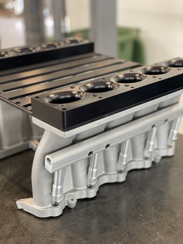

The R8 V8 had Plenty of Room to the Firewall , so the V10 would fit in the Standard Frame without Mods i think . Intake / HP-Pumps sits very High , you need to reverse the Intake with the TB to the Front (a lot of work , not symmetrical) and have a ugly Hump in the rear Clam (or ITB it) .

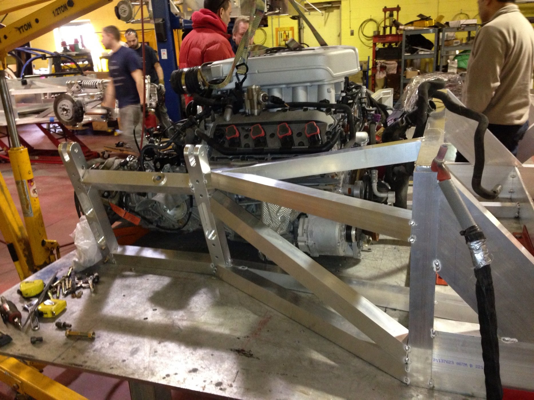

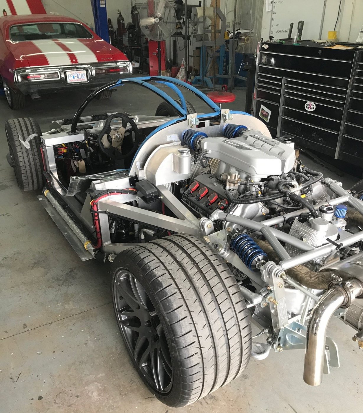

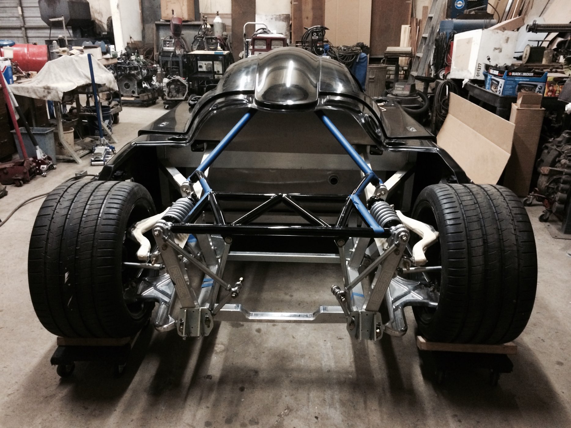

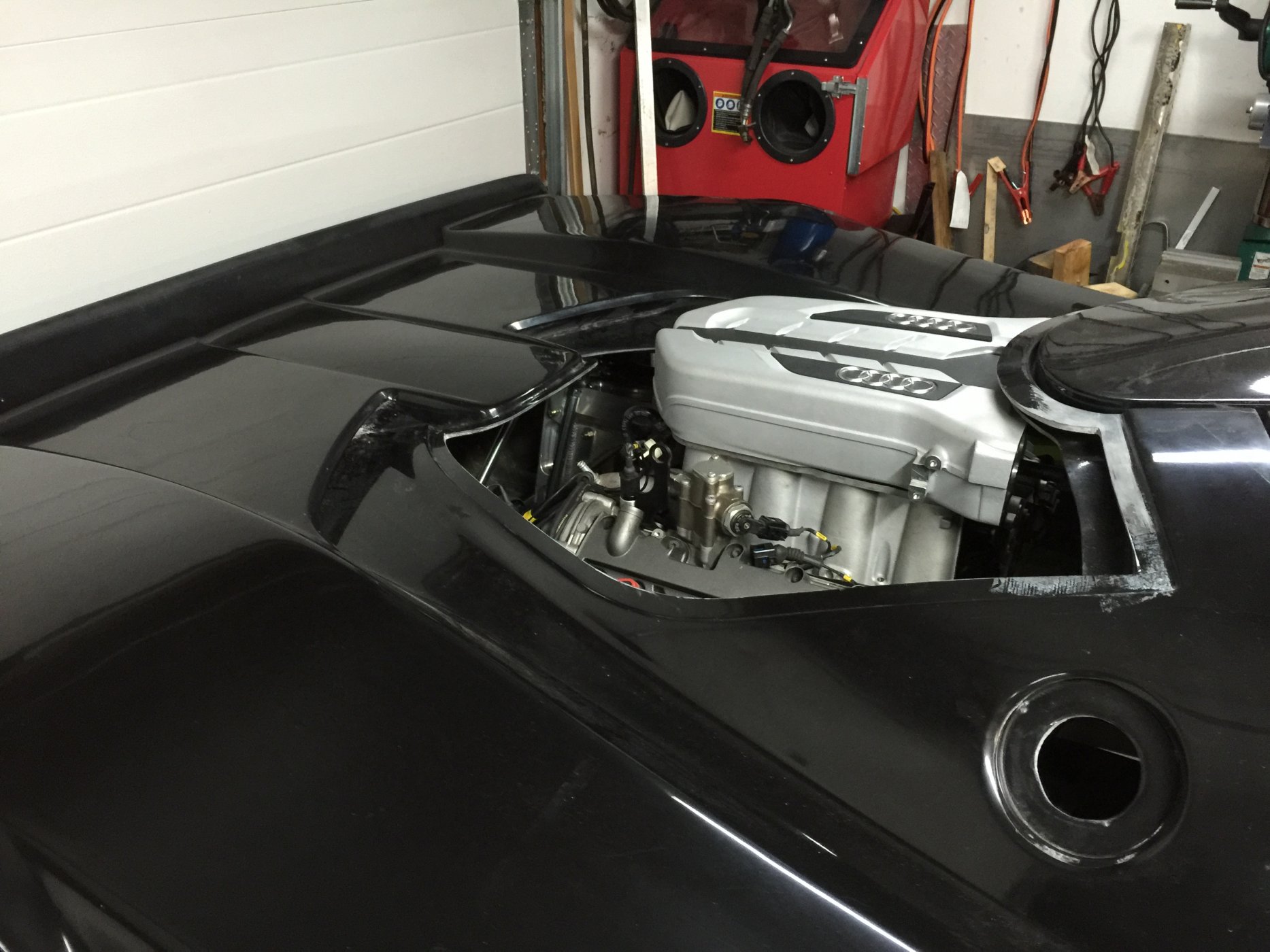

Thank you for your answer Nils. I don t plan to reverse the intake but to bring a major body modification to house it at the rear. As i will have a full AUDI r8 car, the engine is running with all original parts including ECU. I found 1 pic to illustrate your comment but its a V8 and i m a bit scared the v10 require even more modifications than the v8. i will continue my research with your new orientations. Thank you

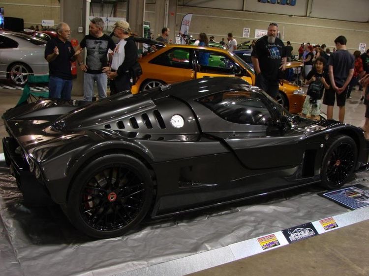

Well look at that.... Nils, Iv'e never seen a picture of an Audi powered SLC, thanks! Being an Audi fan (S8 and TT) I guess I'll go looking for build information on your car now (IF that is a picture of your car.
Have anymore pictures?

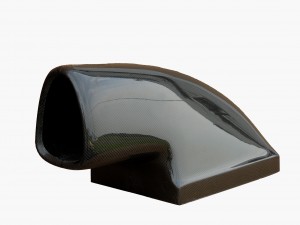

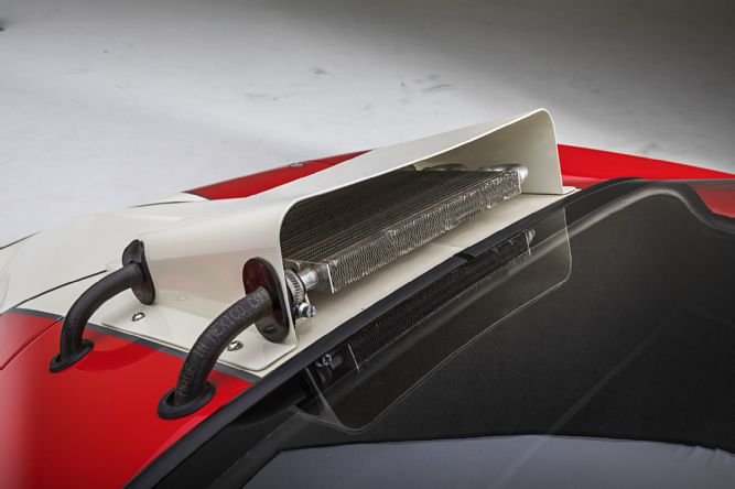

Fred are you in the US? Not so much BODY modifications but, you will need to create a custom 'back glass' insert out of fiberglass to cover the intakes. I'd suggest maybe a scoop be incorporated like an older F1 car to help make the 'lump' in the bodywork make more sense.
i guess it s Nil s car but can 't confirm.
I m currently living in Qatar where it s quite easy to find cheap supercars here. i also fly often to US so i can get spare parts easily (if it fit inside my suitcase of course). Because of the graziano i thought it would be a huge gain in time (and money) just to buy one as a donor car (i m personally not a fan of the r8 design but as european as i know their technology is excellent). Yes I know it can sound weird to buy a R8 just for its components but its cheaper to buy a whole used car than a brand new engine from audi. You are right about the design of the rear body and that s what i have currently in mind since this afternoon. Maybe trying to adapt a drag scoop... or hide the air intake below a ''oil cooler'' looklike. No problem to work on fiberglass but quite hard to find a good welder/fabricator guy here for customs parts (and it cost a lot...). I was naive to think that the engine will sit in without major mods. I m now a bit worried after Nils post. I keep on searching

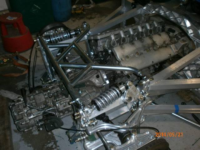

No , i think ist Hyder´s Car . He has it in running State - i canceled the R8-Engine and the M120-V12 before to go the boring LS3-Route - only to complete the Car an get it Street-legal .

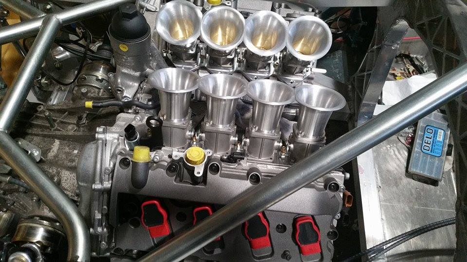

R8 V8 with ITB , a Version with RS4-Intake (S6 or S8 for the V10) is possible too ; then it Maybe would clear the Hood . Notice the Space in Front - the Engine is very short - V10 should be around 92mm longer - no Problem .

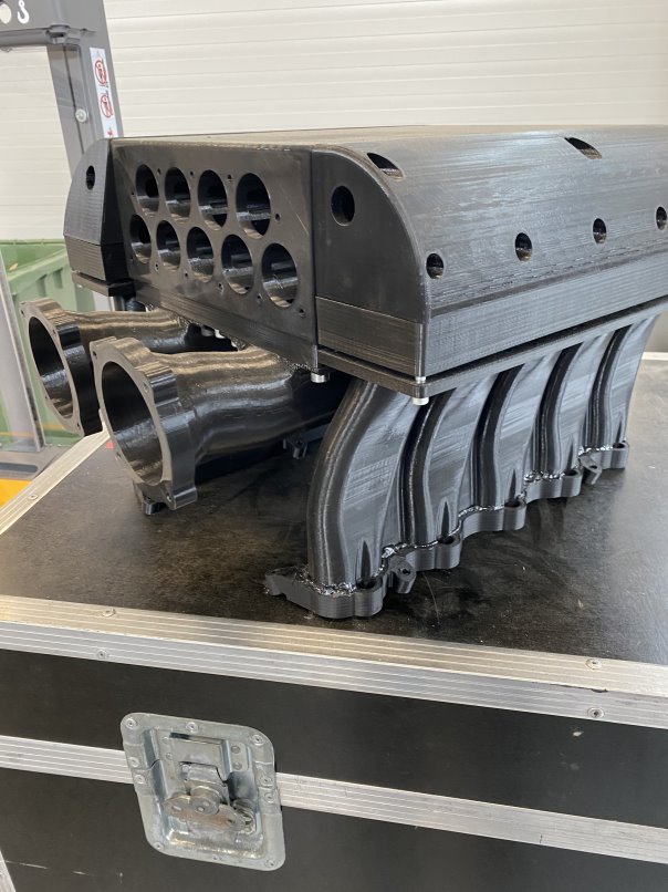

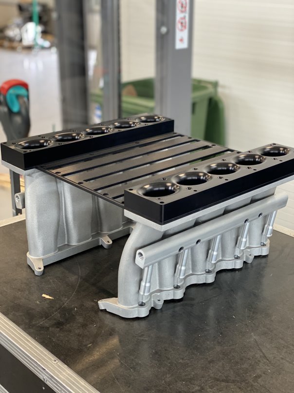

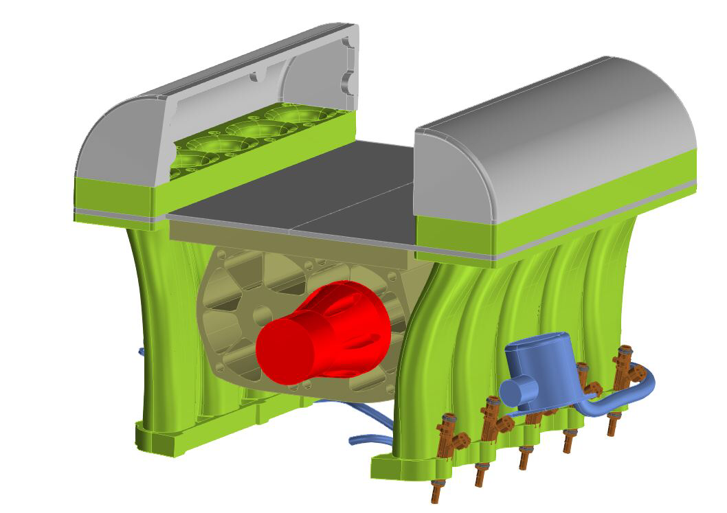

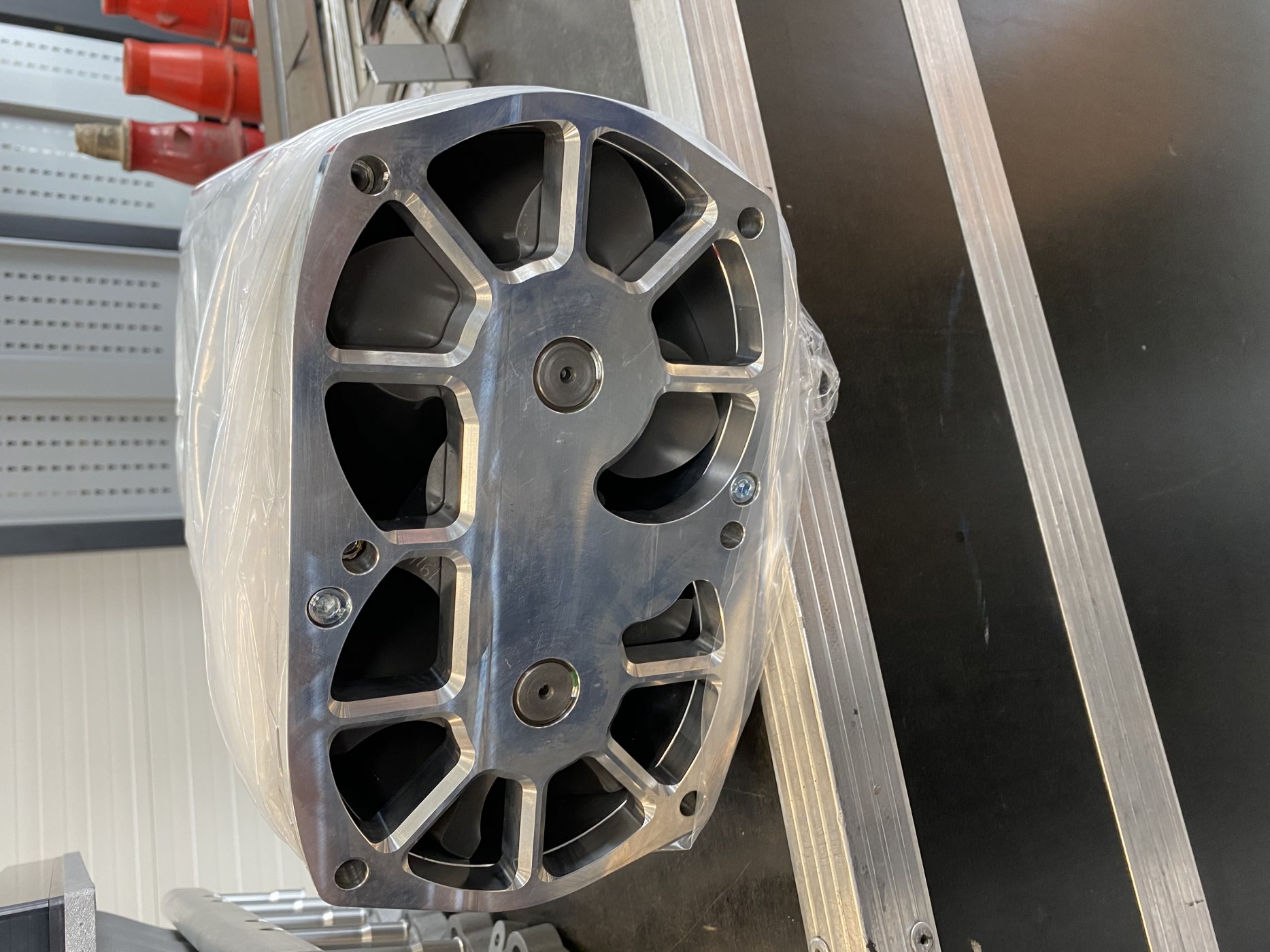

If you need information about the engine, maybe I can help.
I come from Ingolstadt and I design a lot for a motorsport team.
We just built a BiTurbo 10 cylinder, first stage 980 HP with 0,4 bar boost pressure.
Now a supercharger version with 1400 hp is coming.
Unfortunately one must modify the transmission very strongly starting from approx. 1000 HP, costs very much money...
if you need help - PM

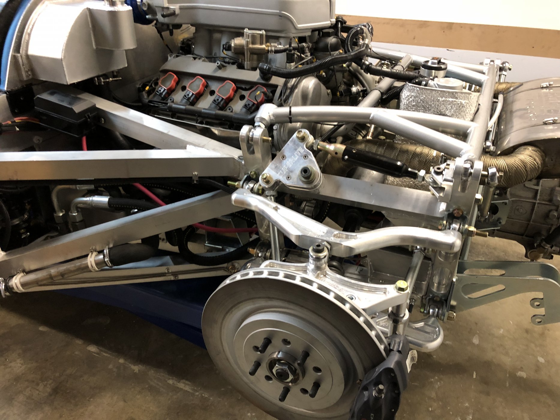

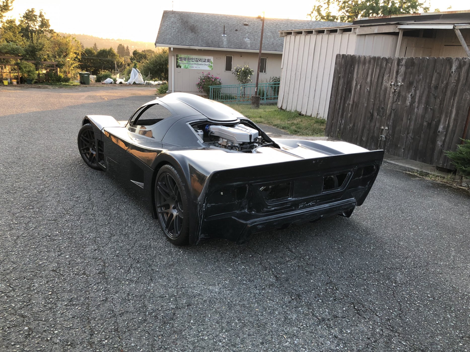

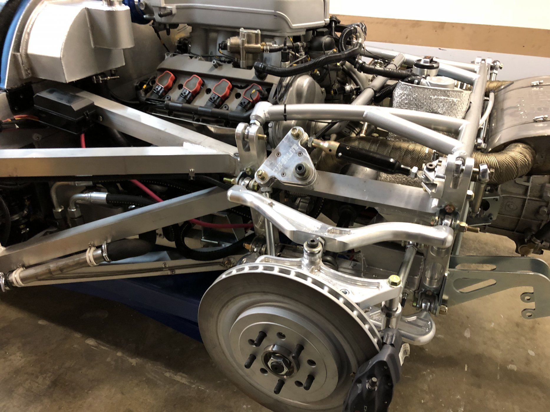

Here are some pics of my R8 V8 SLC for reference. This is lowest possible mounting of the engine in the SLC. Fran did modify rear of the chassis during the build to accommodate the engine but not extensively.
3C6D1BD3-902C-4780-8B64-EA33AD9B75C7.jpegA31B6EF5-501F-4D20-A780-C47118F2E642.jpegDE389FF6-388A-4DFD-B081-B4C29E9F8DCD.jpeg
