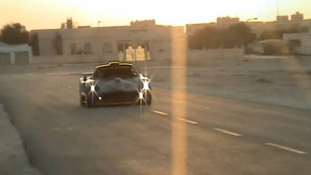

I dont have a GT40, sorry! but I have made a replica Zonda R inspired thing. It was powered by a twin turbo Jag V12 coupled to an 012 transaxle with a redrilled Audi 80 flywheel and clutch. All was good until the engine blew.

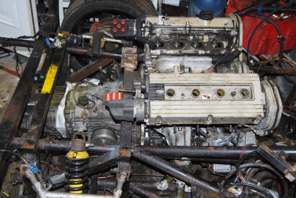

thats good to hear, as i have just purchased an 012 box from a V6 deisel to go behind a mild 302 SBF in a single seater. the ratios are spot on, i dont have to flip it, and the bonus was it was as cheap as chips.

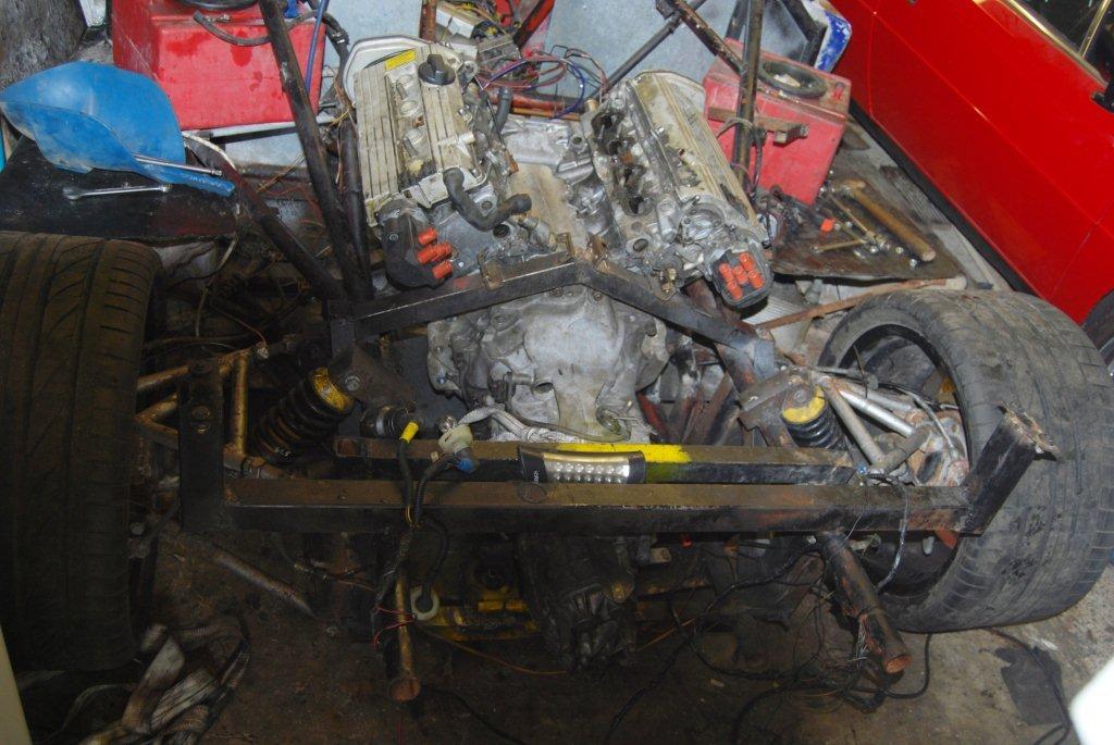

Just wondering Nick, who made the chassis? I would be looking seriously at those rear shock mounts and how they are located.

Hi Bruce
I made the chassis :( As the car evolved bits have had to be trimmed off here and there to fit new bits. One mount had to be trimmed to allow the V12's left turbo to fit correctly, but there is a torsion bar that goes between the 2 mounts for extra rigidity
I based the design of the chassis on the Ultima and so far its stood the test of time with no issues
Nick I am using a Audi abz 32 valve V8 and the 012 box and i used 034 motor sports flywheel insert worked perfect then it is just a matter of buying the clutch and pressure plate you want i went with a stock pressure plate and a unsprung clutch from ebay i think it was a F1 racing 6 puck

Hi Mark
I am using a VW VR6 flywheel that has been machined, and using the flex-plate for the starter, The whole lot weighs 7kgs. I can use any VW clutch now :)
I will ave to drill and tap through the VR6's clutch bolt holes to bolt the flex-plate to the flywheel and align the 10 flywheel bolts holes up. I guess it will need balancing afterwards

Hi
My car has moved on a lot since then. The car is almost finished and goes like a rocket, my chassis has stood the test of time, going from the 5.3l twin turbo v12 to its 3 Audi v8 with twin t3/4 turbos. The Gearbox is still an 012, this is from a diesel A4 (I believe) the difference being the bigger drive shafts.

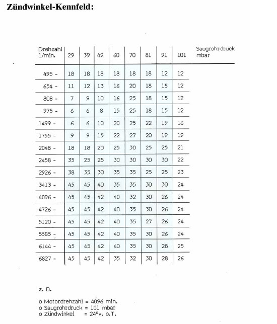

The only real issue I have is trying to find a decent Megasquirt ignition curve for a 3.7 32v V8.. I did try with the forums, but sadly no go.. so until i get it on a rolling road the power will never be optimum..

Hi Nick
I found this info on the internet a while ago. It's for a 16v Audi engine. I'm planning on using it for my Audi ABZ engine as a starting point (looking to do Megasquirt too). Might be some use...

I have a word version of that timing document if that helps, i did use it IIRC, but not too hot with the turbos.
