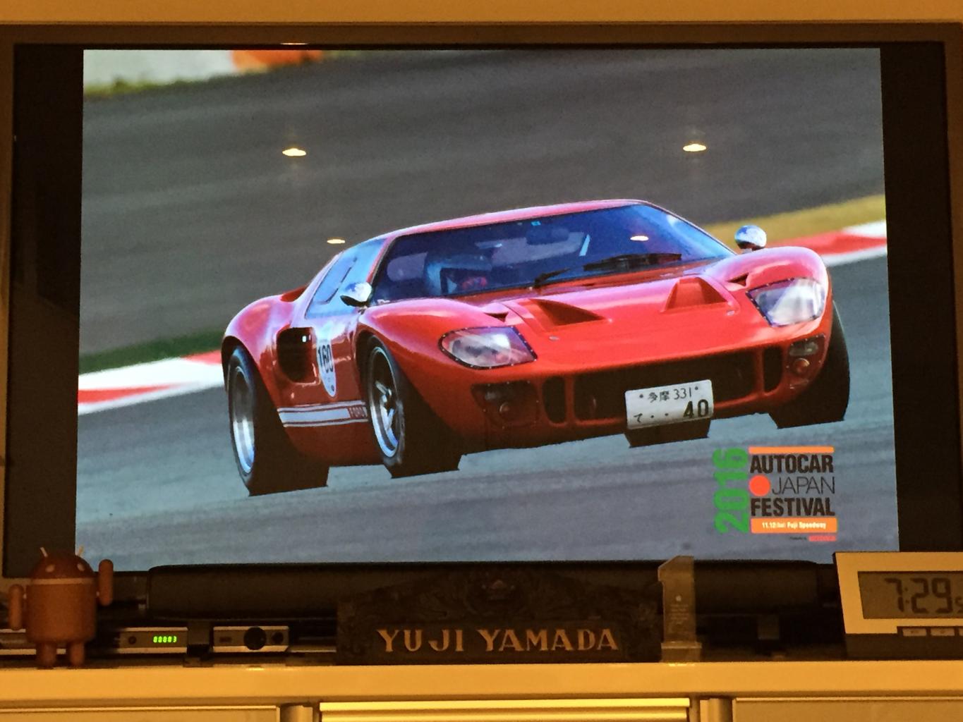

Hi,
I used TB5R for a while and quite satisfied with them although the height might be a bit short compare to AVON. In the past, I bought those from Vintage Tyres in UK, but recently looks Michelin Japan has started to sell vintage tyres locally, too. I sent a mail to Michelin Japan asking the quote! TB5R is not too sticky like recent tyres, but just nice for track days and last long which is good for my pocket!
