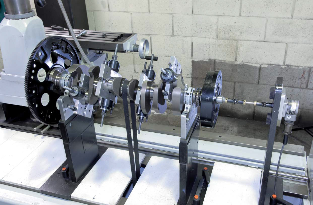

In your case where using all new or built parts you must get the whole assy balanced with damper/crankshaft(with bobweights calculated using your rods-piston-ring weights)/ and flywheel. Once balanced as a unit like that have them attach the front crank pulley and clutch assy and check it as well.
Hi Rune,
The flywheel that you have made is probably machined for an imbalance of 28oz so you must have the correct crankshaft and harmonic dampener from an engine built with a 28oz imbalance. Later engines have a 50oz imbalance.
289s all have 28oz, 302s up to 1980 have 28oz and 302s made between 1981 and 2001 have 50oz.
