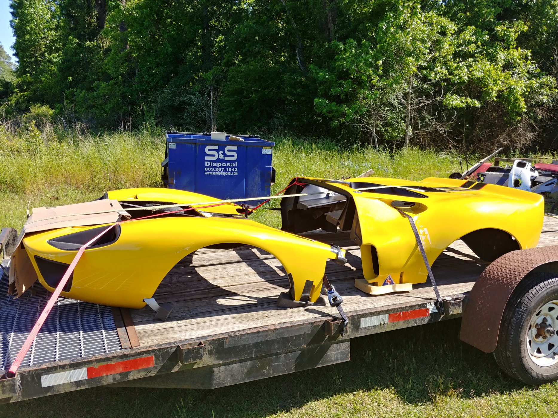

Well I have collected the body parts including front and rear clips and nostral panel that were used in P1027 as spares to preserve the originals. I also have door spares that were with that car but never used. Jay Cushman has helped me fill in the blanks with nice rockers and roof spider. I'm really torn on what to do for chassis. I own a shop and have been doing classic cars and street rods for years. I have the tools and people to build a monocoque if I want to go that far. Or a monocoque without steel roof like tornado and RCR as a compremise. Lastly just build a tube chassis. This is going to be a street car, A/C, etc. Lastly, I'm not crazy about the original suspension for a street car. Why not stick with something like Corvette C5 or C6 (pretty much the same)? Ride and handling is good and no clangy rod ends. I don't know, I have a lot of pros and cons going on in my head. I'm up for points I may not have considered....

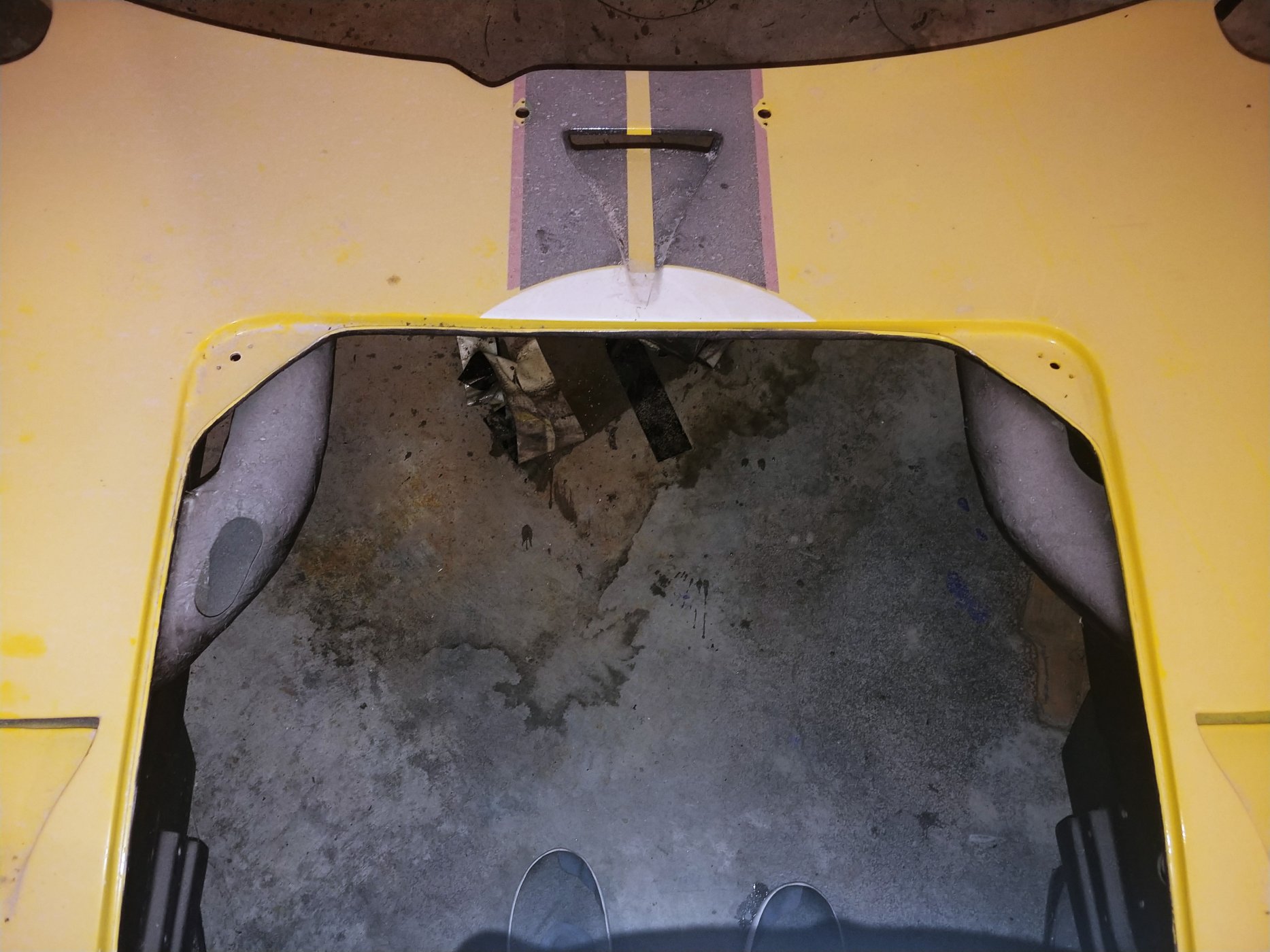

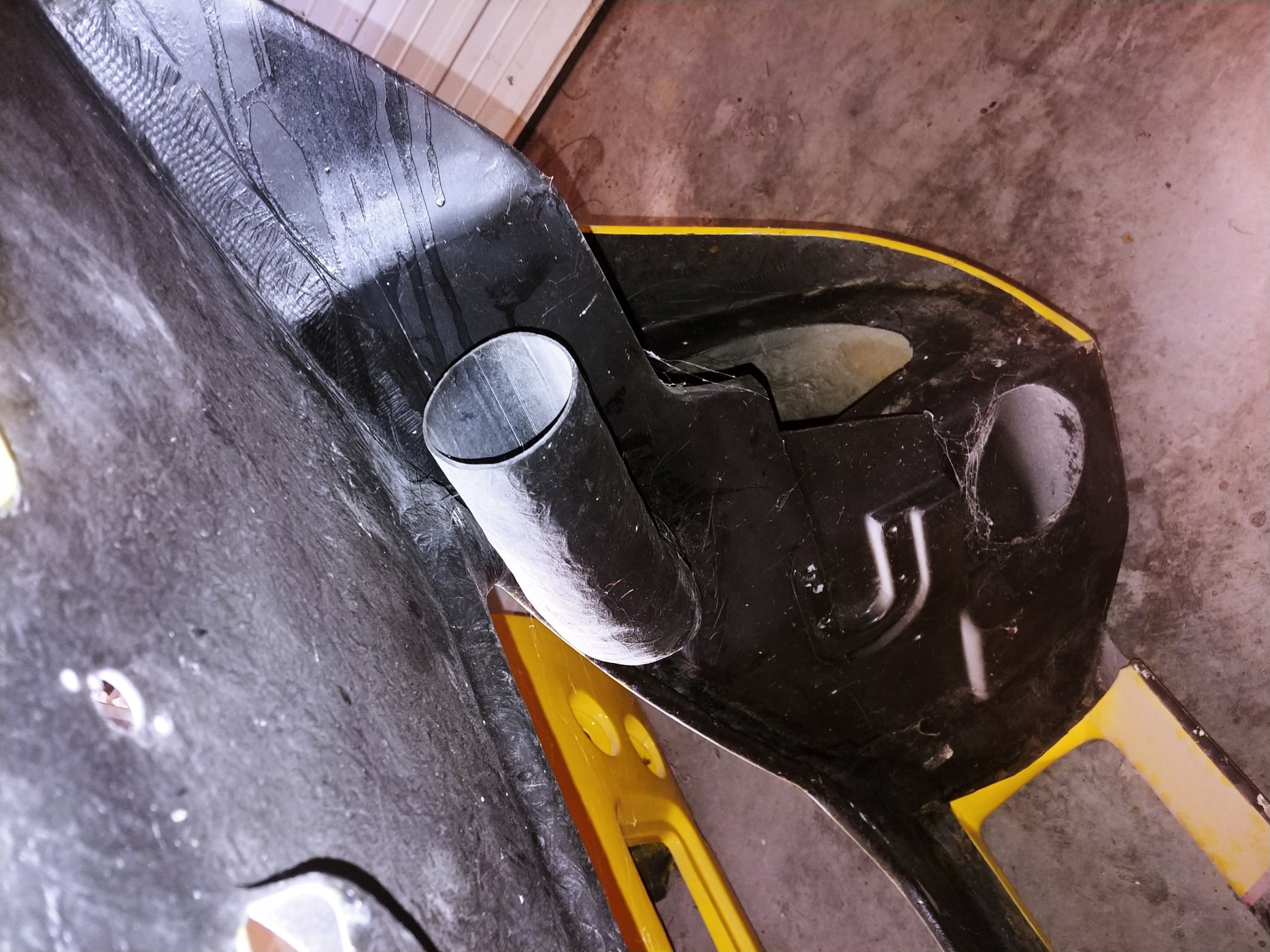

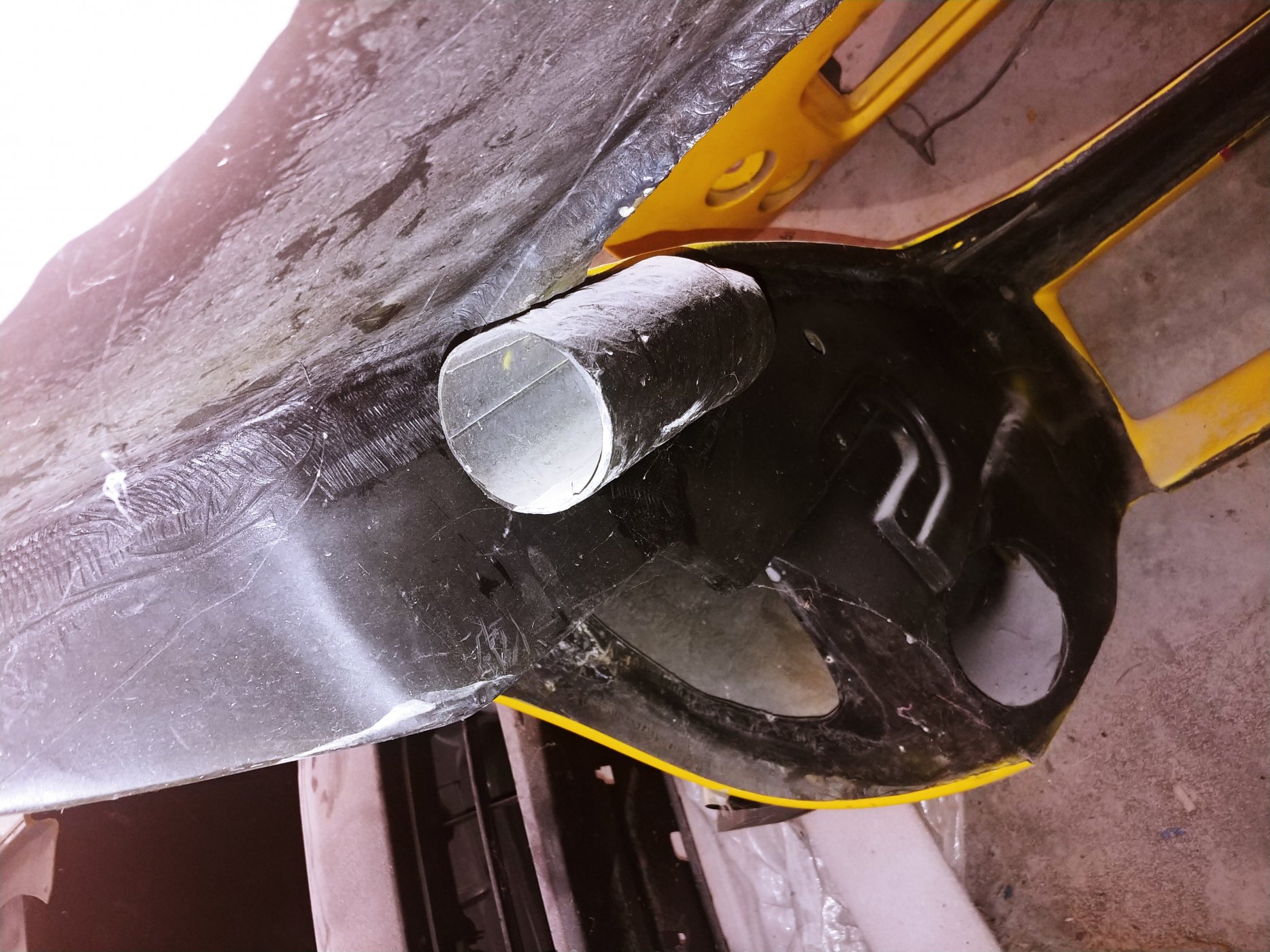

I have been slowly working on things, mostly planning unfortunately. Business is down so play money is not as good as it was. Since these panels were spares copies from an original car, they seem to be very accurate. They were supposed to be produced from molds off the original parts from the car. Anyway, can someone tell me if these ducts were typical of original cars? I don't see them on many replicas. Trying to figure out if they were added later or copied from the original. They start at the NACA ducts in the front clamshell and vent towards backside of the dash.

Those ducts are pretty much correct although the end of the duct that meets with the chassis would normally be cut off at an angle, the exception being if a heater plenum was fitted.
