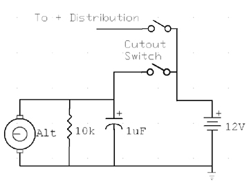

Would placing a capacitor in parallel with a resistor at the alternator terminal between the output and ground allow the battery to be disconnected from the alternator without damaging the rectifier? When disconnected, the capacitor would discharge through the resistor slowly, depending on the RC time constant, and the rectifier wouldn't see a sharp drop in voltage. Then you could use a two pole switch to cut power at the + distribution point and isolate the battery from the alternator.

I don't know if a small capacitor will save the alternator on disconnect a 10k resistor and 1uF cap are very small values and likely might not do much it likely needs more load to keep the regulator stable.
