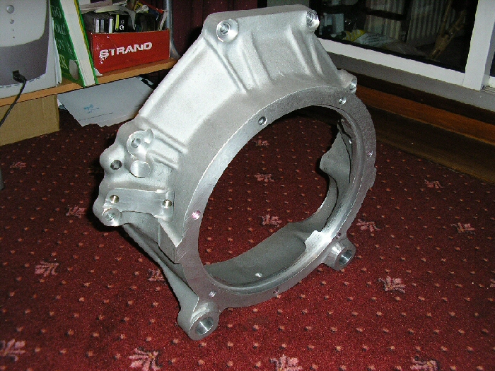

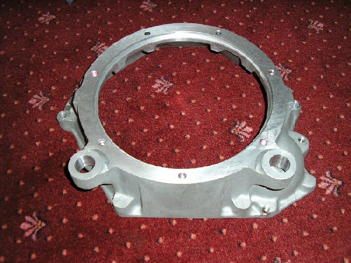

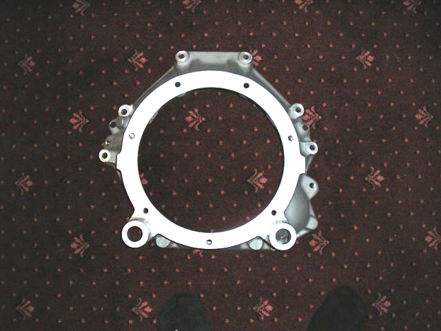

Daryl / Mike. The original GT40 Monocoque had mountings on the bottom of the bellhousing as well as the lugs on the gearbox top plate. The chassis had tubes welded into and through the lower cross beam, and a threaded bar 0.5 inch dia.( nuts both ends ) passed through this tube and the bellhousing, and spacers were made to take up any gap between them. Original pattern GT40 bellhousings are available in the UK, AND ARE BEING USED AS REPLACEMENTS ON ORIGINAL CARS, so they are very accurate. These are available for approximately $1200 plus shipping. I am not sure whether your SPF chassis has the requisit tubes welded into the crossmember, you must check, but you will need to make additional supports for the gearbox, and if the method above is not available then we have fitted an alternative that will. I can E mail pictures of the bellhousings to you, but the file size is too big to post here and I still cannot reduce picture file sizes. Frank

Frank's Bellhousing Pics:

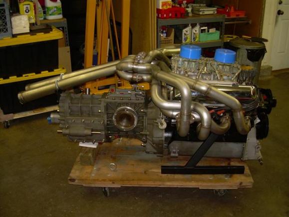

Bringing this thread to the top for the SPF guys and problem some are having with the x-member/ZF top support of the rear horseshoe. The two lower lugs on this bell housing added two further support points to the engine / trans assy, particularly in regard to the weight & torque reaction of larger capacity motors. If the larger Windsor 427 + engines do not have this type then its quite likely for that top x-member to fail especially with some of the larger HP units. The FE427 dry sump motors fitted with T44 in MKII & MKIV both had this provision with lugs on the dry sump pan as well.

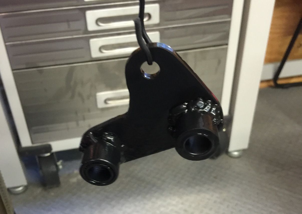

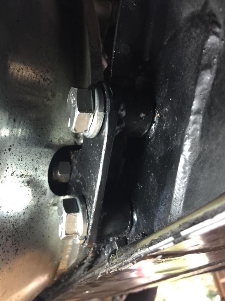

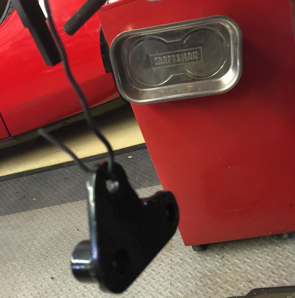

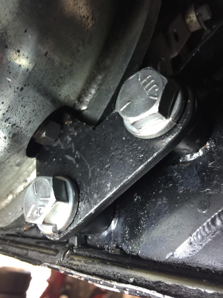

Seeing the damage done in the other thread, I talked to Mike Trusty and he said he'd fixed his long ago. So, on Saturday, I made up some pieces myself and mounted them.
The bolts on the 'back side' were too long and there was not enough room to thread the 1/2" 20 bolts into the thread insert, so I had to put shorter bolts in for the rear clip frame and the A-arm mount.
But it's all done now. I checked that my cross bar was OK and I could see no damage. I bolted the new pieces on as the motor and transaxle were sitting already. Loosening the famous three bolts on the motor mounts to the frame did nothing, so there was no apparent bind.
Pics attached.
FWIW,
Kirby
Is there any rubber or flex in those mount points Kirby, or is the motor assy essentially solid mounted now with the addition of those lugs?
Kirby Schrader
They're mostly silver
Solid mounted. I had a problem with the third bolt not being in the motor mount some time ago and the part that goes to the chassis was cracked.
I think the name of the thread was something like 'Why my motor went clunk, clunk, clunk'...
At the same time, I converted the rubber motor mounts to solid. The upper ZF mounts still have what looks like polyurethane bushings. Maybe I should change those as well....
But the motor is solidly mounted everywhere else now.
Kirby
I think I would leave the ZF mounts with the poly bushings, when you have what is effectively a 3 point or 5 point if you like setup it does not hurt to have a bit of compliance in one set- in your case the ZF top cover area. When we did motor plate mounts in Trans Am space frame type cars- plate front/rear of block it was easier on the transmission case to soft mount the extension housing and allow a bit of movement.
