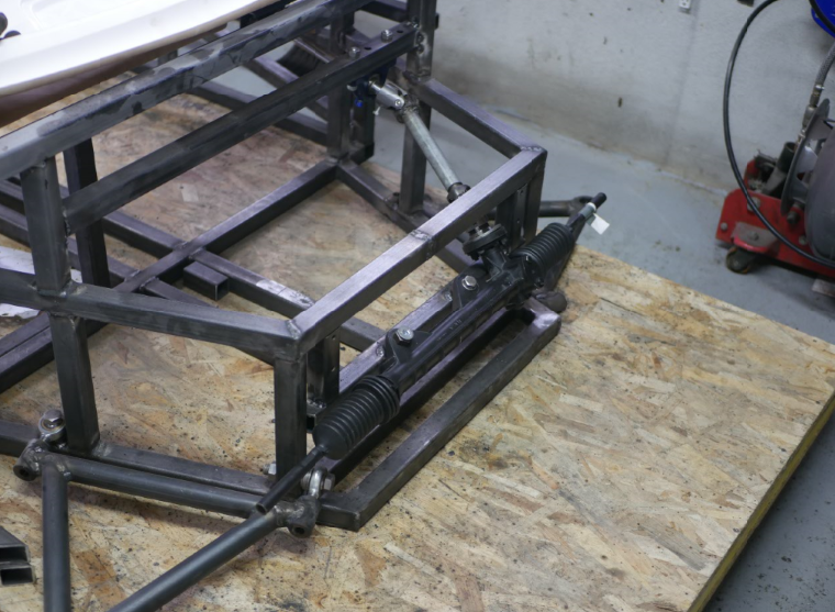

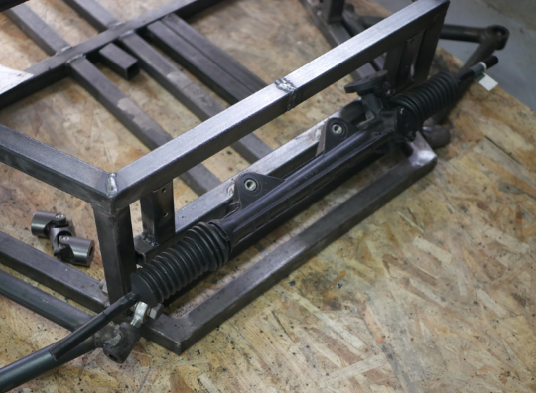

My last video is about the steering rack and the transmission between the steering wheel :D
I'm waiting for your coms :D

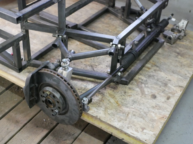

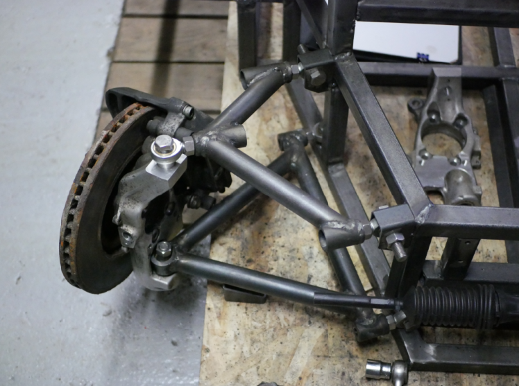

I was going to give you some grief for removing the upright from the mill too soon because I thought you were using a tie rod end for the uppers. When I seen the tap come out then I knew you were using the heims. SALUT!

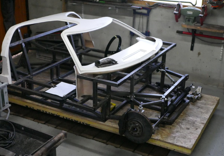

Some upgrade of my build ! I have started the rear axle, did the rear rods.
You can watch my video with the english subtitles ;)
see you seen ;)
