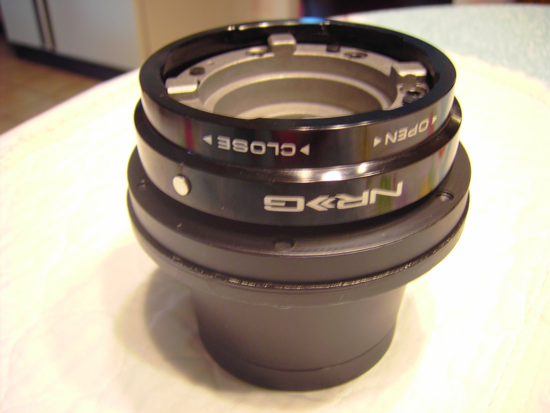

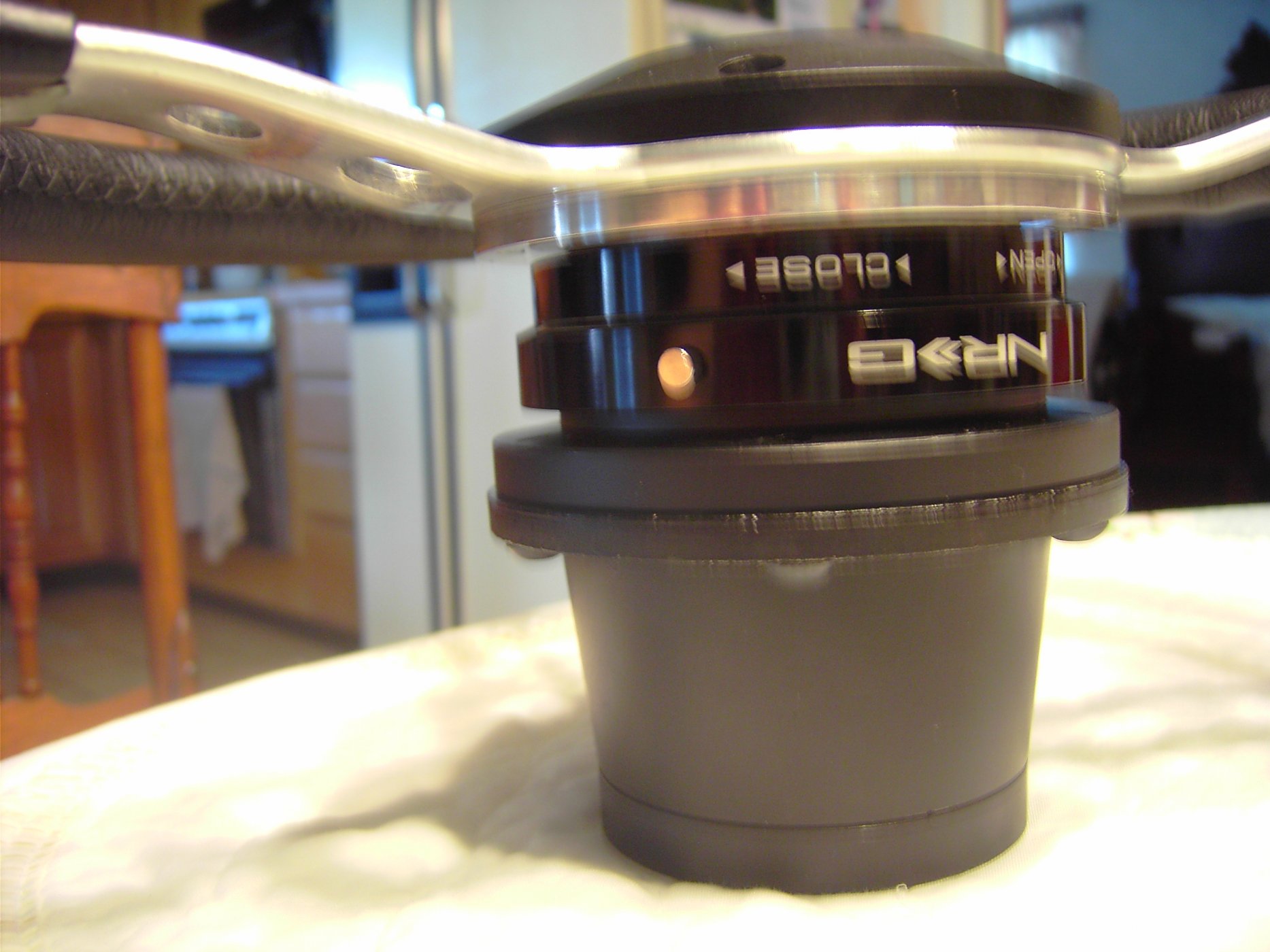

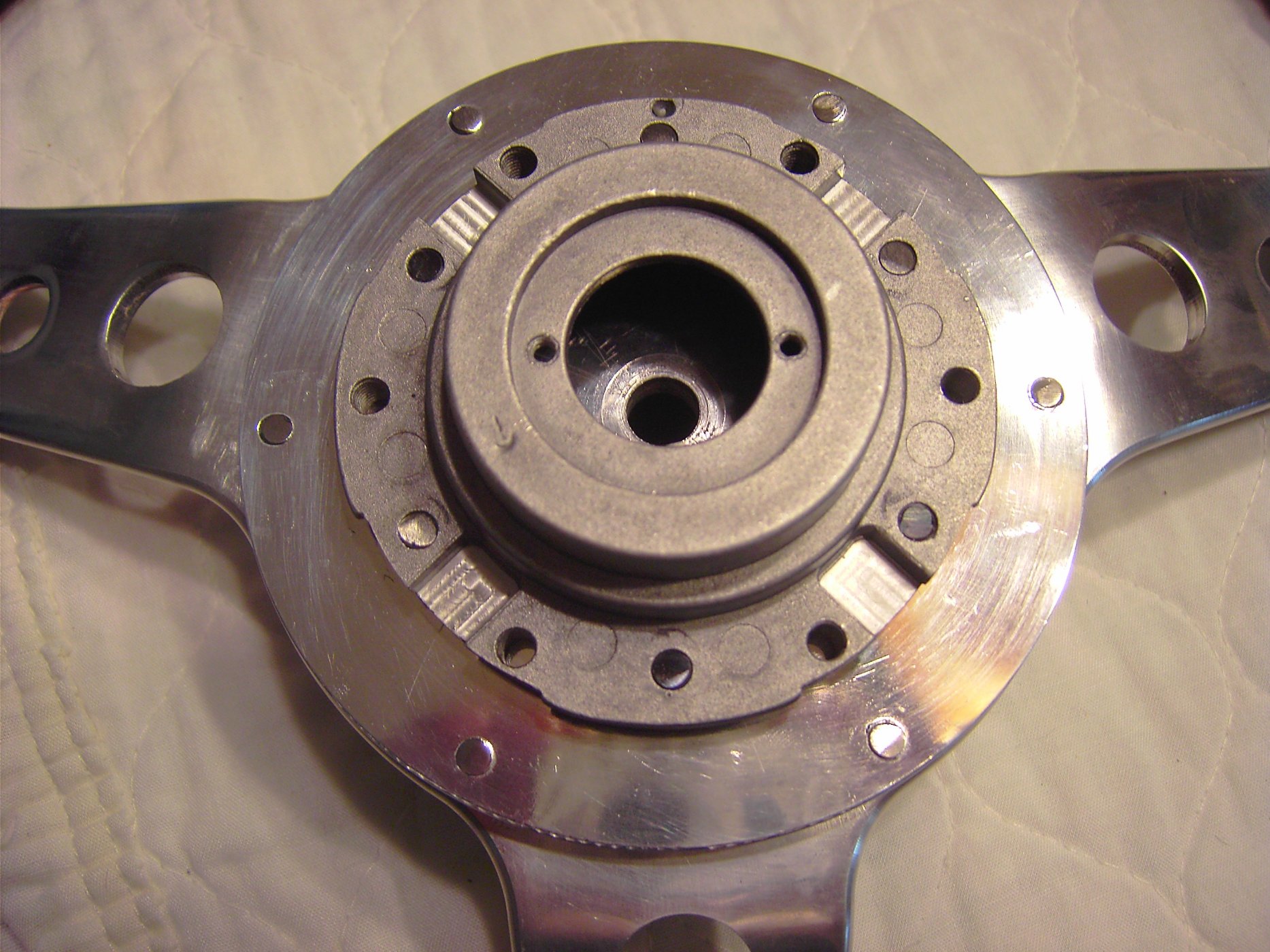

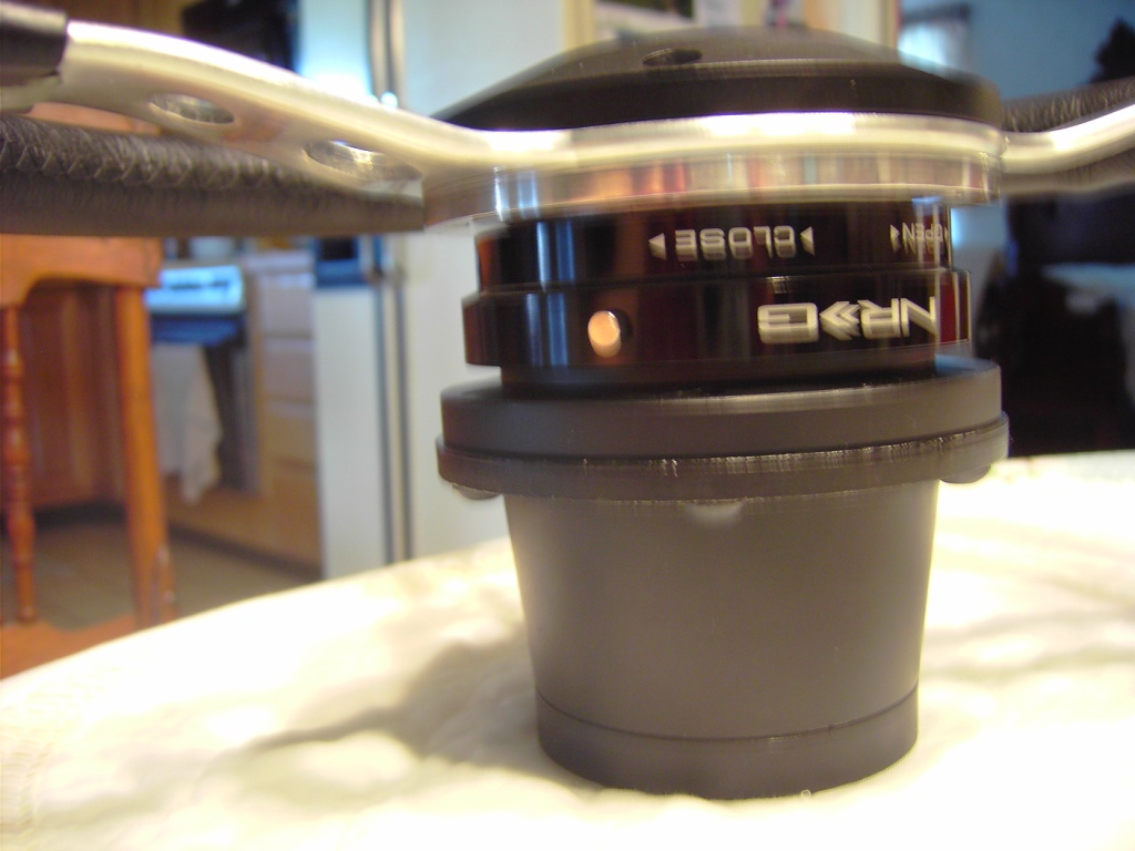

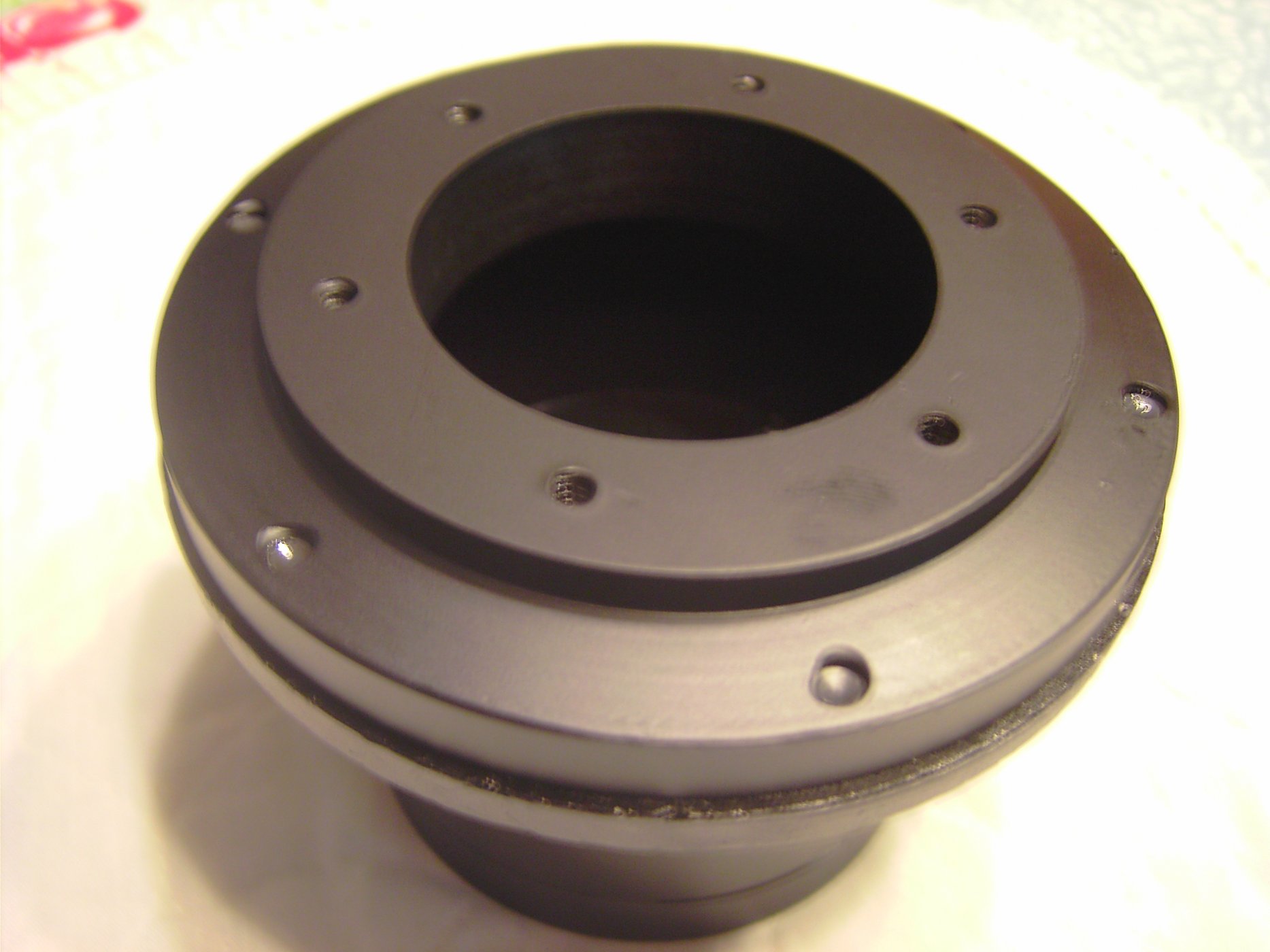

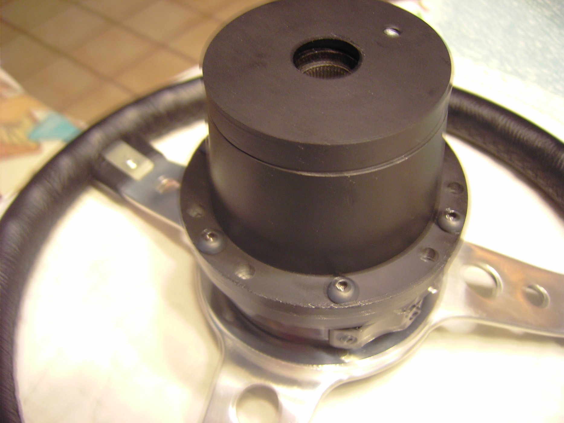

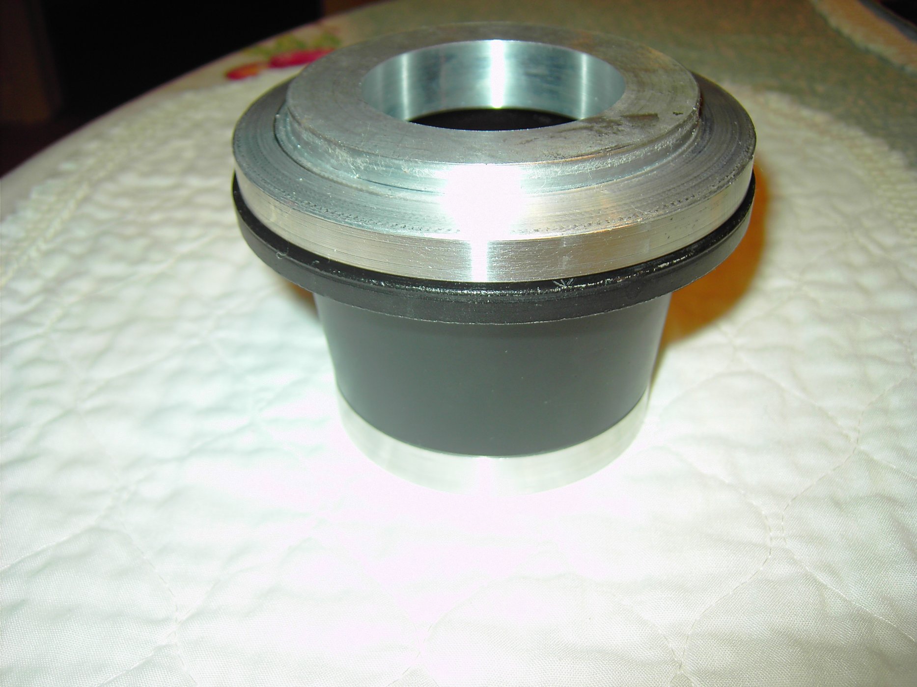

NO...I MADE AN ADAPTER FOR THE STEERING WHEEL AND FOR THE HUB
Hi Walt, your post caught my eye. I may have to do something similar since I have a odd-ball spline and there are no NRG short hubs which fit and I don’t want to weld one on. Can you provide a little detail on which parts did you buy from NRG and what did you have to fabricate?
Thanks!
NRG SRK-400BK THIN VERSION STEERING WHEEL QUICK RELEASE KIT
1/4 INCH THICK ALUM. MACHINED ROUND , DRILLED TO MOUNT TO THE STEERING WHEEL AND 1/2 OF THE QUICK RELEASE.
A THICKER PIECE OF ALUM MACHINED TO BOLT TO STEERING HUB AND THE OTHER 1/2 OF THE QUICK RELEASE.

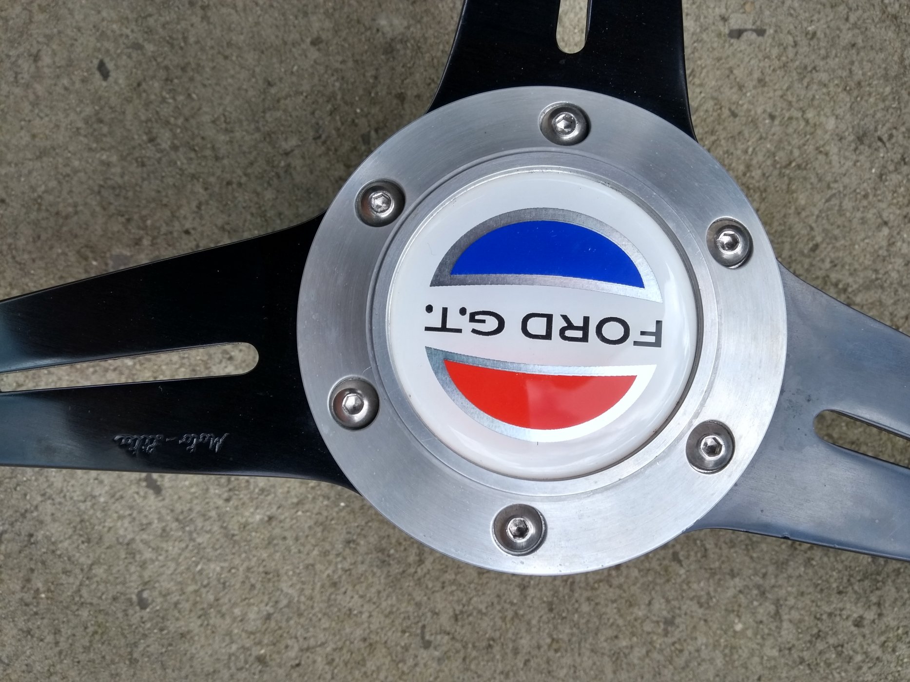

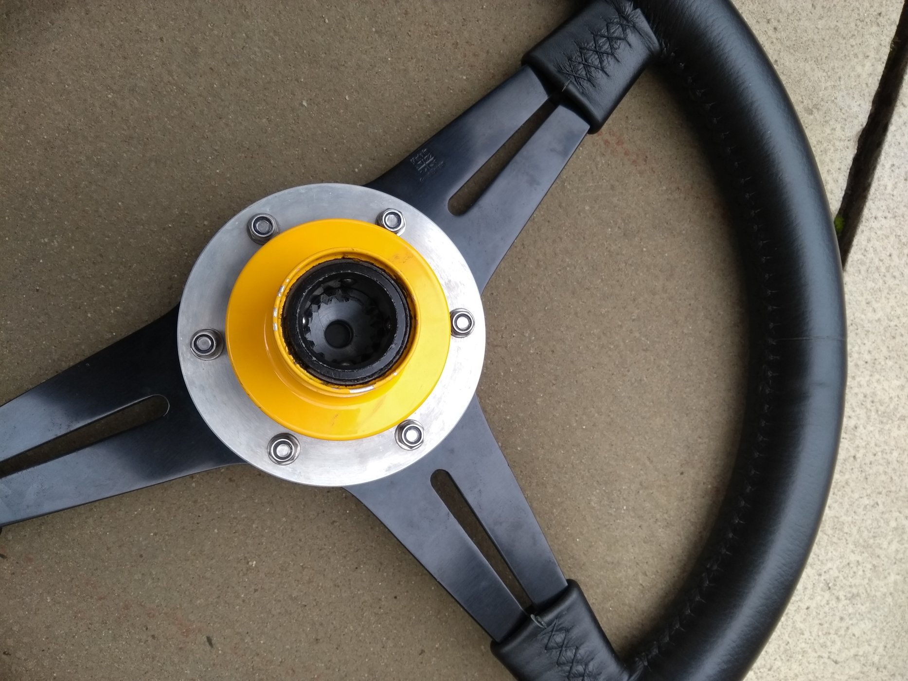

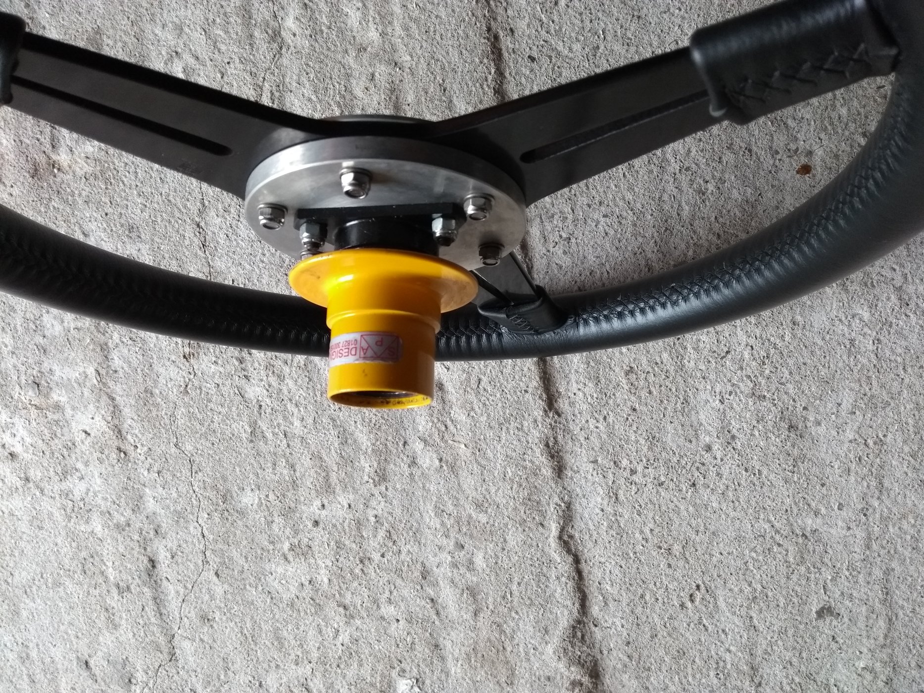

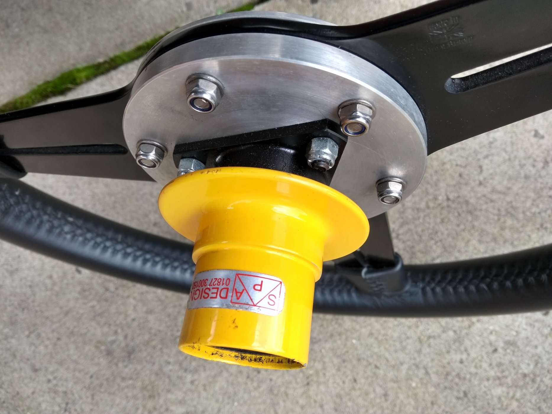

Pics of GTD, SPA Design QR adaptor. MotoLita wheel.
Alloy plate adaptor.

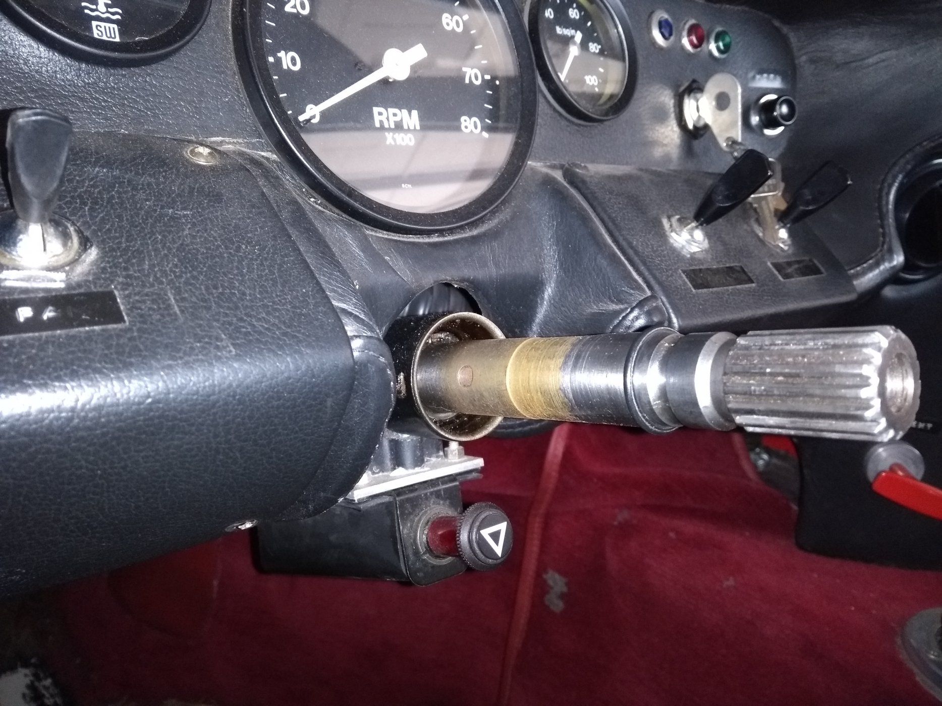

Mike, did you make the adapter plate or where did you get it? The SPA 6 hole adapter plate is 70mm and the spacing on the Motolita is 78mm. Also does the SPA spline need to be welded? Thank you
Mike Pass
I think it came from Frank Catt at Wealden Engineering. The plate can be easily made up from thick ally plate. Either very careful accurate drilling or if you know someone with a dividing head. The steel splined section has to be welded to the steering column. Usually turned and the other section drilled to ensure they are concentric before welding by someone competent.
