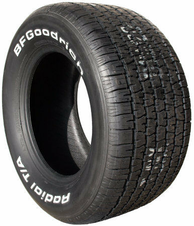

BF Goodrich tyres are now available again in 15" diameter in the UK.
We have the full range for GT40s and Cobras available.
A more economical road car alternative to the Avon CR6ZZ
AndyView attachment 102882
While I have the Avons on my Ford GT40 MKII, I have the T/As on another car and have always liked them a great deal. Sometimes I have wanted to experiment with the T/As on the GT40, simply to see that if, on the street and driving at real world speeds, they reduce some of the twitchiness/nervousness in the front end.

If you really follow the speed limit signs - especially those suggested for curves get the T/A's. If you enjoy spirited drives get the Avons or Yokohamas or Hankooks or etc. I started with T/A's and found myself tip toeing around the track until I switched to Hoosiers (not a street tire ).

T/A Radial are the best looking tires and the worse performing tire I have ever owned. Especially in the rain.

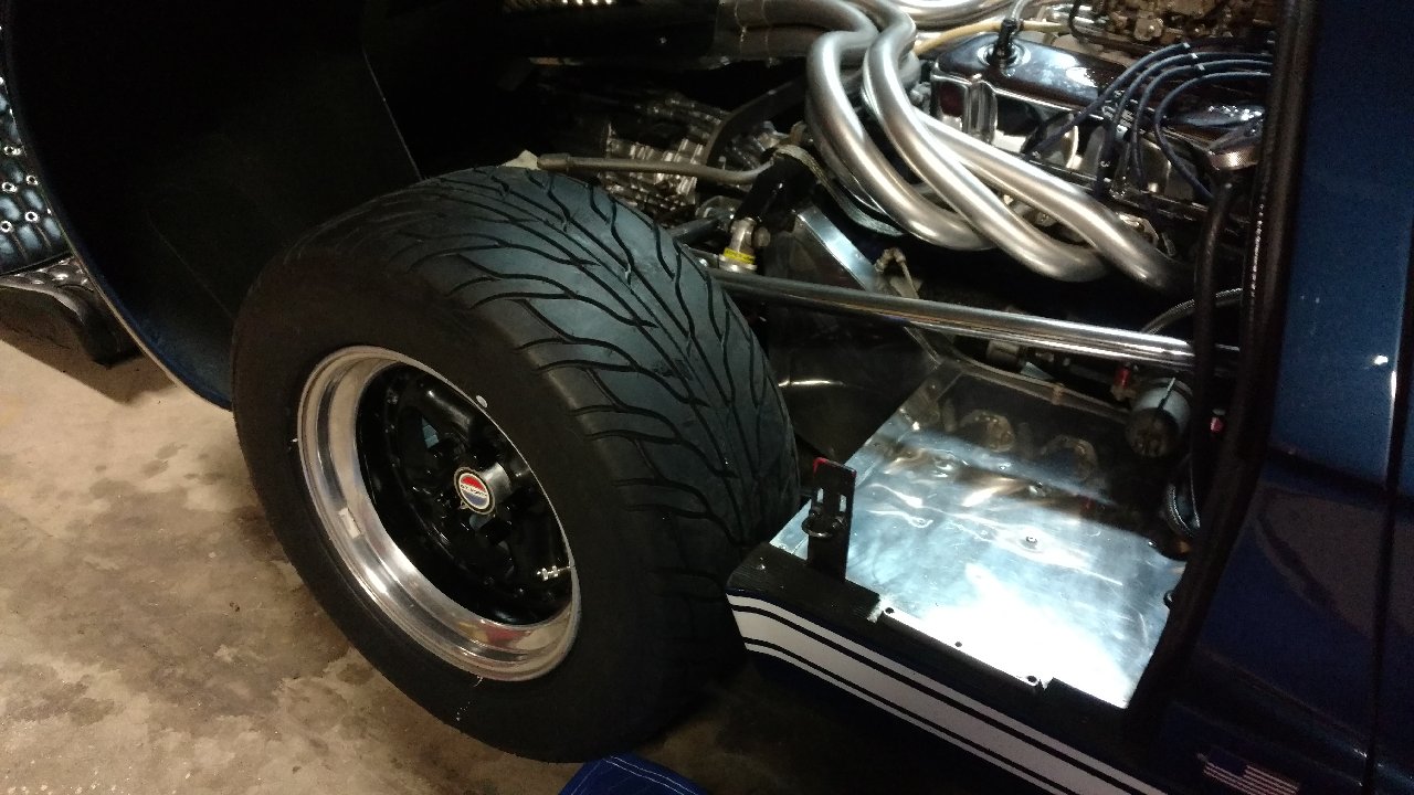

I have no issue with BFG tires, they are on many of the cars in my family. Dad has at least 6 of his cars and me and my brother each have a set on our cars. When it came to the GTD and my brothers Pantera we both bought the Mickey Thompson sportsman s/r a really nice tire with an amazing tread pattern.
