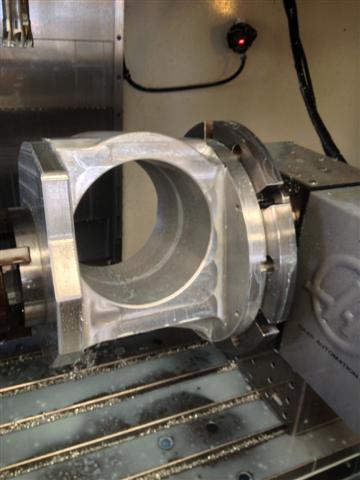

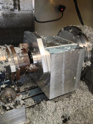

We have a customer who is doing an "exact" replica of a 962 Porsche
Using a G50 / 01 gearbox the right way up, means flipping the crown wheel --(as its a mid engine job)-- so, decided to do a billet diff housing --
Firstly, we do some reverse engineering for critical dimensions to create a model for cad cam, this then provides machine tool language for the 4 axis machining centre which uses various cutters to remove all the unwanted metal .
Then we start with a chunck of 6061 ally 350mm (14") square that we whittle away at till we have about 50% swarf, leaving a roughed out housing.
Next, is stress relieving or aging -- this allows the metal to relax or creep giving stable dimensioning for the finish machining
and wait for the next installment as we go thru the stages till completion

Wow - that chunk of aluminum must have been pretty darned heavy to start with. Sounds and looks like a very interesting project!

Very nice! I priced some pretty good sized pieces of aluminum block for some billet uprights I want to machine, and that came close to $1000, and a lot of weight. Can't imagine how much money ended up on the floor for your block.
Just wondering why you did not just reverse rotate your engine instead? This would be a bit easier and perhaps less expensive, but I do really like what you have there. How many hours did it take to get to that point on the mill?

Three 44 gallon drums of shavings from a ~120kg block @ ~$12 aud per kg which took about 12 hours machine time -- being a one off takes a bit longer.
The diff had been operating in this configuration for some time before the decision came to re house it -- so , guess the customer knows what he wants.
Engine and clutch bolts to a Magnesium suspension cross member, the diff / gearbox is bolted to this also, an extended input shaft is used

We licked the end faces for a reference dimension prior to the hogging out then checked that dim. after, it hadn't changed much --maybe .2mm (.008")
so we resorted to a bush method of stress releif --to be sure-- this involves carefully placing it on a small pallet outside the shop exposing all its glory to the elements of the natural weather ie:- local temps are between 35°C day and 12°C at night -- a couple of cycles at that should do the trick.
