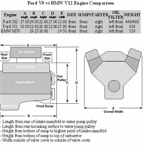

Hi guys found this salted away, I think it originally came from John C, John can you explain why it appears to hang down under the chassis so far, I have a m70 and have been thinking of fitting it to replace the 1uz I currently have in my build, the motor I have is still in the donor, and not easy to get at to measure. Is the crank to bottom of the sump distance on the m70 a lot higher than the 1uz.

Graeme, the inverted G50 is part of it, plus the sheet metal sump is a good 100-120mm deep, IIRC. Several of the M70 swaps have been dry sump conversions for this reason. (Chelle's 250 GTO, Jay Esterer's Ultima, etc.)

I make them, the extra distance is accommodated by a thicker flywheel
In a GT40 application that would only create a further problem with shifting the transaxle rearwards & increasing the half shaft angles. Time for a dedicated bell housing either fabricated or cast with as compact a clutch/flywheel package as possible.
Agreed but on my application I had the space so no need for the extra cost. You could also machine off the mounting flange and weld on one to suit your application (has been done with the 016 successfully)
