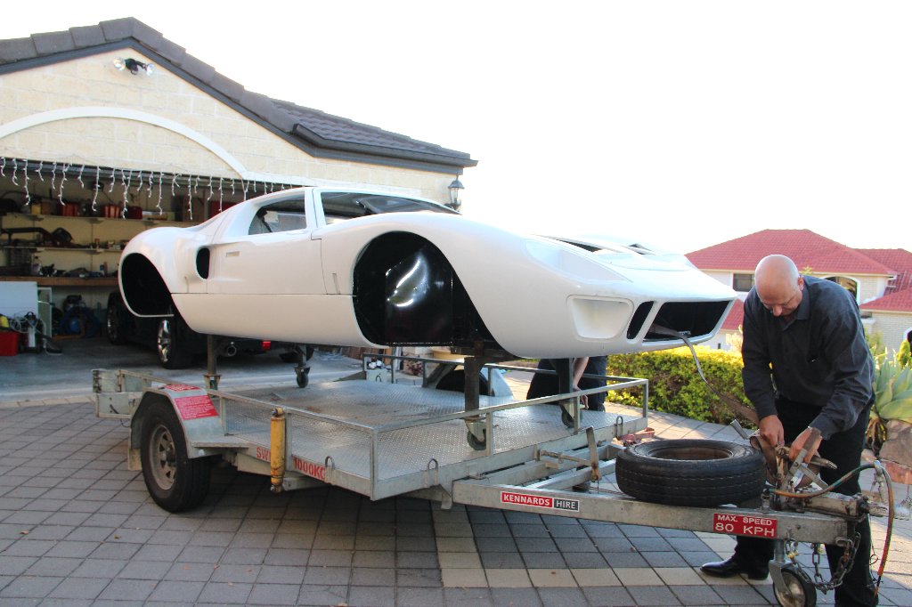

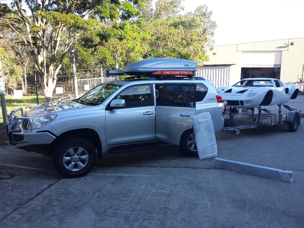

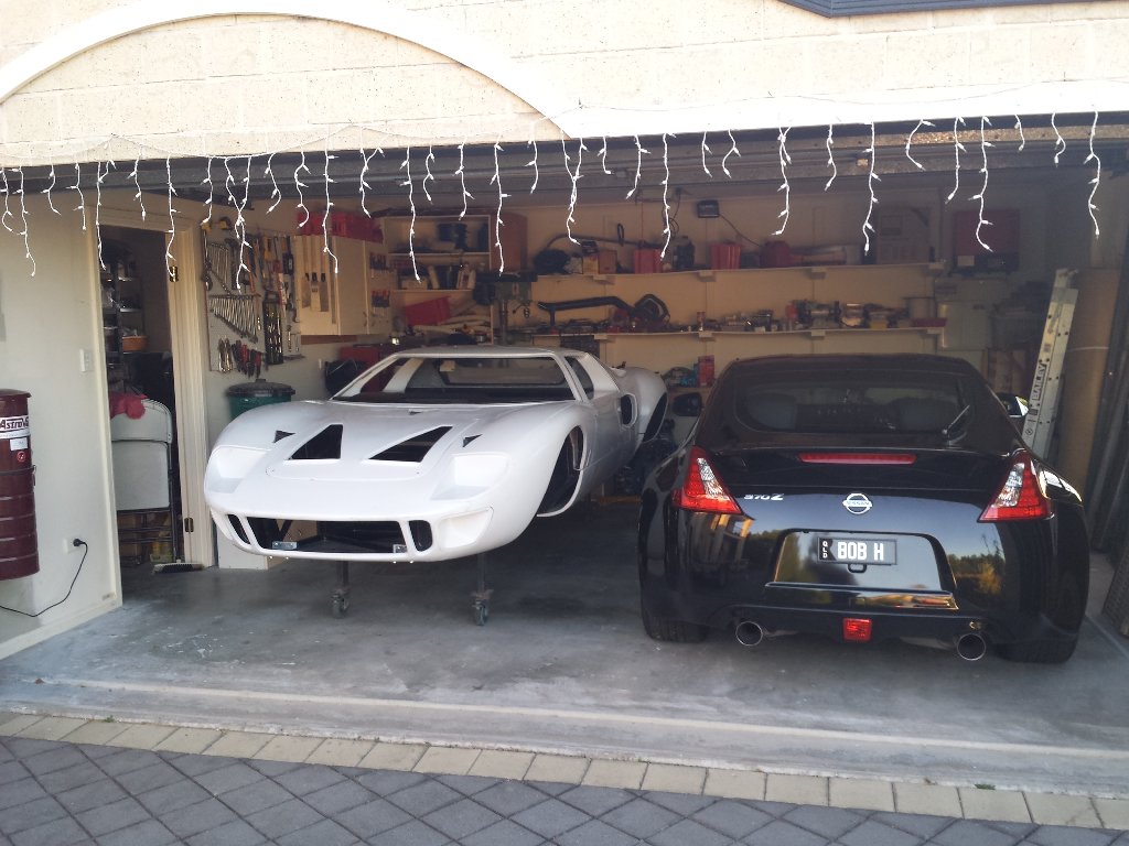

Time to start a build log, I picked up my BCU on Thursday late afternoon, and with the help of Peter, and Gary and Mirnes, managed to get the unit strapped down on to the trailer, I had to transport it on the caster frames, as access to my garage is a challenge. I had to reverse up a steep drive, then 90 degree turn, tested my manoeuvring skills, but got it first go.
But is now in and the build can start, I have 3 weeks holiday over Christmas, so have lots of time.
I have done a few ground up restorations on vehicles over the years but this is my first ICV.

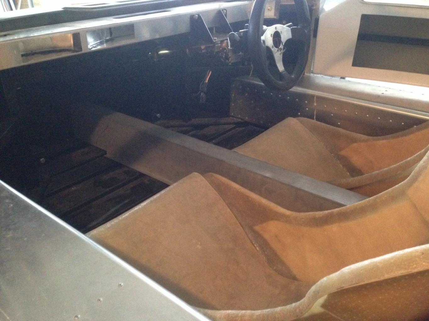

Cross member is made and fitted, steering column is mounted, centre tunnel and seats in but not fastened, waiting for my pedals to arrive, should be on Monday, so I can position everything, fuel tanks are in, and just working on the filler and breather tubes.

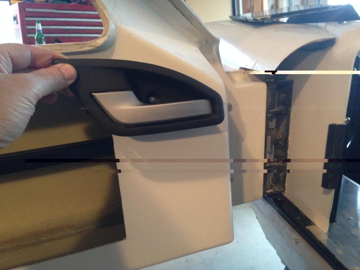

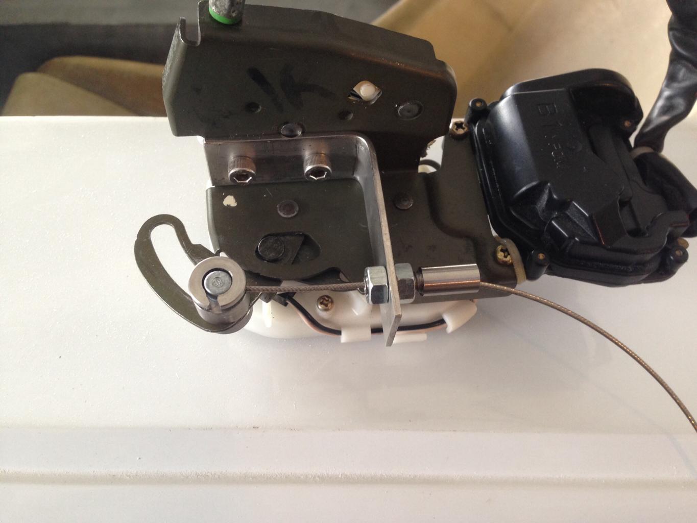

I have made the parts for the door locks, exterior handles are nearly finished, but I have a question about the interior door handles, I would like to put them in the position shown, as I think the shape sort of follows the door quite well, but everyone seems to put them at the bottom of the door, am I missing something?

Bob,
The reason they are usually installed (door pulls) at the bottom of the door is because they are easiest to reach there. (and if you were strapped in tight, you could shove out with your elbow while pulling the handle if something were to go wrong)
Just what I have seen/heard, Scott

Looks like you are making good progress. Slow and easy is the way. You have some good local support for your build. Wish I had had some at times.(local that is) Mine is DRB#5 and probably the oldest of the DRBs running. You will go through some trials and tribulations but the end result is worth it. My build thread is not a complete one as other threads were started with individual problems that arose during the build. Mine was a rather long build. If I can be of assistance just drop me a line. Glad to help out. I think you will love the seats you have chosen. They will give you great side support. Just what you need.
BTW Your interior handles look very nice. I chose the bottom of the door front for mine. It seemed to be more of a natural reach for me. I used Toyota handles and had to incorporate a turn buckle to get it up to the opener. All Toyota parts. When you get your seat belts in, see if you have to reach forward with them on for the handle . That may help you make up your mind. Think about adding door poppers to help get the doors started when opening. I mounted mine at the rear of the doors.
Thanks for the advice, I will need to work out where they go, good idea to get strapped in and see if I can reach the handle, thanks Bill and Scott
