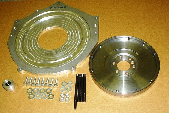

Is it like this ...? :drunk:

I "mapped out" the pattern for the engine-side of our bellhousing by using the engine plate holes (after checking the concentricity of the center hole). Lots of triangulation and checking of each hole, but the process was quite straightforward with a 12" caliper.
The bellhousing pattern is the same as the small block chevy except one hole is not used and there are the two additional holes in the bottom that go into the oil pan. PM me for more information.
