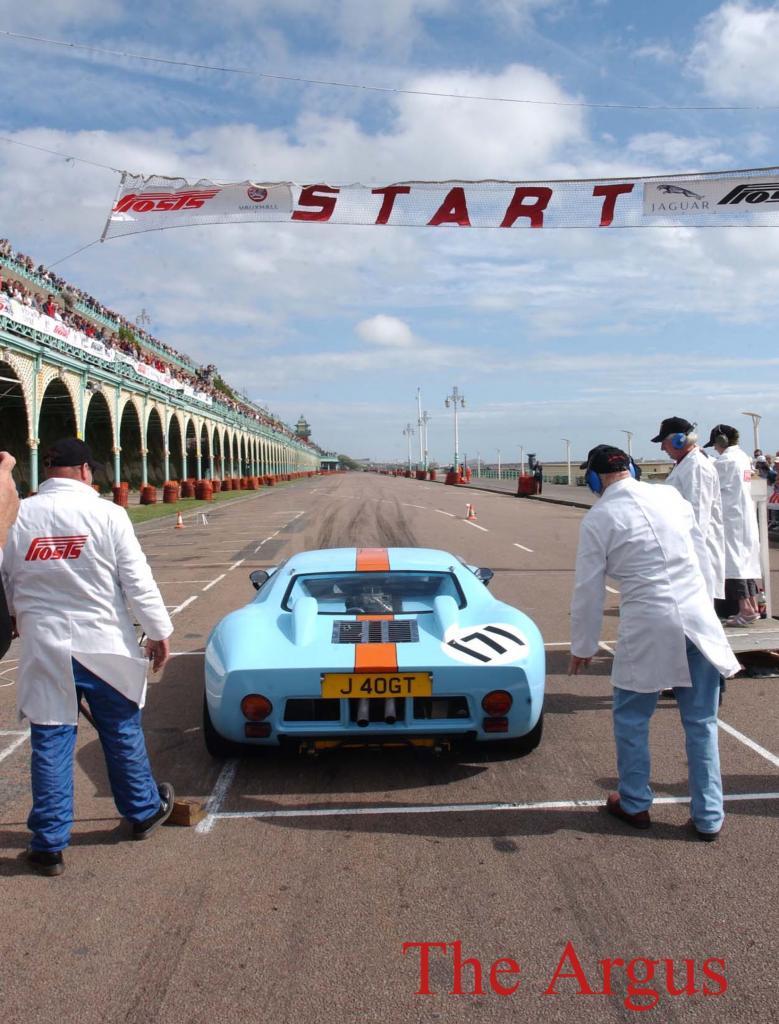

I'm Looking at different options for the rear deck aperture grilles.
If you have some pictures of some different styles that would be good.

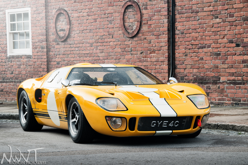

I'll add some fantastic body photos, but not from the angles you are requesting:

Leave the rear exposed but not wanting a bald one, suggest you have a top grill only!
