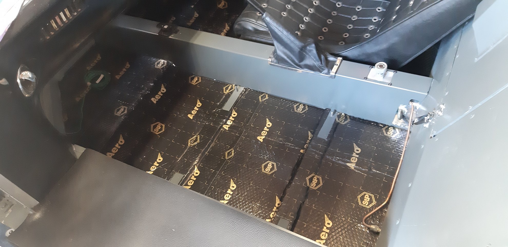

Mine run over the tunnel with heat insulation between it, as I don't like heat transfer from my coolant pipes into my brake & clutch pipes.
I made an alloy cover, to cover it all up..

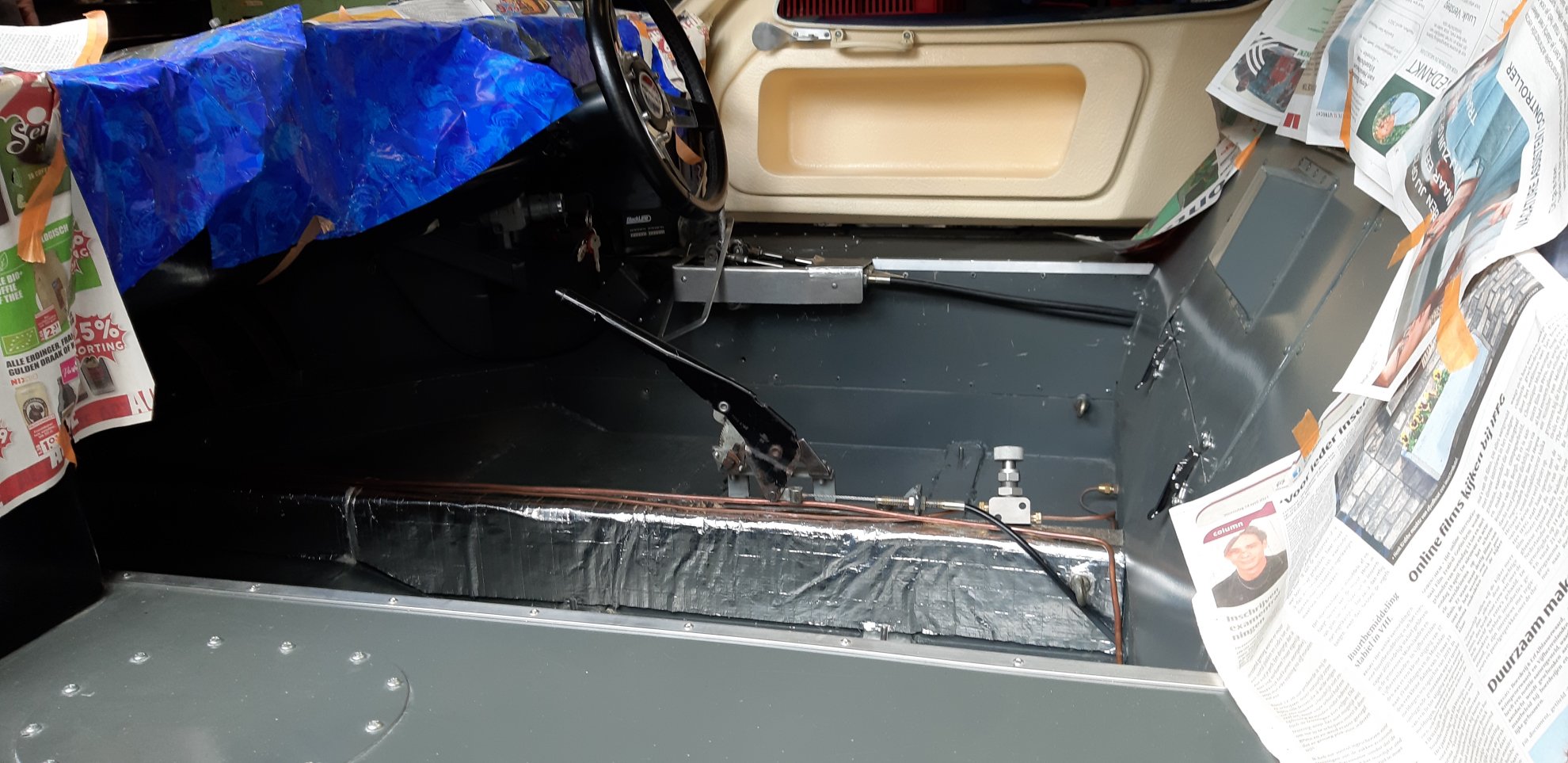

In my DAX the clutch, brake and loom run under the cover that goes over the gear change mechanism.
it is RHD in the U.K. so these run along side the drivers right leg with a fibreglass cover between everything and the cockpit itself.
