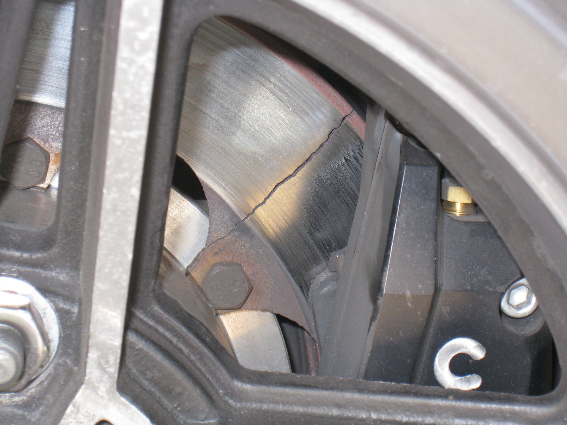

Doc. All 4 rotors have .003 or less run out and there are no cracks in them at all.
