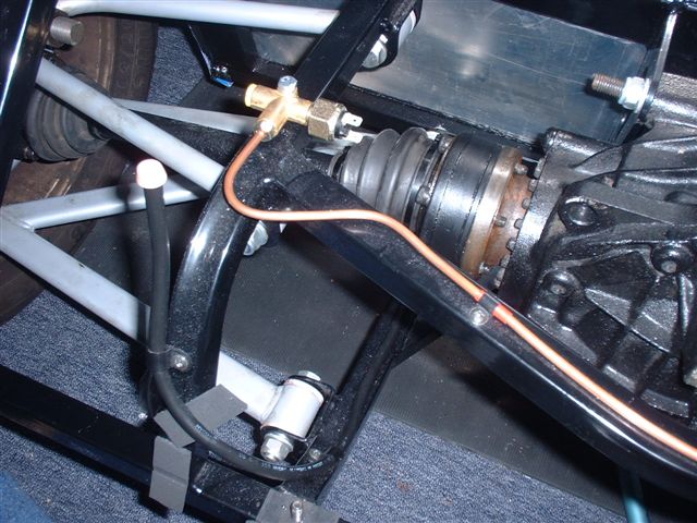

Pressure brake switches can be installed anywhere on the brake lines, this one is fitted to a tee on the rear lines, you could replace an exsisting tee with a 4way adaptor and not have to cut the brake line. Pressure switches are around £6 from Demon tweeks or most motor factors.

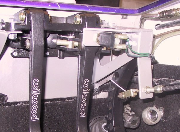

Here's a simple one that Frank Catt uses on his pedal boxes. Its a microswitch detecting the pedal movement. You should be able to rig something up like this, though I do think the hydraulic method is simplest even if you have just finished bleeding your brakes!
If you have a cross or tee to add a hydraulic switch then you can stop too much fluid loss by using a plastic sheet under the master cylinder reservoir cap when you screw it on - it will create a vacuum and limit loss without total draining of the system.
