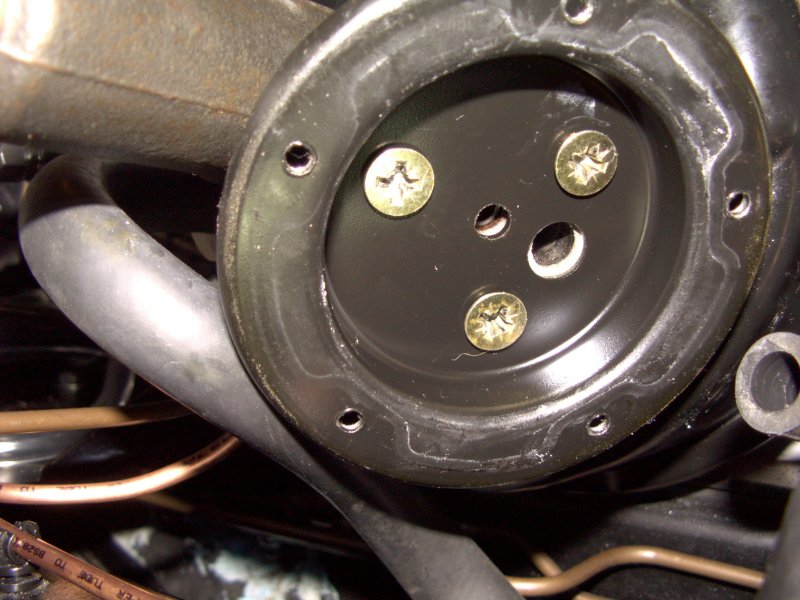

I had a similar problem on my KVA. It runs a set of Tilton pedals with a brake balance bar operating the front and rear master cylinders. The bearing inside the head of the pedal which the bar runs through had worn badly. Changed that and the problem was sorted.
Rob,
I was coming back from Stoneleigh after having just got my GTD back on the road after it had only done 1450 miles in 8 years (significant). Running down the M40 from Leamington Spa to High Wycombe, the car felt as if it was running on a corrugated surface. On pulling off the slip road, the front brakes were smoking and stinking to high heaven and the discs were an interesting shade of blue! The whole lot went back to normal after only a few minutes' stop. Further investigation once the excitement died down revealed that the brakes were slow to release - sometimes taking up to 5 seconds before the car stopped slowing down.
So, off to Wealden Engineering, where Frank Catt had modified the pedals and fitted twin Tilton master cylinders some month before. He went straight for the front servo, where there is a little shuttle valve that releases brake pressure when the air pressure across a diaphragm is equalised (the valve is down the hole in the centre of the pic). The shuttle bore had rust in it; a pencil with very fine emery wrapped round it polished out the bore so the shuttle valve slipped in and out smoothly - you will need to lubricate the shuttle seals with brake fluid and have a pair of fine-nosed internal pliers to grip the inside of the valve to get it out. Don't force it in, you won't get it out again! Also when reassembling the diaphragm, make sure to seat the diaphragm lugs in the recesses in the cover properly, as an air leak will cause the same symptoms.
With the engine running and an assistant turning the front wheels, stamp on the brake pedal and check that the brakes come off IMMEDIATELY on release. If they don't, listen for the air leak with a piece of hose.
If this doesn't help you sort it, contact Wealden Engineering. They love bleeding brakes 3 times in a morning and can whip a servo to bits in seconds!

Thanks Tony, that was a good tip for me, the shuttle valve has fluid on the inside, and air on the outside, so the valve bore can rust. I did both servos, sure enough the servo for the rear brakes had patches of rust and had collected some between the seals. I used a 7.5mm drill shank with 1200 grade emery wrapped around it.
Missed your comment "make sure to seat the diaphragm lugs in the recesses in the cover properly" and had a whistling noise due to the leak. Seems ok now, time will tell.
