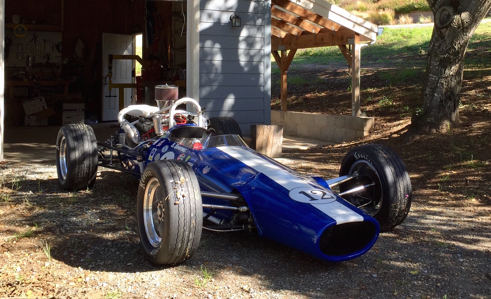

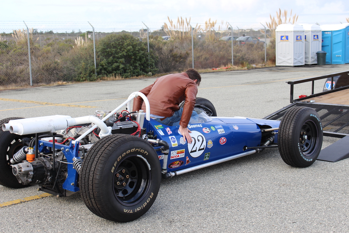

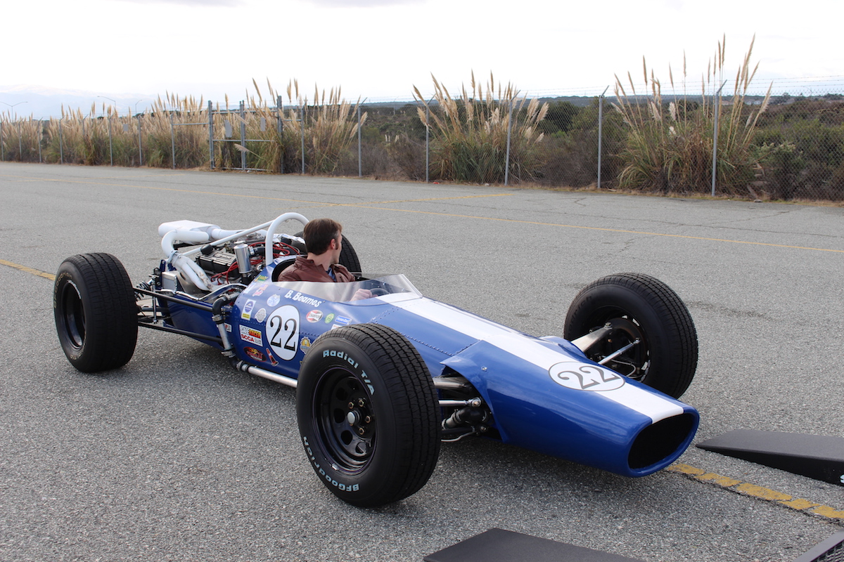

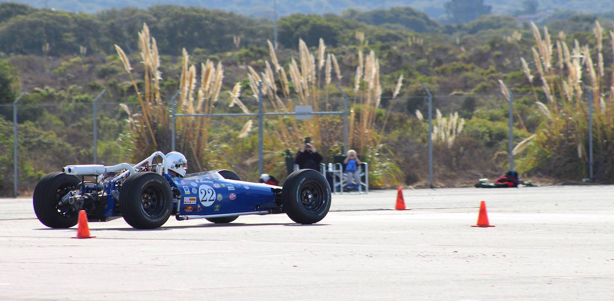

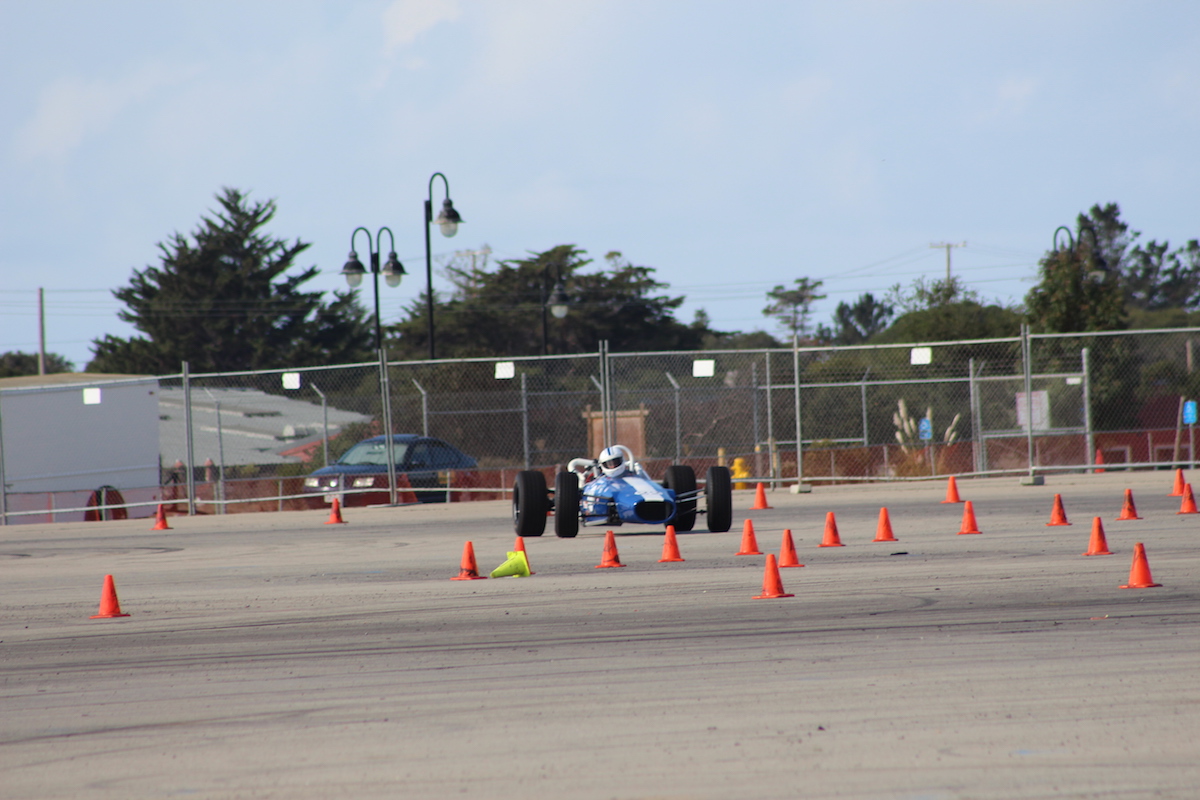

I finally got a trailer and got the car to the last autox vent of the year out here. Unfortunately it was a pretty tight course and my car isn't exactly small. I still have oversized (almost truck sized) tires on the car making it ride high and looking ridiculous, but I wanted the thing up off the ground to be sure it wouldn't slam its nose under braking or something.
I've never had this much engine behind me in a race car and its not the horsepower that was startling (I was never really in the meat of the power band as 1st was a little short and 2nd a little tall for this course with these tall tires). It was the engine braking. I could enter a turn, take my foot off the brake but leave it off the gas and the car would rotate. I spun the first time I did this, and then realized I could utilize it. But this event was more about being a shakedown then going fast (and I was pretty darn slow in the time sheets). I had a somewhat scary clunking noise that turned out to be a heat shield flapping just enough to tap the battery bracket and act like a bell. Easy fix.
So more of my brain was paying attention to the car then to driving the course. I'm sure there were people out there wondering why I was so slow and why I wasn't hitting the gas at certain points (I was listening for things).
Beyond that, the car was much better balanced then I thought it would be. Once I'm finished checking every weld, rivet, and bolt for any failures, and make some adjustments to make it more comfortable in the cockpit, I'm going to be really desperate to get it back out on track and drive it hard in the rev range.

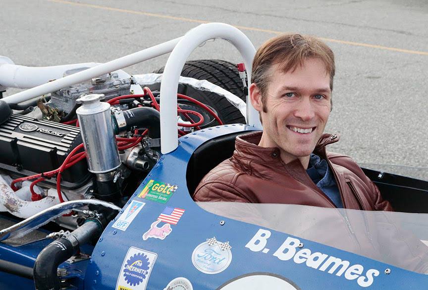

In the extra wide picture with two people sitting in the background taking pictures, that's my uncle and my son :)

Nice job Ben!
Ah yes, trailing throttle oversteer is what you experienced. Try it at 150 mph in traffic some time if you really want to get religion quickly....
Looks like a whole lot of wheel weights on that right rear..
Hope your nut-n-bolt session turns up looking well...
Yeah trailing throttle oversteer, but I've never experienced it AFTER I've braked for a turn. That is in the moment between foot on brake and foot on gas. I'll admit my "moment" was a longer than it should have been, but I was trying to pay attention to which tires were squealing.
And yeah, on the wheel weights. Apprently when you only pay $45 for a wheel they aren't very balanced to start out. . .nor terribly round. I've got aluminum wheels picked out but until I'm ready for new tires (or a giant influx of money comes in) they'll have to wait.

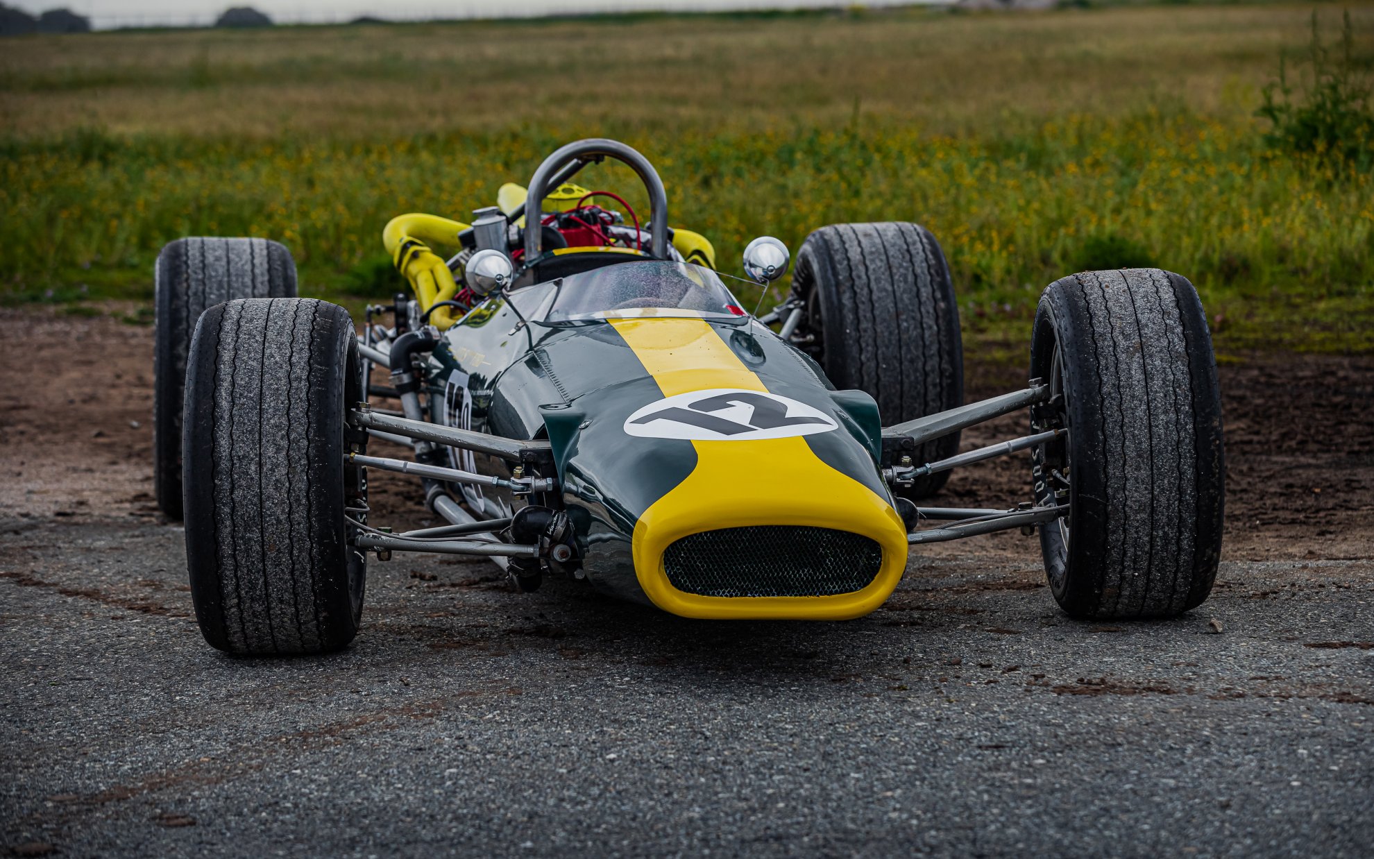

Now having had a couple of autocross events completed, and having gotten tired of not having any traction what so ever, I've put on some lighter wheels and vintage racing hoosiers. The car lost 70 lbs of unsprung weight in the process and is now down to 1420 lbs. It looks better too :)
If you want to see what it looked like on the oversized hard tires that's right here:
Project 22 Second Event. NEED BETTER TIRES!!! - YouTube

Ian Anderson
Hi
Can you alter your seating position to lie more, if not please raise your roll over hoop as your head is the highest point!
Back in my single seat days a straight edge between roll hoop and top of front tyres and top of helmet had to be two inches below that line.
Accidents do happen and better safe than sorry!
Other than that it looks like a lot of fun!

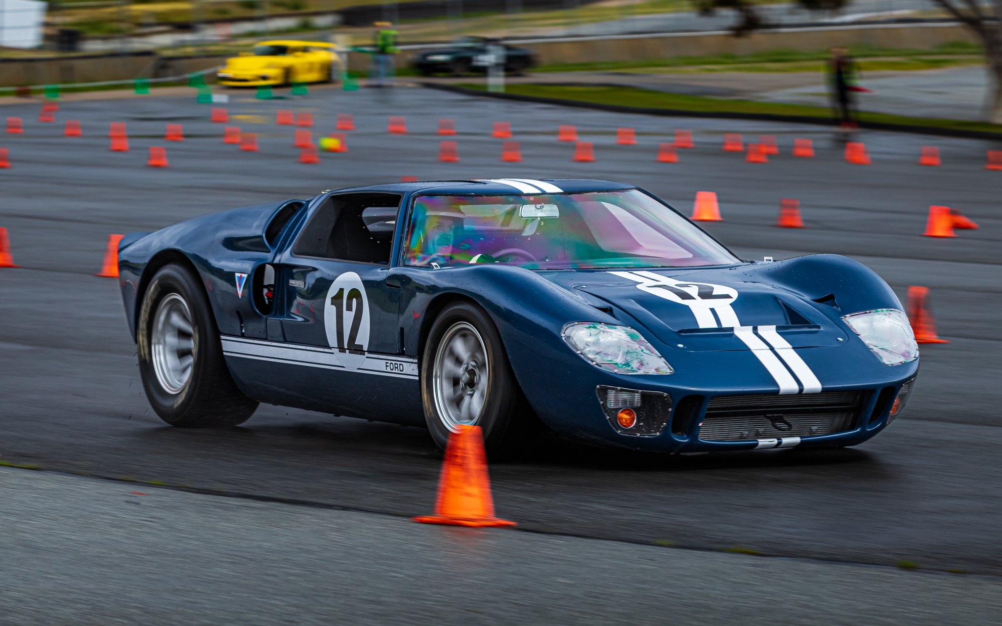

Remember this car? I made a new nose for it, won a few local autox's, painted it green and then. . . built a GT40! I just made a video series on youtube about it.
The preview is here:
and the whole thing so far is here: https://www.youtube.com/playlist?list=PLoolQMkFx9To6Mc-okimaFLEmiIQkr2uc
There's plenty in it to make fun of. Its more of a "this is what I tried/did" than a "this is how you do things" video.

Wow, what a surprise.....
I followed this thread and was wondering what you are up to next - now I knowo_O
Markus
Its been a wild ride. After the 38, I was pretty broke for a while, both the build and my living expenses went way up. Then I got a better job and had money but no time. I started very slowly building the GT40, then the pandemic happened and suddenly my commute vanished giving me 3 more hours a day. So the GT40 build went from a planned 3 years to a year and a half. I got so used to keeping myself busy on this stuff I had to force myself not to start another project last winter (that was part of why I made the videos-- something to do). And now I keep bouncing back and forth from having too many events to do to not enough.
