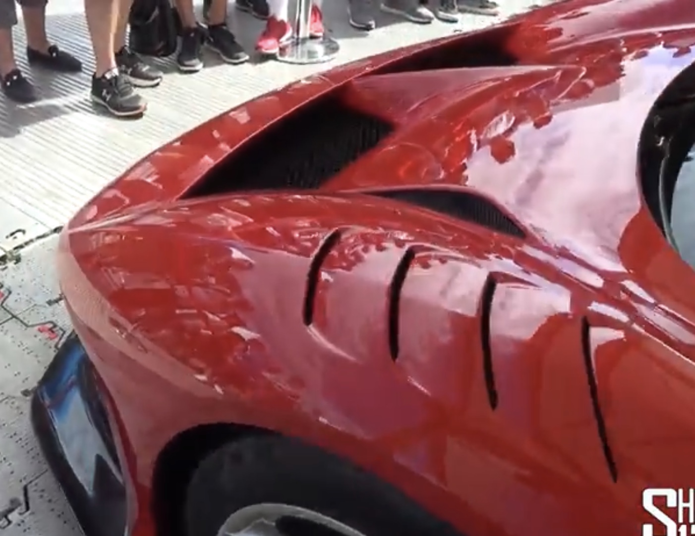

  2. Wheel Vents - as noted above, I initially contracted to get the Carbon Fiber wheel vents. Then I saw the wheel vents on the Ferrari P80/C and I JUST couldn't unsee them or forget about them. So Fran and I are looking at just cutting the shape of vents into the existing fender to make them similar to the following

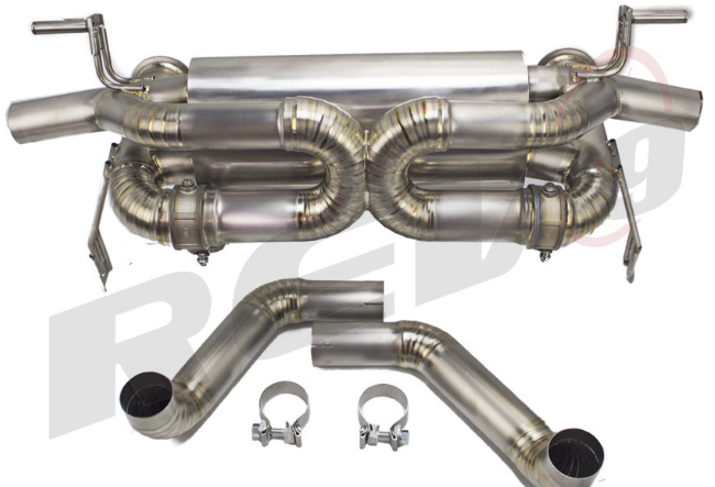

Happy Thanksgiving all - I was thinking of buying this R8 Exhaust. The Exhaust canister size: 17" x 8" x 4.5" approx. It appears from other race rail cars that there is more than 9” in height between transaxle and the underside of the rear clam.
Question - can someone confirm how much room do we have on the Racetail between the transaxle and the underside of the rear clam? Is it more than 9-10 inches?
That is a gorgeous exhaust, but it seems like it may not fit under the race tail.
I just measured my R8/Gallardo exhaust clearance and there is ~6.25" between the top of my Graziano Transaxle (aft of the shifter) and the Race Tail.
My Quicksilver muffler is 5.5" tall and there is 0.5" clearance above the transaxle and 0.25" from touching the Race tail.
Hmm. I am also doing the rear scoop which may give me the extra room. The other thing that “may” be possible is to lay muffler on its side so that the pipers are on the top. This would also save an inch. Going to call Fran on Monday to see if they can be squeezed in. Fingers crossed

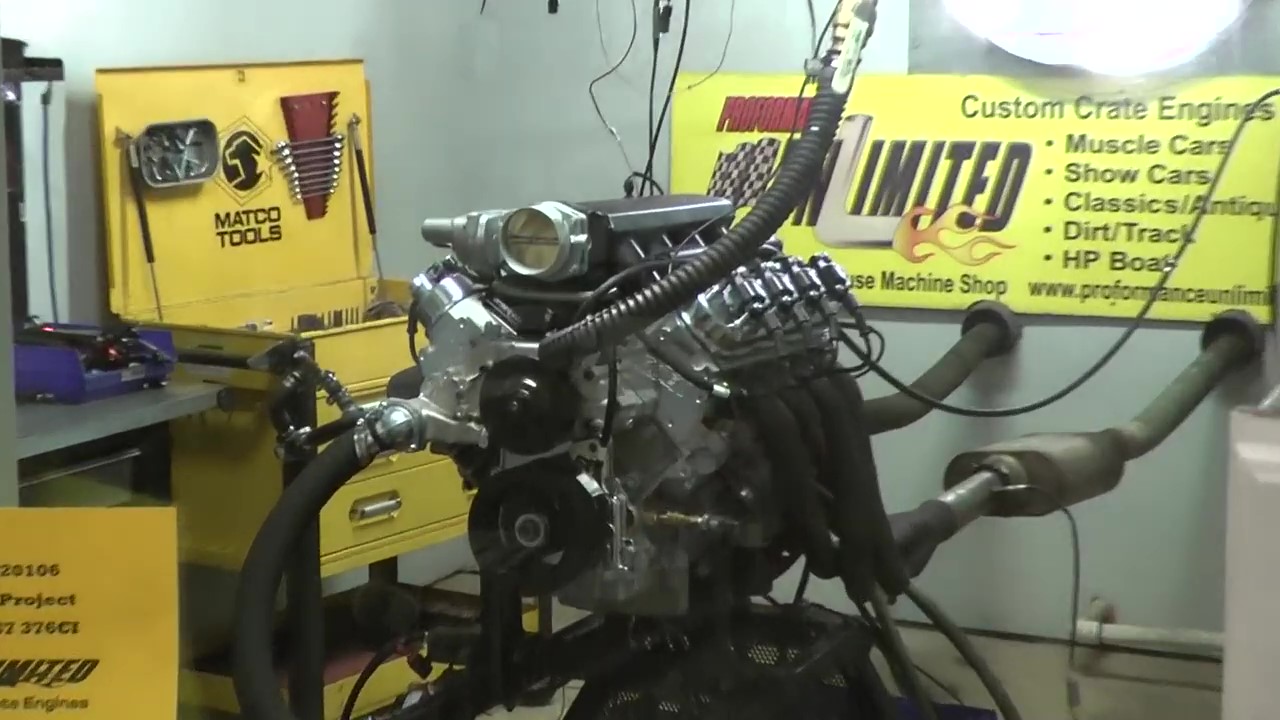

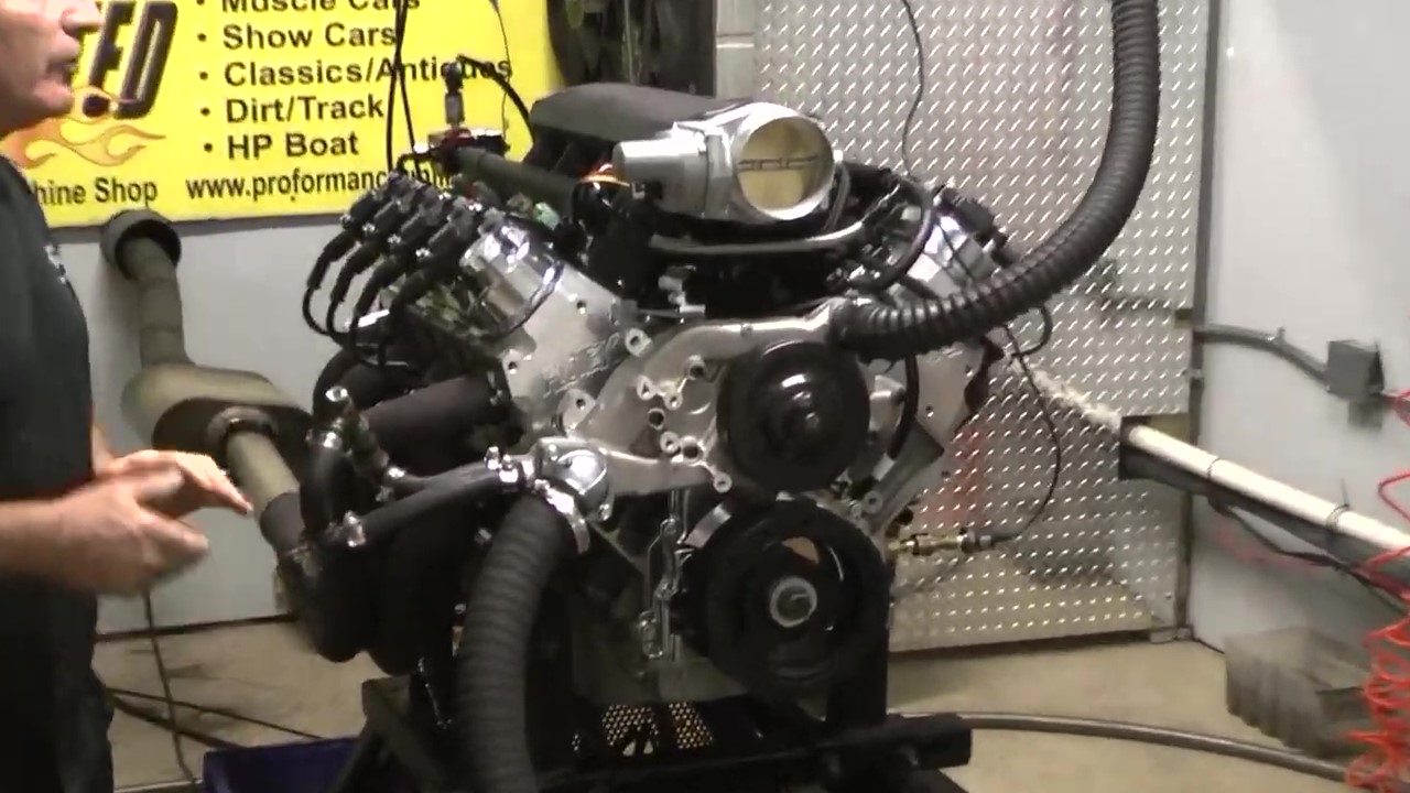

Engine - My LS3 Engine was completed and I'm super happy with it. As mentioned above, I didn't buy a crate engine...instead I went the route of having a professional engine builder build a completely custom engine using the best components. It cost me an extra $2500 but came with the 2 year warranty by the builder (Steve at Crate Engines | Proformance Unlimted (proformanceunlimited.com) ). Happy to share the dyno video if anyone is interested. (PM me)

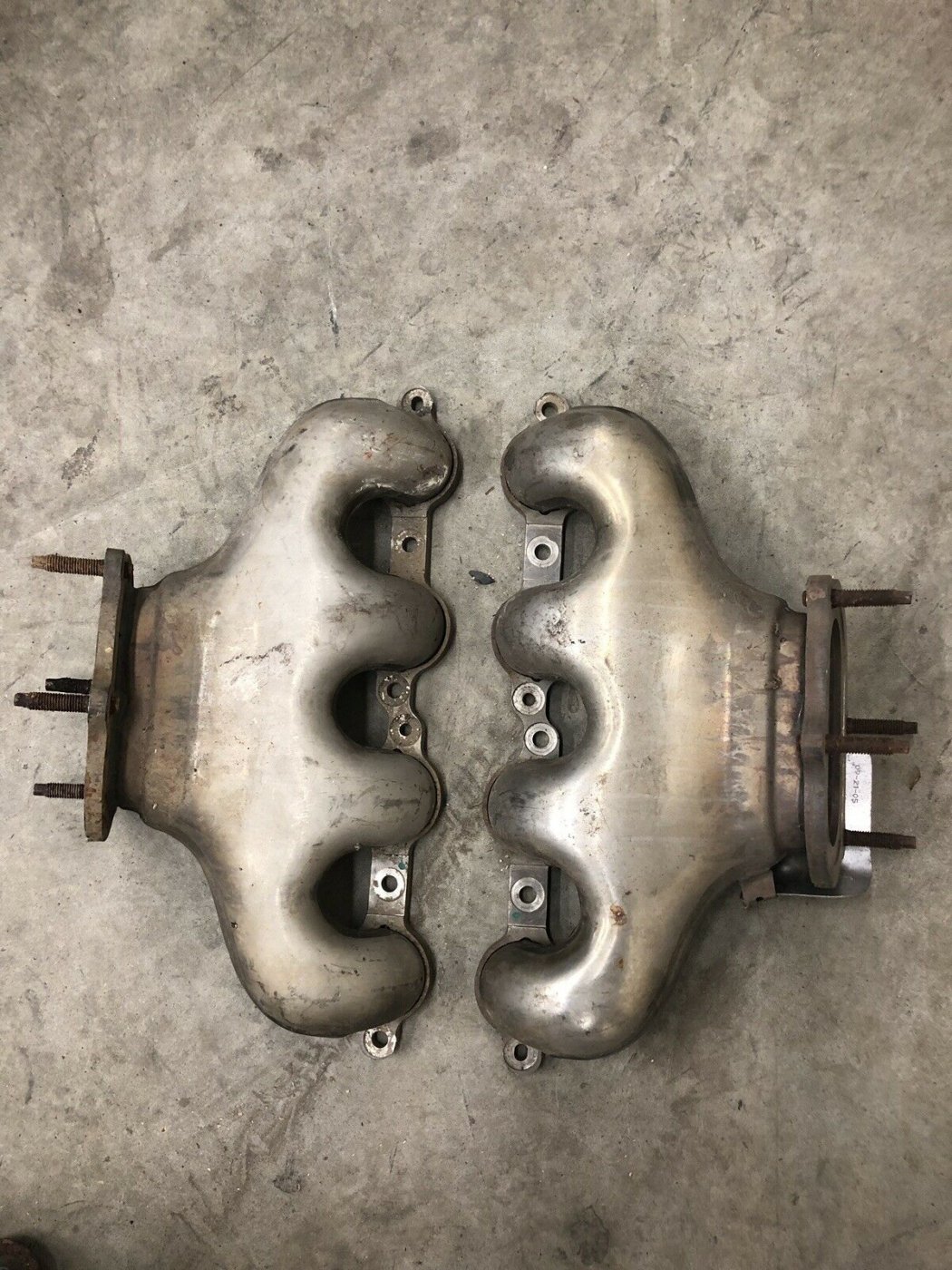

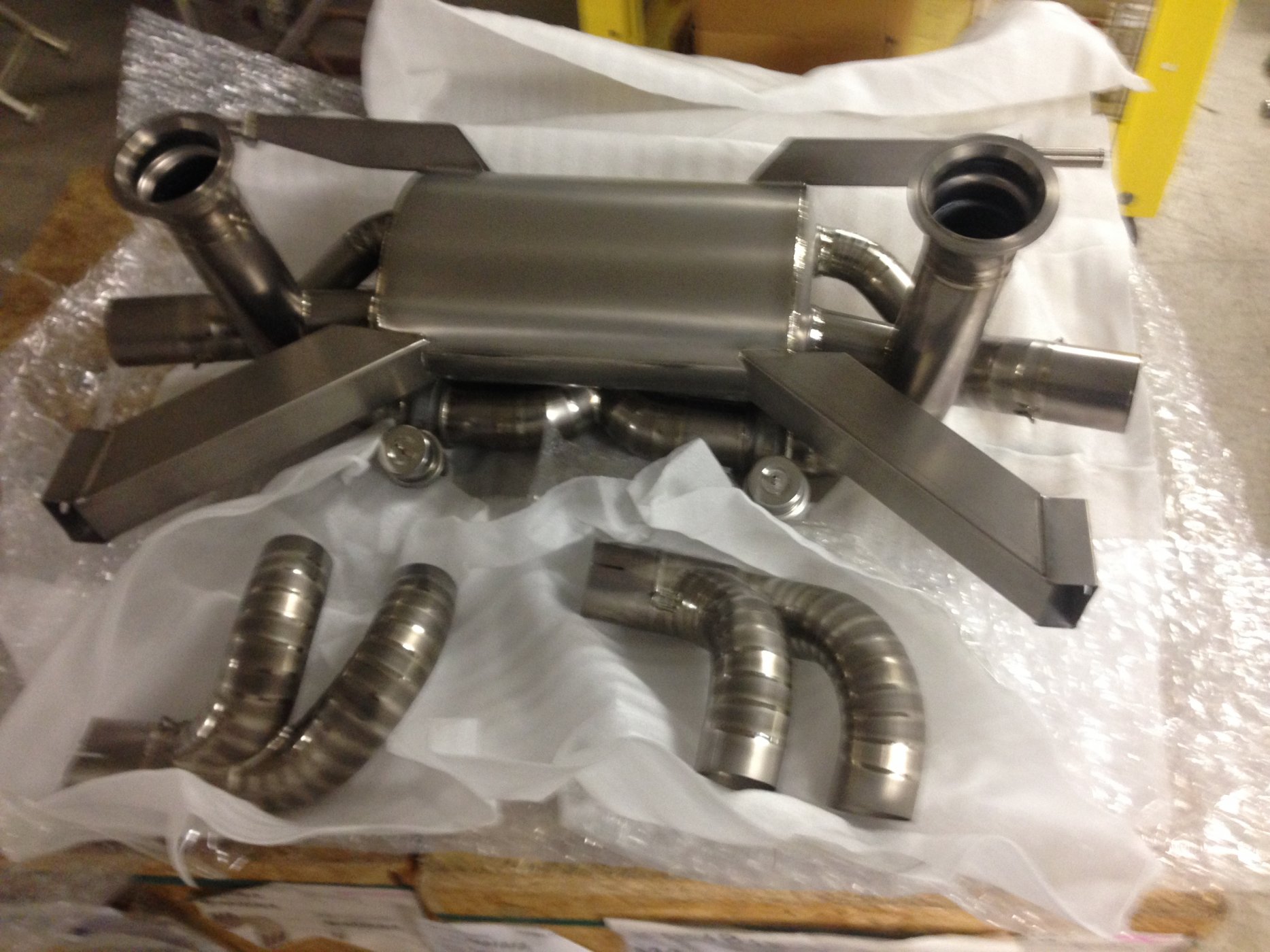

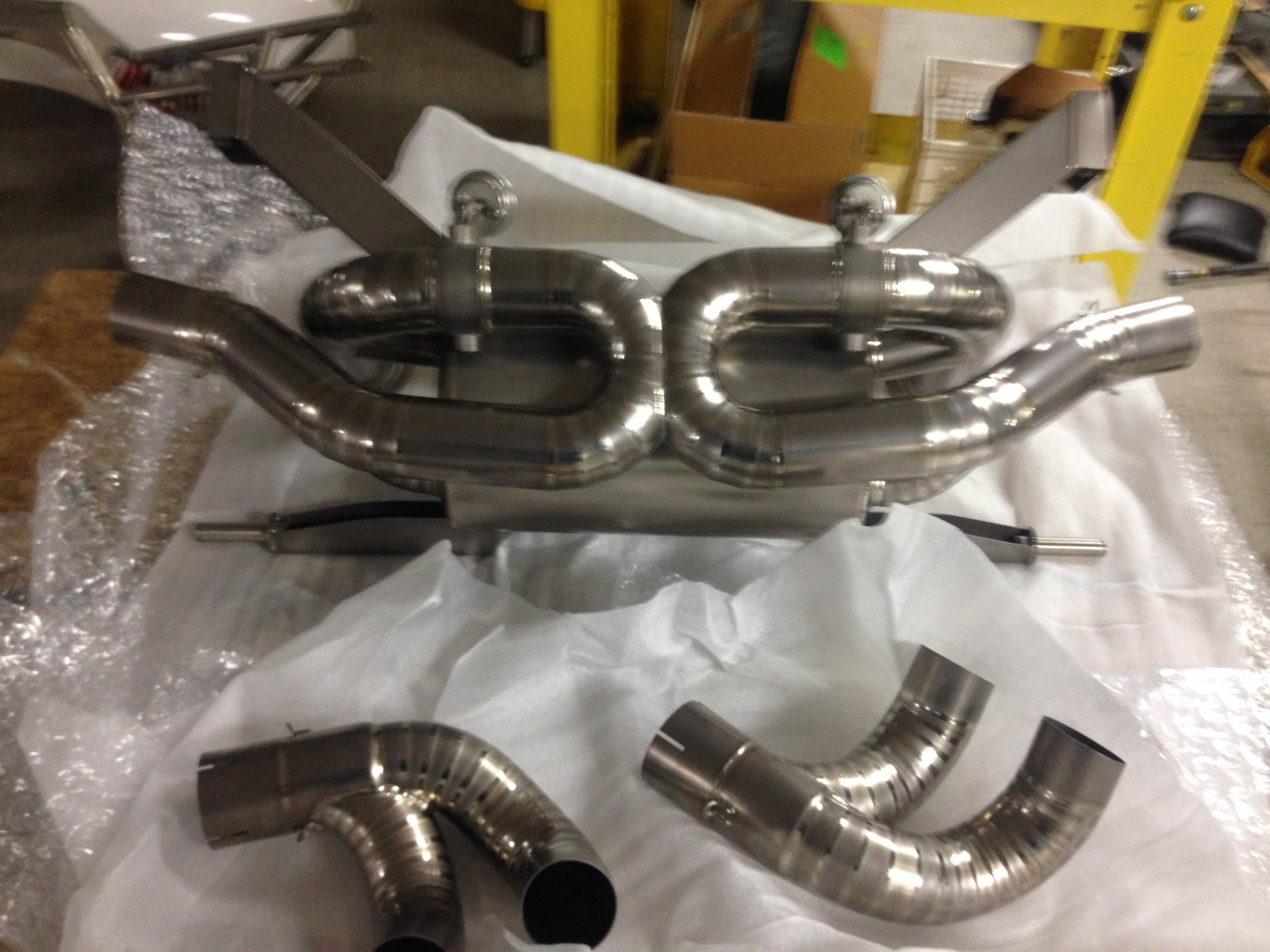

Exhaust - after A LOT of research, I found a CAT back valved titanium exhaust system that was very budget oriented. Here are two pics of it delivered to RCR this week. I also ordered a set of LS7 exhaust headers per Frans advice. To make the Titanium Exhaust system work work, Fran said that he will need to modify the splitter on my race tail.

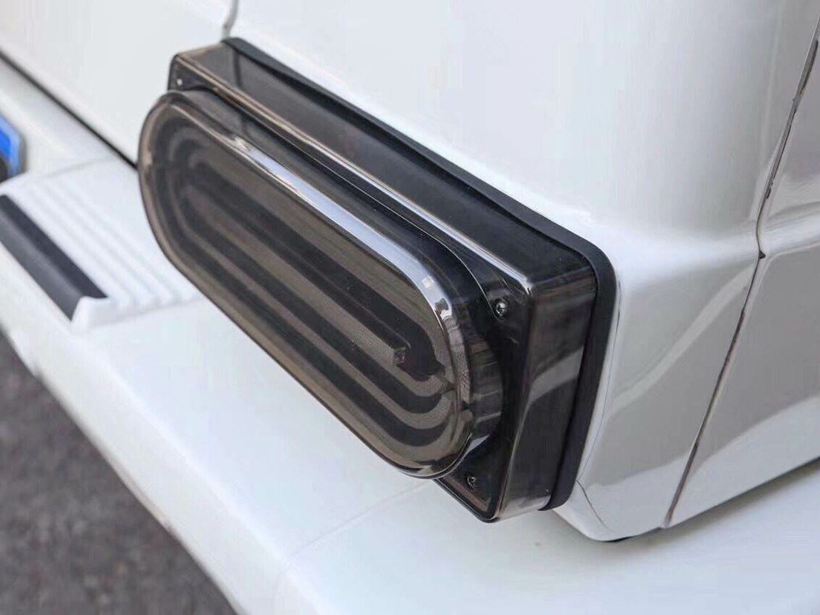

  • I am pretty close to selecting the tail lights. Given the flat nature of the rear Race Tail, I have been trying to finding Stock LED Tail Lights that fit the flat profile. NOT MUCH OUT THERE....Unit I spotted the Mercedes G Wagon. And they kinda look like the Agera tail lights...So here is what I am leaning towards. Note - only the oval part will stick through the body.

"I am pretty close to selecting the tail lights. Given the flat nature of the rear Race Tail, I have been trying to finding Stock LED Tail Lights that fit the flat profile. NOT MUCH OUT THERE....Unit I spotted the Mercedes G Wagon. And they kinda look like the Agera tail lights...So here is what I am leaning towards. Note - only the oval part will stick through the body."
For flat surface lights look in truck/trailer parts suppliers.

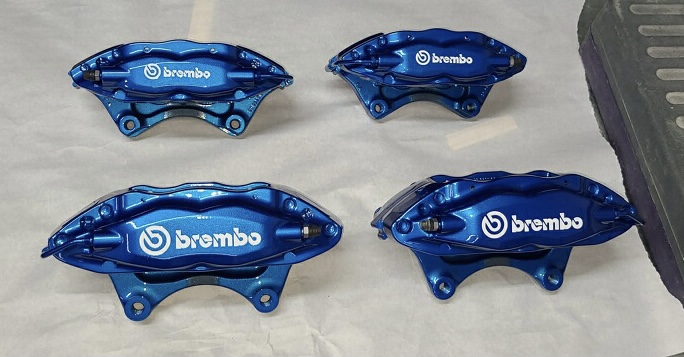

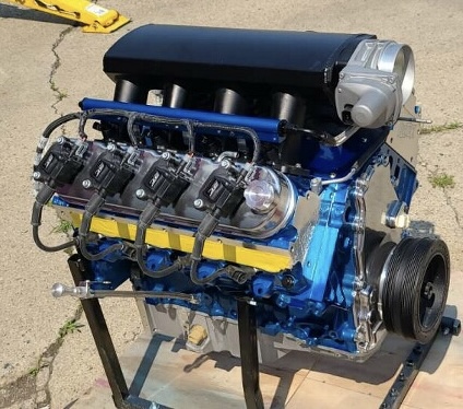

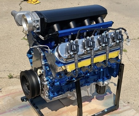

Regarding my build. It has been very challenging to see nothing happening for the last 6 months. The engine was delivered in mid Jan and Fran was waiting on the body and paint guy to paint the engine and calipers. After a lot of phone calls and texts from both Fran and l, my engine and brake calipers were finally painted this week and were delivered back to Fran today.
Here are a few pictures. The paint I chose is the 2020 Lexus Sapphire Metallic blue (paint code 44J). Steve did what looks like a great job (I haven’t seen them in person). From these pics he sent me, I think it looks stunning. I’m really hoping that the Sapphire Metallic blue on the brake calipers will pop behind my gold rims and red car. Similarly hoping the Sapphire Metallic blue on the engine and the Gold heat insulation wrap in the engine bay will compliment each other and show well.

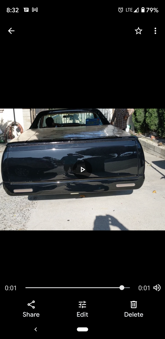

Hello Brian . I used these tail lights on a El Camino and they look amazing.yau can mount them on a flat surface.the tail light is only about an inch thick . possibly stacking two toughter ? It is very inexpensive . Just a thought
Thanks for the ideas. Those look a little narrow but I am going to look at that company to see if they have something that could work for what I am trying to accomplish. Really do appreciate it
