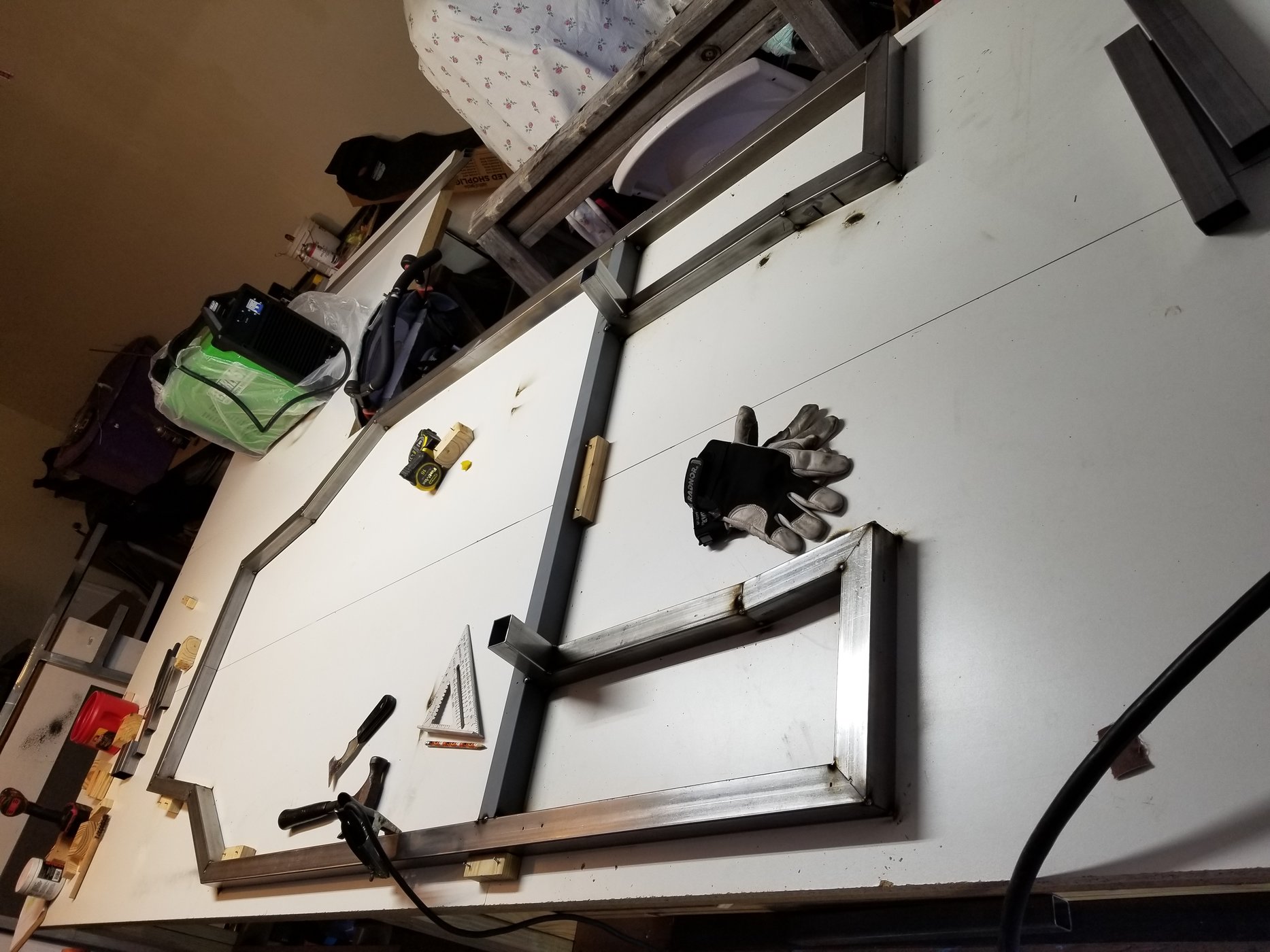

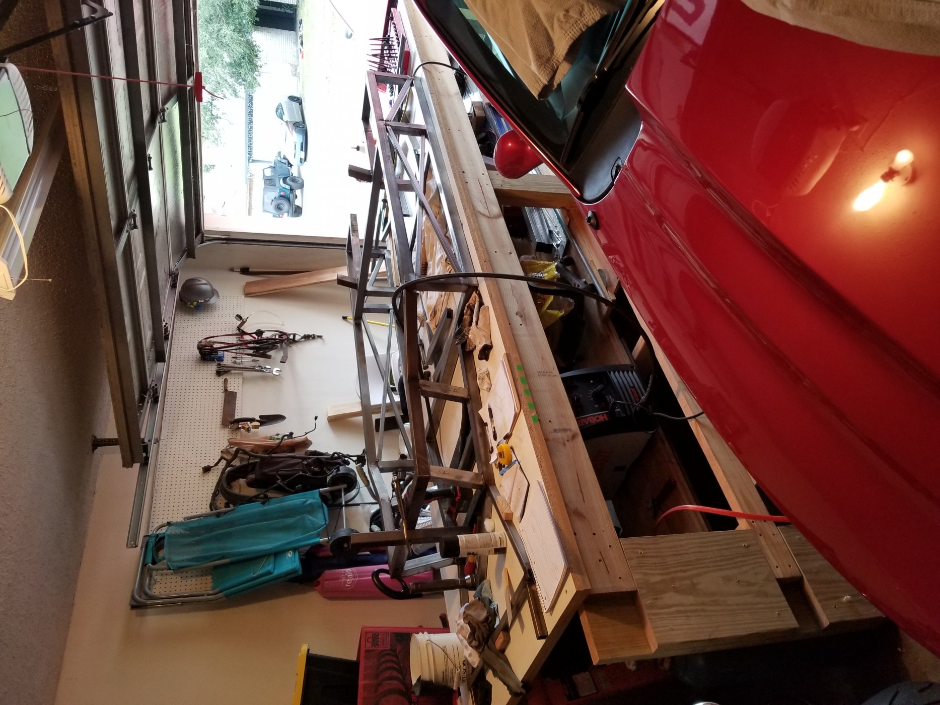

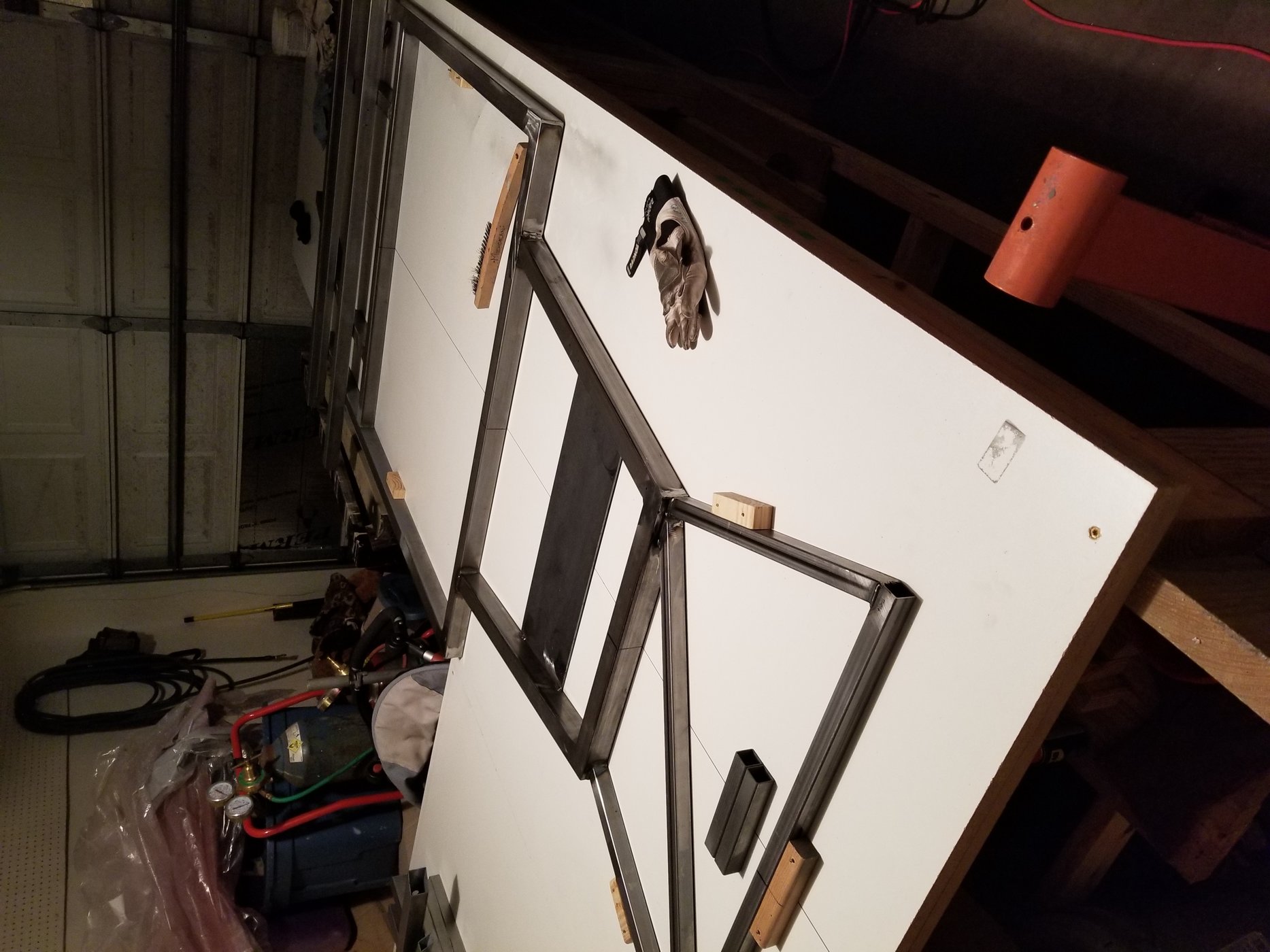

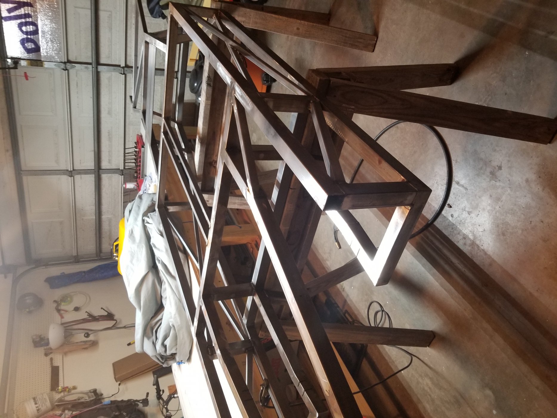

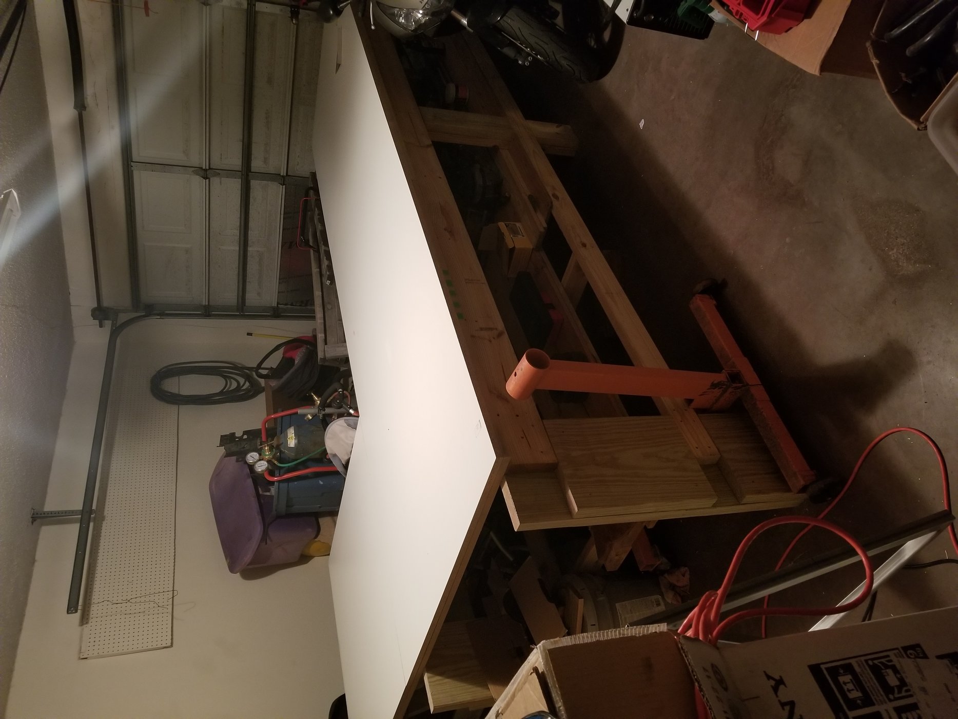

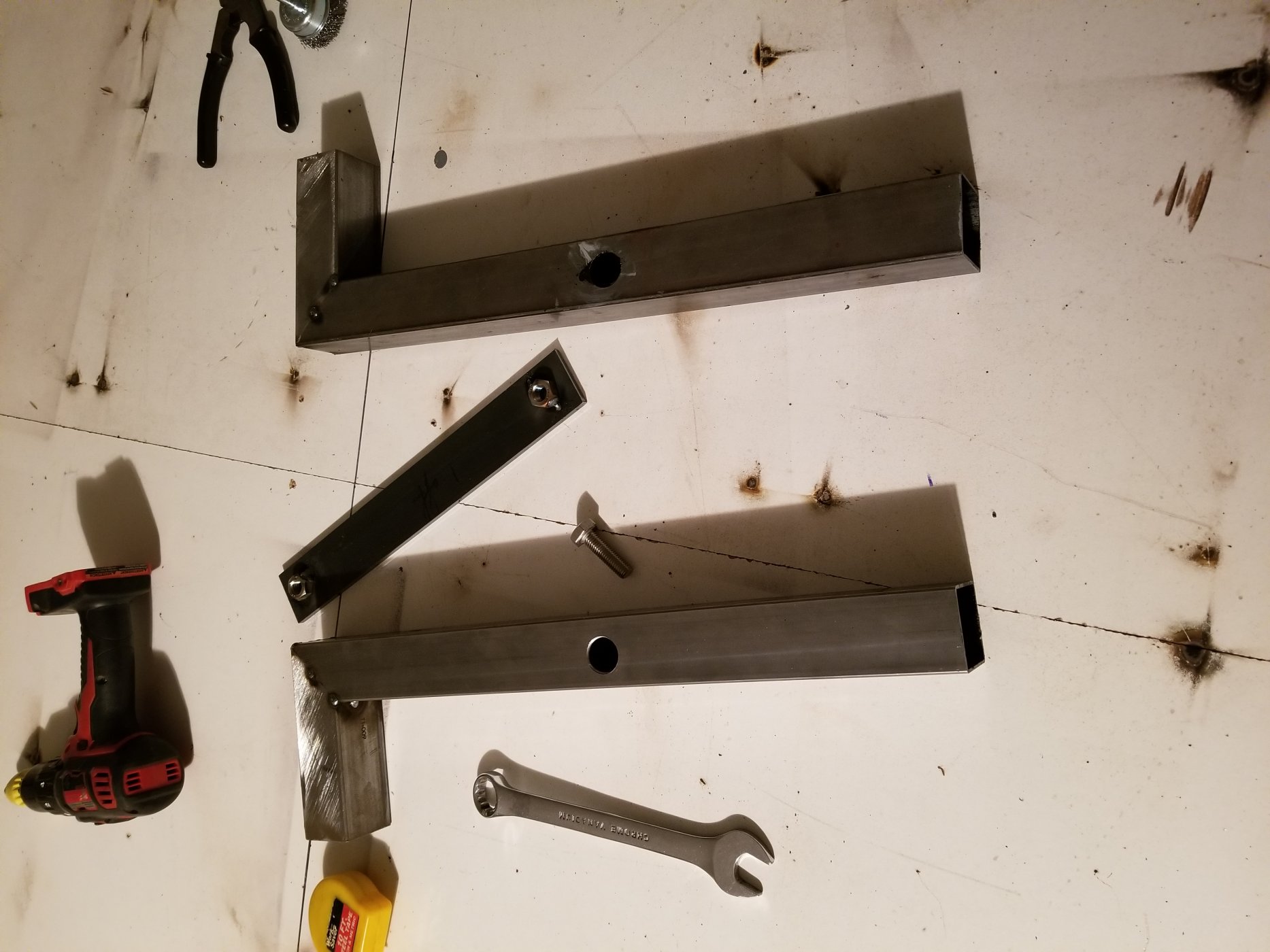

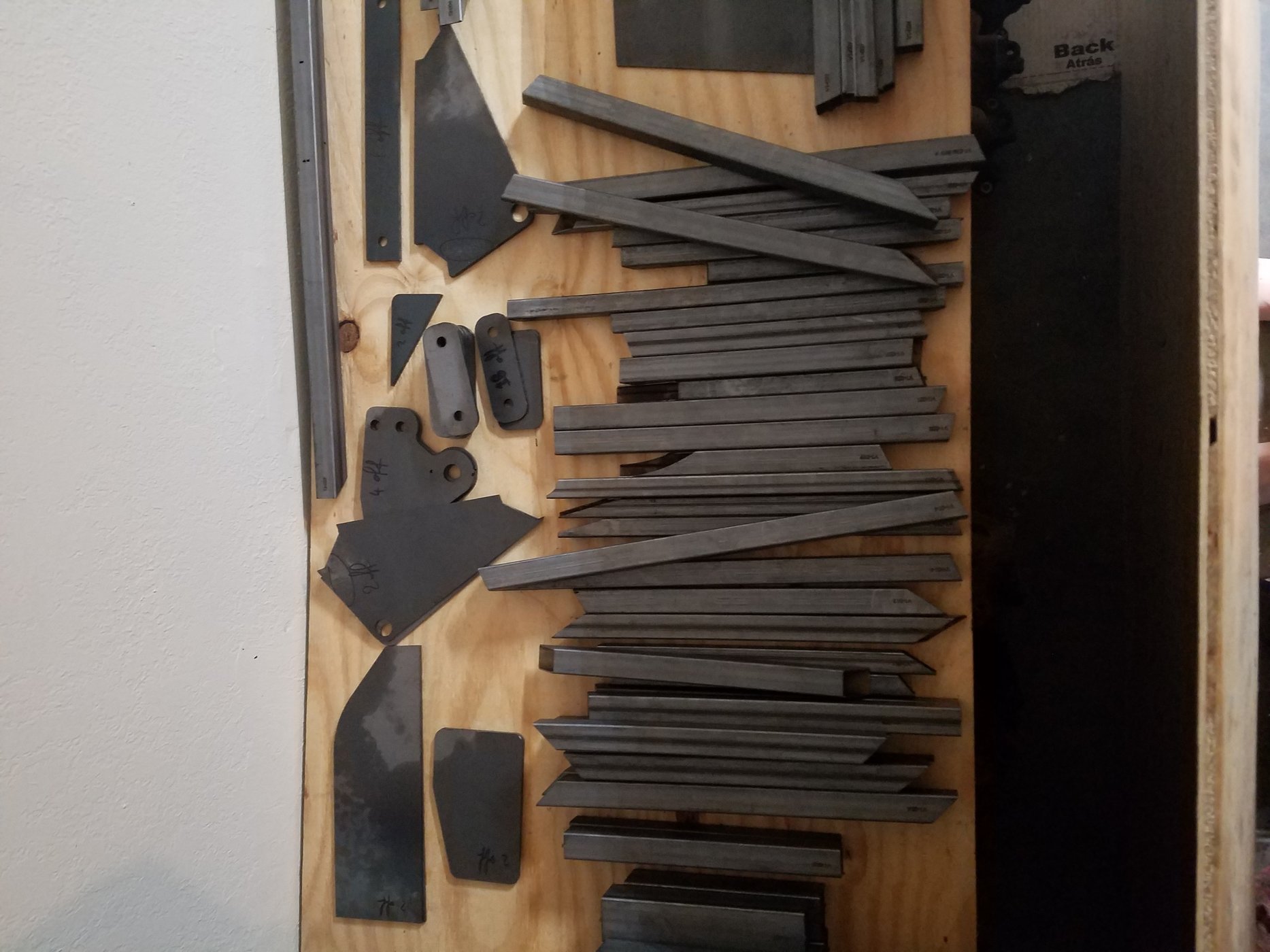

I purchased a Gt forte laser flat pack at the end of 2017. after looking over what i recieved and the instructions Darrin George sent me i began the journey to build my GT-40. I've decided to start a thread here to gather as much help and advice as i can. my first role of buisness to do was create a good table to build on. i designed my table to not only construct my gt-40 on, but also to build a airplane i have plans for in the future some time after my 40 is complete.

Bryan Koehler
And here are a few more which bring me to my current state of progress.20180915_123545.jpg

Thanks nick , I bet it does. Im actually working on the middle section now. Im following your build in the order of how you assembled the sections together. Although i weld out the entire frame each time i add to it and grind the bottom flush each time. So far its staying pretty flat.

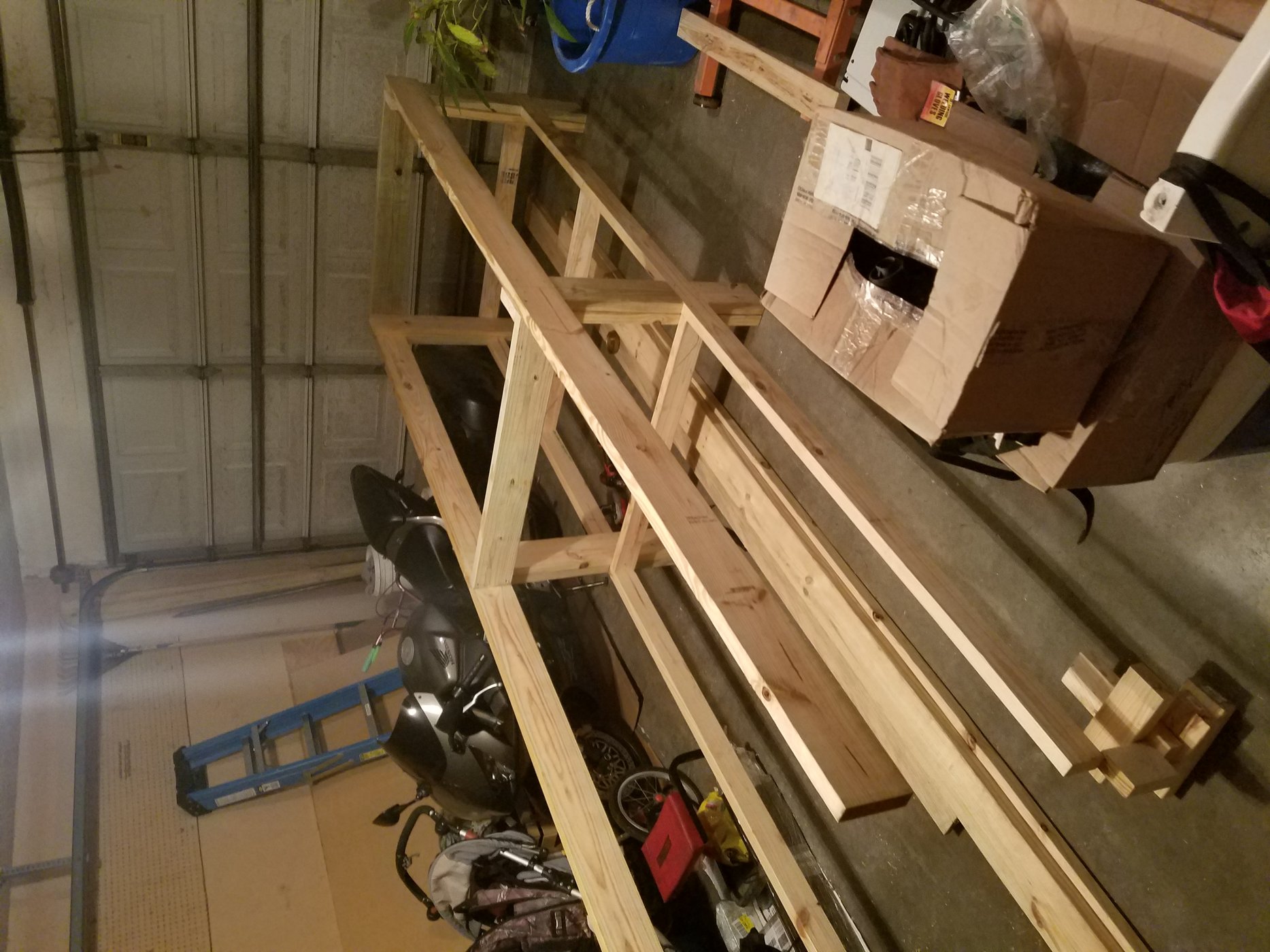

Hey charlie i used 2x6 for the frame with 2x12 at one end which is actually the middle of the table. Below the table is storage and im using 3/8 ply there. The top is two layers 1 layer of MDF 4x8 and then melamine 4x8 both are 3/4 inch thick if i remember right. If i did it over i would just use 3/4 inch plywood. Theres a spot where the 8 foot sheet ends and a 4 foot section begins, that has a slight low spot. I will eventually fix that but i just build on the 8 foot section when fitting up. This tables overall length will be 24 foot for a wing i will build one day. And the L shape is cause i didnt want to cut these sheets so i can use them for the second table later down the road. After the chassis is done i will dissasemble the table and move it back to my other shop , 2hrs away. R u n the USA? And did your kit come complete? If your looking for a cheap solution i would buy 3/4 ply finished on both sides. And clamp angle iron under it to keep it flat . And just check it with a straight edge.

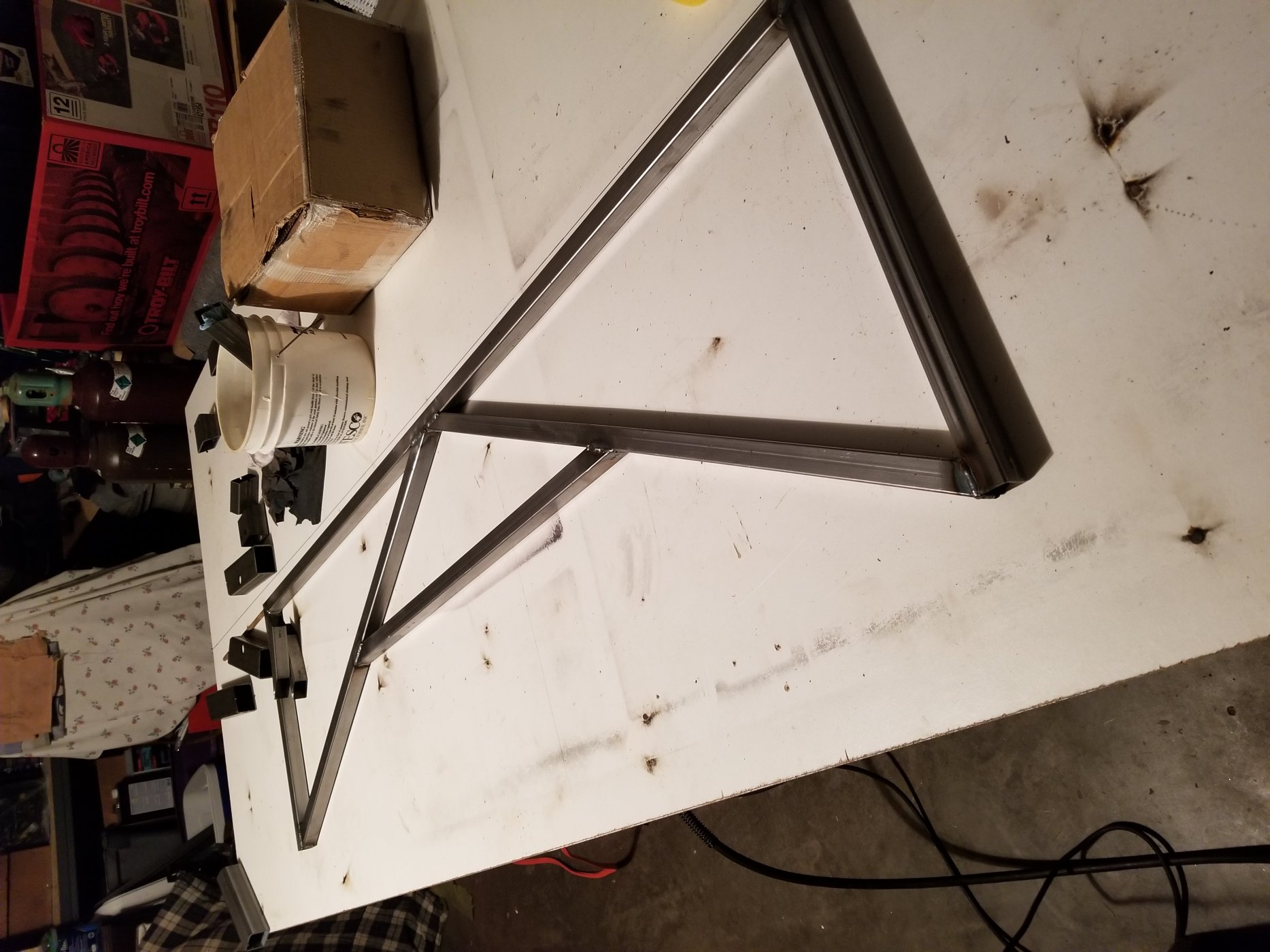

I welded up the middle rail section some time back in january. Then i had to take a break from the build to remodel the house. Hopefully i will get back to working on the 40 over the summer. No other real progress at this time. I did buy a Tig for Christmas but its still in the bag havent even pluged it in yet to see if its going to work. Gota get back to building. Will post new pics as soon as i make somemore progress

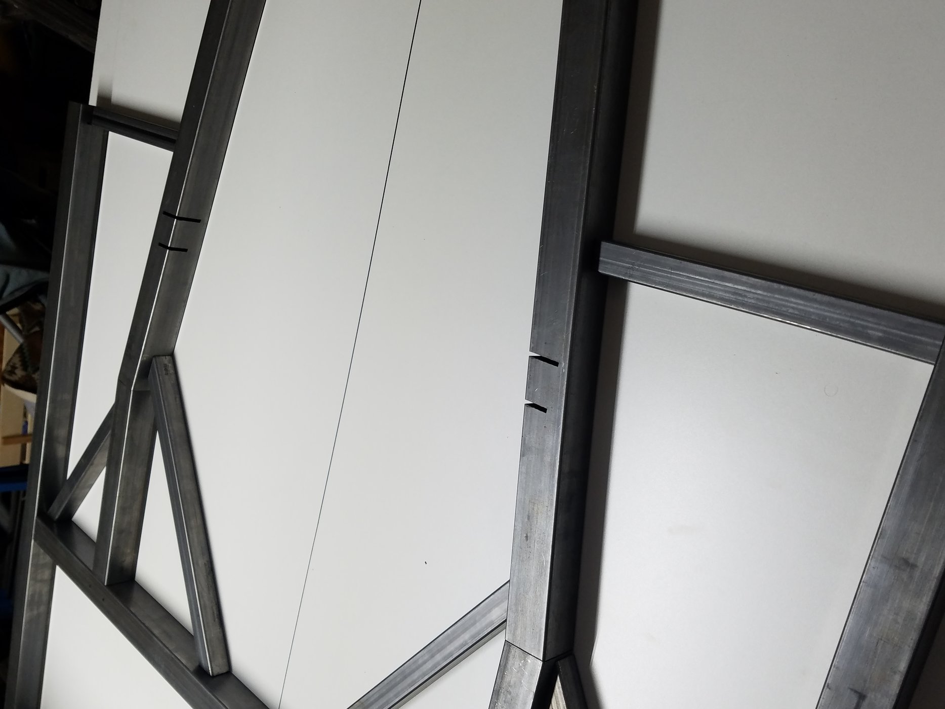

Made a mistake or two and had to cut and reposition a few of the tubes. Guess thats what i get for getting in a hurry. I mocked up the middle section and most of the vertical tubes that attach the two together. Everything jiged up good so hopefully this weekend i will be able to do some welding. Ive been searching for a source for 40mm sq tube. Its hard to find and expensive when i do find it. If you know of a good fairly priced source do let me know. I will eventually have to bite the bullit and order it so i can move on. I also am wondering what others are using for round tubing when fabricating A Arms and rear links. I was thinking 1.125 Dom with a .125 sidewall thickness. Or 1" chromoly with .083 wall. Let me know what some of you are using. And if someone has the full dimensions for the rear upright pm me i have a partial drawing of it and need a little more info.

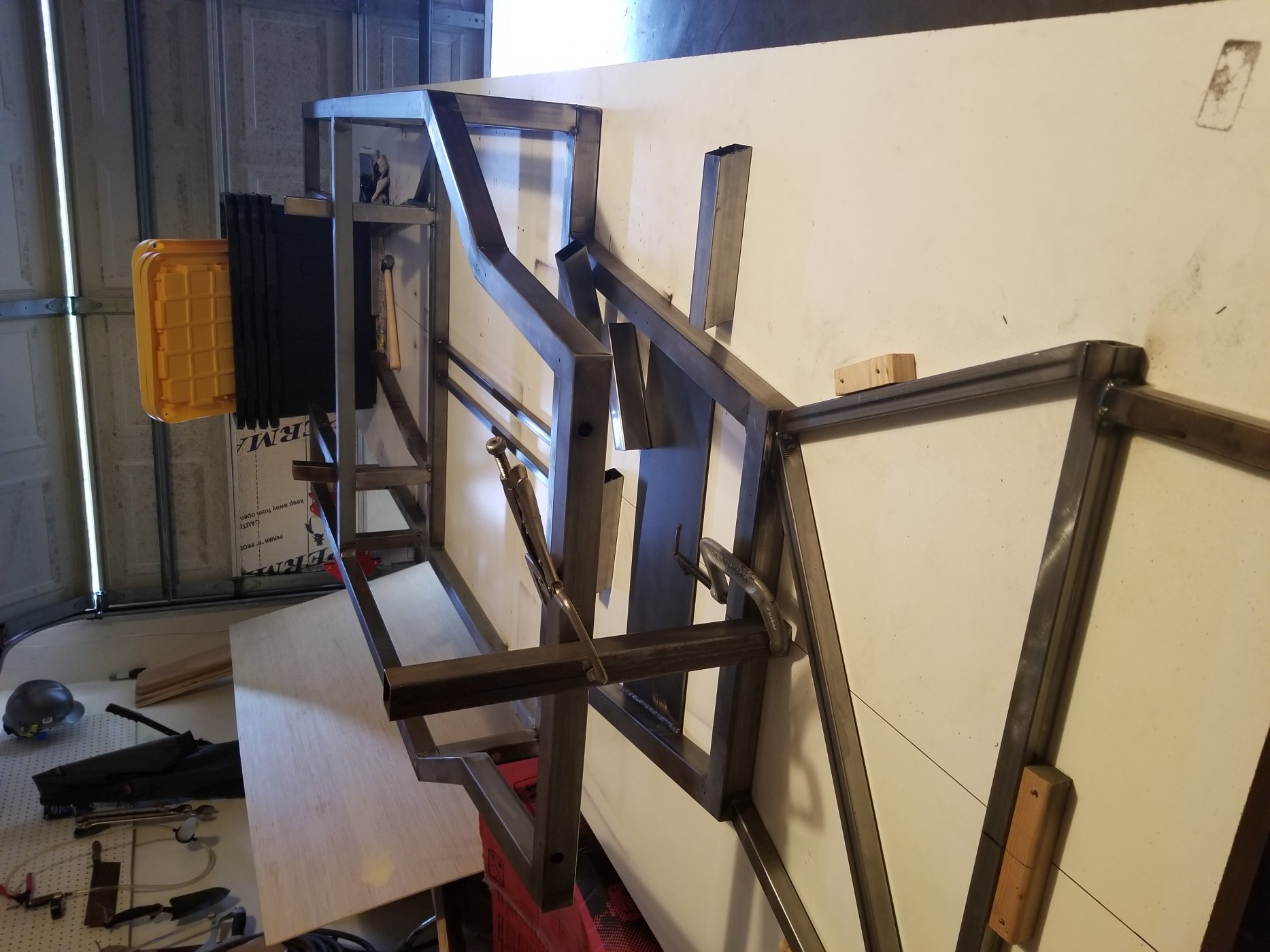

Joined my two sub assemblys together and i added the four front post although i havent took a picture of that yet. Everything is still straight and true. Within 1mm. Hope to have some more photos soon.

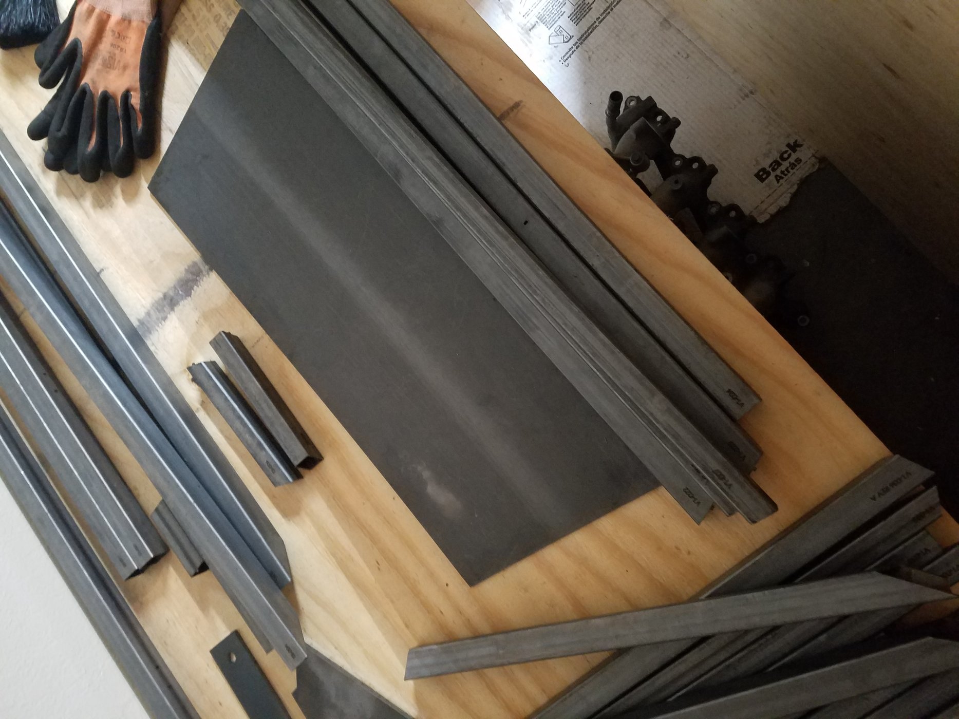

Made a little progress on presidents day. Welded out the main structure. Got some grinding to do now. Welded the dash frame up, and cleaned and etch primed all the tubes for the horse shoe. Primed the tranny mounts and captured nuts. And welded out the tubing for the transaxle to sit on. I originally was going to use a 01e trans but now im thinking i might want to use a porsche box instead. Im scared if i build a 351 to a 408 i will break the Audi box. Just dont know how much it will change the design of the rear chassis if i go with a 930 or g50 box. Any advice out there? I need to make a decision soon. Here state side the price is not too far apart. As there are no audi boxs here unless i get a rebuilt one. So thats 4 to 4500 dollars and i have found the 4 spd 930 box for that price the g 50 is a little more...
