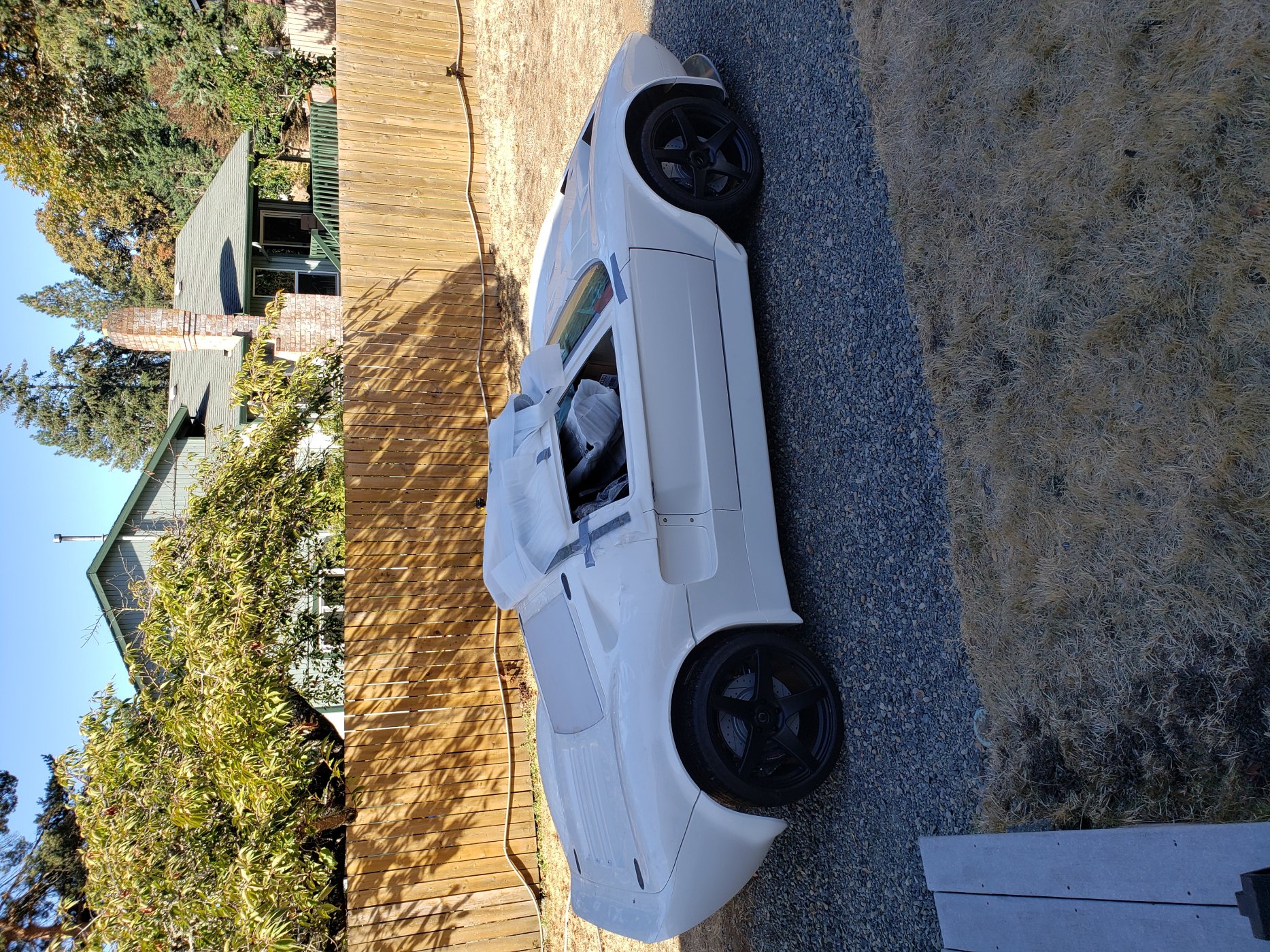

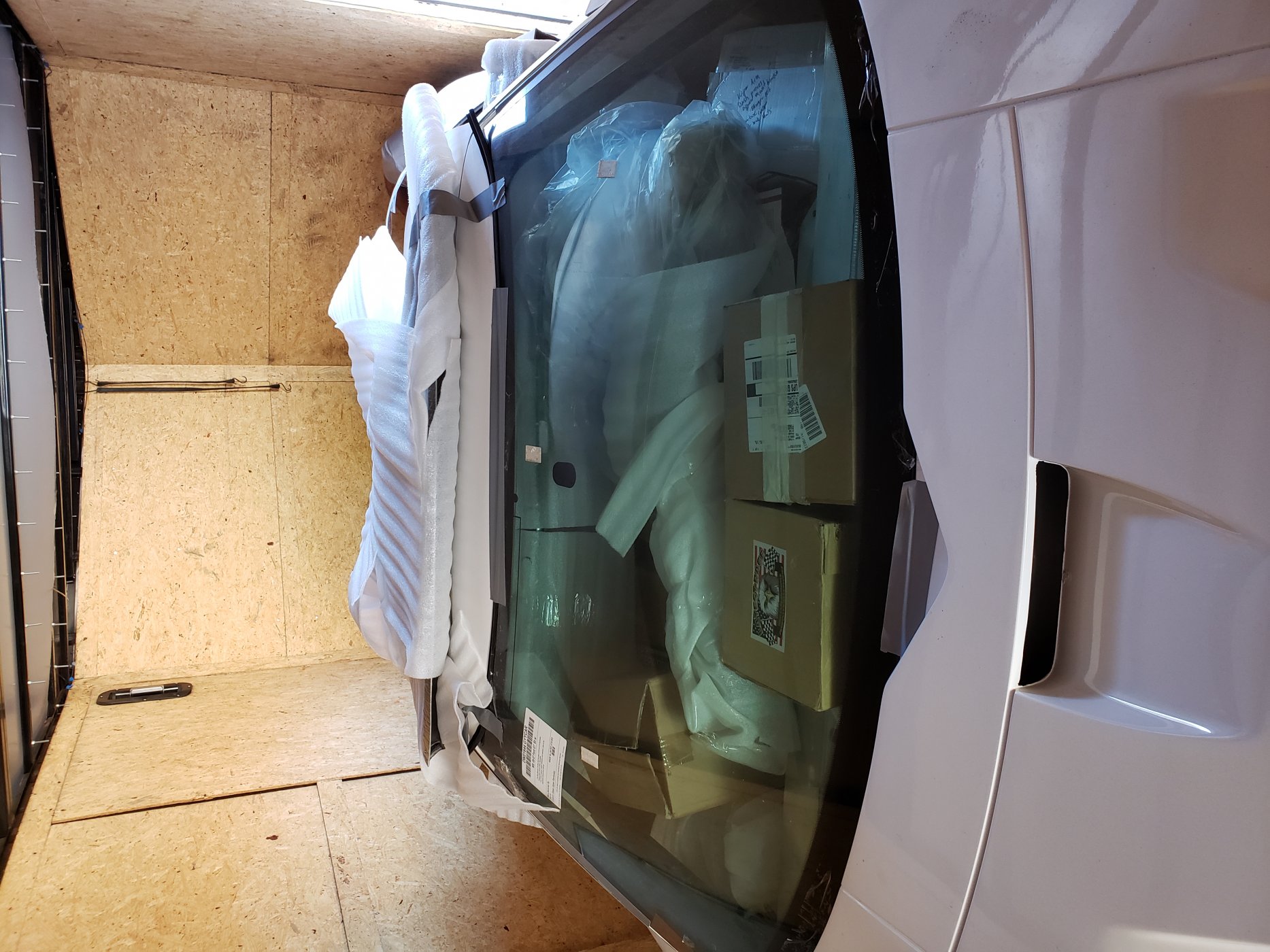

I didn’t want to start my build thread too early for fear of jinxing it, but it finally made its way from New York to Oregon. Like any other service these days, the shipping was not easy. After one broker, two shipping companies and 3 drivers It took 5 days from the initial promised pickup date for it to be loaded. The shipping companies who would not show up at scheduled times and just ignore calls or texts.
For those who wonder, it is possible to fit everything that comes with the car including the Graziano (no motor) inside the car for shipping.
Let the adventure begin!!!!!

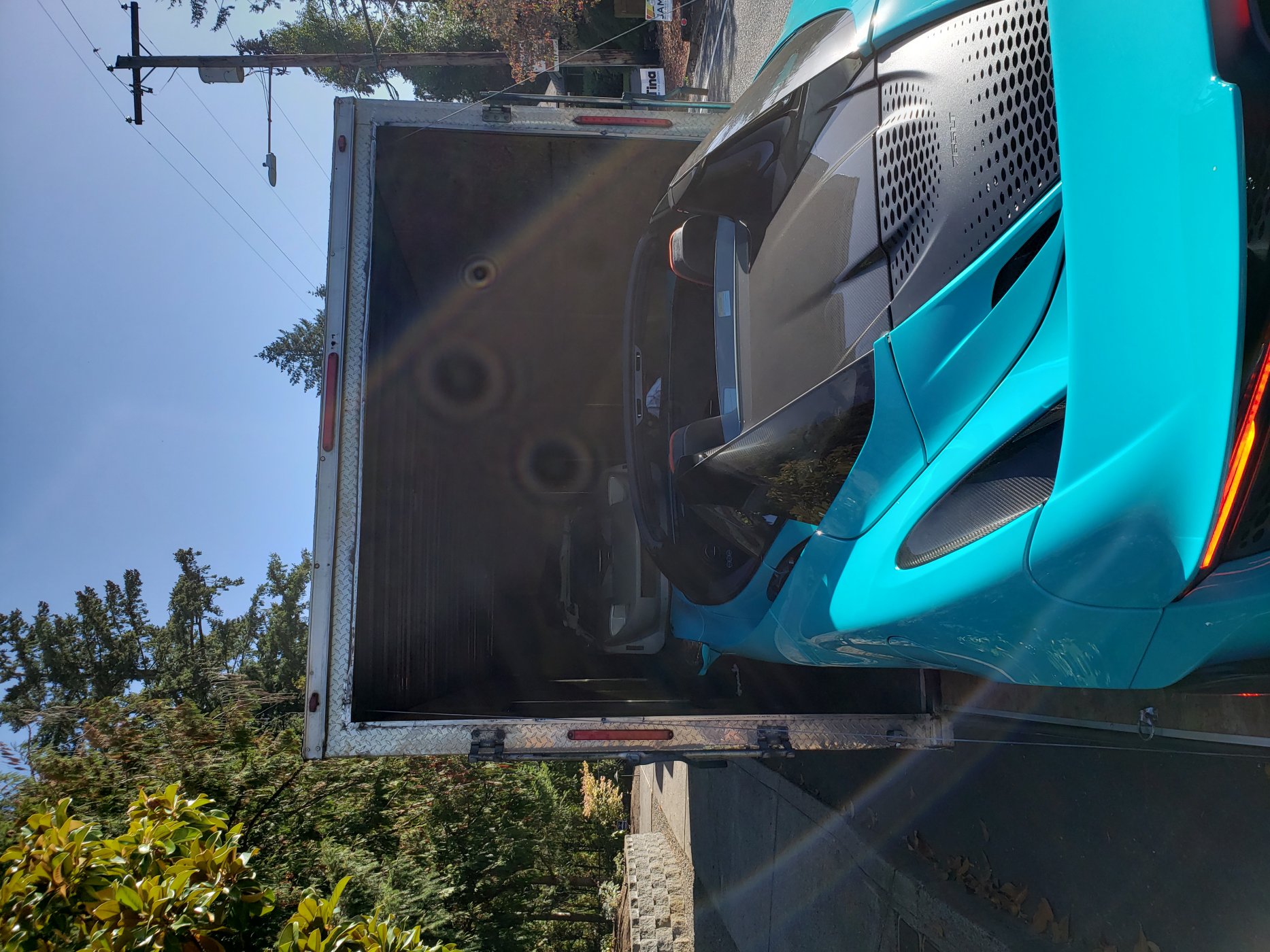

My car arrived hiding behind this 765LT in a beautiful color. Might be a sign I should paint the GT-R this color

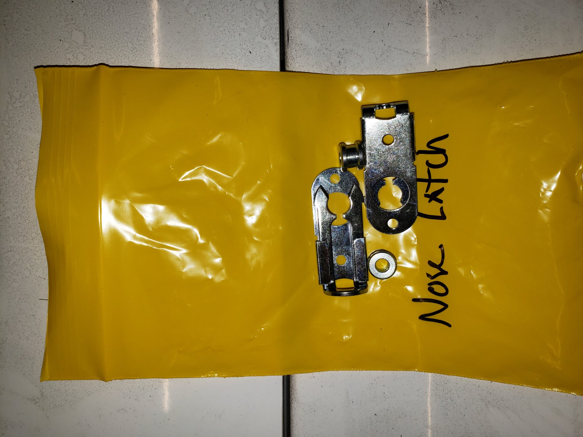

I was unpacking parts from the car last night and was wondering what a couple things are. Tha ks for any help.
I now see it saws nose clips but not sure of their use or placement.

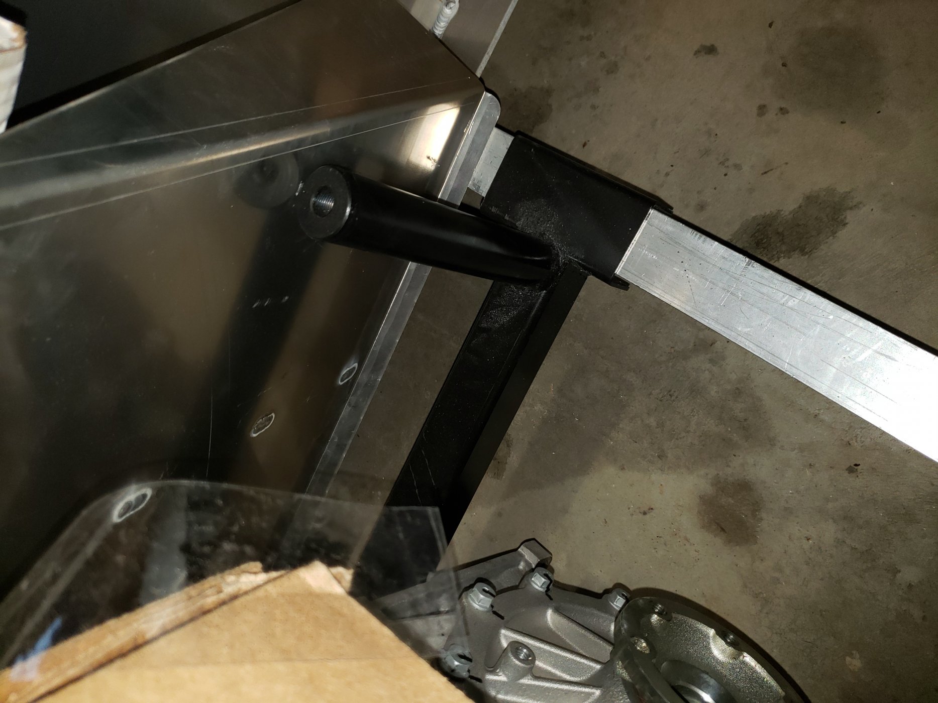

These are about 3ft long

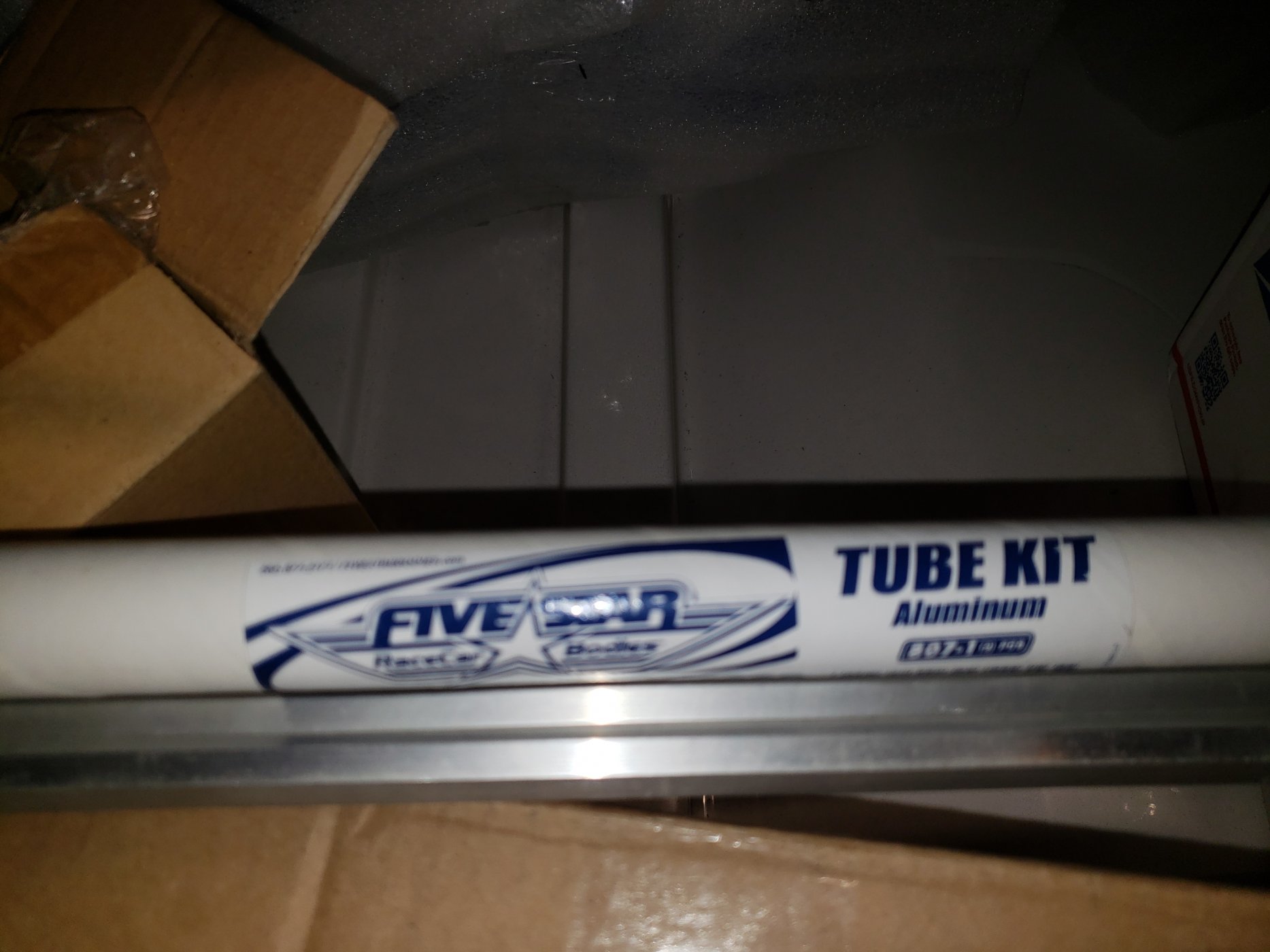

I should have a scale in this, they are about 6 inches long. I have 2 in carbon fiber and 2 black gelcoat

I remember receiving the car and some of the loose parts became a guessing game on what they were for... Took me awhile but I figured it all out (and I still have parts left over - LOL).
I didn't use the nose clips. I modified the front clip per H and others to create a hinged lid to access the battery and reservours and bolted the front clip down. The Five Star Tube Kit contains stand-offs to support and stabilize the side rocker panels just forward of the rear tires and also to connect the diffuser to the support frame. After you cut them to length, you'll need a RH and LH 1/4-20 tap to make them adjustable. Lastly, those are end sections for the dash and need to be cut to go around the roll bar.
