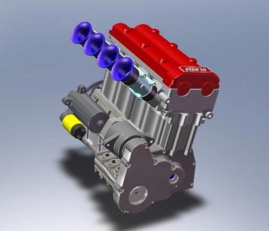

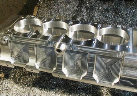

H2 BUSA engine
This would be the setup below, I never did like the chain setup.
"New product- H2 BUSA engine! The design is complete and manufacturing has begun on the BUSA engine.
The H2 BUSA engine will be offered as a kit or complete engine. As a kit, it allows the transfer of all Suzuki Hayabusa upper engine parts to a robust 6061-T6 billet crankcase designed to be mated to automotive gearboxes like the Ford Sierra Type 9. The engine has a 4 stage dry sump system which enables the crankshaft to be just 116mm from the engine bottom. With the 140mm clutch, 215mm flywheel and compact bellhousing, the entire drivetrain on a 7 type car can be lowered several inches. The engine is estimated to have a fully dressed weight of 140lbs and can produce 175 to 250 hp NA; and much more in turbo form.
Availability to be 1st quarter 2009. Check back for updates on the prototype build and specifications when they are released. (No pricing is available at this time, but it is design to be much more affordable and will be available as a kit) Email [email protected] with "H2 BUSA update" in the subject line and you will be notified when more information is available.
Update (11-14-08)... Billet case for the H2 Busa is just coming off the mill. Upper case weighs 5.6 kg. Lower "bedplate" caps weigh 5 kg."
Factory Web site

Karlo,
Nice product but way out of place with the concept of this car....meaning "budget conscious".
The automotive gearbox also does not fit with the Nemesis concept as its not a front engined Lotus Seven
I have spoken at length with John abut his V8 which is very cool but again pricy....and as yet I dont think there is a place in my product line for it or the H2 either
