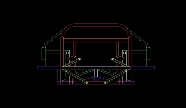

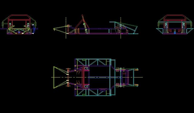

Here's the 2D dwg that I created to produce the 3D design for the chassis I intend to build.

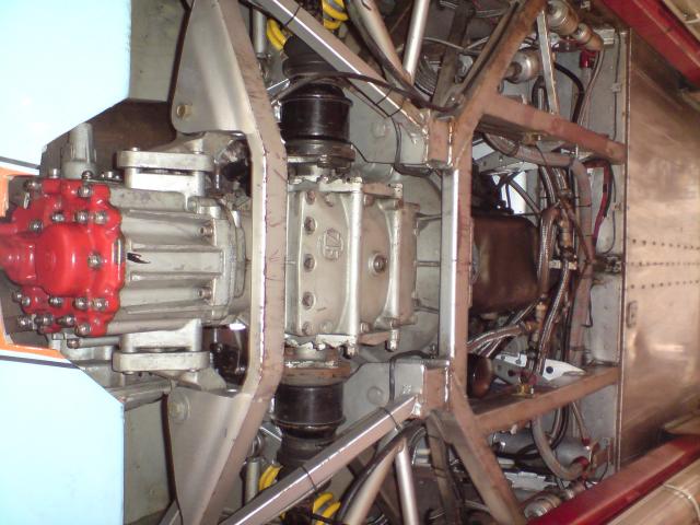

"jpkuehne - to my mind push/pull rod type suspension is not used not to just lighten unsprungs which is very important in itself."
Beg to differ. You have actually increased unsprung weight. You have added the pushrods and the bellcrank to the equation. The all the mass that moves is reacted by the spring.

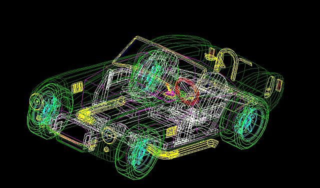

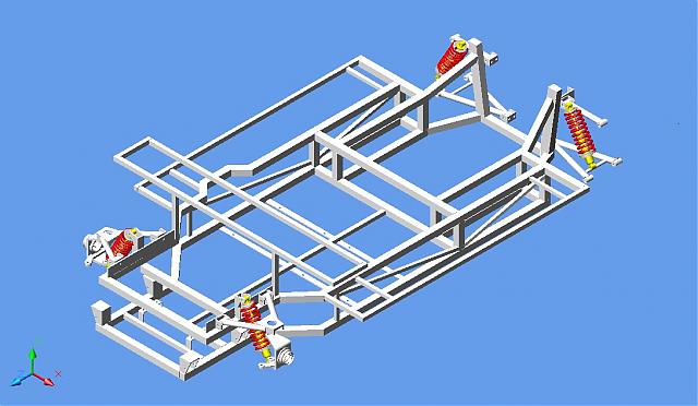

Just been rummaging through my files & found this on a CD containing chassis drgs I did many years ago. This was done in AutoCAD which although not a true parametric 3D package does help with visualisation. My latest attempt is in Inventor & I'll post this once complete.

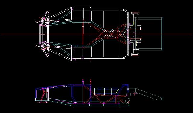

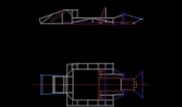

hi, my name is david from melbourne australia.
first timer, I have bean building cars for most of my life, and i would love to build the mono chassis of the gt40.
i payed for some jigs a few years ago but didint get all the items i needed to build the chassis.
i finaly got a mould this week, so its time to start all over again.
all i know its a mk1 body.

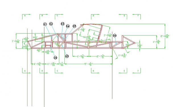

listed are some drawing i did years ago.
anyone how wants to exchange ideas and drawings please contact me on venom_00427 at hotmail.com.
i will be building the first one in rhs, but the next one i would love to build it in sheet form.
starting this week. i hope?

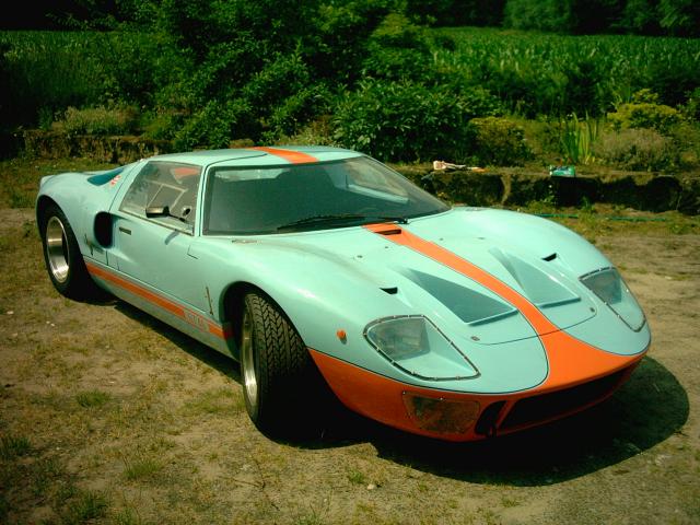

A few years ago my father builds our Ford GT40 MK1 in our Garage
based on an Hermsen Raceframe and body.
And now we decided to do a new one for me, but I won`t will buy an Kit,
I will start to build it on my own hands, I working with cars for 10 years now and have good contacts for cutting and welding the frame. I have experiences in AUTO CAD 2000 and Inventor.
Now Iàm searching for Frame Plans in dxf for download at the web-
so we don`t have to start this projekt from point zero..
Can anyone of you help me ?
It would be nice to see an positive answer
Thanks a lot for your help and answers
Best regards
Christian
Here is our first GT40, now Iàm trying to look for the new project..
So does anyone can help me with some drawings?, As we want to do it
scratchbuild from our own..
