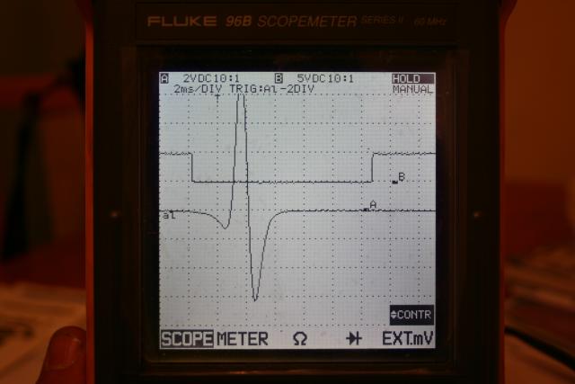

Kalun an oscilloscope is what you need.Apply the DC voltage to the correct pins (sorry can't help there) and then hook the scope to the signal and ground.When you crank you should have a healthy series of square waves on the scope. Your Fluke 88 is probably like my old 77 and although it will read on AC it won't be accurate and you can't determine the waveform is a good shape. I've got plenty of oscilloscopes here in OZ but I don't suppose thats much use to you at the top end of the world.
Ross
Hall Effect Sync Signal
Hi Kalun -
The signal for the hall effect output would, as Ross says, look square as the upper trace seen below. The lower trace is the mag output from an MSD Distributor. :)

Kalun,
I have access to a scope and would be happy to check the pinout.
