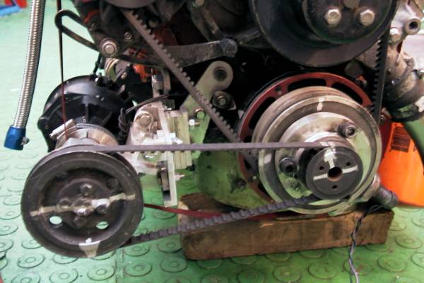

pps - this will make you laugh - how we used to distribute the spark back in 2000 BEFORE switching to Motec and multicoils. /ubbthreads/images/graemlins/grin.gif

I remember seeing this pic before, I see an MSD trigger wheel there. It looks like the timing marks are set up for if you lose your reading glasses. 8>)
