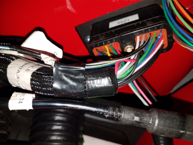

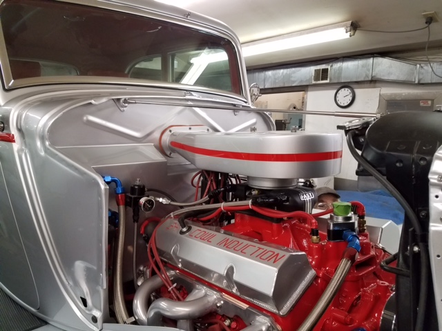

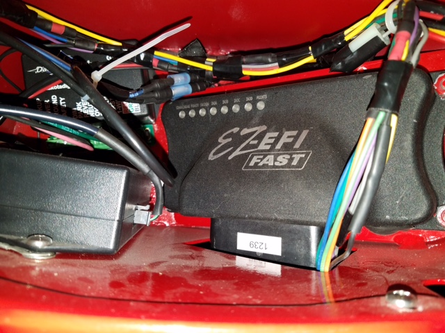

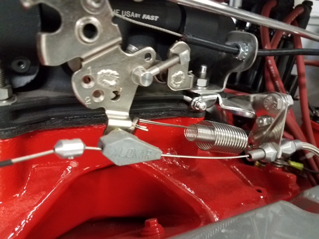

Yes this is the FAST EZ-EFI 2.0, but also controls spark and came with the distributor, fuel pump, regulator... The 2.0 system also includes a handheld controller that you can use to do your setup or monitoring the system.
IMO it is Junk.
