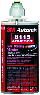

Hi Bill,
Use this (or similar from SEM etc.) and it will probably never come off - but I would still go with the 2-sided automotive tape.
