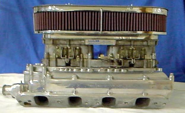

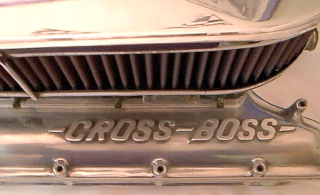

Guys,
Do these formulae work with a Ford / Autolite in-line carb & Cross Boss manifold set-up ?
I would appreciate any help.

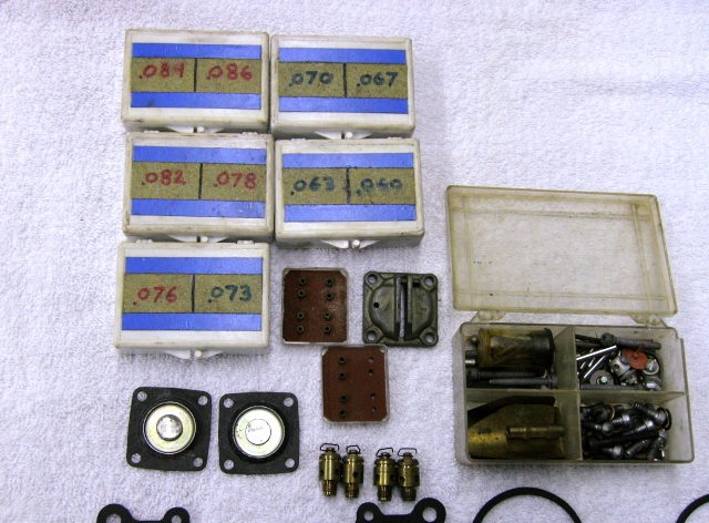

Jac,
I bought one recently with a pile of spares and three sets of manuals but the paperwork could be for a moon lander vehicle for all I know. I need to learn about these things.
I was told that these carbs beat the Webers hands down for progression.

I would imagine if they have a plenum under them they might be close. If IR under the hood then maybe not so much, but would be something of a start. These calcs are really estimates for more conventional setups but always a good starting point as it is easy to visualize a Holley like carb ;-)
I have seen a few of the autolite setups and they are as cool looking as webers, maybe more so since they are from Autolite and hens tooth rare I'm guessing.
Sandy
That's exactly what I was thinking Sandy.
I also agree that it's a pretty cool lump of kit and I would like to give it a go some day. I have an ambition to do a nice Mustang some time so I decided to buy this as a reminder.
