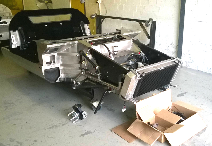

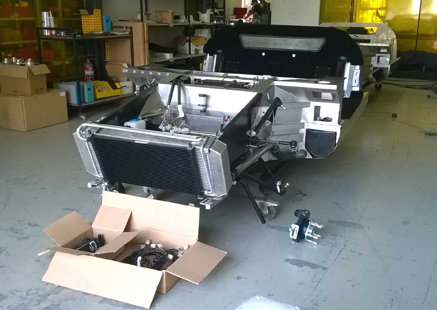

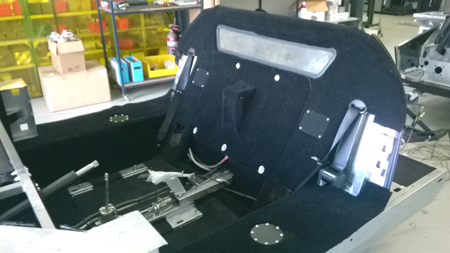

Johann informs me today that the body is in paint and that there will be some photos soon. Meanwhile, the chassis is undergoing final assembly as shown below. You can see #181 behind, not quite as far along. Notice the A/C condenser coil is in the front on these later cars.
Sam
