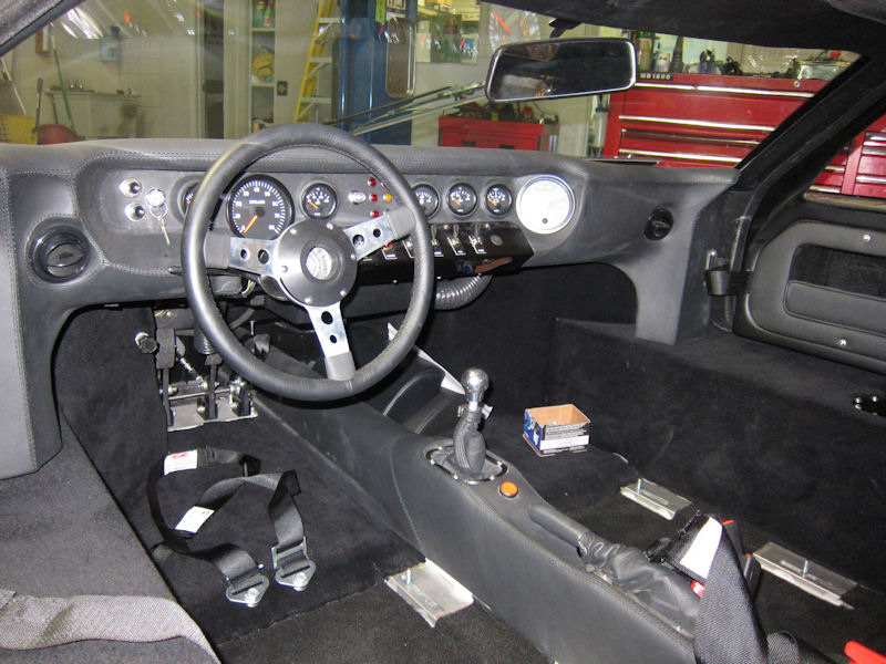

I'm back from a short trip to North Carolina to survey the progress. We are in the final stages of personalizing the car. Specific things included installing hard points for shoulder harnesses that were not there in the factory body. Also we fitted the seat and pedal box to my dimensions. Made a number of decisions: where to mount mirrors, license plate, fabricate straight pipe exhaust trumpets, modify muffler turndowns to clear body more, change plug wires to underneath headers, recoat headers to silver, how to install sill stripes, install paint protective film.

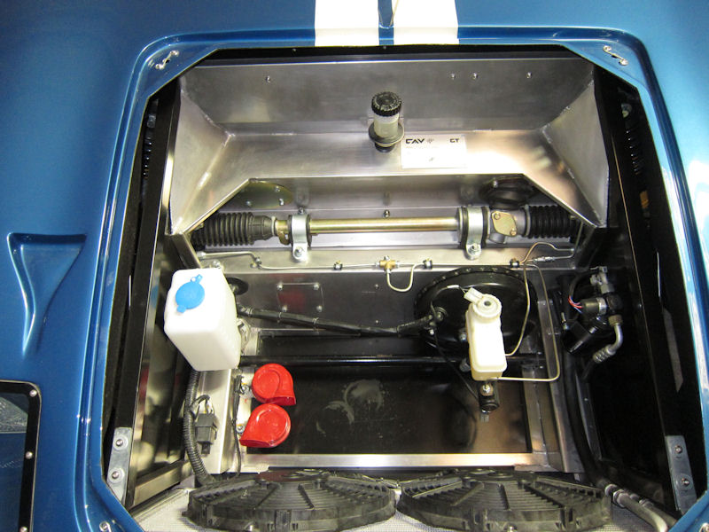

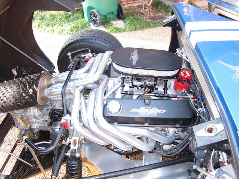

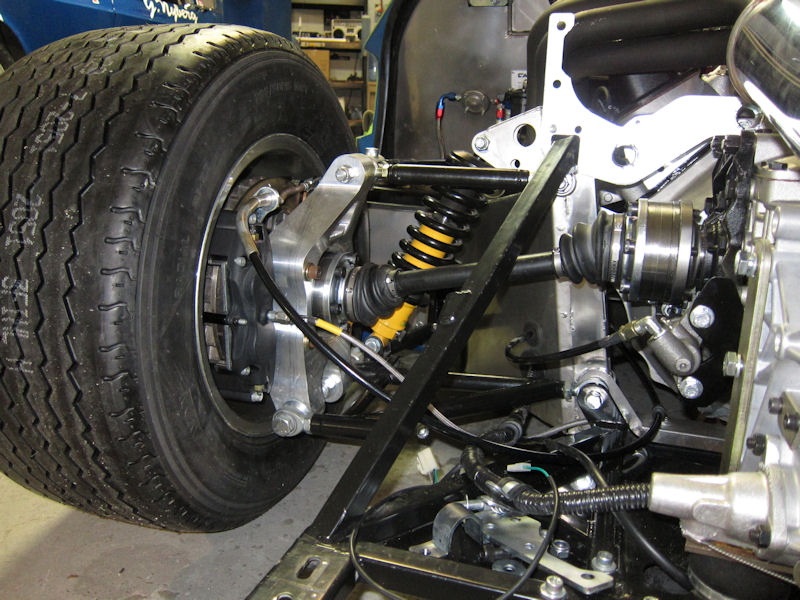

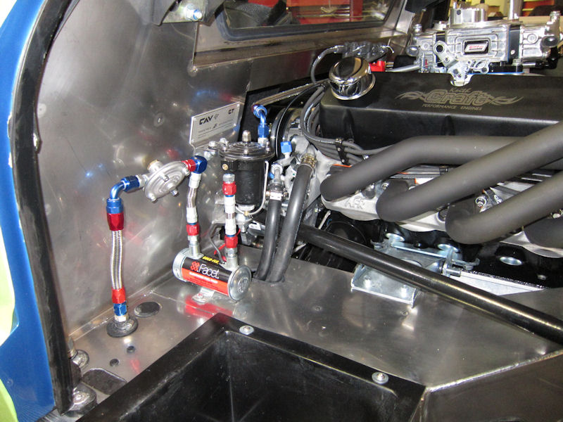

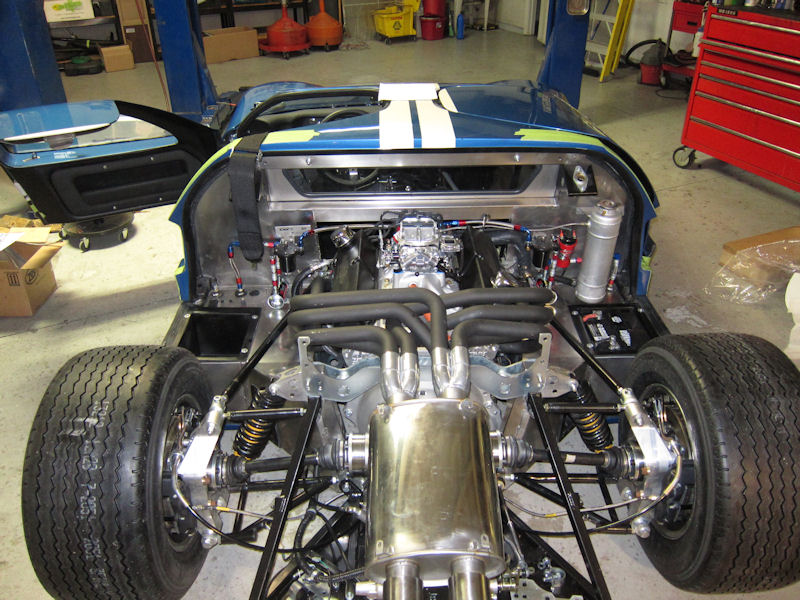

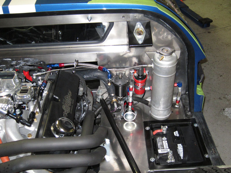

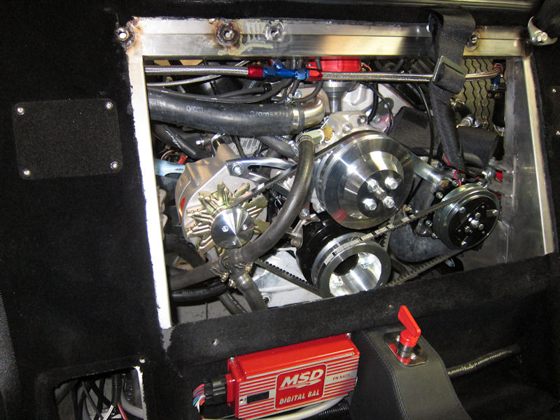

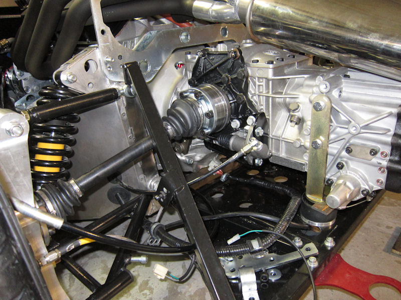

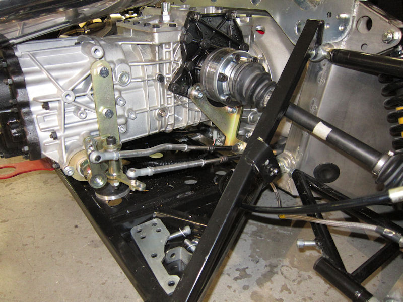

Some still photos from the trip. In the second image, note the newly welded nuts in the firewall on the left, and see the harnesses mounted on the right:

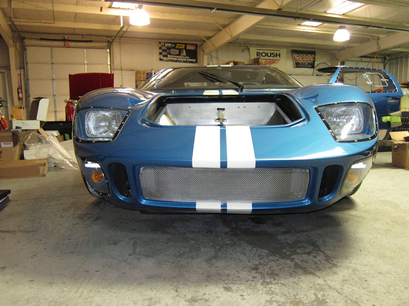

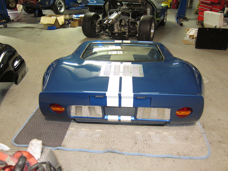

Still more ...
Apologies for doing this in multiple posts, still learning how big a gulp this forum will allow:

Great looking car Sam and thanks for sharing. One suggestion, mount a stainless plate on the left side of the pedal box over the carpet. It will prevent an annoying drag on the carpet by the side of your clutch foot.
Thanks, Pat. I will look at that.
One issue we are working is clutch pedal stiffness. This car has the RBT/ZF mechanical throw out arm and Pantera style throw out bearing. That is what CAV called for. The clutch is a McLeod 10.5" Mustang style diaphragm, single plate version. As I tried it, it was very stiff and difficult to modulate. Dennis is having them experiment with different slave cylinders. Anyone been down this road?

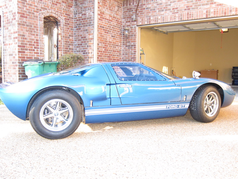

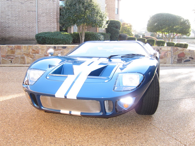

CAV 180 has arrived! Just 14 months after the first contact with CAV in Nov 2013 ;) It's been a looooong wait. It was late afternoon, but I shot some quick photos just to prove I ain't lyin' :D
Drove around the block one time just to get a feel for the clutch and shifter before attempting the steep driveway. Dennis set the supension a little high at my request, but it will still drag if I don't bridge the junction of the driveway and street with a couple 2"x12" 10ft long planks. I'll come up with something later.
Clutch is very stiff and shifter is also. Hopefully, that will improve over time. I can modulate the clutch ok, so I'll just wear stiff shoes. Got some Piloti that will do nicely.
