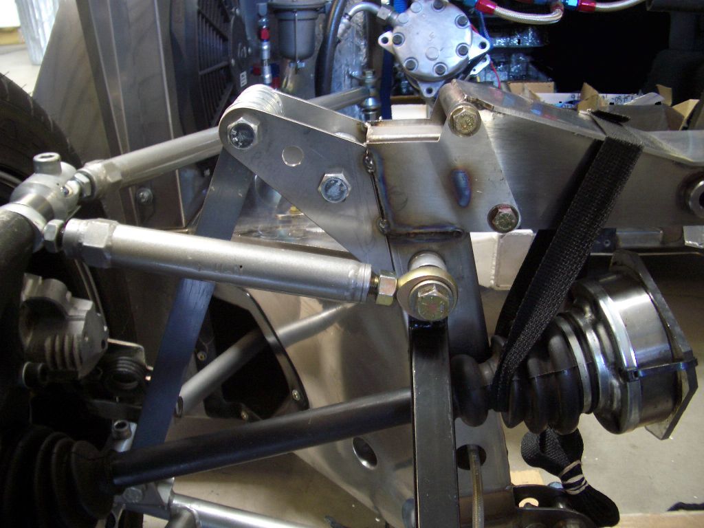

If you take your medications regularly you will stop seeing imaginary brackets. Finally, here is a picture of the real one made of 0.120 inch thick SS plate. (And thank you Howard, this time I used the correct caliber weapon to drill the holes.) The left and right sides of my CAV were very symmetrical which made fabricating the parts to fit and then locating both brackets much easier. The brackets were located and then tack welded in place while being held by the 13 inch long gauges.
An additional piece will be added on the top to box-in the brackets and cap-off the open chassis tubes beside the crossmember. The flat part of the cap near the crossmember will include weld nuts concealed on the bottom side for mounting a stock CAV sway bar. Original style GT40 sway bar mount can also be added to the tops of the outer most shock absorber locations.
I decided to make the brackets wider than necessary. The extra width will let me use spacers to center the upper shock bushing in the bracket so there is no binding. This is a detail of design seen on other brands of replicas which I think is smart and prudent.
Just like on the AutoFutura brackets, I used three shock absorber mounting angles, but mine are on each side of the stock CAV shock angle. This also seemed to be prudent and in-whack. If my requirements ever get so specific that I need to change the springs, at least I will be able to use a method of limits to experimentally determine if I need more or less spring rate.

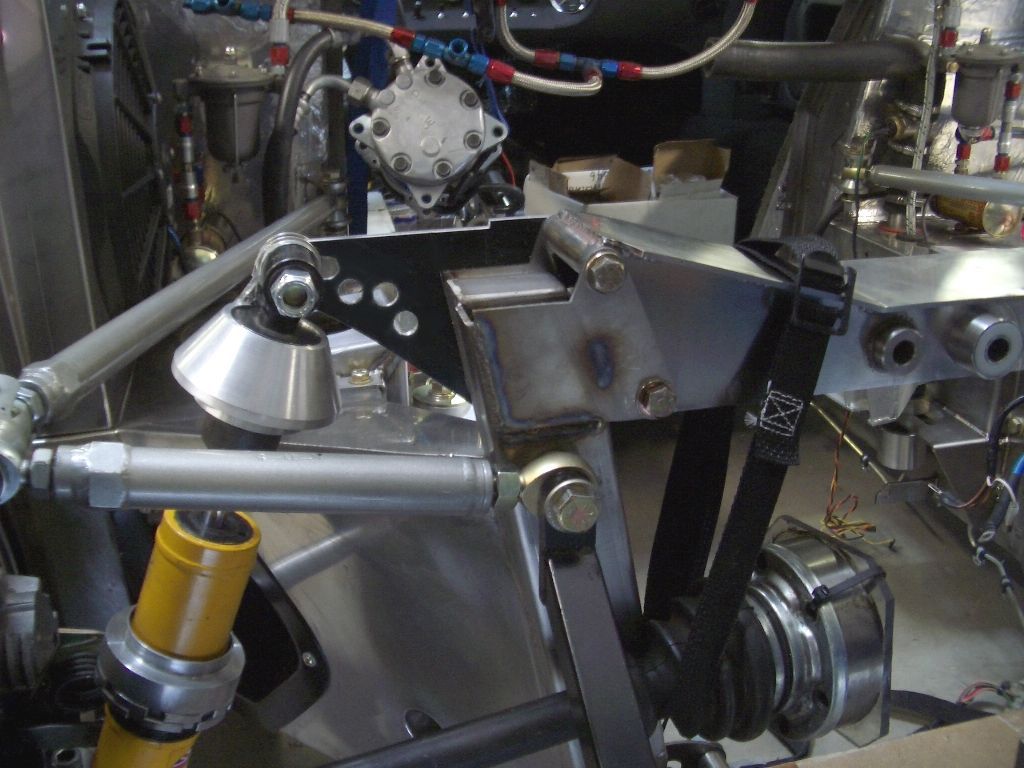

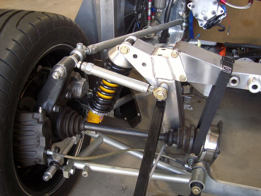

This is the last step for phase IV. Hurray! The car is now on its wheels and can be moved around! The new brackets are positioned and welded in place as shown in this picture with the shocks and springs. And, while these are not quite tractor brackets, I will admit that they are a bit over designed. I like them, they look cool and are made of shiny stainless steel to match the rest of the car.

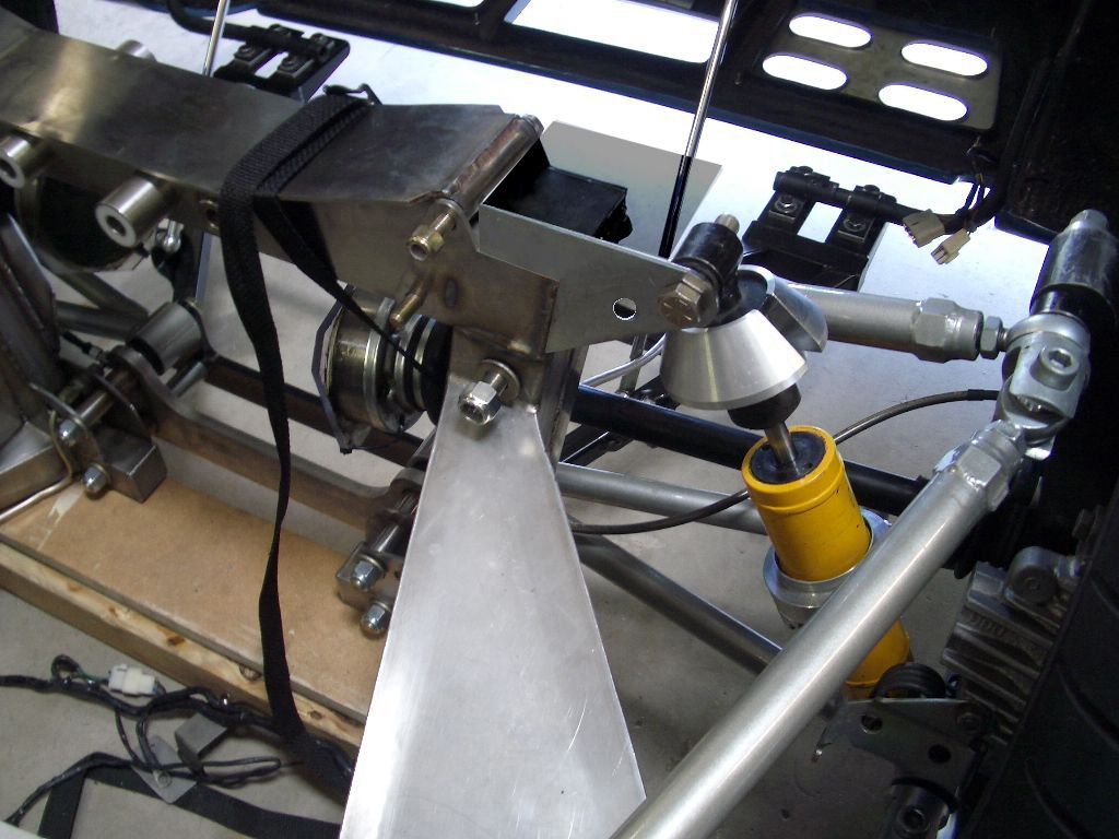

In this close up picture you can see the three mounting positions for the shock absorber (above, at, and below stock). The two additional holes on the top of the bracket are captive nuts that can be used to mount the support for the stock CAV sway bar. Alternately, an original style GT40 sway bar mount can also be installed over the top of the shock absorber. The washers used to center the top of the shock will be replaced with polished aluminum bushing.
The last custom parts to be installed in this phase were the aluminum cones (or hats) for the tops of the springs on the shock absorbers. These parts came from the same source that supplied the adjustable motor mounts and the crossmember. The stock CAV shocks have dull gray colored flat cast caps at the top of the springs with aluminum spacers at the bottom. In this case, all I had to do was remove the aluminum spacer at the bottom and replace the flat gray cast piece with the cone hat. Now the tops of the shocks catch your attention and these pieces of “eye candy” also look like those found on most original GT40s.

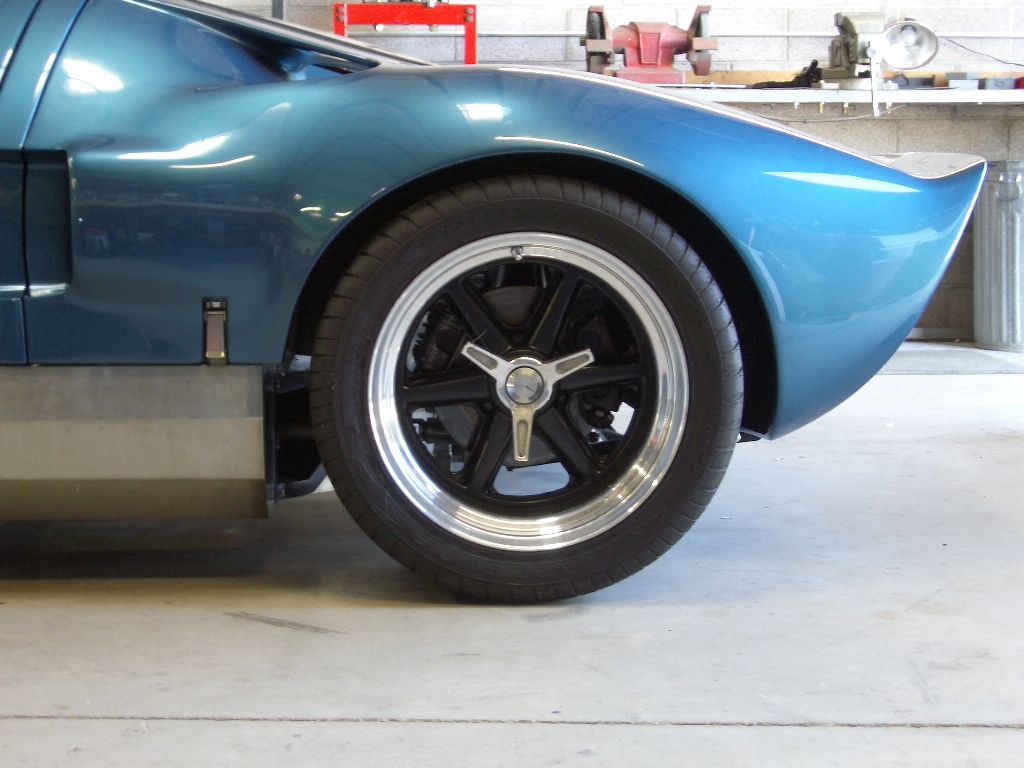

And finally for closure, here is the “AFTER” picture of the wheel and tire centered in the wheel well. When compared to the first picture of part IV, this is a big improvement.
I got everything I had hoped for out of this series of modifications. The space between the top of the tire and the wheel well was reduced. I was able to center the adjustment range for ride height. The proportion of suspension rise to drop was also improved mostly by setting the stroke of the shock into the middle of its working range. The custom shock brackets (in the style of AutoFutura) made the angle of the shocks adjustable, and provided a means to eliminate binding at the upper shock absorber bushing. The shock absorber caps were an extra bonus.
