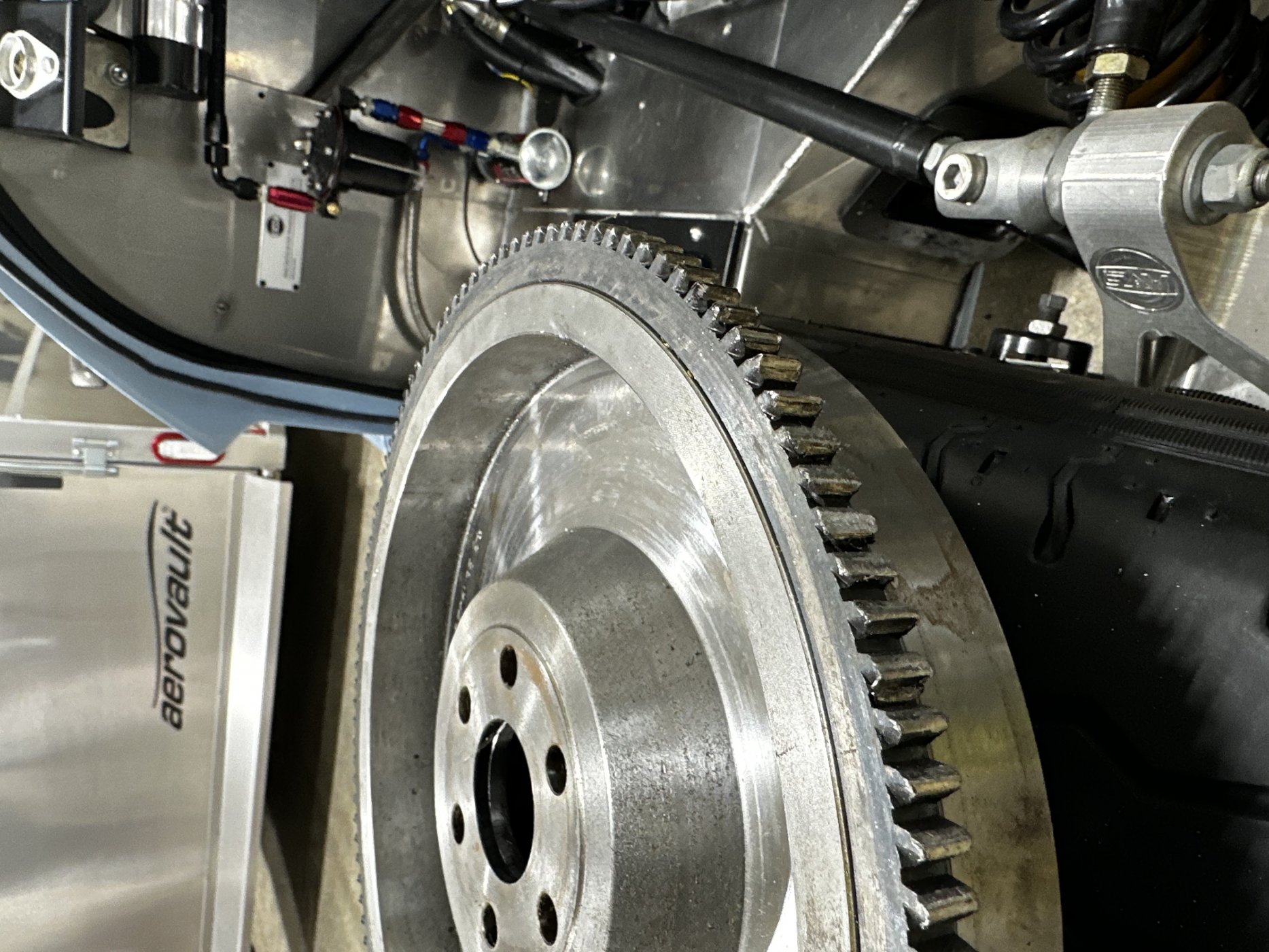

Greetings, my CAV has a tall deck SBF and Audi 01e transaxle. The starter decided to chew the flywheel ring gear. I pulled it apart and as per the pics, the flywheel part number is FF06V35. Would anyone know the source of this? I do know its a 121T ring and Ford Essex V6 starter motor. Thanks!

Ring Chris Cole on 01953416051 UK number. He does not do internet stuff. I believe he does 121 tooth steel flywheel. He may have ring gears.
Mike Pass
Burton Power do Essex ring gears
Ordered. My local transmission guy will swap the ring gears. Thanks for the heads up.
