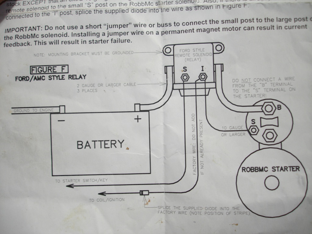

If your starter has an integral solenoid, but you are also running an original style Ford Solenoid, make sure you don’t have a jumper wire between the two posts on the starter itself. Refer to the attached drawing...
