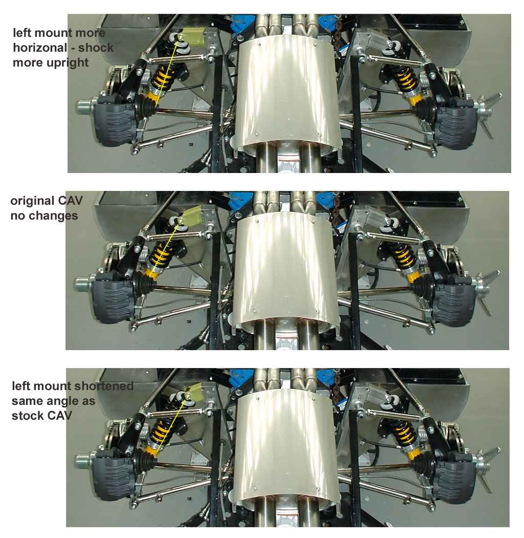

As for your question about rear ride height, I got advice from a lot of old hands and then reposition the rear ride height on my car by shortening the upper shock bracket. The first photo illustrates this change. The second photo shows the car level with wheel clearence and ride height totally adjustable in the desired range.

Bob, first thanks for the comments!
Yes, you have one of the few CAV's that I have seen with the rear sitting right, however needs to be painted gulf blue and orange :-)
I like both of my options very much, but for some very different reasons. Some of them are things that are an annoyance (to me that is) on the CAV, other the CAV has is a huge plus. The build it yourself route has some things that I really enjoy doing, ie, the mechanical, the rest like fit and trim I suck at and don't like BUT I can use 13" racing brakes, dump a hewland transaxle in it, etc, etc. The CAV is excellent in the fit and finish and it is easy(er) to get one up an running and that is huge. I really can't say how nice it would be to work on my engine and trans and drop that into a car that is pretty much done except for setup and tweeking. Some of the tradeoff in what I can dump into the car also is related to how much of the work is done, the fixed cost of a CAV roller vs me doing bunches of work and gathering up all the minutia (sp) of parts that are really needed to get to the same state.

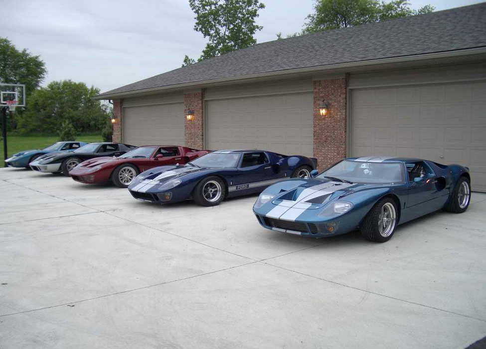

Yes, you are absolutely right. I bought my CAV roller from Dave Wagner in Michigan. Dave is a long time Ford employee and a Cobra expert. We worked together on my car until it was drivable and could be shipped to Phoenix. Dave has a fantastic work shop, is very skilled, and is great teacher.
At the time, Dave had 4 other CAVs in various stages of completion (along with a couple of Cobras). As luck would have it, all five GT40s were finished on the same weekend so we rolled them out to take this picture. Each was outfitted differently and all were full of custom fabrications. From left to right, Guardsman Blue, 385 HP 289, & ZF; Black 600 HP 427 FE, & ZF; Maroon 351 with injection, & ZF; LeMans Blue 650 HP 427 (351 stroked) & ZF; and my Guardsman Blue car on the right end with a 400 HP Roush 342 & ZF.
The last month was very exciting, as one at a time, each car as completed and started for the first time.

Dave is a good friend of mine also ..I actually sold a couple of GT40 's for him..
He is a great guy with a wealth of knowledge...he did however tell me he would not do mid engined cars again due to their complexity compared with his beloved Cobras...
I know three of the other owners of the cars you picture...
Reed had Dave remove his ZF and install an uprated G50 transaxle due to its superior strength and the fact he was running a serious engine.....
Thanks for the great picture...(outside of Daves garage) /ubbthreads/images/graemlins/grin.gif
