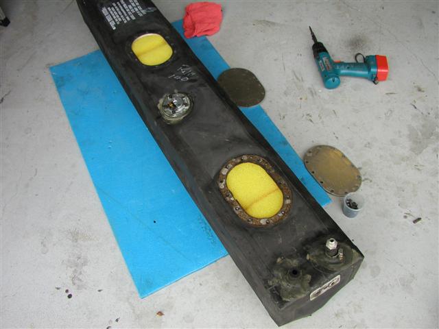

As some of you know, I recently replaced a leaking fuel cell in my CAV. After some vigorous driving, I noticed a new fuel smell. I've already addressed the filler caps so I pulled the inspection plate over the fuel gauge and discovered it was wet with gasoline.
I pulled the new cell and discoved the attached.

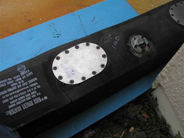

I will leave it to the keen eyed observers to determine if you can spot the problem as I pulled the foam inspection/replacement plates.
Notice anything unusual??

Looks like a little more attention was needed when assembling that tank. Maybe it was a Friday tank. /ubbthreads/images/graemlins/smile.gif Seriously for safety's sake, you just don't want to have problems like that.
Veek, its a bit of a bugger getting the tanks out of a CAV, but having got them out ( I have two out at the moment ) I am glad for the warning to check the gaskets, Thanks, Frank
Pat
Thanks to all. I knew the responses would be memorable. This forum certainly is populated with a witty bunch with a keen eye.
As you noticed, check the gaskets before you place a new cell in your car. The rear was delivered with, the front without. Shame on me for not checking before I installed the darn thing. I was fooled by the fact that gasket sealant was evident in the fastening screws. None was between the plate and the cell. Buck and his cadets need a little lesson on quality control. I sent the old cell to Floats and Cells in Memphis to give me a quote of fabricating another. http://www.ffcfuelcells.com. I figure in 5 or so years I’ll need to replace them and I don’t want Buck to have another opportunity to turn me and my car into a smoking greasy spot on the road.

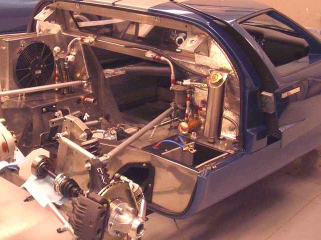

I am very jazzed that all the fuel cell issues are being discussed here with specific suggestions. Like Frank and Pat, I happen to be doing this work right now, so the advise and experiences of others is perfectly timed. I actually did the battery stuff last week. Getting the battery and all the electrical wiring out of the same body cavity as the fuel cell is a relatively easy job on the CAV.
Battery
I ordered all my parts for this job from Summit Racing. A new red 1-gauge wire was run from the standard CAV master disconnect switch, along the right side of the interior under the gray plastic cover plate with the heater hoses and into the front of the car. A new ground connection was made to the chassis in the front end.
Putting the battery in the front is a close fit and required some trial and error fitting. I ended up using a vented marine battery box and cut 2" off the top so that the battery box cover would sit low enough to clear the front clip nostrils. A 0.80" SS tray with flanges on all four sides was fitted 1/8" above the sway bar to hold the battery. Two 1 1/4" diameter aluminum spacer were made to hold up the front of the battery tray. The tray was bolted in place to the passenger side foot well and through the spacers to the belly pan. The battery is actually held in place by two hold down bolts that go through the tray, and up through the bottom of the plastic battery box, through to a steel strap across the battery. Silicone was used to re-seal the bottom of the battery box where the bolts went through. The marine battery box included a nylon strap which is just used to hold the plastic top on the battery box. Everything was done with 5/16" grade 8 hardware and nylon insert lock nuts or safety wired.
Remote Terminals
Mostly because this was the first time I had done this job, I mounted a set of remote 12 Volt and Ground terminals in the engine compartment and used the same holes and wires that the original CAV battery had used. In retrospect, the remote terminals did not have to be mounted flush and could have been installed on a raised bracket bolted to the chassis. The wires that used to go the battery could then have just been connect to the terminals on the new bracket. This would have made the job much easier and is probably what I would do now if I had the job to do over again.
