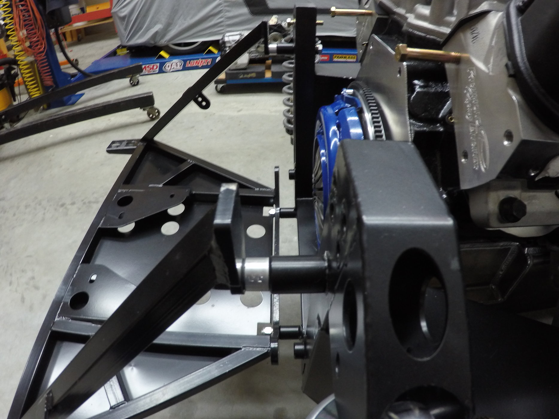

Use caution with RBT and ask questions in advance. I have a RBT with Kennedy bellhousing. The bellhousing from Kennedy is to long or the RBT input is to short resulting in a poor fit to the crankshaft. The release bearing support is also to short. This could all be a lot better fit with a shorter bell, I couldn't find one. After a few calls to Dylinn at Griffin and him stating he would make a longer bearing support I gave up because he never came through with his word. The bellhousing I recieved from Kennedy was in a box with no part numbers, no brand markings of any kind so I phoned them to ask if infact I had the bellhousing I had ordered, they said yes that's how they come. ( off shore junk is the way I see it? ) FYI in a CAV you will have to modify the bell to fit the tub, machine the bottom to clear the cross bars and the starter nose to clear the upright. I like the McLeod twin disc, wish I had known sooner. I have a 427w, good luck.
Bill Kearley
Sean

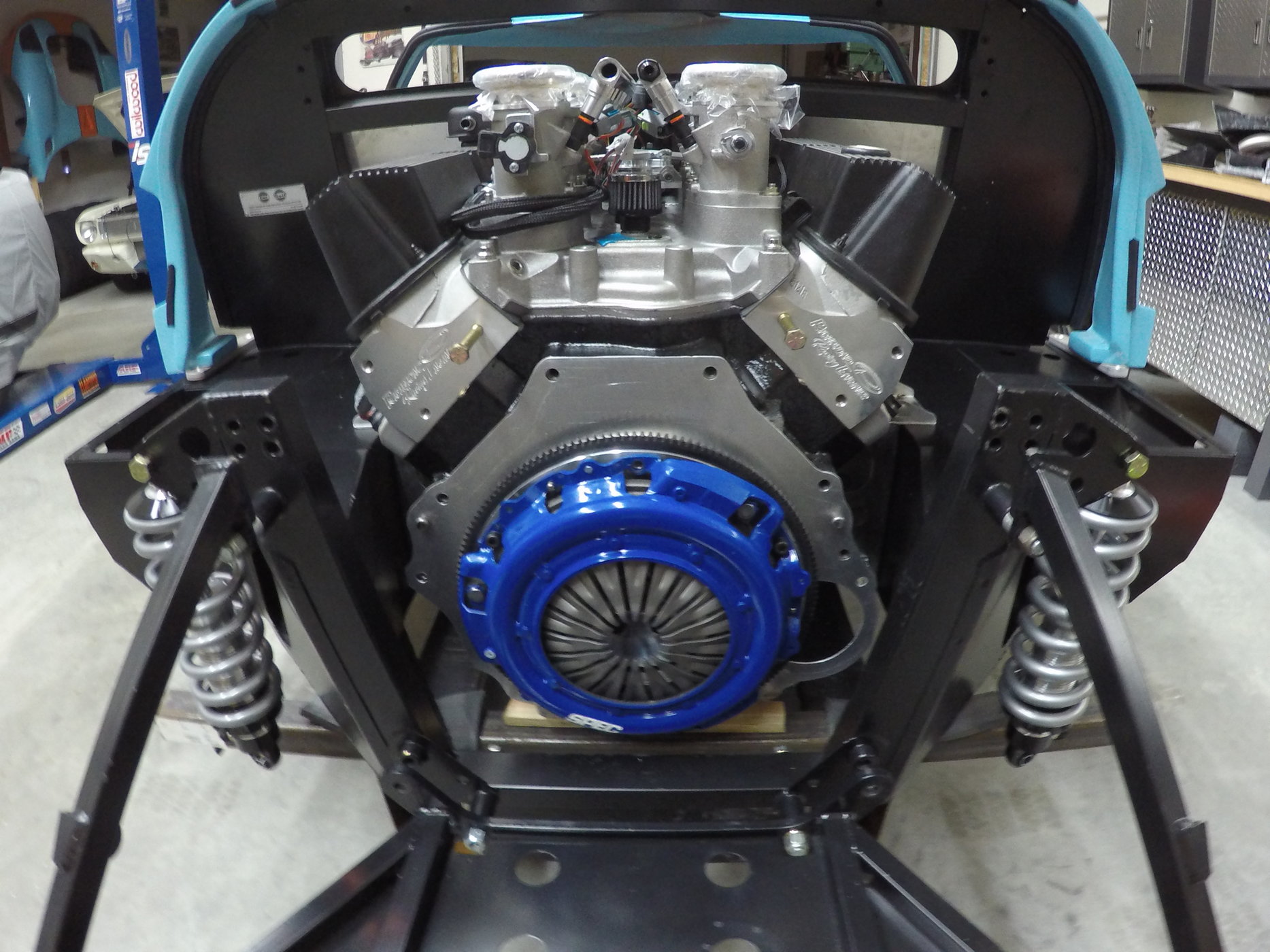

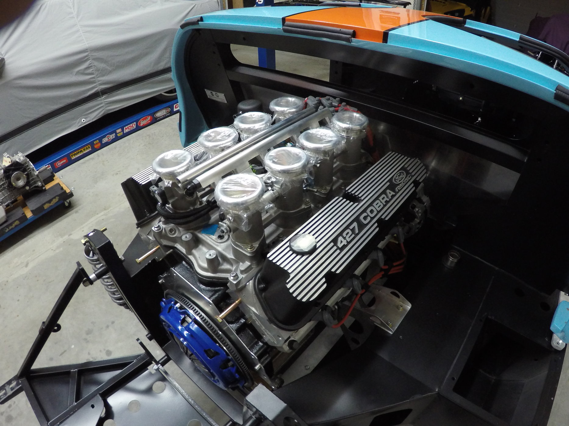

New it was 4 1/2 inches. I had 1/8" machined of the front and back. That gave me 4 1/4" , it still gives me concerns with pilot/input shaft support. A 4 inch bell would have been much better. I am using a Spec clutch and have lots of room to move the trans closer and allow the release bearing to fit on the support better. As it is I only have about 3/4 of the bearing is on the sleeve using about 1 inch of shims. and about 1/2 inch of the input in the crank bushing. Sorry I didn't take any pictures.
Bill Kearley
Not much, but this is what I have
