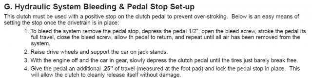

I'm not clear if you're trying to determine what to order or how to set what you have. If the latter then this extract from Tilton's setting instructions might help.
Jim
